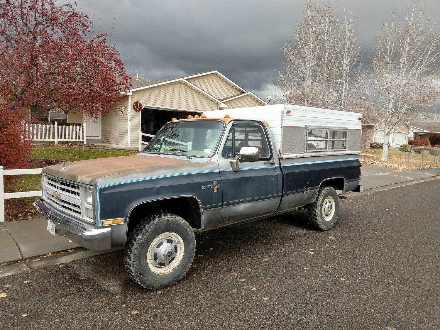

Nice anymore pics of it to share
Just a couple from the other thread. This is from December when I first saw it in Grand Junction:
This is it parked inside my garage, where it will likely stay for the next year or so:
