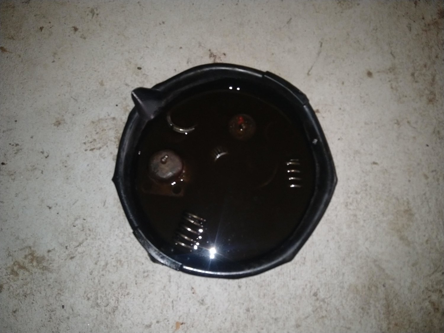

I started cleaning today...
Didn't take too many pics, but basically just poured a bunch of old gas into my oil catch pan. Put the parts in one at a time and hit them with a wire brush. Then I put them into a bin of soapy water and hit them with a different brush, and finally I put them back into gasoline to soak. I figure I'll just leave them soaking in gas overnight.
Here's a late photo of the parts soaking.
I also tried washing my spindle parts. My dad bought me a power washer hose attachment a while ago that I had forgotten about. It got its first use today and it did an okay job. I am going to have to go back with a scraper though.
Anyway, I suppose it is progress. Nothing glamorous, but I'm moving forward. Can't wait to have this axle back together and new tires on the truck.

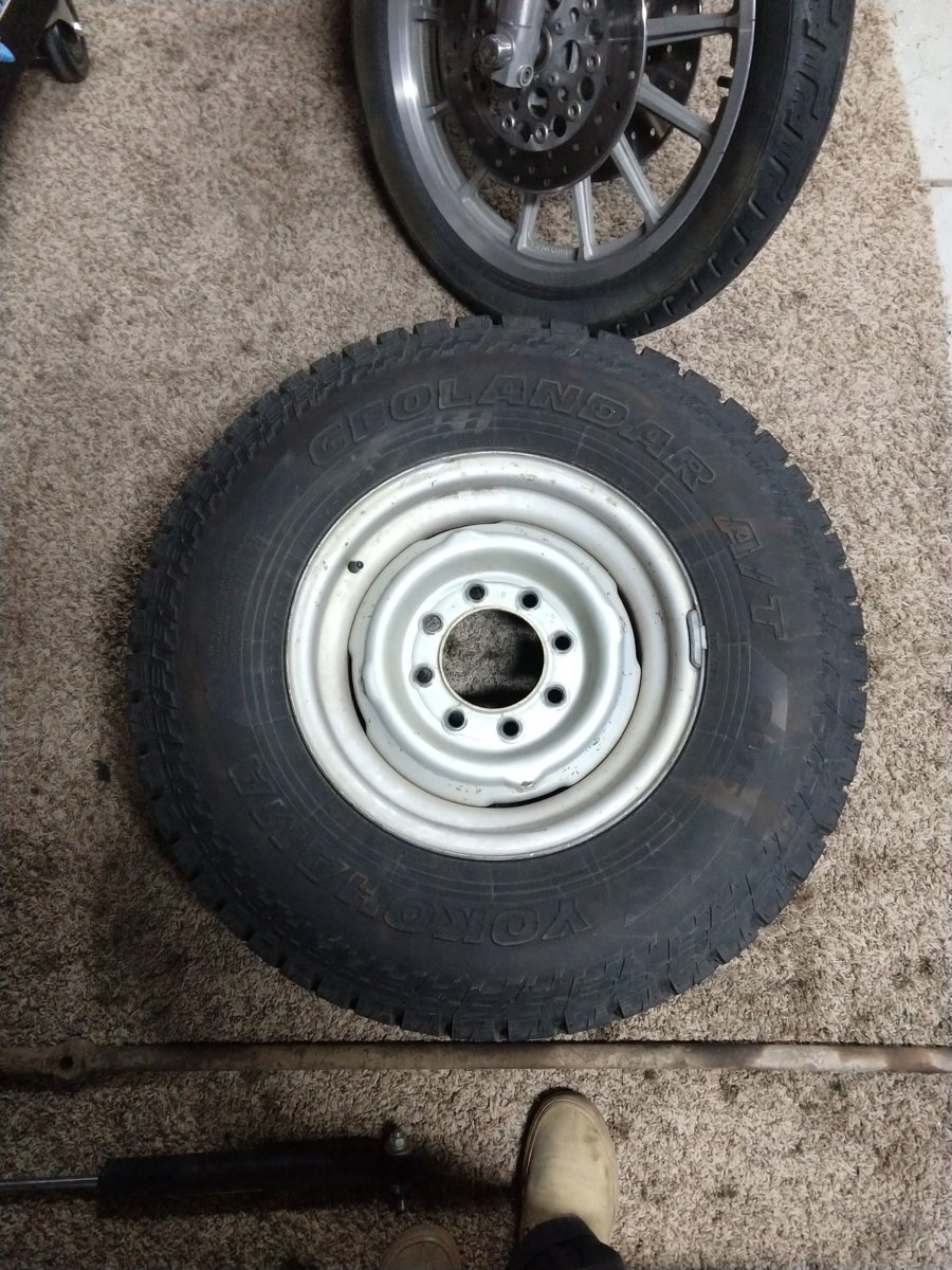

  1. I bought a new set of tires and wheels: https://ck5.com/forums/threads/yokohama-geolandar-a-t-g015.339999/
  2. I bought two kingpin kits from eBay: https://www.ebay.com/itm/361489252975
The wheels that I got recently are sort of a pale silver color:
I think I am going to run them as opposed to the original set of white wheels I got with the truck. It will be nice to have five matching wheels / tires and a full-size spare. No clue where I am going to put the spare though, aside from in the bed somewhere.
