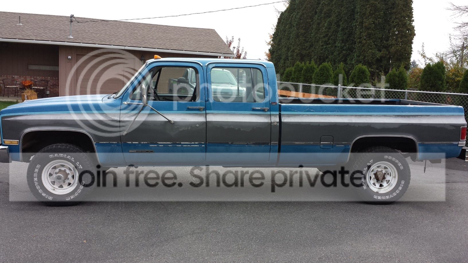

This thread is going to start off very slow but hopefully pick up steam in the next 6 months or so. I have liked the ideas of build threads to catalog what I do to rigs and also maybe give other people ideas on their own stuff. So here we go....
Right now I currently have a 1996 K2500 extended cab pickup with the L29 7.4 liter Vortec 454, 4l80e, 14bff rear with 4.10 gears. Literally it is bone stock. I have been using it as a tow rig for my K5 for the last couple of years. It doesn't do too bad at all towing on flat or slight grades, but in CO we have some pretty big mountains to go over. On some of the bigger passes I have a hard time even keeping up with the loaded down semi's. It hasn't been too bad and I have just dealt with it, but recently I had my 3rd boy and with just the extended cab with no door access to the back seat, it was starting to get really annoying.
So, like most people I started to look at 3/4 and 1 ton crew cab pickups, both gas and diesel in all makes. I quickly found out how freaking rediculous this truck market is right now. The prices are so overpriced in my opinion. The more I was looking at these trucks the more pissed off I was getting. After talking with my brother he told me to get into the medium duty semi market (as he just did). If I had some property I would do this in a hearbeat but as that is not in the foreseable future, a crew cab pickup is really what I needed.
Then I got the idea of just building my own tow rig how I want it. I have seen some guys use the older square body crew cab 1 tons as tow rigs and thought they were some of the coolest tow rigs I have ever seen. So I was on the hunt for one. In CO, even for 2wd versions, in SRW or DRW guys are wanting a lot for these. I started looking on the forum sites too and happen to find a guy here on CK5 with a 1989 V3500 Crew Cab that was 100% rust free with a TBI 350, TH400, NP205, 14bff, d60, and 4.10 gears. He was priced right in my opinion for the truck....but the only problem was it is in the state of Washington. I just so happened to talk to my brother who lives in WA who said he would be willing to go pick it up for me and keep it at his house until we arrange to get it back to CO for me....I was sold!

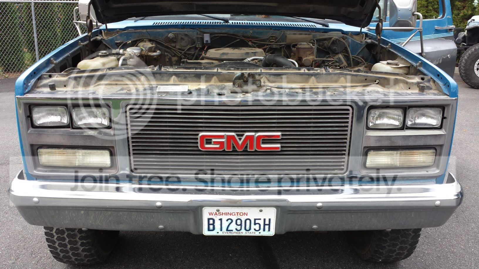

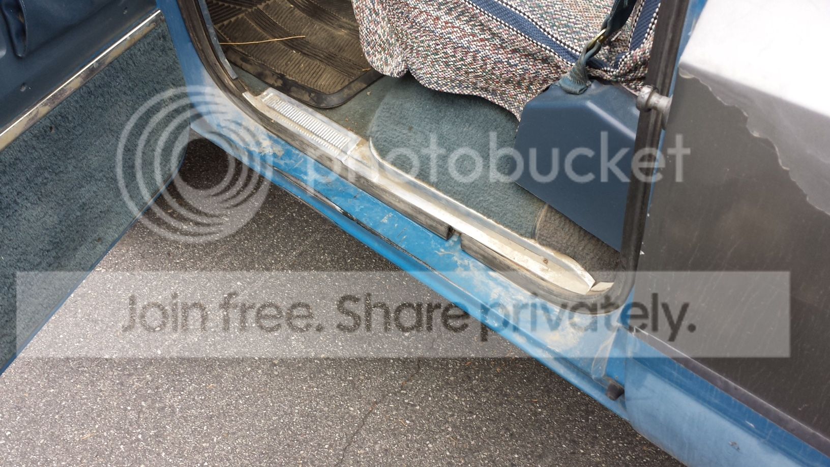

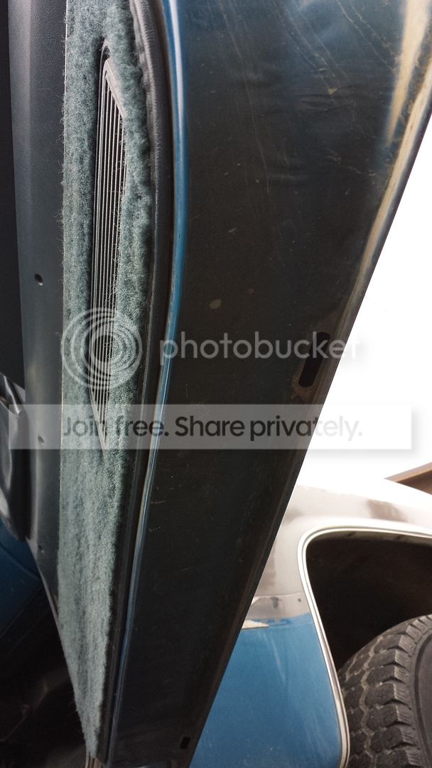

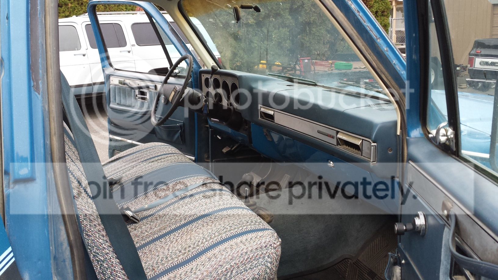

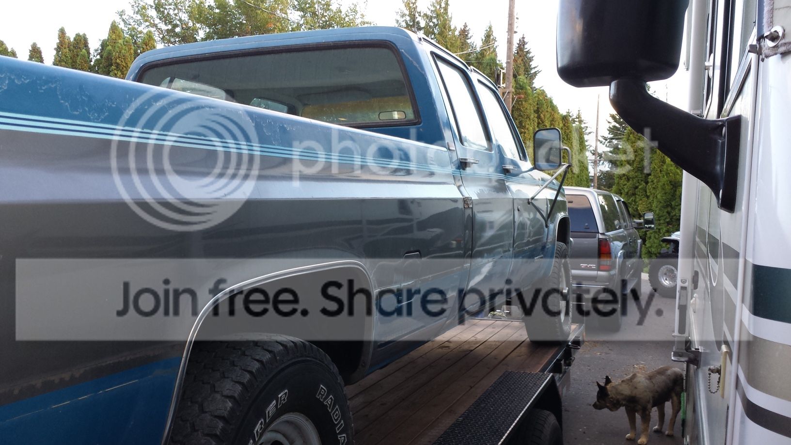

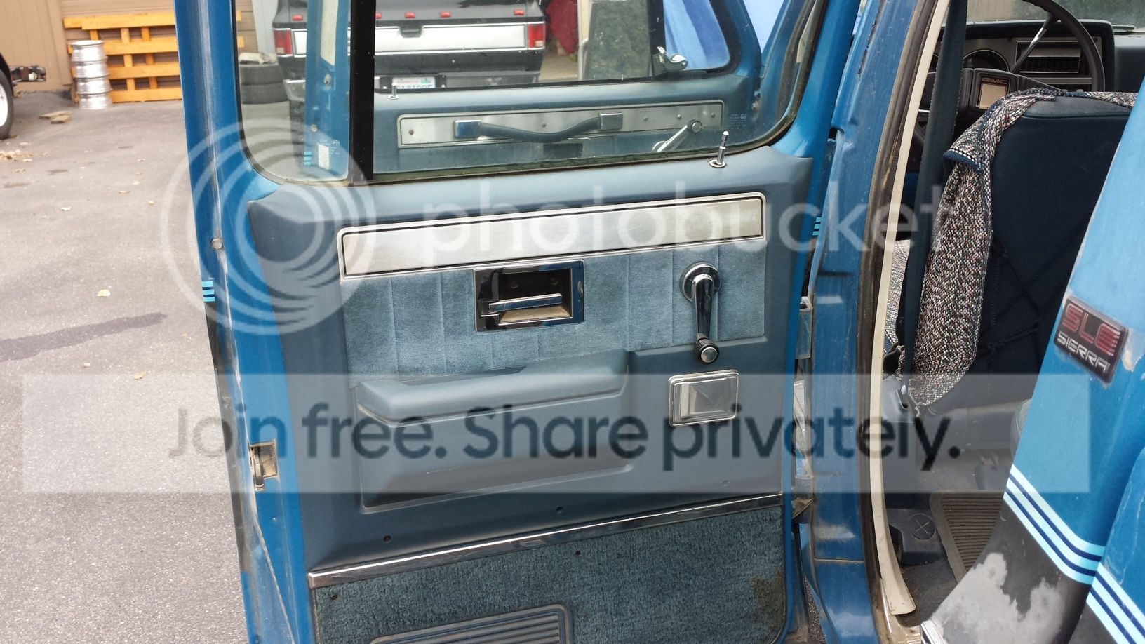

So as of right now, these are some of the pics I have of it from the seller. It is at my brothers house and we are working on possibly next month getting this thing back to my house so I can start this...

So, what my plans are for this truck is first off, get it back to CO. I want this to be a really clean, dependable, nice tow rig. I am by no means making this into a show truck (that's not my style). I believe you either make a show rig/car, or you plan to use them. This thing is going to get used. I want to purchase a cab-over in-bed camper to put on this thing along with towing my K5 and go camping/wheeling with my family a lot.

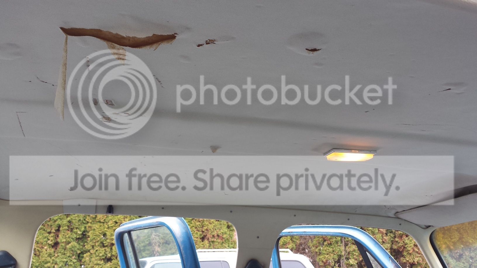

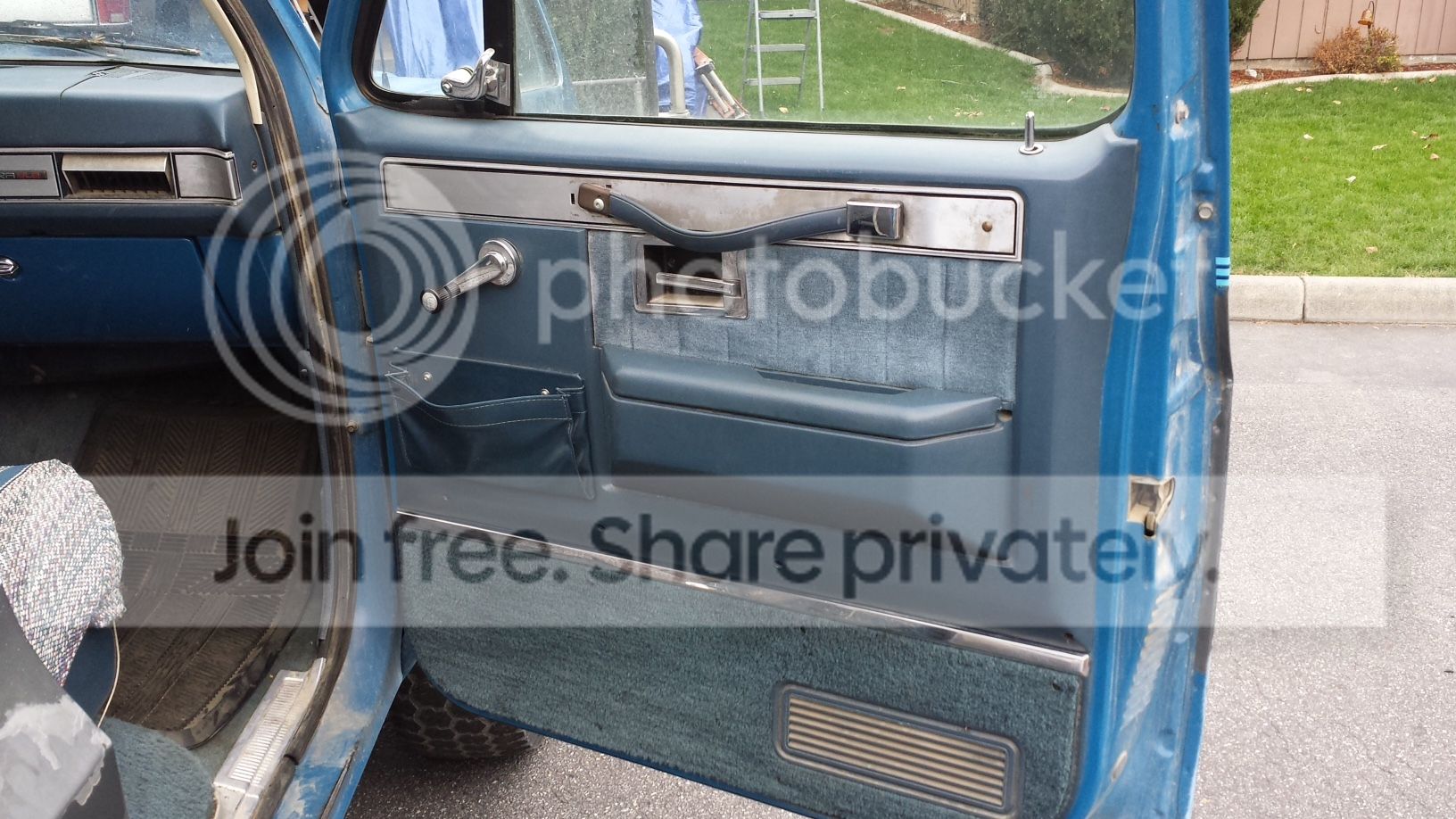

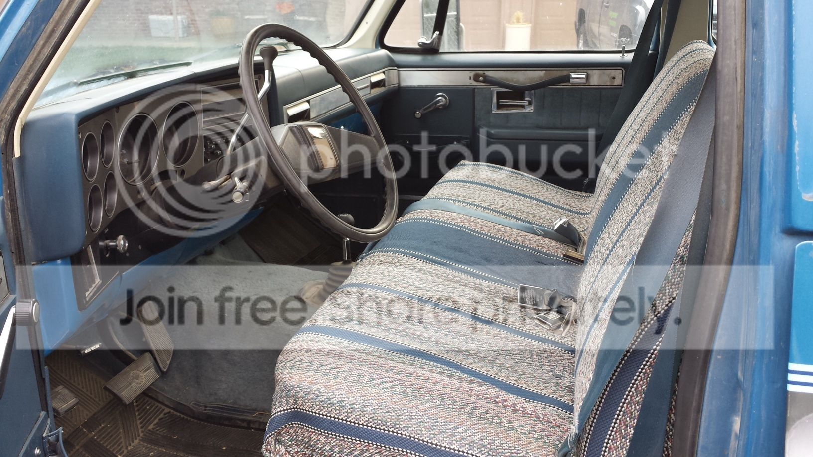

So I am first going to fresh'n up the interior. Clean the carpet or replace it, figure out the headliner situation, fix the dash, get some nice new seat covers...and overall just make it a very nice rig to ride in. As far as exterior, as you can tell it is really, really clean. I just want to paint it a straight blue (no two tone) with a couple coats of clear on it. Does not need to be perfect, but I would like for it to look real nice from 10-15 ft away. I may throw a small lift on it (2" or so) or maybe just leave the stance as it is and throw just a little bit bigger tire on it, remember this is going to be a tow rig.

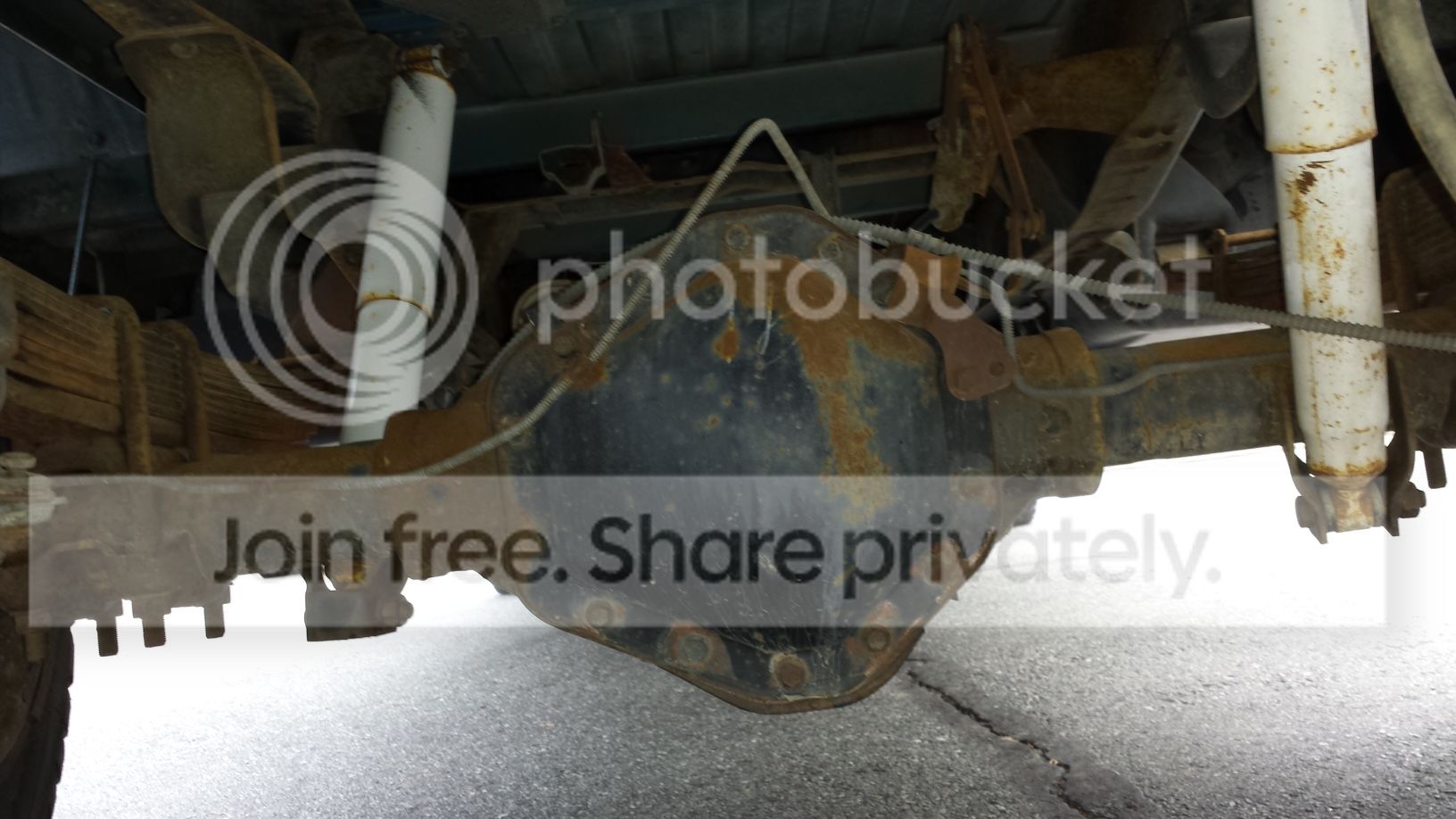

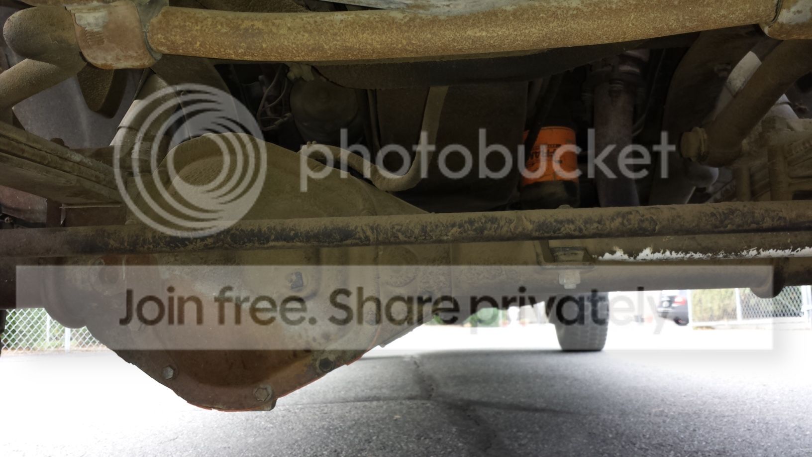

Then, as far as drivetrain goes, I want to just fresh'n up the axles, change seals and bearings/kingpin bushings and so forth. And as far as motor, that TBI 350 ain't gonna do it. So I plan to swap in a L18 8.1 liter motor into it. I thought about a 6bt swap, but I really want to keep this thing a gas motor and keep it GM. Plus, the more research I do about the 8.1 the more I freaking love that motor. I know with a good tune I could get close to 400hp and 500 ft lbs which is plenty that I want/need for what I am gonna do. I have not 100% decided on a tranny swap yet. Having either a 4l80e or Allison overdrive would be really nice, but the TH400 shifts really good in it right now. Still a little torn on it. If anyone has some real-world advice on this, please chime in!
Like I said, I just purchased this rig and don't plan on any crazy mods at the moment. I need to either find the motor or a donor vehicle before the motor swap will happen, so first on the list is making it pretty. Anywho....that's what I got, let me know what you think!

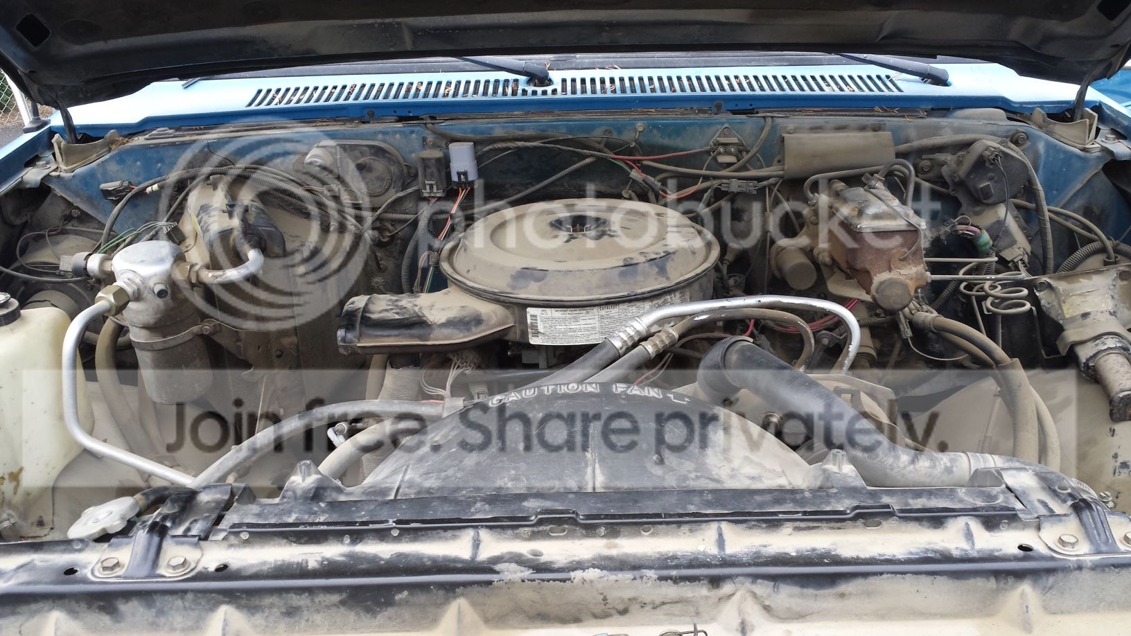

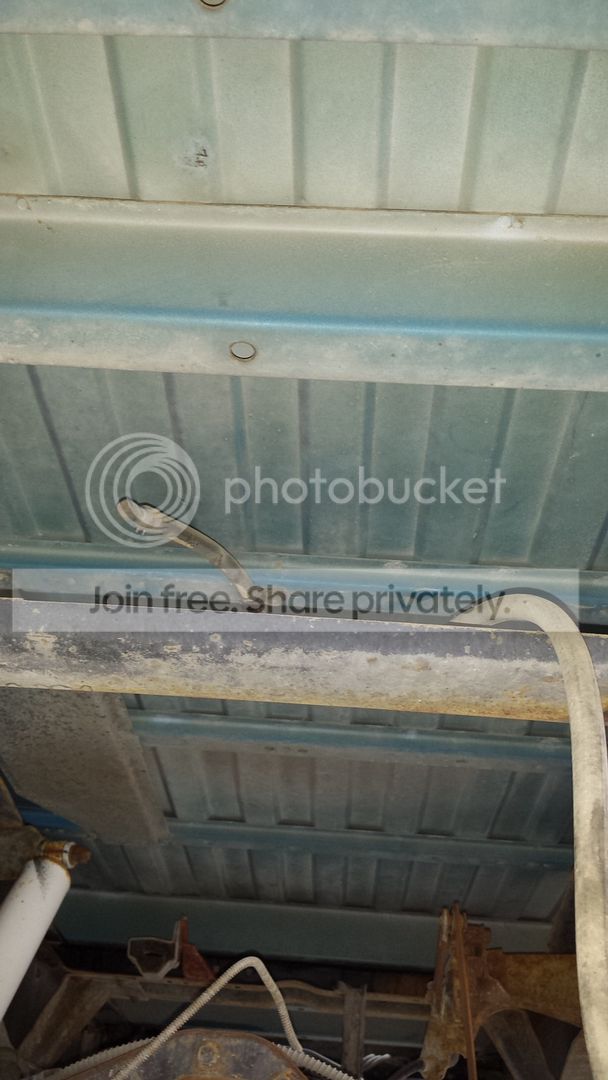

Oh, I forgot to add in it's current state right now, the motor is not running worth a crap. My brother said it has a hard time starting (takes a while cranking before it will finally fire), once it is running it will idle just fine but once you try to give it some gas it has a horrible hesitation. He is thinking it may be the intermediate hose on the fuel pump (hose that connects the pump to the fuel line). I may try and at least get it running ok to allow the truck to be mobile while I search for a motor, cause I am not sure how long it is going to take me to find the right deal on that. So we will see.
But once he had it running he said the TH400 was shifting just fine. It had the feeling like someone installed a shift kit in it as the shifts were a little deeper and firmer than stock. The NP205 shifts good (as normal as most all 205's shift) and there are no unusual sounds or feelings from the d60 while in 4wd or anything that hints of death wobble. Steering column feels nice and tight though steering feels sluggish. This could be due to a power steering pump going out, or the fact that the front tires are at pretty low PSI, or both. Either way, the motor issue doesn't really bother me since I plan to swap an 8.1 liter...maybe it will just get me to getting on the swap earlier rather than later :)
FYI, for anyone reading this if you have a lead on a good 8.1, feel free to let me know, haha
