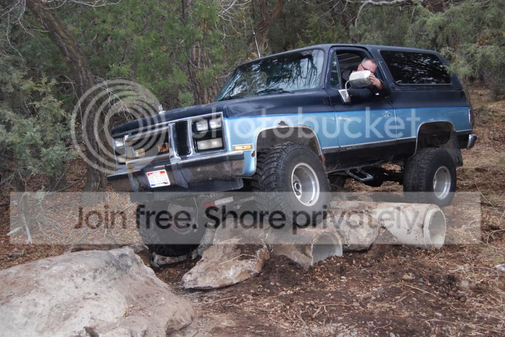

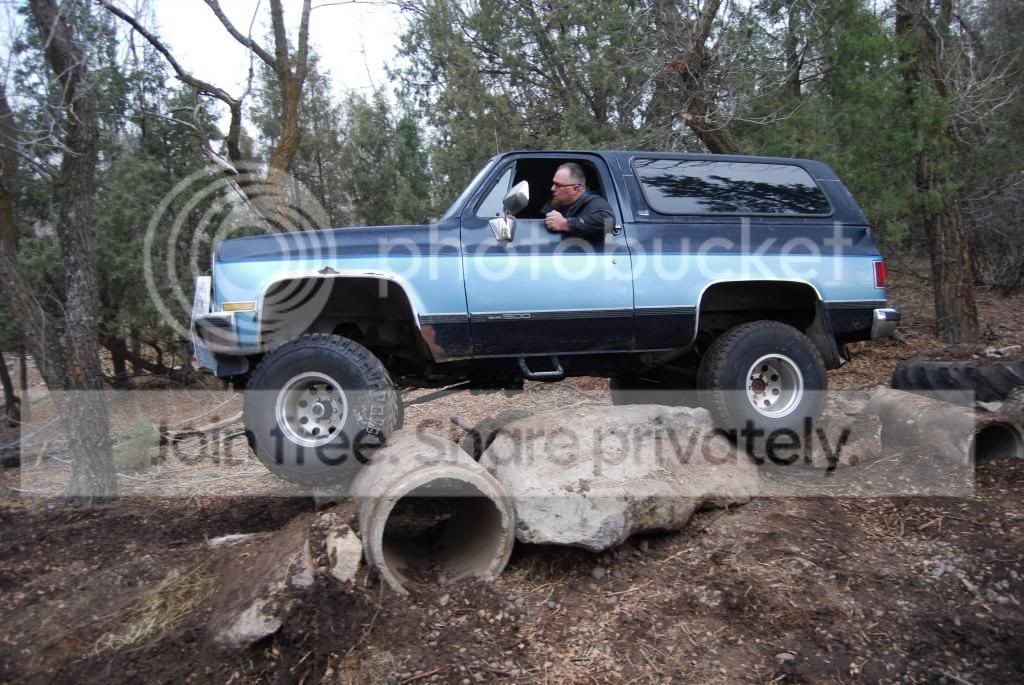

1989 Diesel Jimmy. What do we have here hmmmm
Building a little rock trail at my buddies Dads house.
Went out there today to try it in the Jimmy was fun.
Broke off my little side steps so its time to figure out some type of slider.
Doesn't flex too bad I suppose
