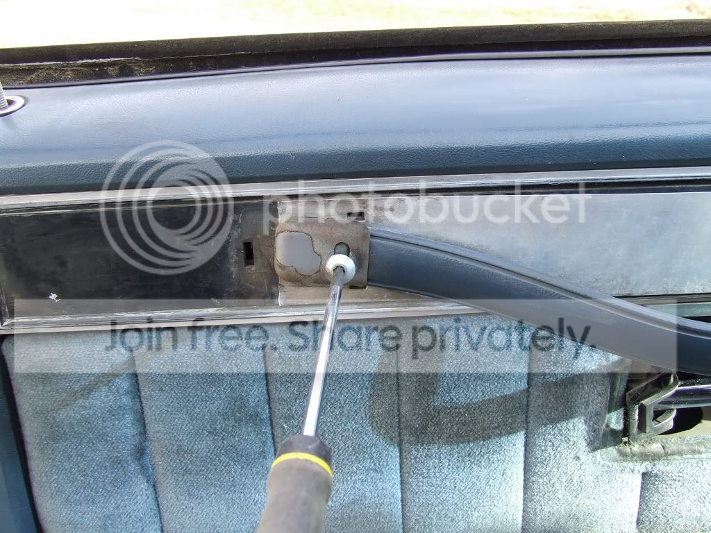

After all the screws are out plus you will need to give the panel a jolt upwards there are steel clips that hold it on the window opening. Like I said make sure you have everything off you need. Including the door pull handle bezel and the thing that threads onto the door lock.

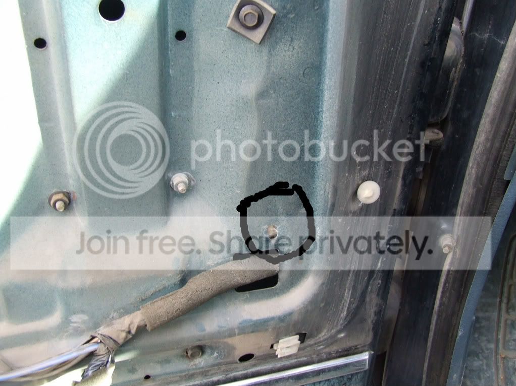

Once the panel is off remove the two screws that hold it in here is where one is the other one is down from it
There is also a bolt that holds the lower mount in it is already taken out

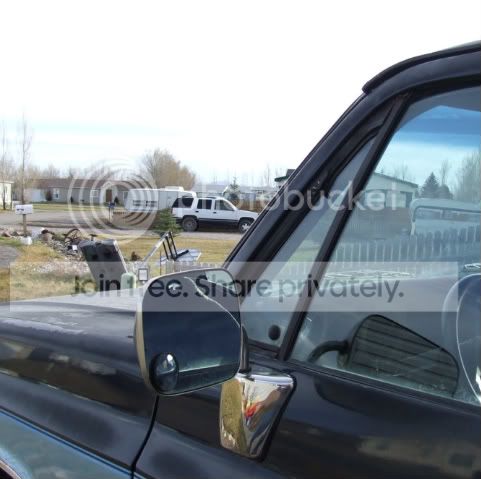

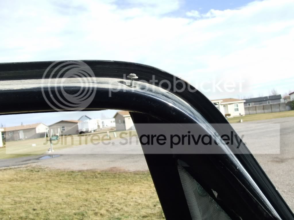

When taking the vent window out you will have to gently cajole it and twist it many ways. Be careful with it. Pealing back the window channel at the top of the window allows you more room at the top of the window which is needed. Pull it back and up look in the door panel and you will see where and how you will have to rotate it to get it out.
When putting it back in make sure the window glass is lined up with the channel that the vent window assembly has in it.
