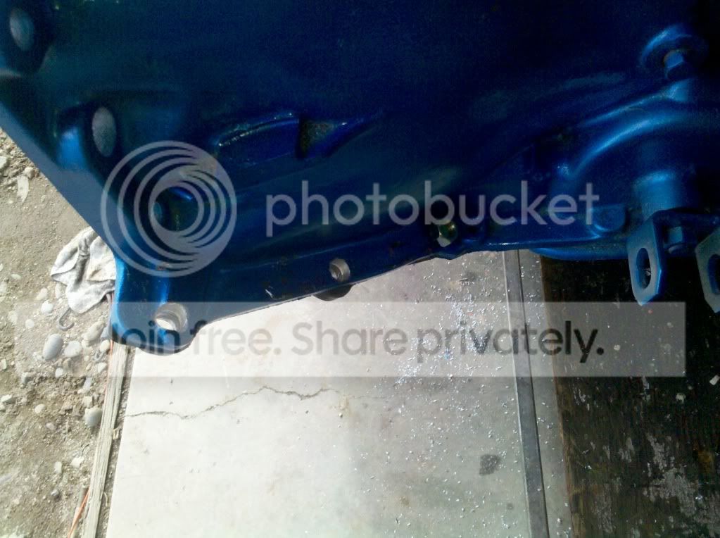

Couple of things went wrong overall. My old 700 (blown up one) has the thick flange and bolt holes for the nice lower cover. It still has the support rods that go forward to the frame.
I want to keep these but the new trans has a thinner casting down there. So since changing housings is not really in the cards right now. My plan is to drill the holes and make some small bars the backside to spread out the load.
Good idea? Bad idea? What thing ye? I think it will be fine and I actually plan to rebuild the other transmission but not for a while. I will be collecting parts to do so over the next year or so.

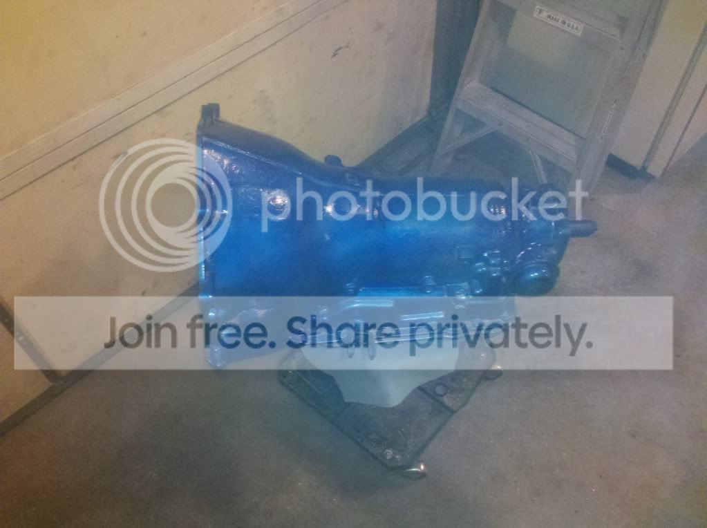

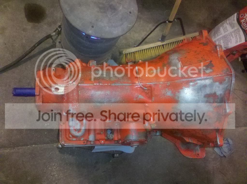

Anyhoo since the trans was orange before and this truck is not orange I painted the trans.
Obligatory pics
Before
After

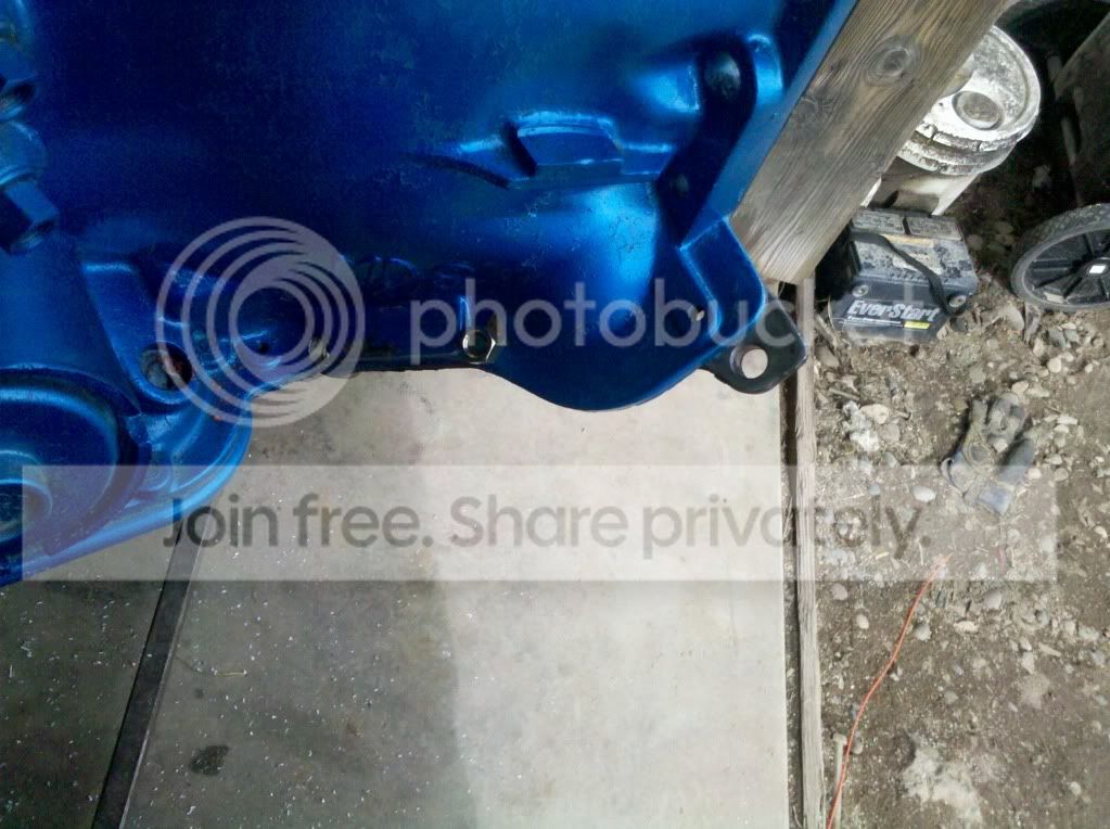

No opinions on drilling the holes in the thinner flange of the replacement trans?
For the thicker TQ cover should be fine, somebody else just did that in the garage. You will have to do bolts and nuts though.
Thats what I'm doing to Eric....my T400 has the thinner flange for the cover.
So weirdly enough my TC cover actually broke one of the top tabs off. Very top on the passengers side.
Oddly enough as I put everything up there this was the only hole that was way off. Like an inch to the side so I would not have been able to use it anyway.
Clamped the TC cover on and drilled away.
Here are the results
Passengers side with the tab I broke off in to show you can't really drill a hole for it

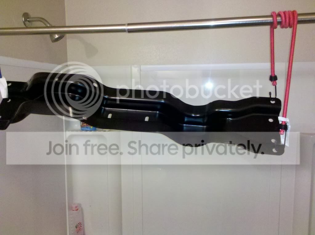

So I started cleaning stuff, crossmember clean and new paint
Front driveshaft is drying off. Cleaned and painted the adapter. Started scraping oil off the bottom of the body so I can repair what seems to be every single seat mounting point.

drying parts in the shower, I love it Eric!
You need some 2" DOM on some trussed and gussetted 2x4x3/16" framing.
You need to buy your wife a present, I would be dead if I tried that, dont you have a garage for that stuff :dunno:
The garage was cold!
I don't do if often but that is Baileys bathroom and it was only in there for one night (so far)
Going to have to take the driveshaft out of her tub to give her a bath tonight.
