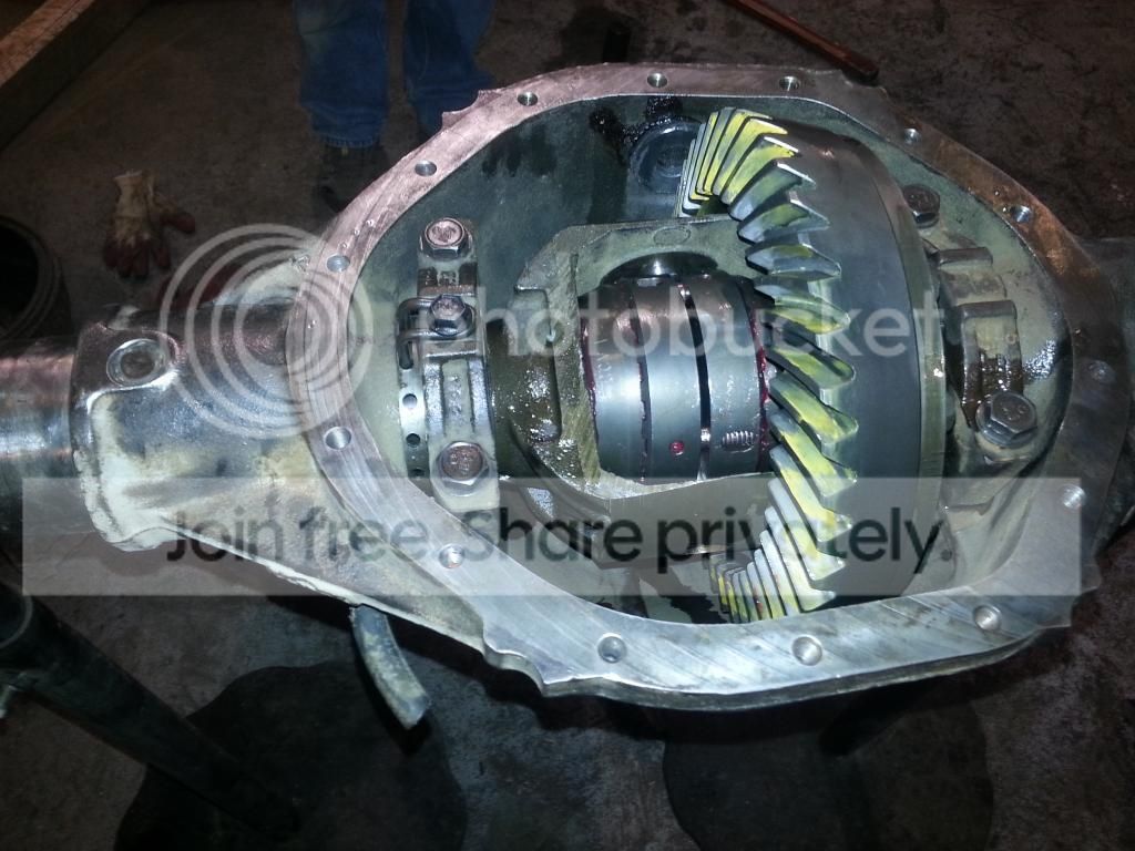

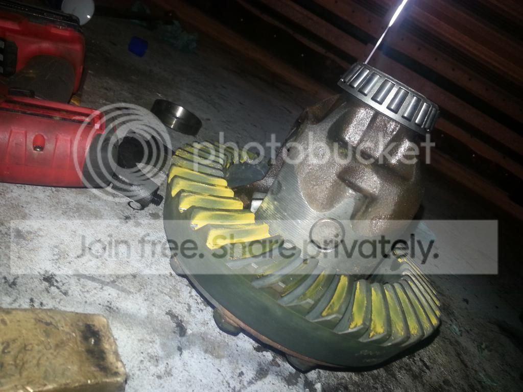

How's the locker and gearing combo working out for ya?
I kind of forgot how ummmm active loc rites are lol. It's great. I need to get the side gear shims replaced. They were worn so the locker acts a little weird sometimes. Gearing is lovely. At the 6300 ft elevation I live at nothing helps much other than a turbo.

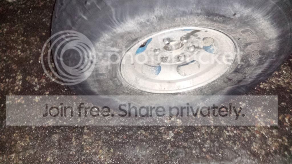

Any to bring this up to date. I broke down yesterday.
