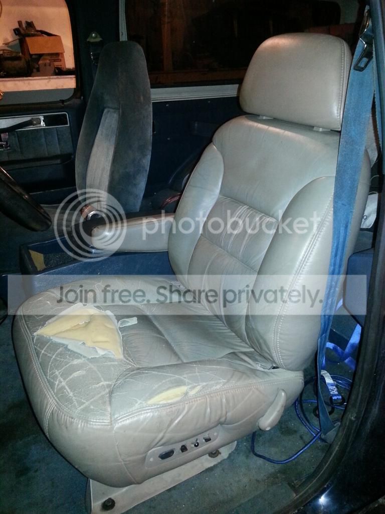

1989 Diesel Jimmy. What do we have here hmmmm
Seats will get recovered soon. I only put one in so my buddy could pull the other one apart and start making a pattern.

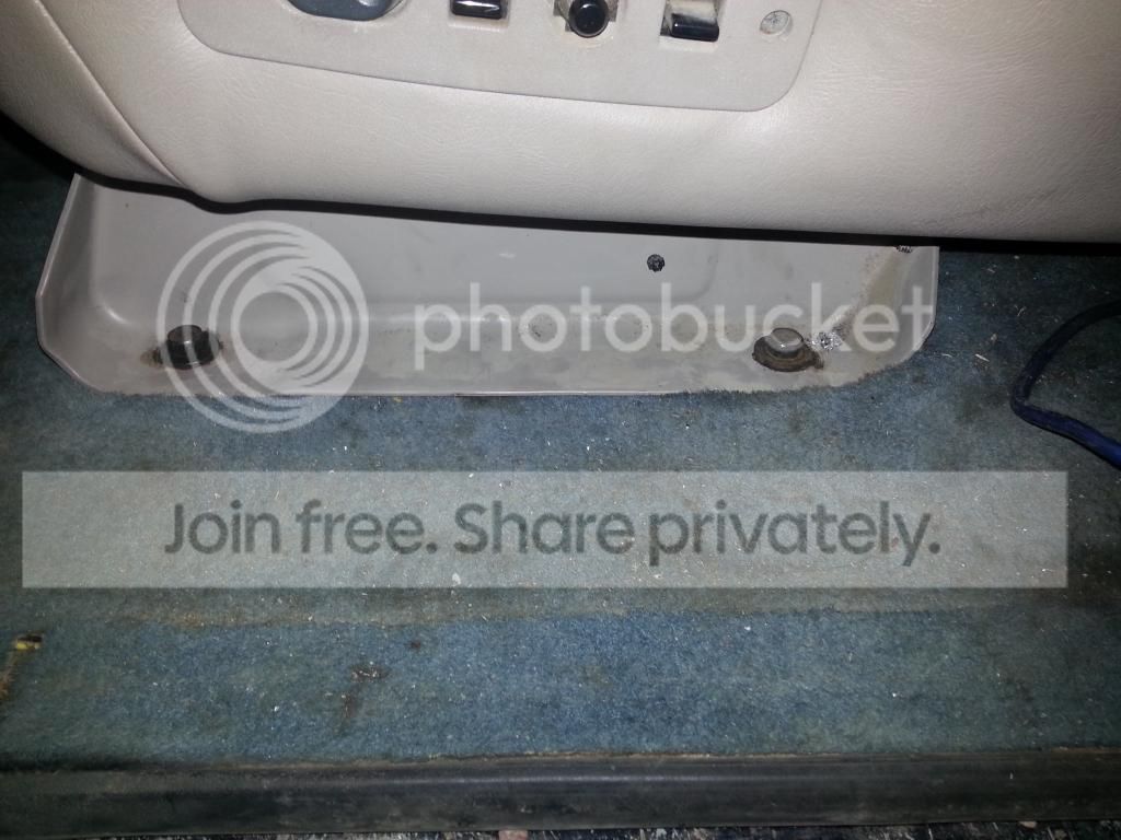

Out of an mid 90s burb slot one set of holes and they bolt in. Drivers seat will be power. Already made sure it works just gotta run one power wire

Nope when in good shspe I wouldn't change em. All the foam in that seat was broke down the cover was obliterated. I was riding on the steel frame of the seat. It failed on a 3 hour drive. My back still hurts.
This solution gets me a seat I don't mind and it will get recovered soon . All for the price of fabric. Oh and helping link cage and all that other cool stuff to a bronco
