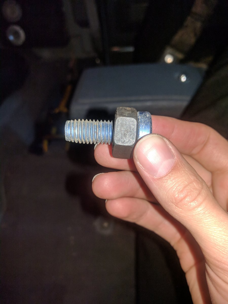

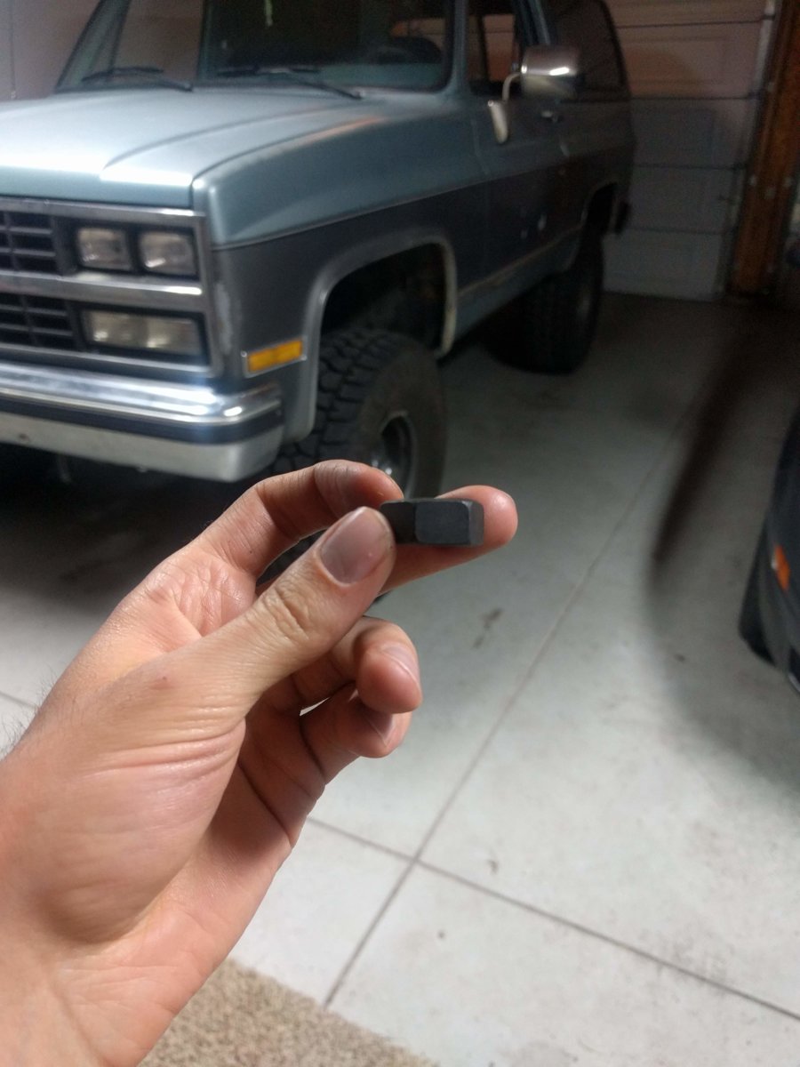

I only had a couple of washers available that would fit over the hex bolt, and they were pretty thin. So, I decided to improvise and use a substitute:
I had two nuts like this that were identical, so I decided to just go for it. The only thing that worried me was that there wasn't a whole bunch of thread left for the bolt to bite with:

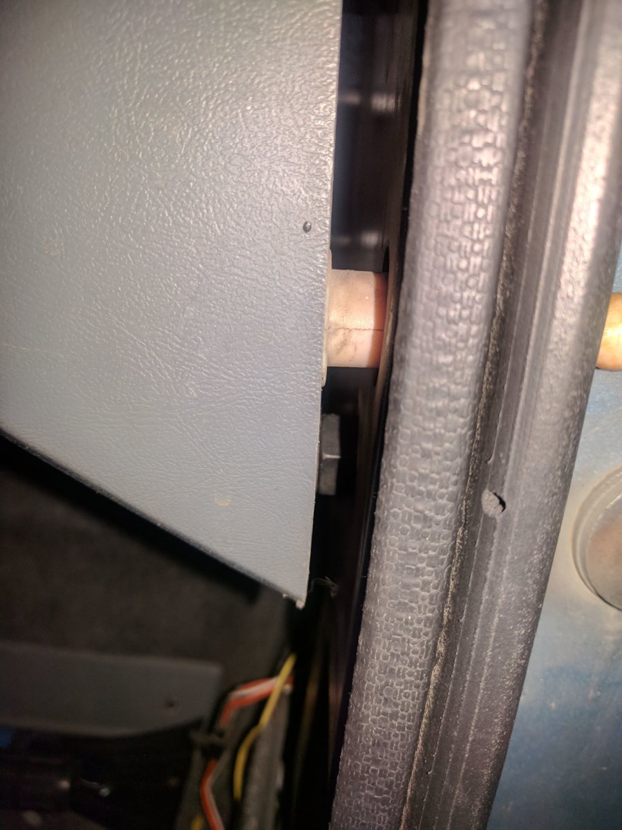

Here's how it looks installed, pretty goofy:
I took the Blazer for a test drive and the seatbelt retracted perfectly. I am so happy, my night is seriously made. The seatbelt not retracting was driving me up a wall.

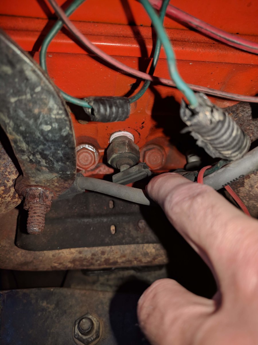

ESC Sensor

The Haynes manual says basically one of two things could be happening:
  1. Failure of the ESC knock sensor signal or loss of ground at the ESC module will cause the signal to the ECM to remain high. This condition will result in the ECM controlling the EST as if no spark knock is occurring. Therefore, no retard will occur and spark knock may become severe under heavy engine load conditions. At this point, the ECM will set a Code 43.
  2. Loss of the ESC signal to the ECM will cause the ECM to constantly retard the timing. This will result in sluggish performance and cause the ECM to set a Code 43.
With how sluggish my truck felt, I am guessing that #2 is what is going on. Loss of ESC signal to the ECM. I am really hoping that my wiring isn't messed up. What would you guys do in this situation?

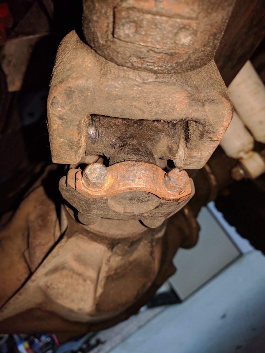

First off, I tried checking out my driveshaft u-joints for play. I used a YouTube video (below) for guidance. It's a Jeep video but I thought a lot of it looked the same.
Jeep video on u-joints:

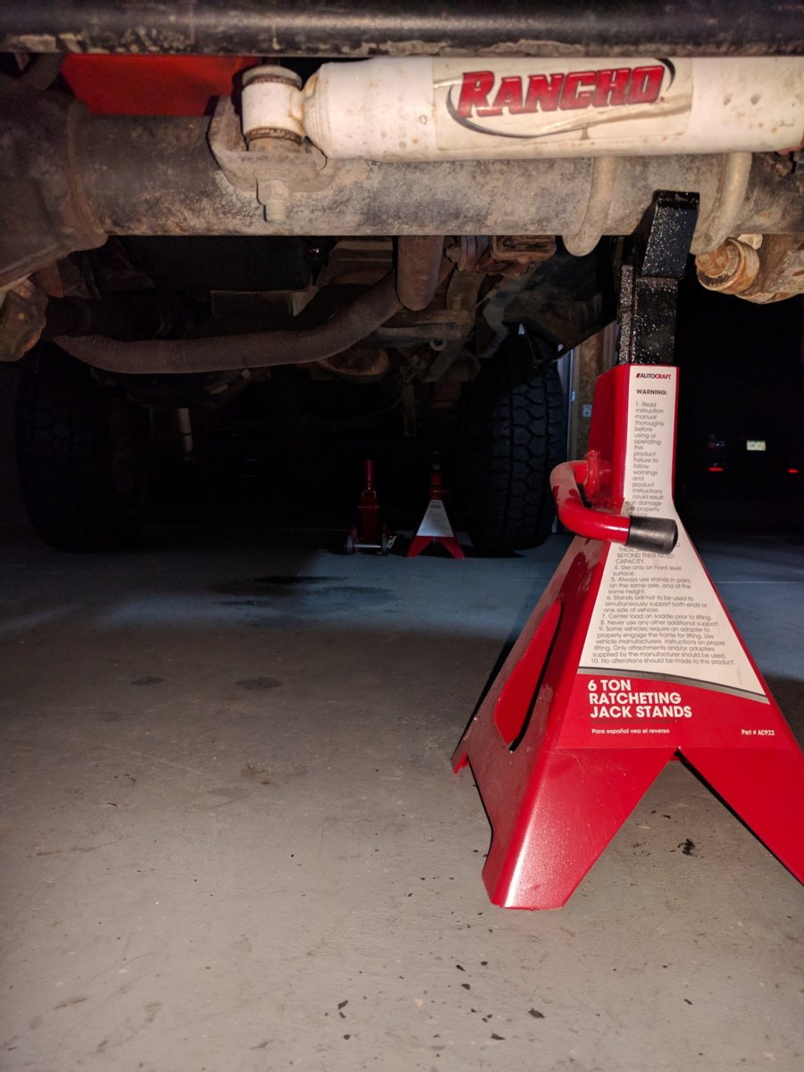

Embarrassingly, this was the first time I tried jacking the Blazer up since I bought it on June 15 of last year:
I snapped a couple of photos of my front driveshaft u-joints. Both feel pretty good. I couldn't feel any play in them at all.
Front DS Pumpkin side:
Front DS T-Case side:

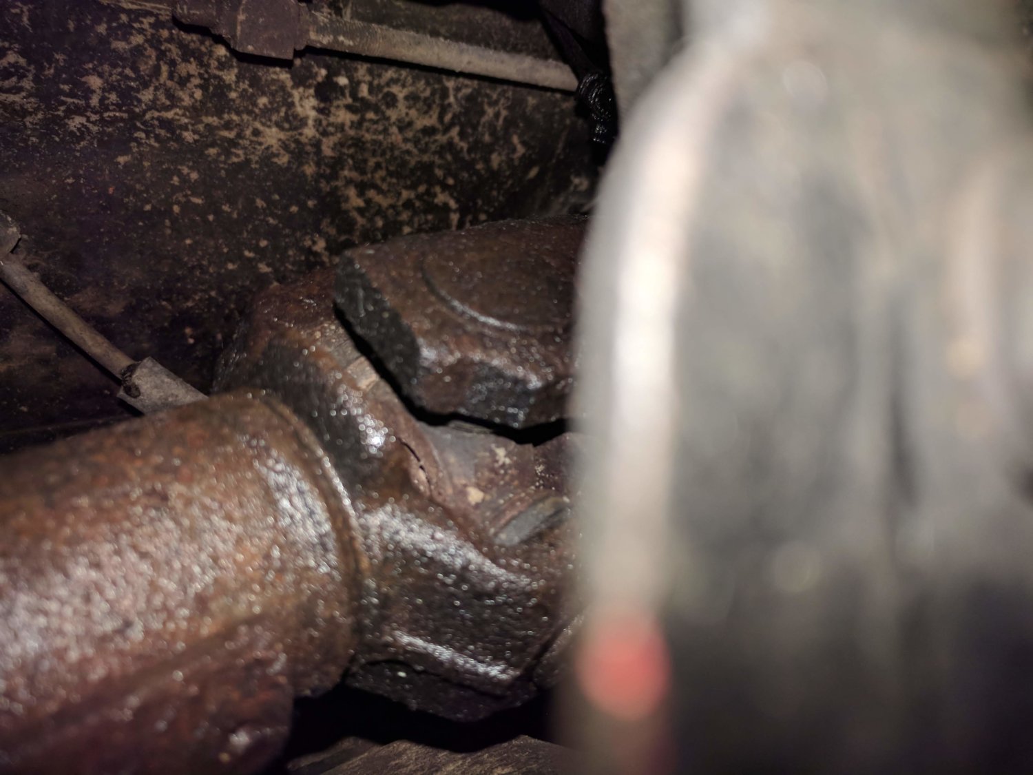

When I moved to the back side, I had a hard time figuring out if the play I felt was in the u-joints or somewhere else. I shot a couple of videos if anybody is interested in hearing how little I know about this stuff... :doah:
Rear DS T-Case side:
Rear DS Pumpkin side:

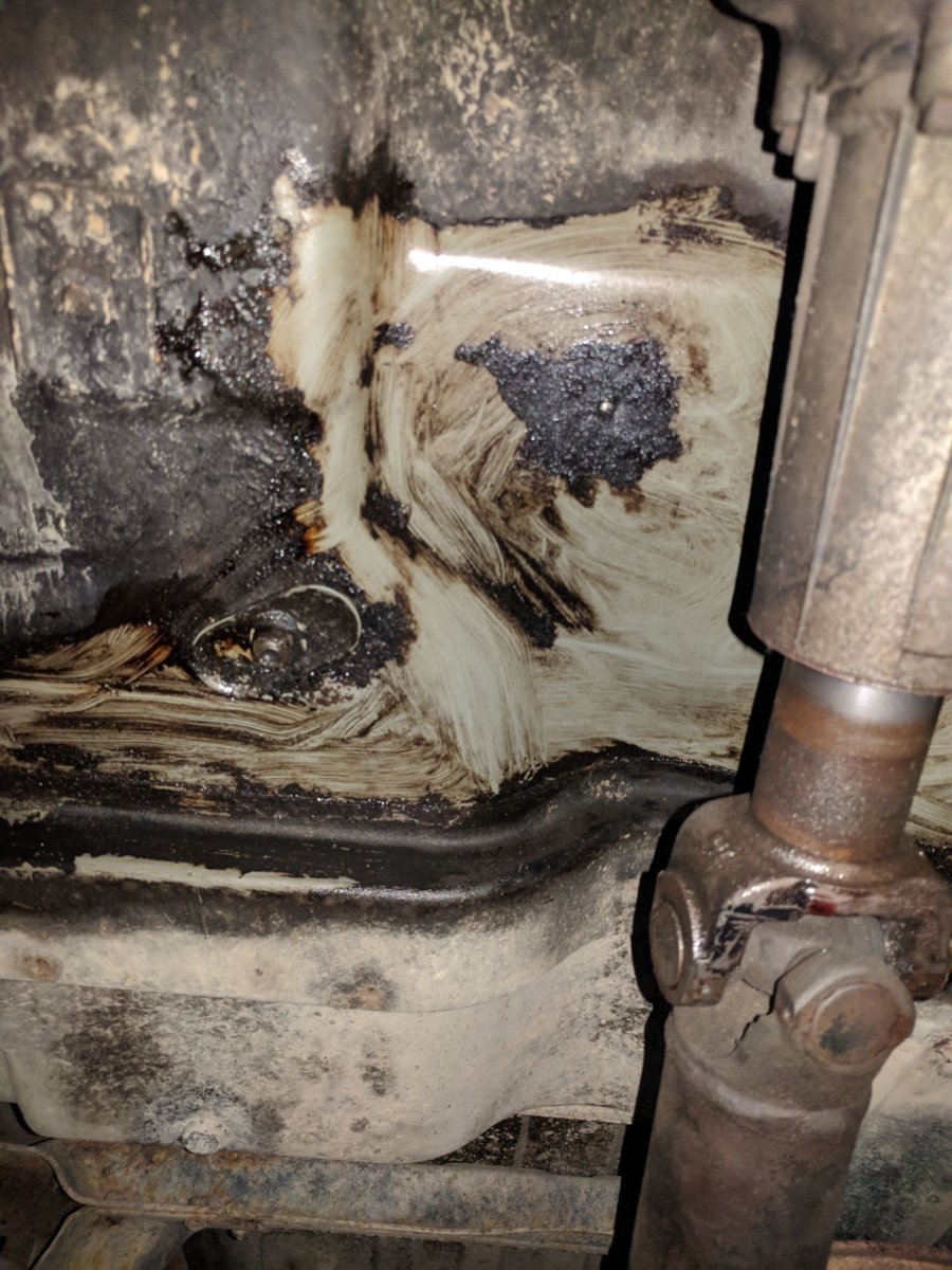

While I was under the t-case area I noticed a lot of black moisture / sludge. I am hoping that it isn't a big deal but I shot another video to show you all how widespread it is. It's too big for CK5 but I'll link it below.
Photo of sludge after wiping it with a shop rag:
Video of sludge area:

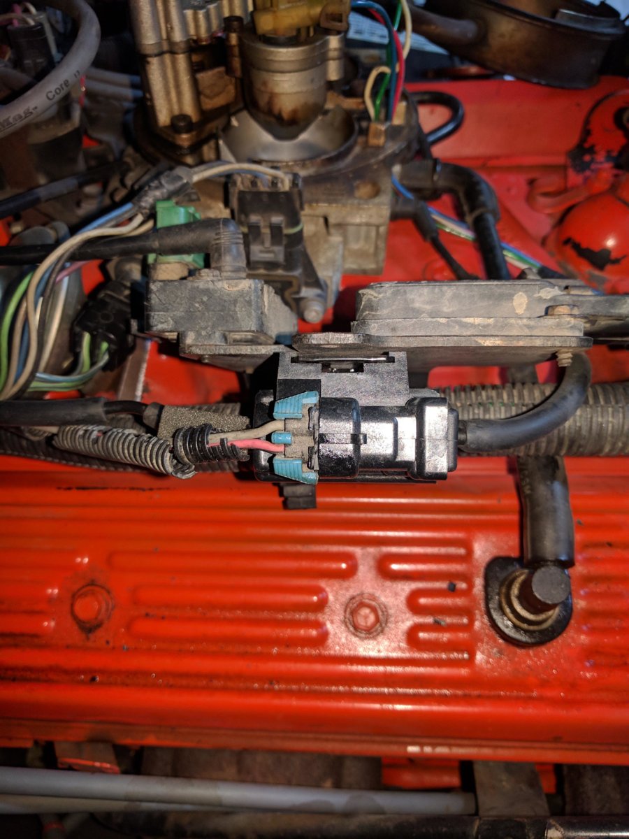

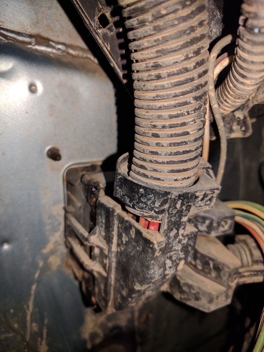

Finally, I tried figuring out my code 32 thing. I shot a photo of what I think is the EGR solenoid connection. The clip is broken off and before I took the photo it was wrapped in electrical tape.
EGR solenoid connection:
I also shot a video of spraying carb / choke cleaner around my vacuum lines. I didn't hear the engine change RPM much at all save for one line that went over to my charcoal canister. I think it's called the purge hose. That video is also too large for CK5 but it's below if anybody is interested. The engine sound changes at 0:53 and 1:16.
Purge hose choke cleaner video:
The oil around your t-case is probably the seal for your driveshaft slip joint. Pretty common spot to leak. If you pull out your driveshaft, you can install a new seal. When you pull the driveshaft out, t-case oil will come out a bit so don't be surprised. Once reinstalled, check your t-case fluid level and top off.
Thanks. I probably should get around to doing that sooner rather than later...
Also, I was thinking about my EGR stuff earlier this morning. Does anybody know what causes the EGR to close once it is open? It feels like my EGR opens just fine, but then doesn't close when it is supposed to. As a result, more exhaust gas makes it into the intake manifold than is ideal and therefore my engine gets starved of oxygen. Just my guess at this point.
I would just replace the egr valve if it is suspect. There is a spring inside of it that should close it.
