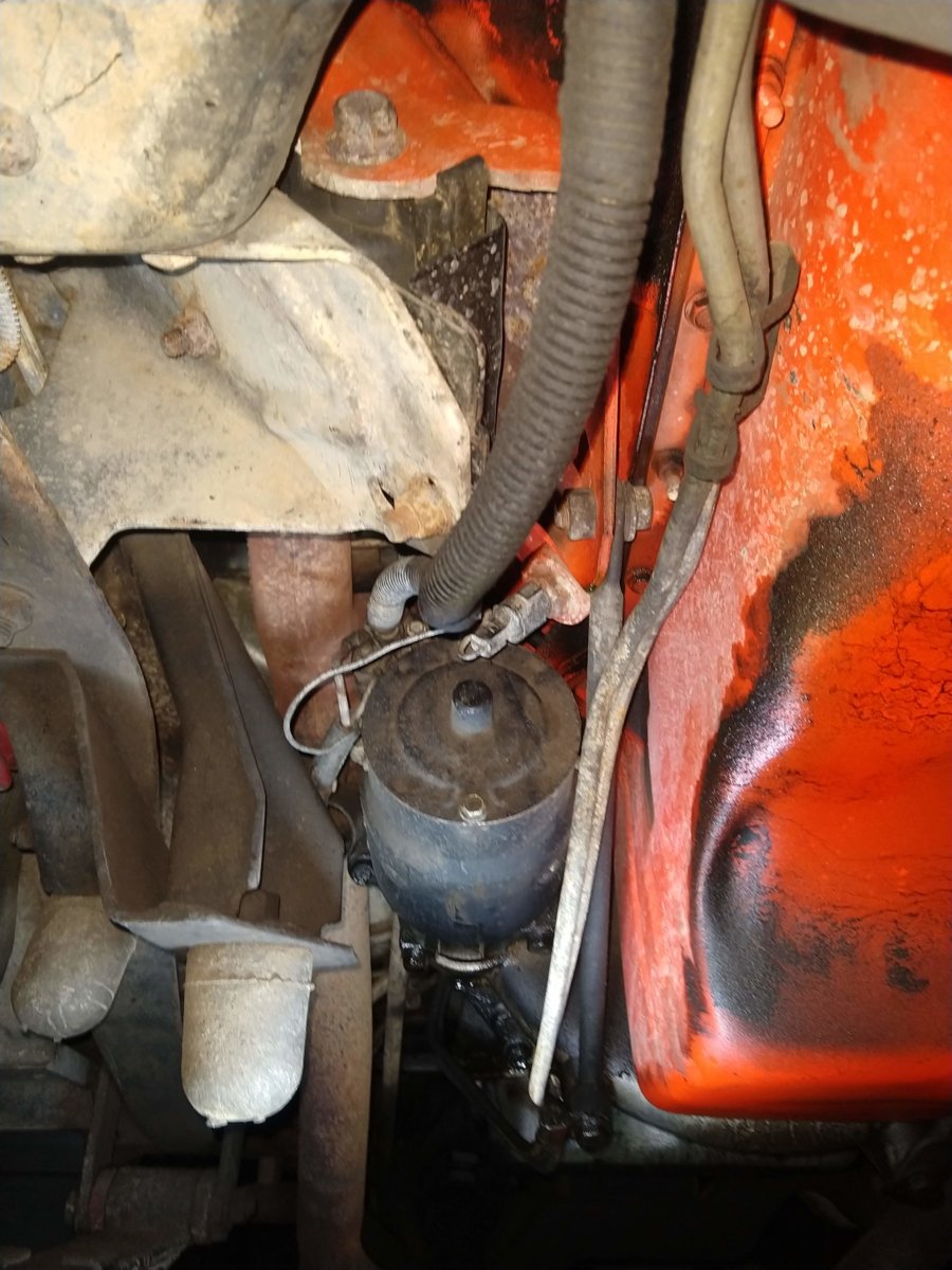

I drove the truck to my buddy's house to go snowboarding on Sunday. When we got back from the hill and I fired it up to go home, I smelled something burning from inside the cab. I popped the hood and didn't see anything obvious, but it was dark at that time. Today I decided to drive it again thinking the smell could have been a one-off. Nope, smelled it again. Shut her off and took my other ride.
Where would you all look first? I can't describe it any better than a burning smell, but it is strong. I was guessing I'd check out the starter first.
Burning leaves is the closest I can answer.
So maybe electrical
See anything hanging out too close to the starter?
Did you ever see any smoke?
Probably dead rat in the heater box
I didn't see any smoke at all! Aimee confirmed it smelled. If we shut off the heater inside the cab then the smell went away. Definitely something inside "the vents". I am guessing leaves or something got in there.
Could be the blower motor resistor. I'd look there if the smell went away if you shut it off.

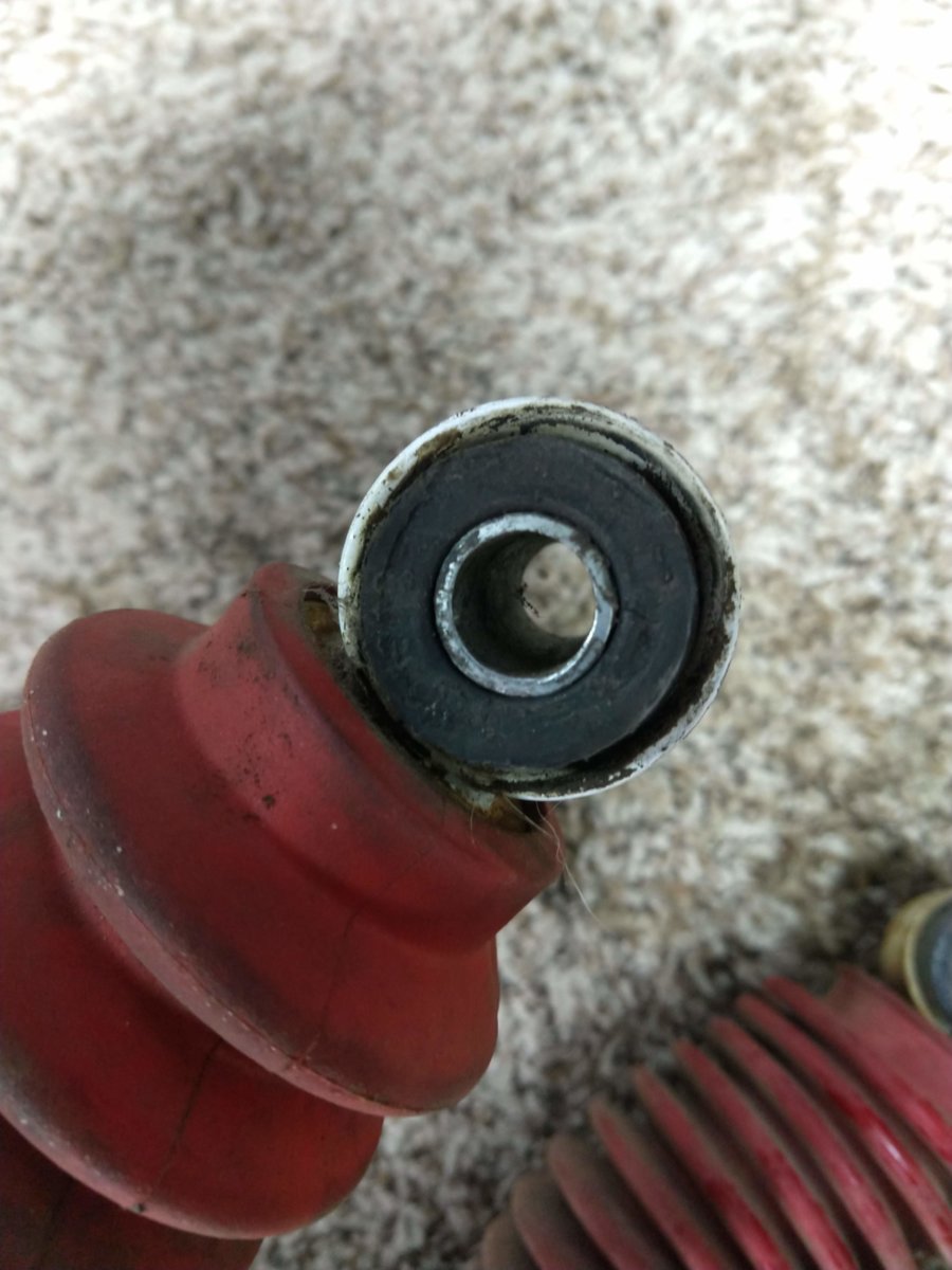

I also tried replacing my old shocks with the ones that @Justin V gave me a long time ago. Holy crap, my old shocks were indeed blown. They don't rebound at all once compressed. He called it forever ago, but I haven't gotten around to replacing the shocks until now. Thanks again for them, Justin!
One snag I did hit is that the new shocks have a metal shim inside the eyelets. My old shocks don't have this metal shim, and the new shock eyelets won't fit over my mounting hardware. I hope that I can just remove these metal shims from the new shocks so that I can get them onto my truck. I've attached some pics here, with the old on the left and the new on the right. Let me know if anybody has any thoughts or tips!
Pretty successful garage day today. Got my fuel filter replaced, made a mess doing that. Anybody know an easy way to get rid of old gasoline in Denver? lol
Yeah you can remove the sleeve
Probably a dumb question, but is there an easy / accepted way to do it? I was trying to hammer them out - they weren't budging!
It's in rubber beating on is not the easiest since it will bounce back.
A press is the easiest but you don't have that you can get a cheap manual one from harbor freight or Amazon
