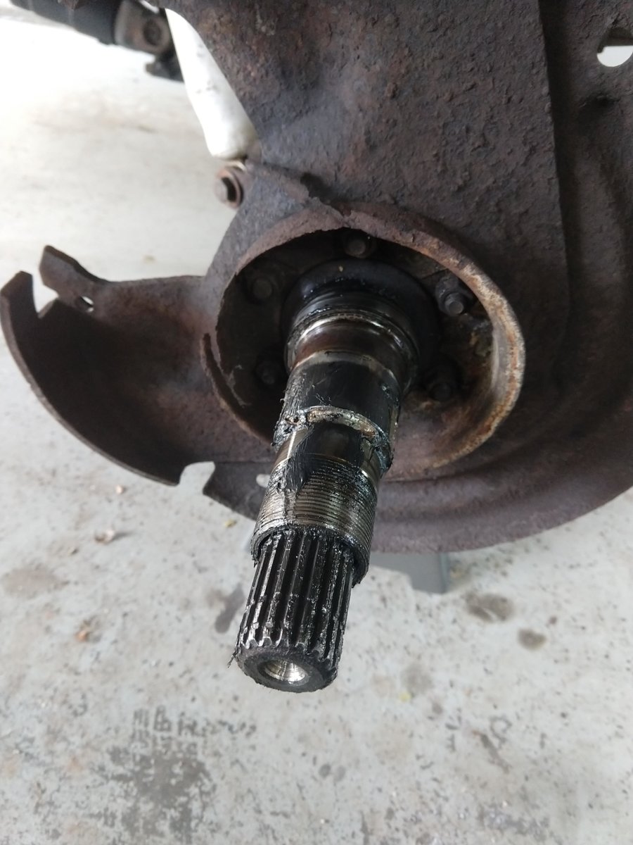

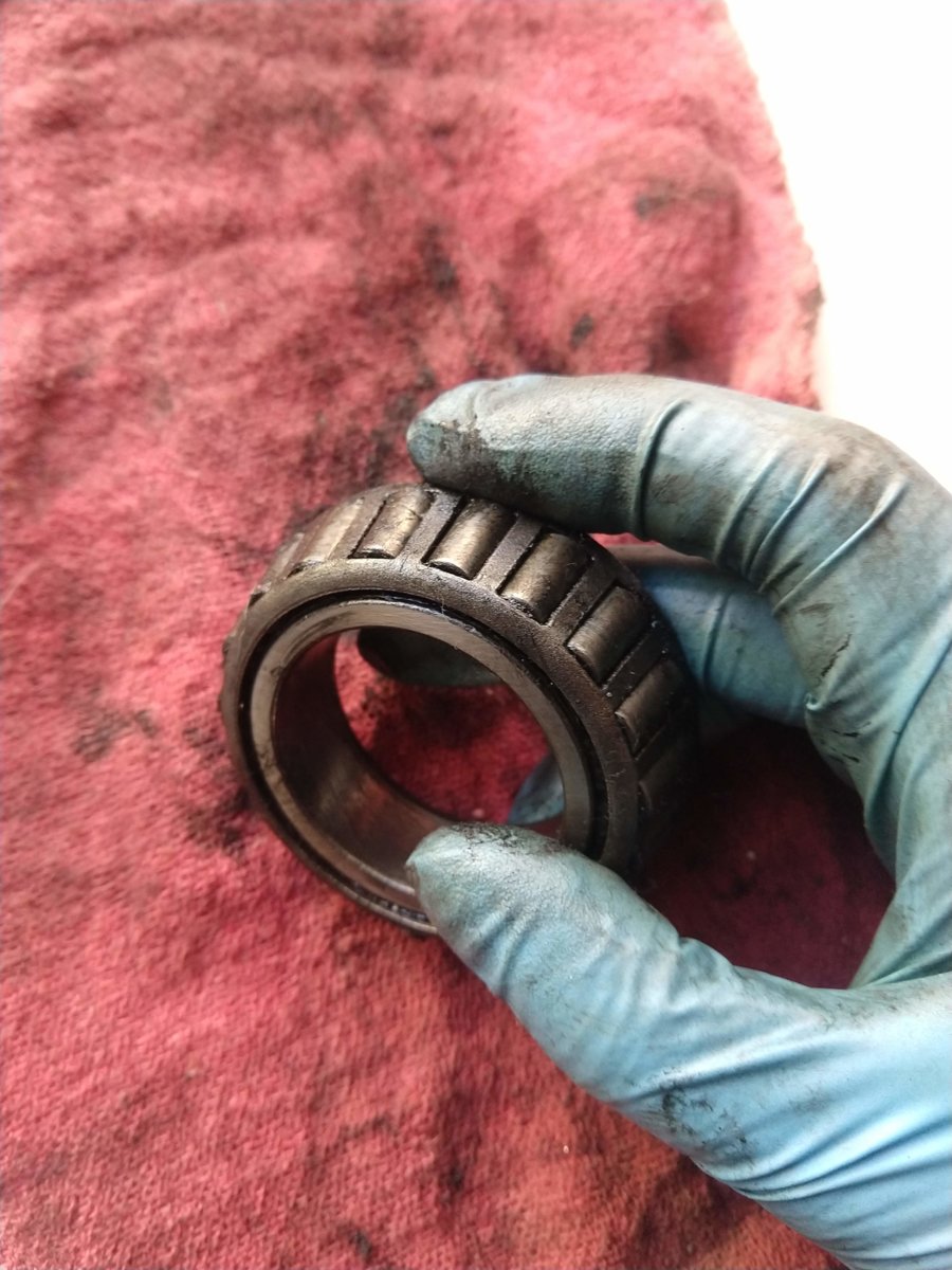

Demo is complete on both sides, and the wheel bearings are out:

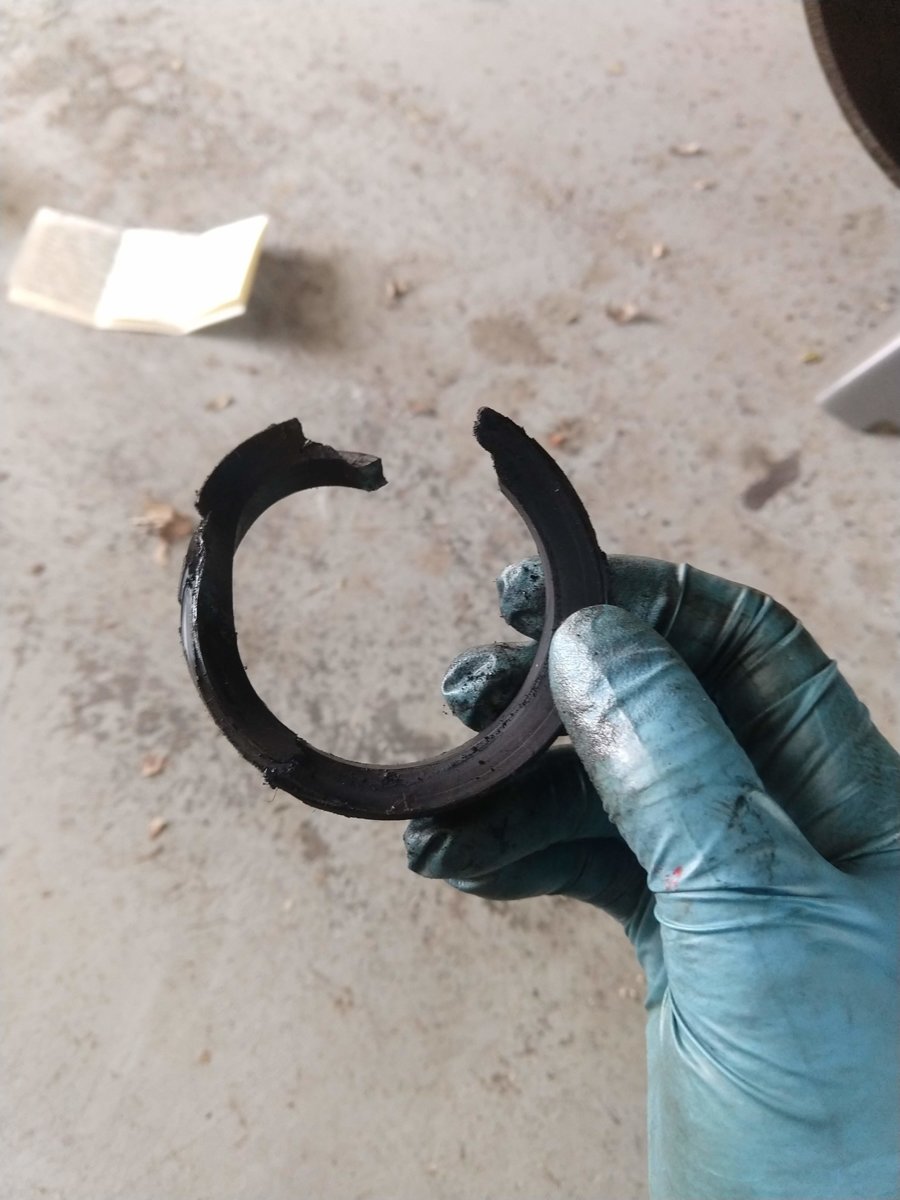

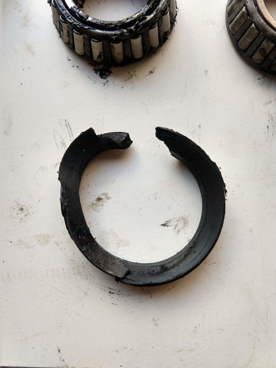

This rubber seal fell onto the floor at some point - perhaps when I was removing my passenger side hub:
Anybody know what it is called? Here is another photo:

That's the hub seal.
It's done but I usually change it anytime I change bearings.
Is that the original axle?
Almost looks like a small bearing spindle from an early d44 in the picture.
Might be a bad picture.
Thanks, @imiceman44. I appreciate it. I am honestly not sure if it is the original axle or not.
I took a look online... couldn't find just that seal on AutoZone's website. I did find this kit that looks to have the seal I need:
https://www.autozone.com/suspension...front/duralast-wheel-seal-sbk1/12299_747966_0
