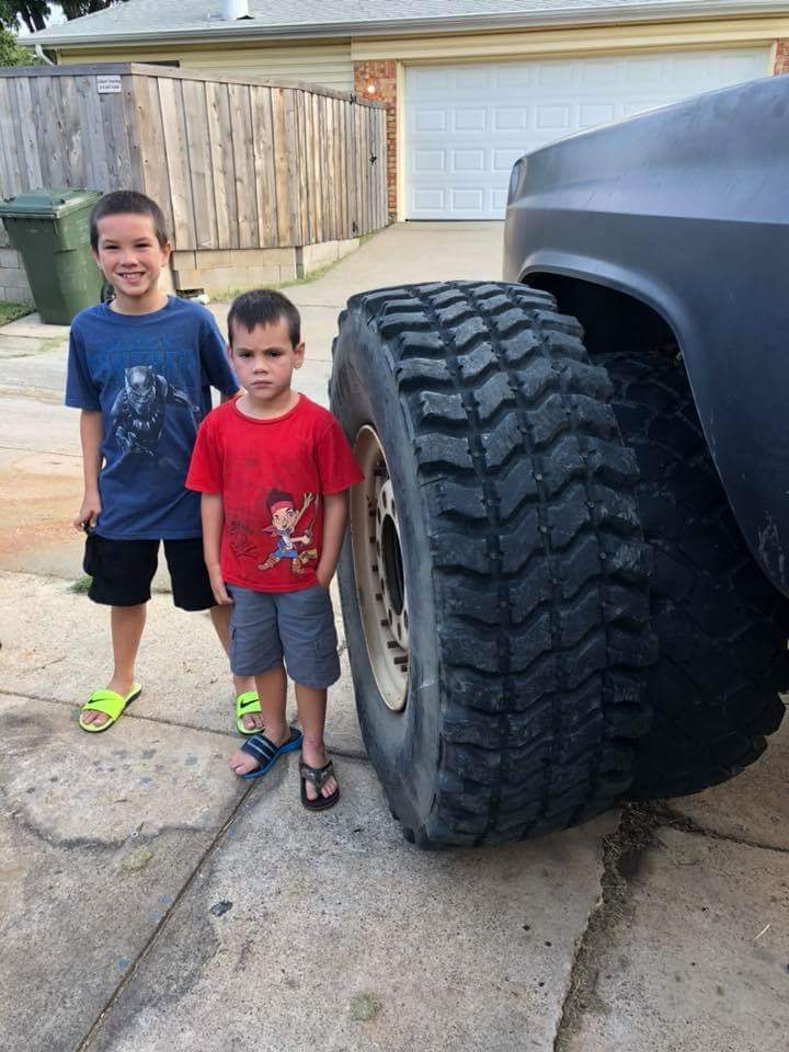

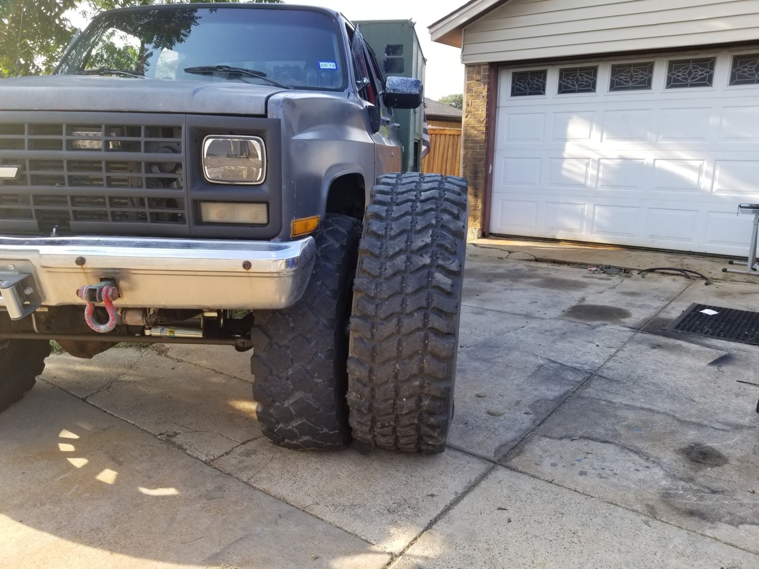

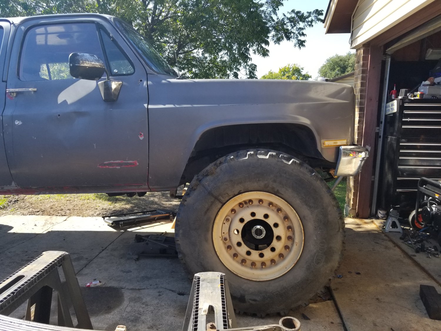

If you cant tell, that is a 46" Goodyear.... I have been thinking about the 395's for a little while because they are a little more than half the price of the current 335's I have now. I borrowed the tire to do some test fitting to see how much work it would take to fit them.
full
full
full
Never-mind the miss-matched flip-flops on my youngest, he was upset that the tire was as tall as him! He soon got over it when he realized that it would make my truck taller. Here is what it looked like mocked up in the wheel well, the tires are not perfectly straight ahead so it makes it look a little weird but you get the idea.

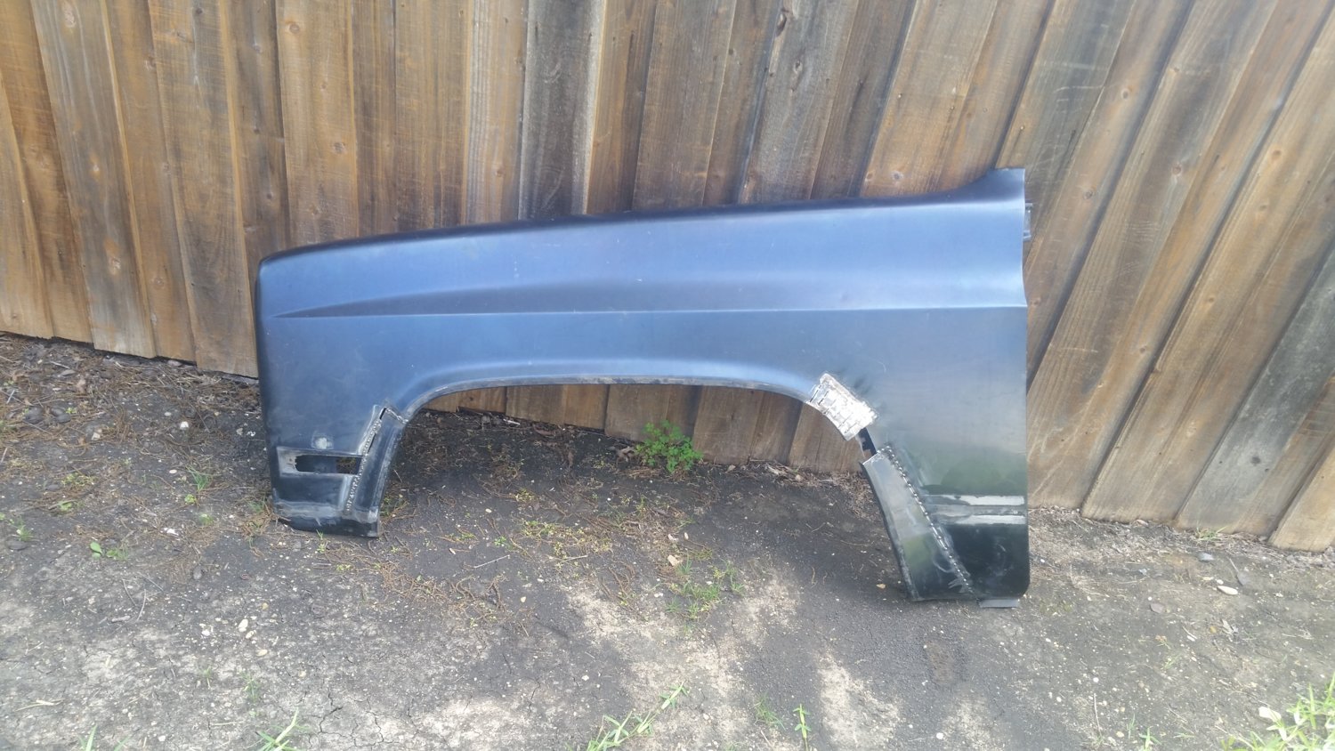

I have also been (slowly) working on sectioning a set of fenders for the truck, looks like I may need to speed up that process along with building some slider style steps.

Damn this thing is a sweet ass truck! Those new tires can't be light! What are you going to do for rims?
My brother has those 46" military tires on his semi/crawler hauler. He used a whole bunch of airsoft bb's in each tire to balance them. It goes 70 mph down the freeway with little to no vibs from the tires.
IIRC they are a 20" rim...so he should be able to pick up any 20" rim in a 8x6.5 bolt pattern he wants and toss those tires on them. The goodyear 46's are really heavy, but the Michelin 46" military tires are even heavier. My brothers spare for his semi is one of the Michelin's and lets just say if you let that tire get away from you, it will surely kill a bus full of nuns
So my current tires are Michelin XLZ in 335/80R20 (42ish) I plan on reusing my current wheels with the 46's. Right now, with the steel wheel and run flat, the 46 weighs about 450lbs...
I used the airsoft bb's on my current tires and they work great! I have had them up to 85mph with very little vibrations.

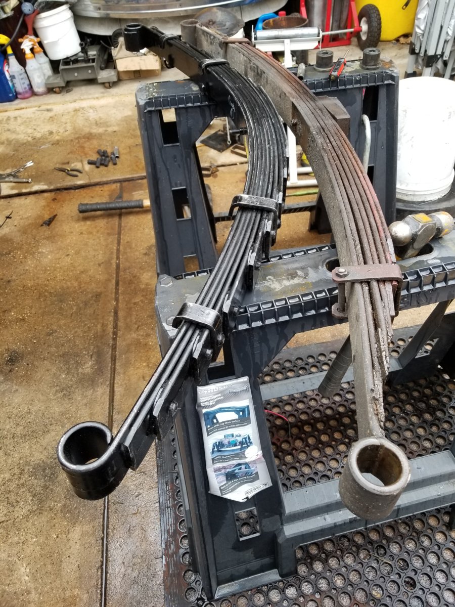

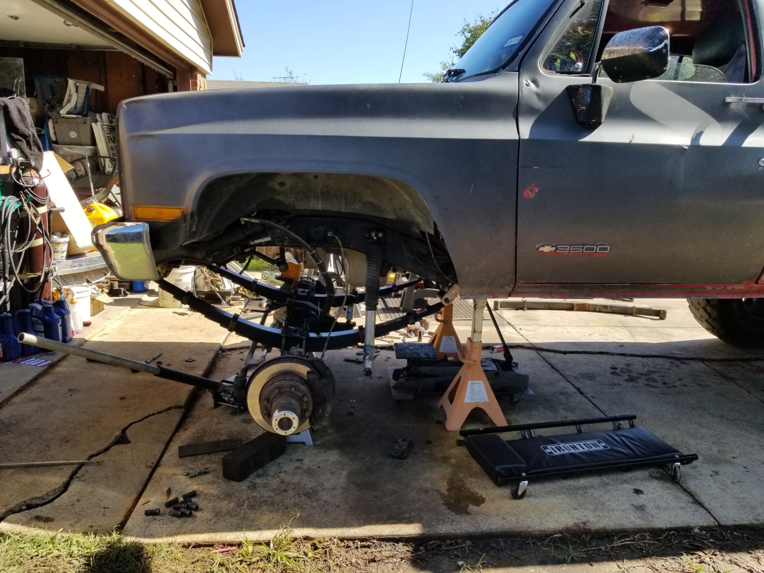

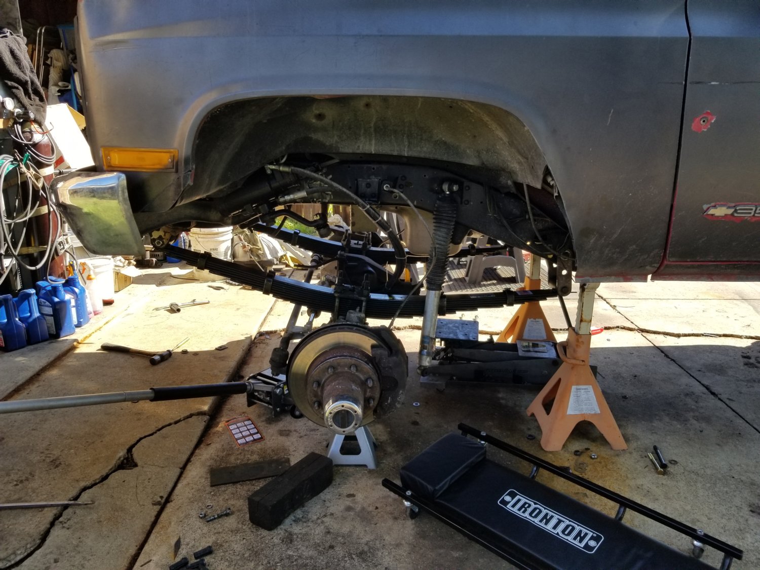

Was able to get started on the first steps of getting the 46's on. I got the hydro assist steering installed a few weeks ago and yesterday I started installing the ORD custom leaf springs. I am going from a set of 56" rear springs with a 1" zero rate and some degree shims, all together it netted me about 4.5" of lift. The ORD springs were built to have 7" of lift, the still required degree shims but I was able to loose the zero rate.
Here is the new vs old springs.
full

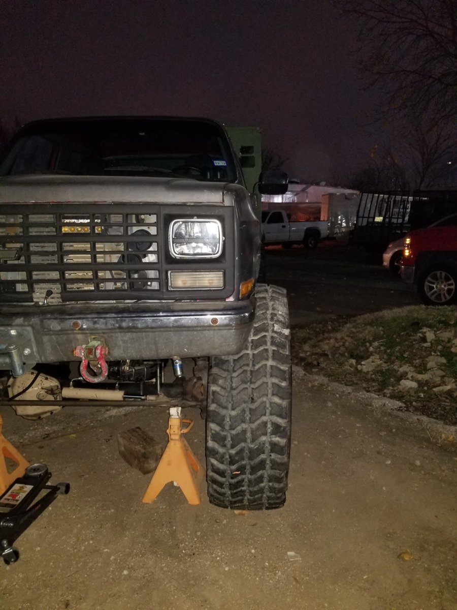

New spring at drop with axle hanging from it.

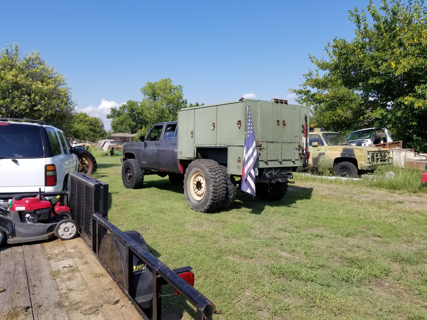

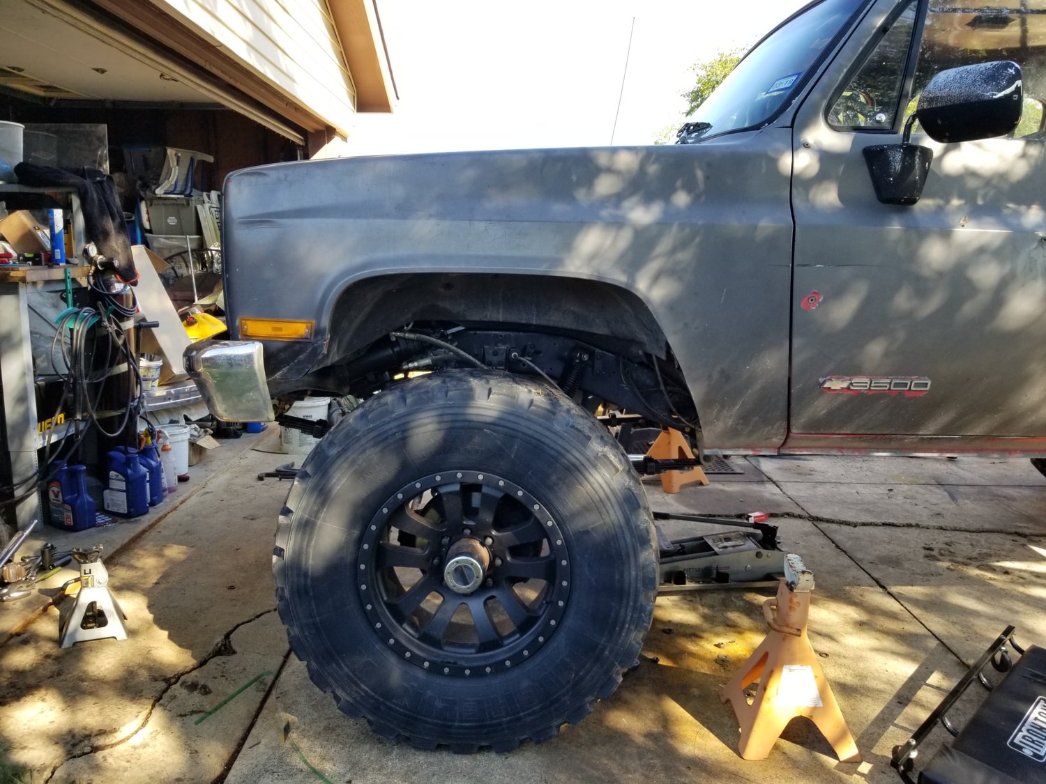

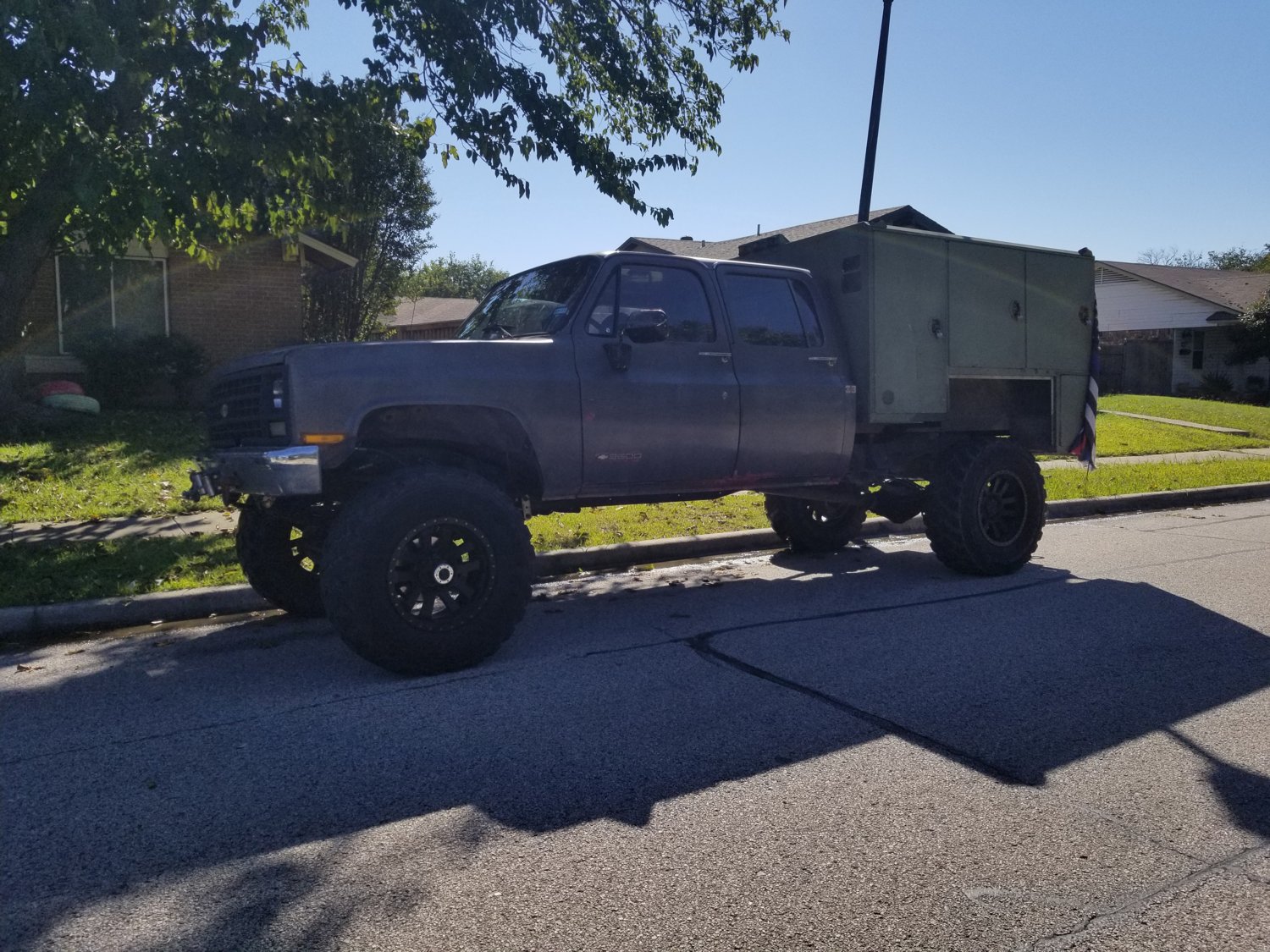

This is how it is sitting now with the 42's and 7" of lift. I plan on mocking up the 46's this weekend but until my big brake kit arrives I won't be doing much more...
full

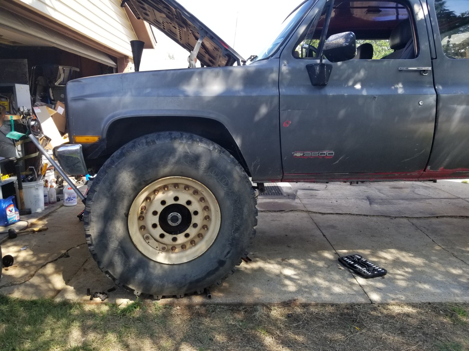

Finished installing the springs and everything today... The old leaf springs had a significant lean to the passenger side. The driver side was about 1" higher then the passenger, the new springs cures that! It looks pretty good with the 42's but I really like the look of the 46's! Haven't put any miles on the springs yet as I had to get to work but I'm excited to see how they ride.

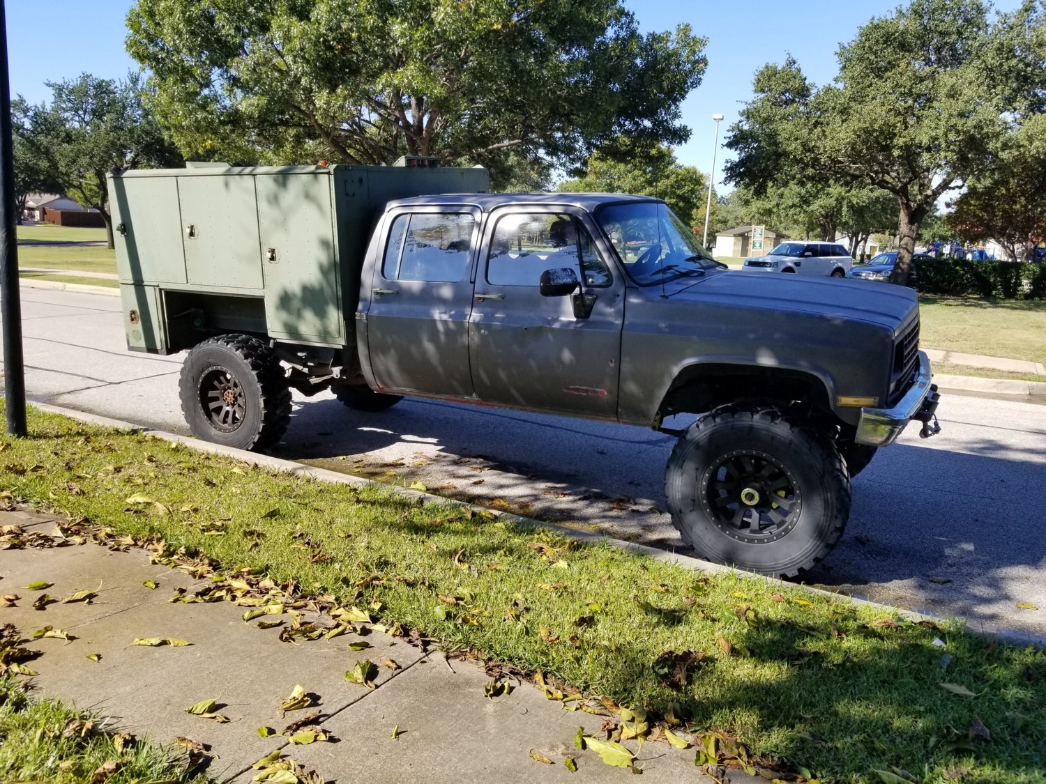

And now for the 46 with the 7"lift!

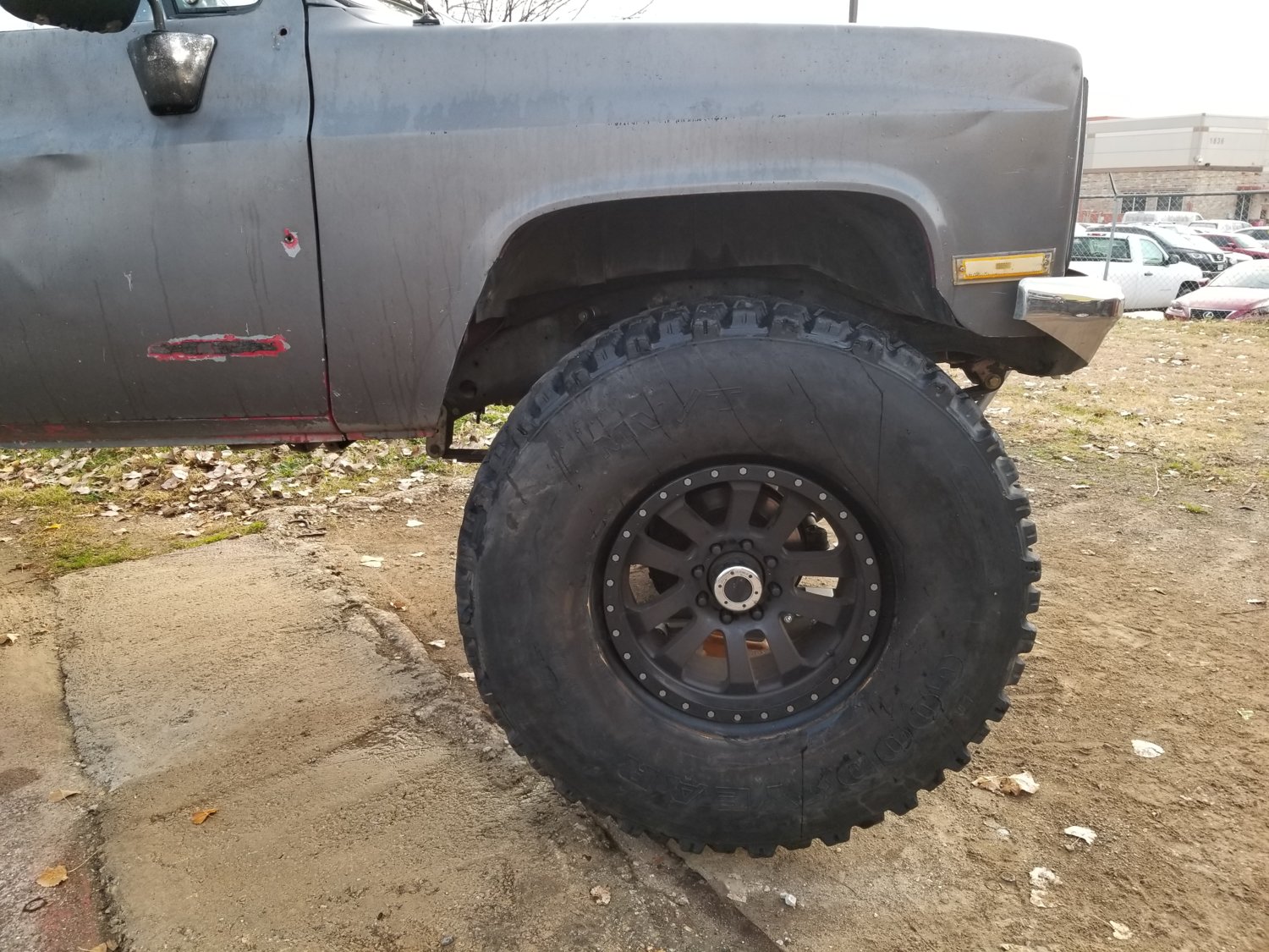

So.... This thing has started to snowball...

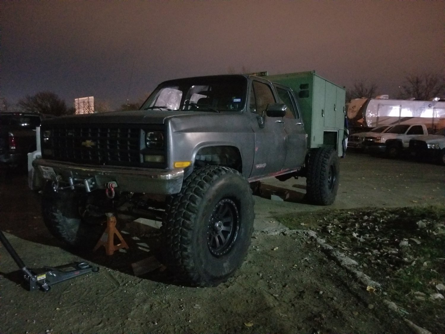

Was driving to check out a welding project for a buddy of mine and when I parked I noticed a significant lean. I got out and was checking the front springs because the were the most recent upgrade, but as it turns out, my passenger rear tire had a sidewall failure. After some price checking and soul searching I decided that now was the time to attempt the 395's. I did some checking around and found some 70-80% Goodyear MTV's for a good price so I picked them up. Then my brother, who works for a Firestone Service Center helped me get them mounted on my wheels. That was a pain in the a$$... I got the tires mounted up and had to use some wheel spacer to clear everything, once I get better clearance on the fenders and inner fender I want to get away from the spacers.
full
full
full
full
I had clearance the bottom of the bumper to even be able to turn lock to lock, even then I am going to have to clearance the core support, inner fender and the firewall... I plan to move the front axle back about 1" because I can remove more material easier from the firewall. I plan to still clearance the core support some how and also limiting the up-travel. Here are some pics of the clearances as it sits now..

I do like the box you have on the back. Can you put a full sheet of plywood in there width wise?
Yes and no. The box, without the generator and compressor that normally come inside has a main compartment size of 94.25"x50.25". Ply wood sheets do fit but you cant lay them flat on the floor, one end or the other has to be elevated.
