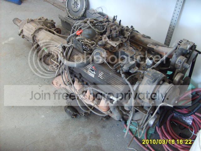

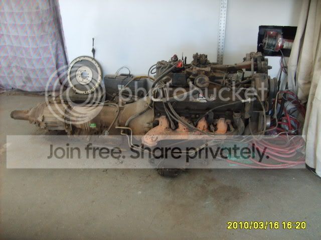

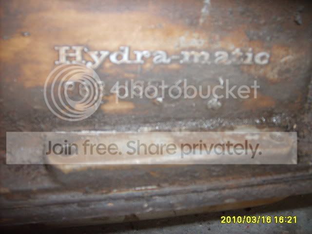

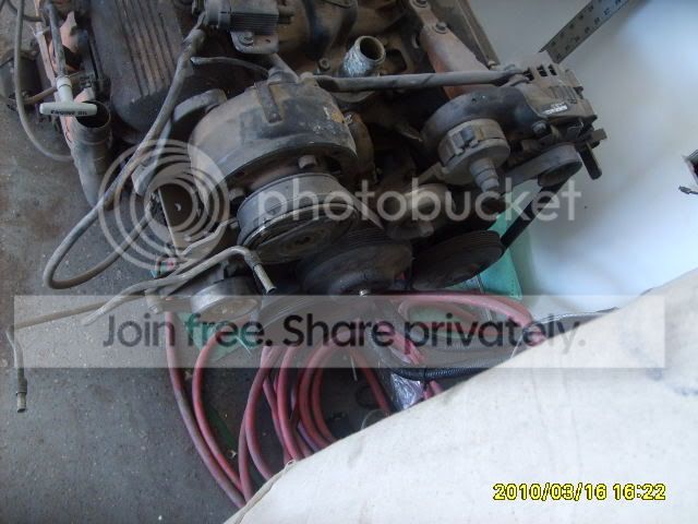

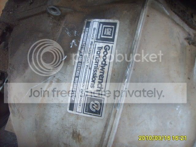

well here it is, remember the free heads I picked up last week, well he took those in trade and knocked $200 off so all of what you see for $900!! I will pick it up either next weekend orthe one after that, got to wait till monday the 22nd to request my money from my 401K, then how ever long it takes to get in my bank.

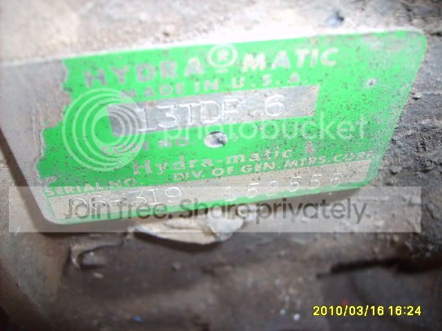

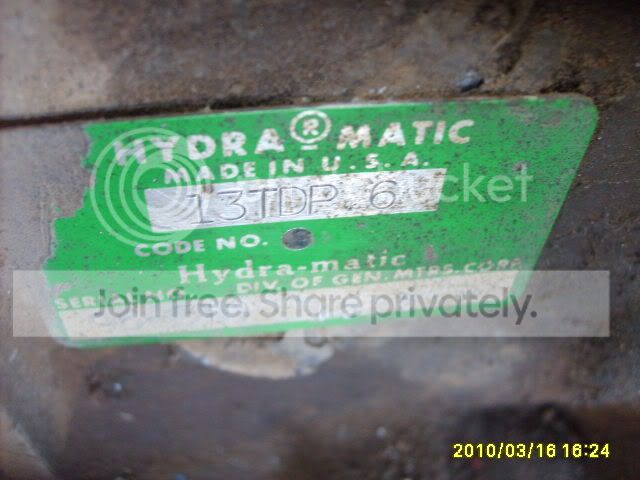

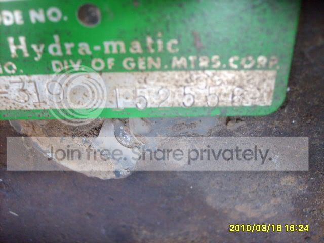

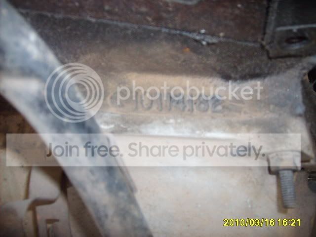

anybody know what this tag off the trans means?

Wow, seems like a good deal to me:bow: All of the stuff that would normally nickel & dime you is already there.

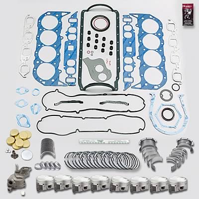

rebuild kit $600.00

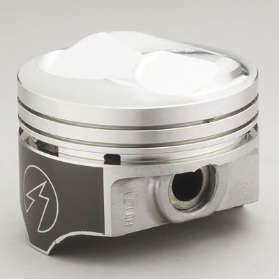

that's what I was hoping for too, just a bearing and ring rebuild....but the taper on a 454 is tight at .002, and out of round tight too. (GM service manual 1985) I had a gouge deep enough to require a .030 bore job, and the crank had questionable bearings in it, and had oiling issues before. I decided to do this right the first time out, and not have to look back. I'm at about 5G's right now with mine, and everything but head castings, block, crank, and rods have been replaced. Also my machinist didn't like the bargain kits that most sell. Too inconsistent with tolerances....Therefore we spent about 1400 on parts instead of the 699.00 for a bargain set, but got SRP forged pistons that are light, and didn't require the extra labor for balancing that a heavier set does. (the pistons were $549)
