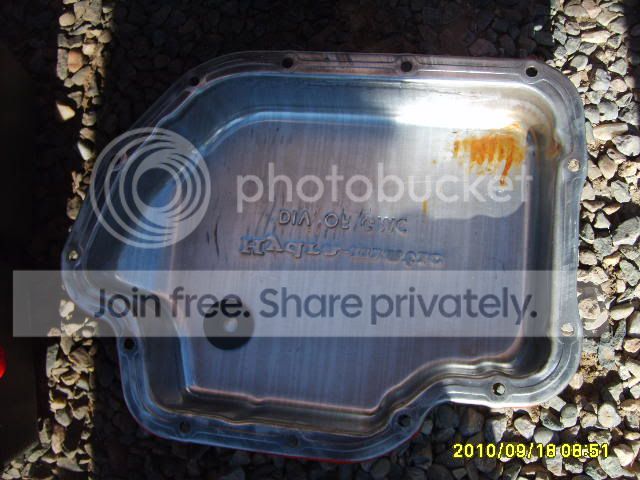

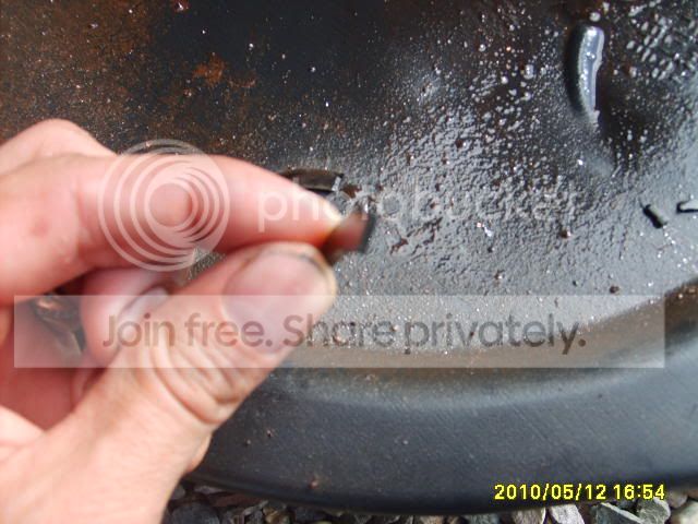

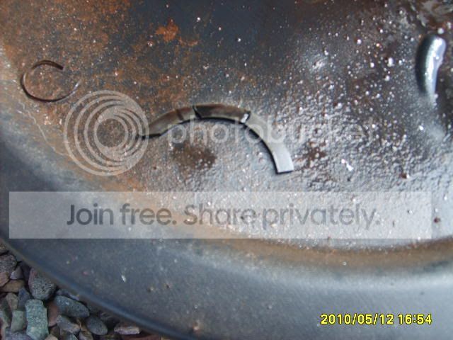

well I am no expertbut I am pretty sure this should not have been laying in the bottom of the pan?
I know that was not there when I put the pan on, and there sure aint supposed to pieces of brass in the pan or all the sludge either. So yeah it's kaput!
and the filter was right where it was supposed to be.
a snap ring for a piston spring retainer?
Don't remember any brass in there though....maybe a thrust washer or bushing material?
could be it was really brittle sorta like plastic? the metal shavins and brass looks like bushing material or maybe the clutches. Anyway gotta pull it and get another one. Still all up after selling the other motor and trans I got a 454 for $450 bucks that works just fine.

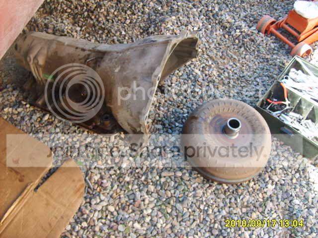

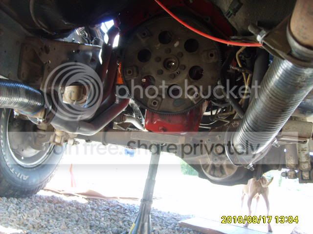

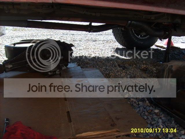

well that was quick and easy!!

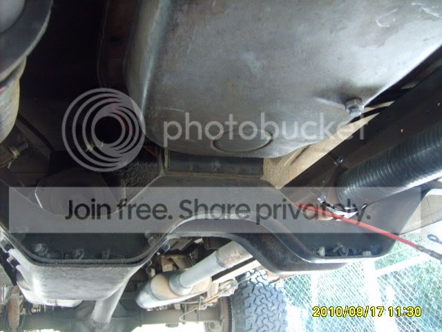

unhook the torque converter
drop the cross member
then the t-case and pull a few more bolts and wallahhh! It's out.

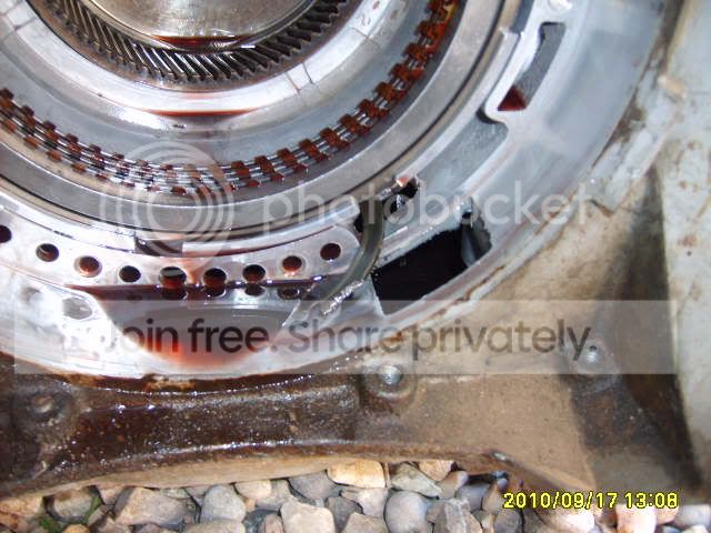

and couldnt help my self had to pull the pump just to see!
whatdya know anothe piece of broken something sitting there? other than that have no idea what I am looking at.....I do know the pump dont just slide right back in easy. Oh well no big deal, now all that's left is pull the th400 out the blazer and put it in the burban!! HMMM need a break first.

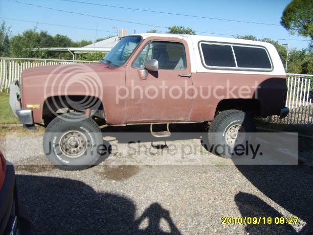

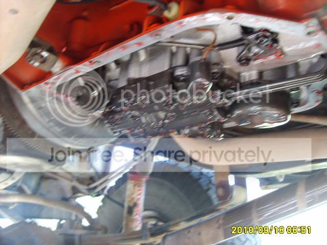

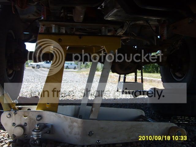

well here is the operating room and new home for the blazer for a while.
the problem with a 6" lift, the jack wont reach the trans! Nothing a couple blocks of wood cant fix.

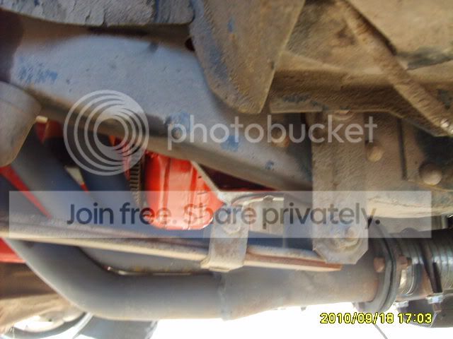

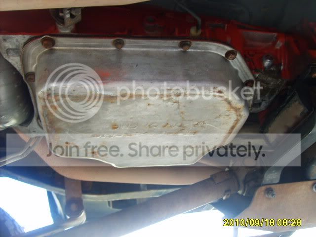

decided to change the filter while it was still in the blazer.
was a little sludge but allgone now, and the fluid wasstill nice and red!

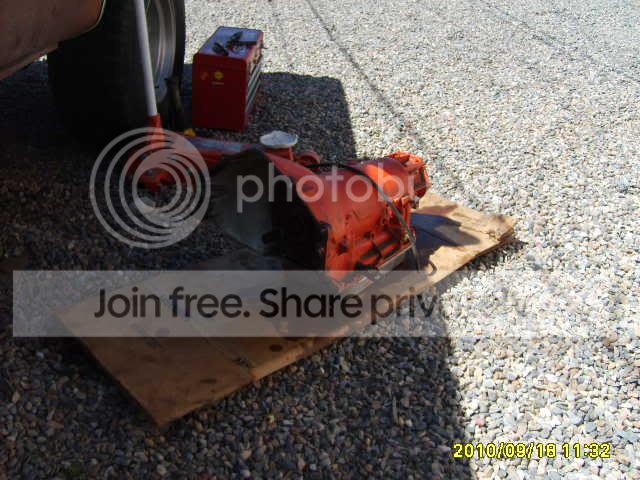

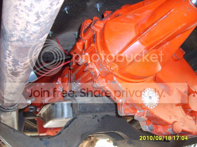

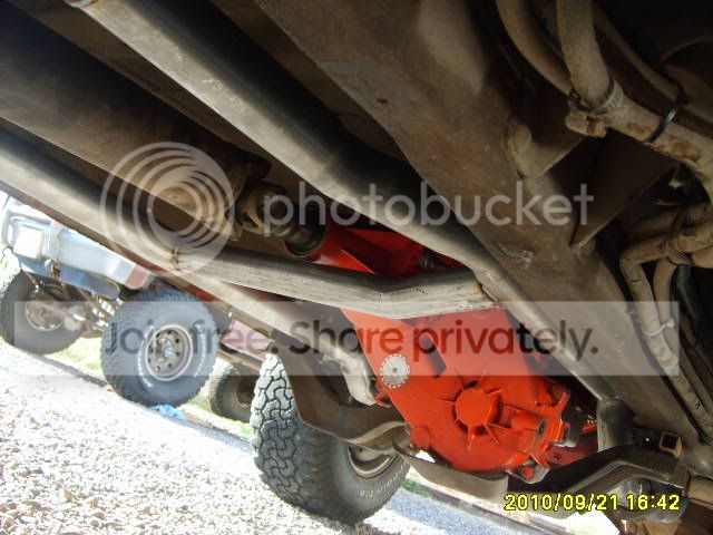

came out easy and here it is just waiting to be put in it's new home. Decided to take the transfer case with it since it was clean and painted already.

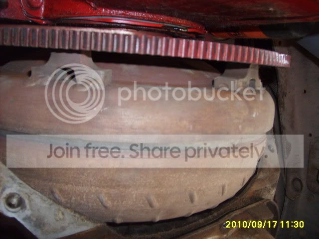

Look at the pretty new torque converter peaking out.

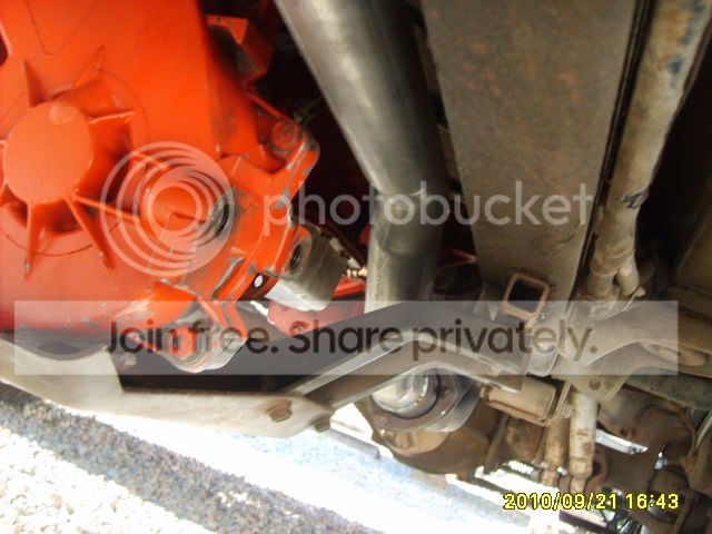

all bolted up, even went ahead and spaced the crossmember now to save a step when I put the lift on.
I will need to get the driveshavt lengethend when I lift it. So all I got left is the cooler lines, vacum line and the electric kick down needs to be hooked up. Should be a quick day tomorrow and ready to drive!!!

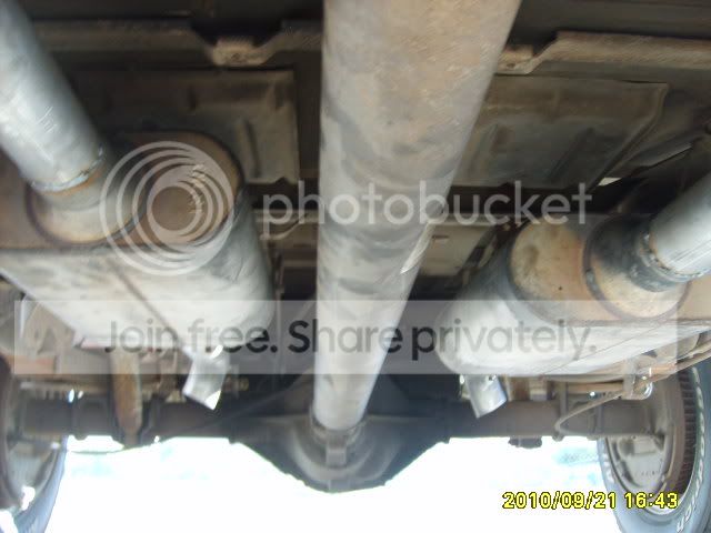

well here it is $187.00 later!
Sounds a little tamer now when driving but sitting at idle it has some serious deep tone to it. Will do another video short of it after I get the timing sorted out.

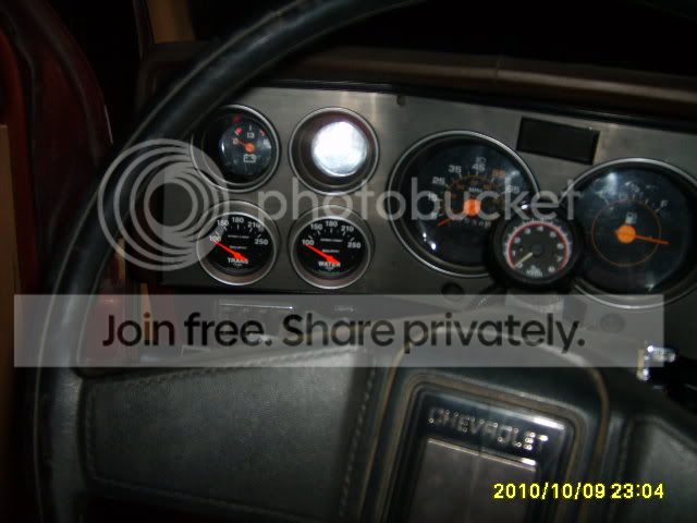

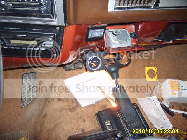

got the gauges put in temp like until I get the rest of them and then they will go in the dash.
Had to put together an adapter to make an in-line fitting for the trans guage. used a 3/8 tee fitting and the adapter from autometer.
then solder on a ground wire since it wont have one otherwise.
the water temp sending unit installed
the tranny temp adapter installed and feeding into the auxillary cooler, this will give me the temp of the fluid coming out of the radiator.
and finally the guages in their temporary spot, so far so good, after a little worrying about the flow in the radiator.

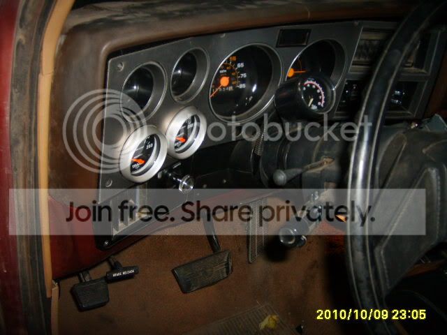

new gauge cluster, with fuel level installed, the rest will be air fuel ration and voltmeter

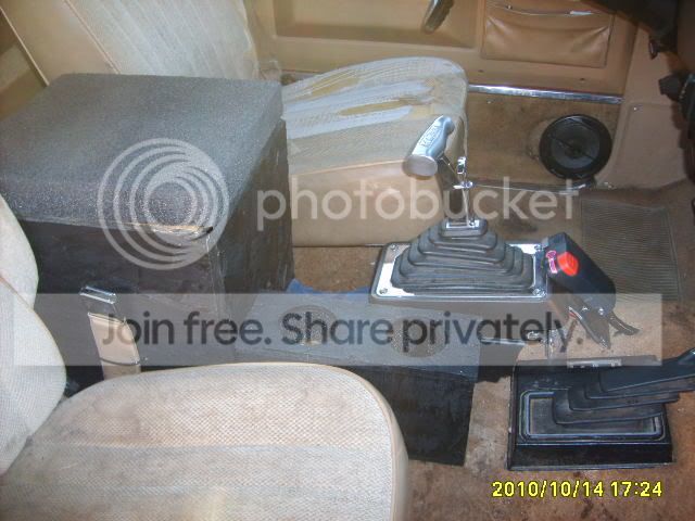

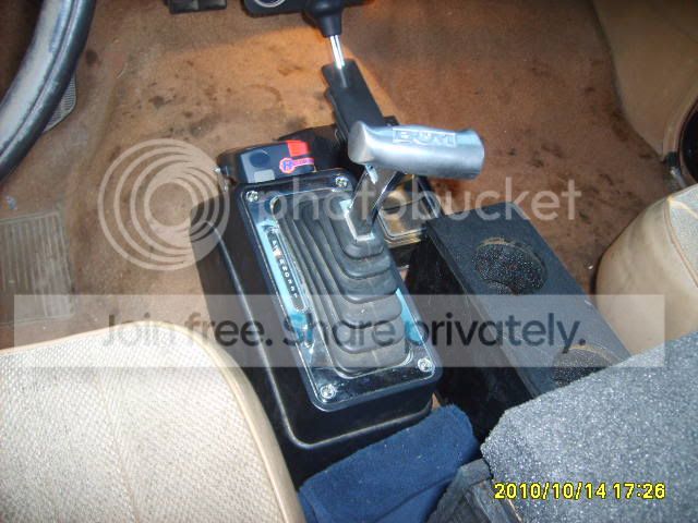

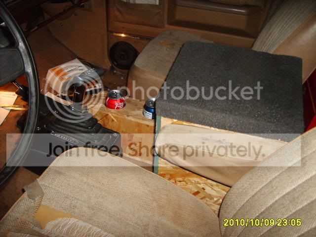

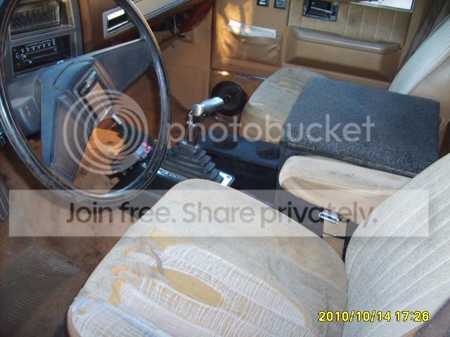

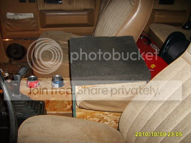

the console

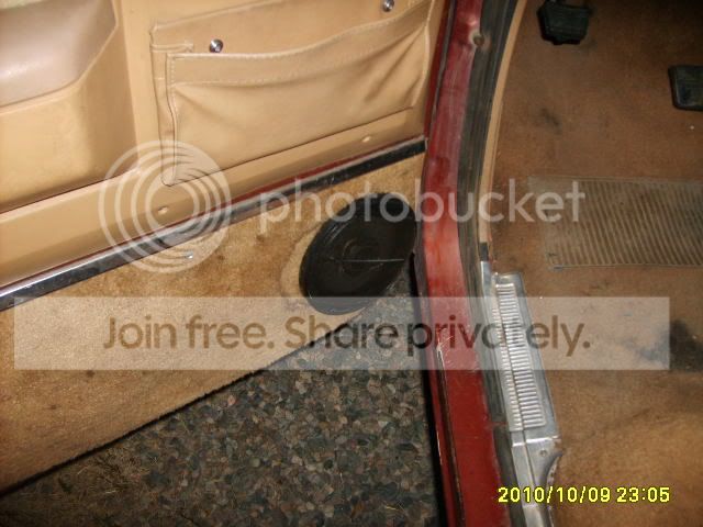

new speakers
you can see the other one in the console pic.

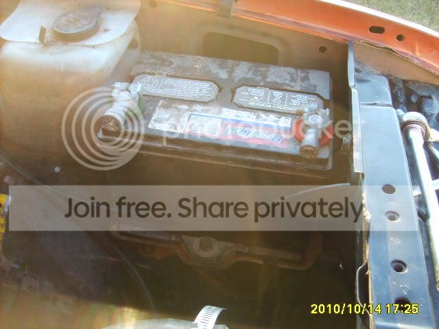

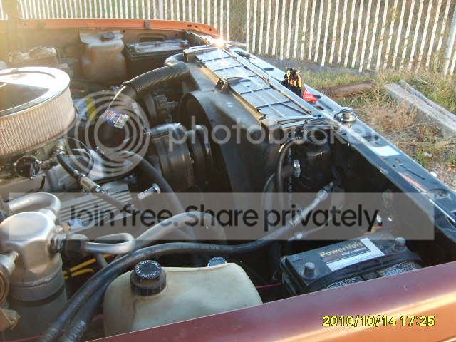

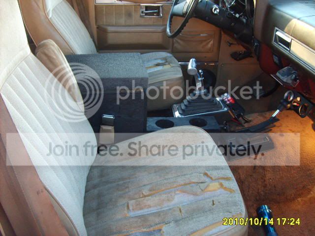

So got the thermostat swapped out to a 195 degree and while I was at it figured I would snap a few pics of the batteries and my center console that I pimped out a little.

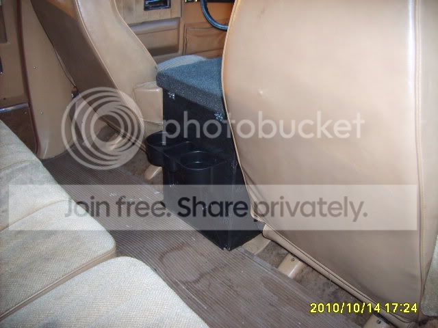

Painted and added a cup holder in the back for the kids.
and here is where I stuck the brake controler, make it easy to reach and adjust.
that's about it for today.

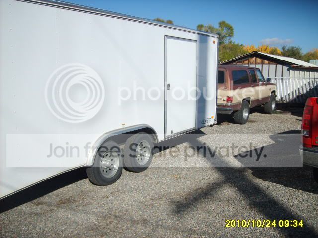

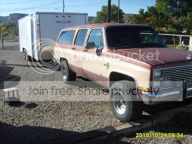

the trailer that I pulled that prompted the 496 build.
kinda squated it huh.
