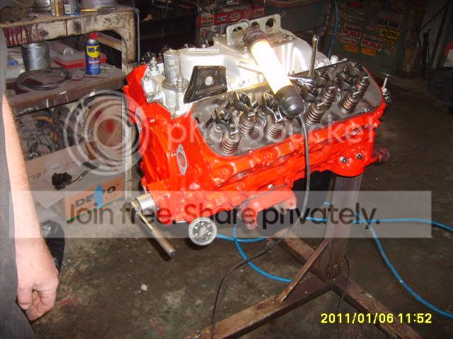

so stopped by at lunch today and of course he was not as far as I had hoped but still says he is on track for tomorrow starting it up.

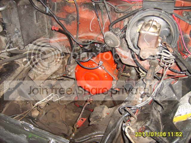

all empty waiting for the new power plant, look at that lonely Hughes Converter just hanging there all sad.

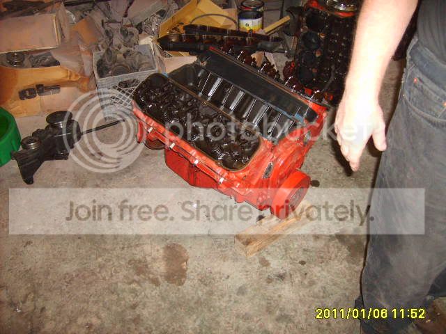

the old 454 stripped down in shame!
and the fresh new hotness! Getting ready for oil and being primed.
Valves are adjusted and locked down, and he is prolly got oil in it now and priming the block as I am typing this. He said should be ready to fire it up tomorrow so hope it all goes well and I can get it tomorrowbut will just have to wait and see.

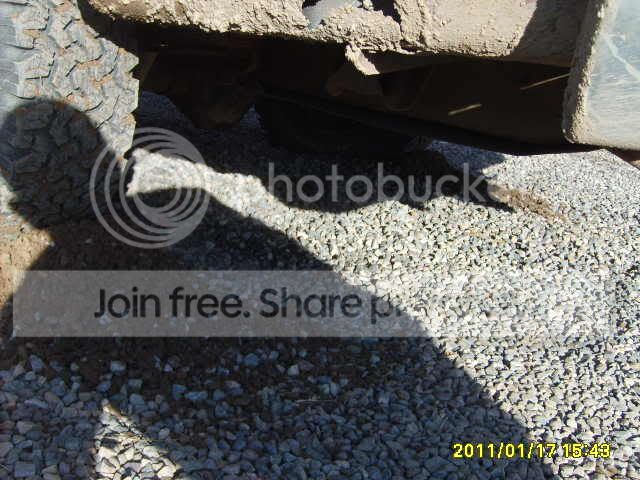

tranny lines all in the wrong place kinda hard to see but there is the smash

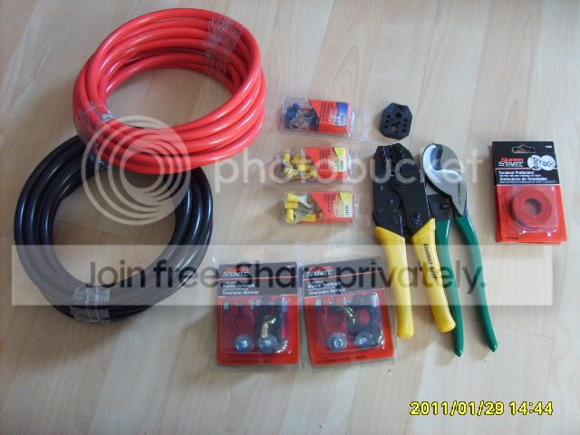

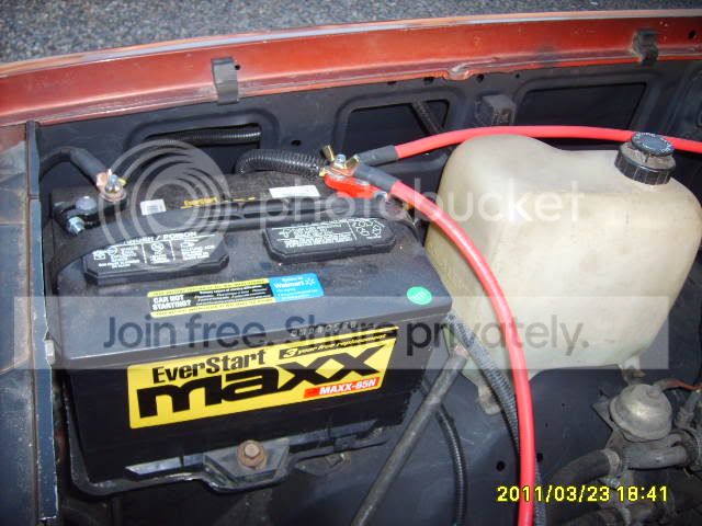

ok so cant find the battery cables I want to fix the starting issues. So I just ordered 20' of 2 AWG in red and 20' in black, a hammer crimper, 5 copper lugs of each of these terminal sizes, 1/4, 5/16,3/8, and 1/2. Now just gotta get these
5 bucks for a set at the local Big R hardware. Then still need to get a solenoid and relay, and switch to hook up the dual battery set up.

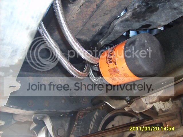

Also got the new mechanical fuel pump on the way along with 25' of 3/8" stainless steel braided hose. Gonna replace all the tranny lines, cooler lines, filter lines and rubber fuel lines that I got running all around the place. I still need to sort out the new lines for the engine oil cooler too, but that is down the road a bit since I am not driving it anyway. I will start looking for any vacum leaks while I am cleaning up the wiring and painting the engine compartment. Just to much ugliness going on in there, that is prolly what it dont wanna run right, need to get all the half ass out and do it all correct!!

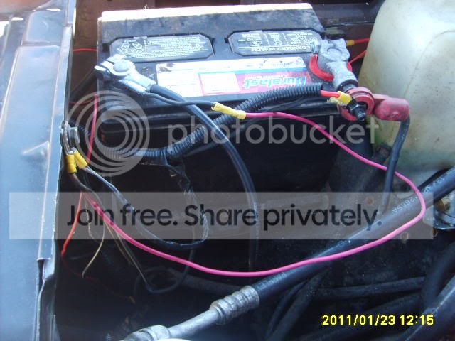

what a mess!!
totally half ass on the positive side!!
lots of clutter and just ugly!

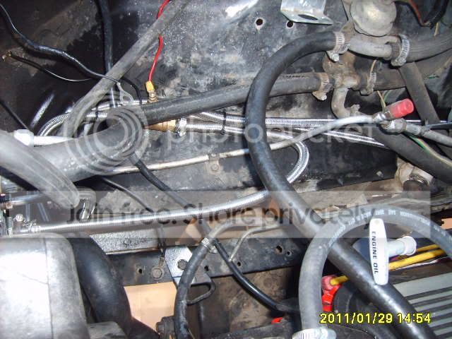

Stuff should be arriving today, the fuel pump and Stainless Steel braided hose should for sure.

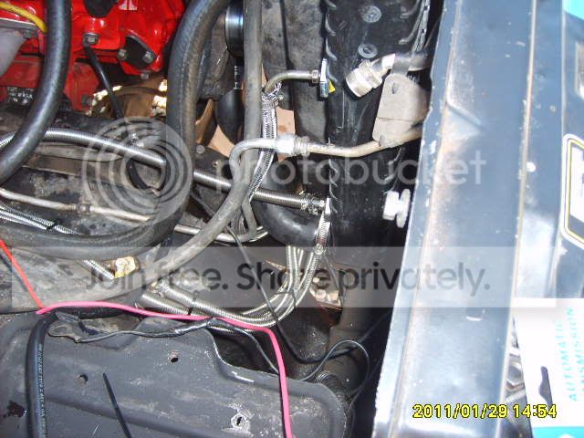

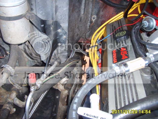

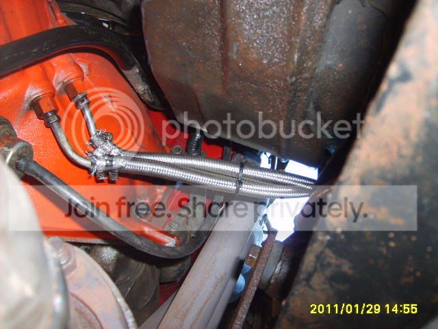

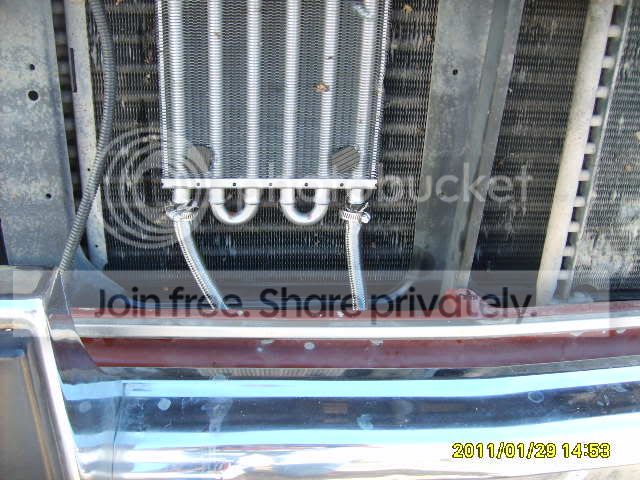

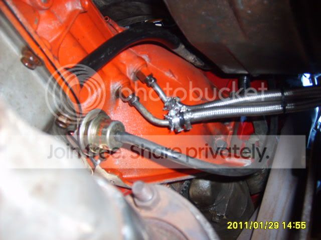

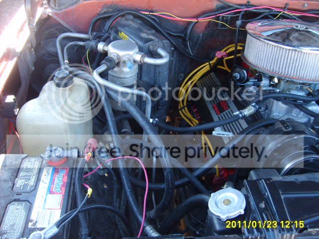

Anyway I started running in my mind how to do the new trans lines, my thought is lower port of the trans along frame rail to bottom of the core support where the remote filter is, then to back under a short ways to the lower port of the radiator, then top radiator port through core support to the external cooler, then from the cooler back down and along the frame rail to the top port of the trans. I will put the tempature sensor just before the remote filter so I can read the temp of fluid coming out of the trans Pan, will put it in the pan on of these days.
Does that all sound right/good to yall? That is correct for the flow right, the lower port is the out line on a TH400 right?
got the trans lines run. I like it, still need to tie them up but here they are.
also got my cable and a few other goodies, but no 2 AWG crimper yet so cant put them in till that shows up.
new crimper, also does ingnition wires witht the extra die.
extra die

You're trans lines look awfull close the the header there in the top to pics..... or is it just the angle of the pic :dunno:
just the angle, they are about 8" away and still have not been tied back yet.
Did you flare the end of the trans lines before putting on the flex lines?

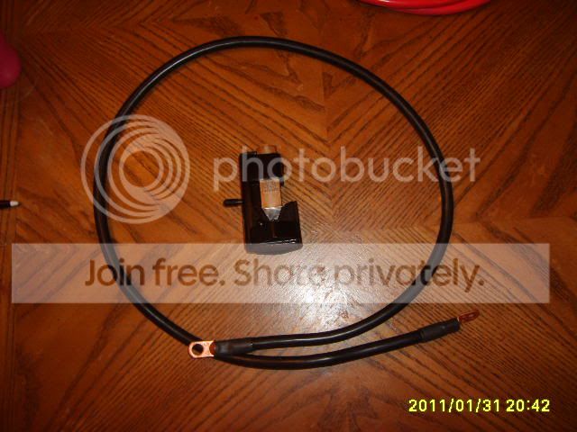

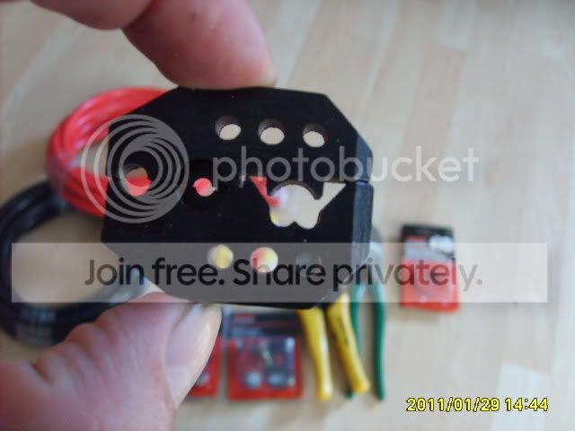

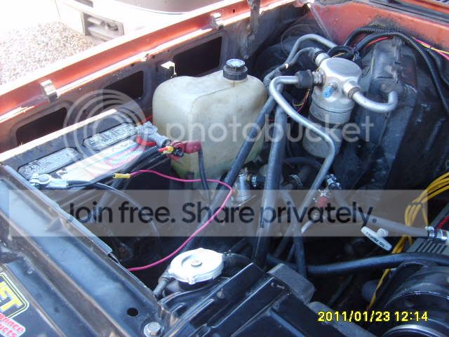

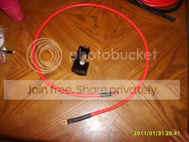

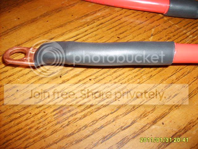

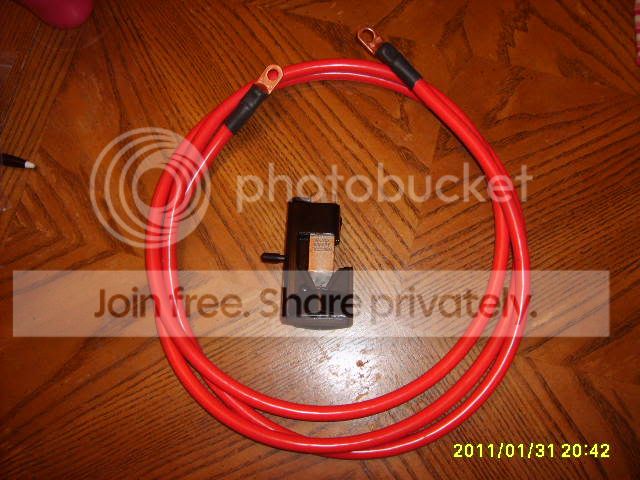

cleaned up one side and made two battery cables so far, will get the rest of the pics up later. I didn't get much time to work on it only had 3 days off and really good weather and a pregnant wife, you do the math!!

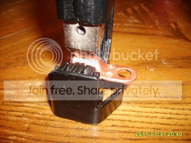

so got the cables made or at least 3 of them

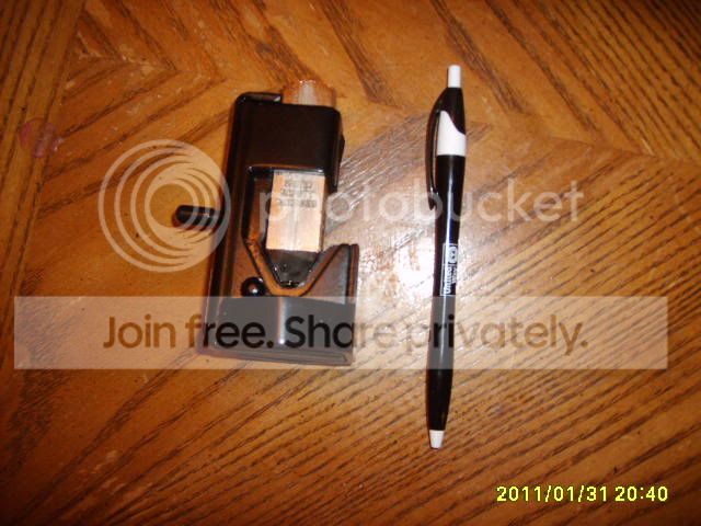

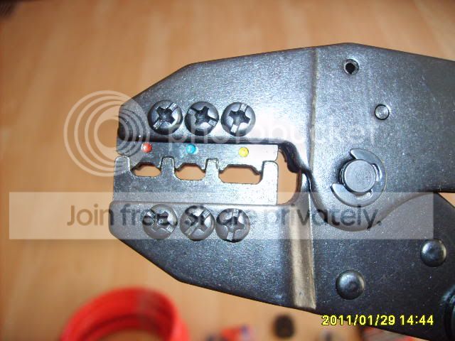

here is the crimper, smaller than I thought it would be but works like a champ

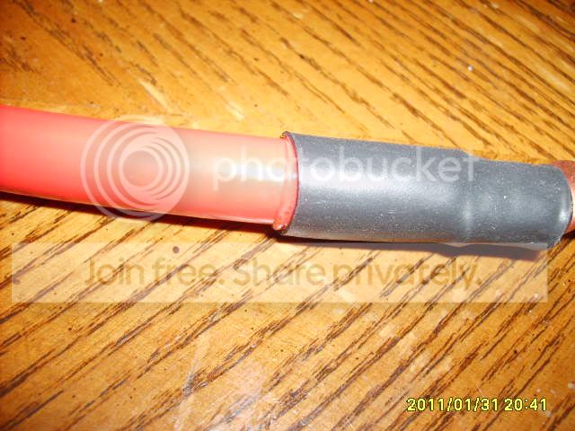

the main bttery positive and neg cables. The long sleeving on the pos cable is the starter solenoid side.

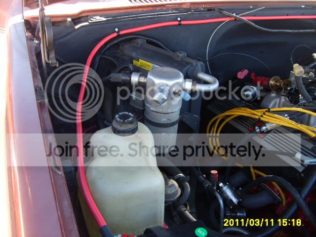

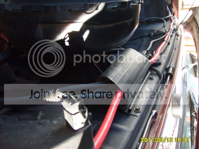

and the main pos battery cable to dual charge solenoid that will be on the driver side fenderwell, it will run through core support in front of radiator then back in on the other side.
I sealed up the ends with some thick adhesive lined shrink tube, the glue will keep all the wet and stuff out.
so just got to make the aux battery pos to remote solenoid cable and the aux gnd cable, then still have a lot of other wiring to replace and upgrade. After all that get done future plans are relays for the headlights to hook them directy to the battery and run 10GA pos and gnd off the aux battery into the cab for radio, inverter, tv's and what ever else I might decide to rig up.
hope to start putting cables in tomorrow but it's supposed to be snowing tomorrow and cold so might not get to it until later in the week, but when I do will post up some pics as usual.

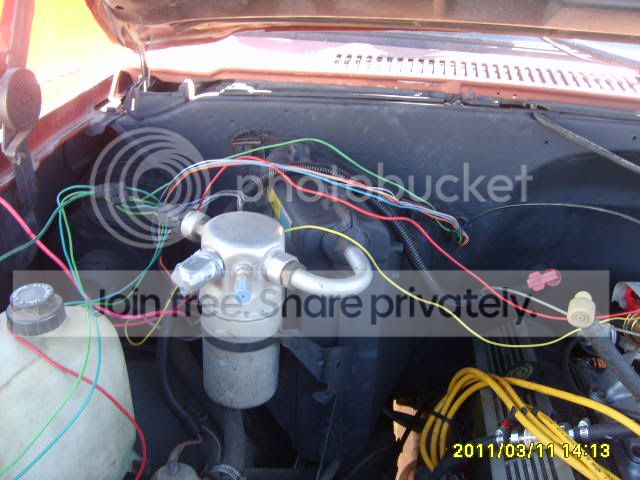

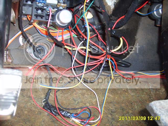

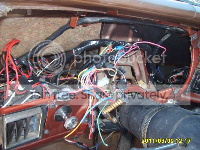

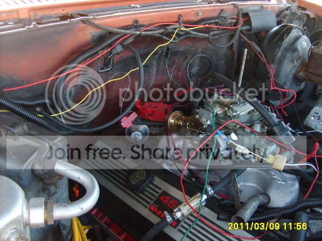

so here is the update of what is going on. all the wiring so far!
been sitting here since I got it home in January.
some inside shots of storage and parts and junk that is in process and never put back in the tool shed.

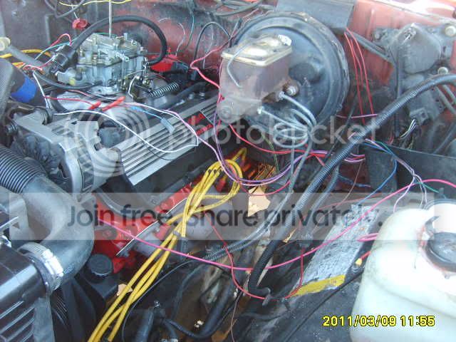

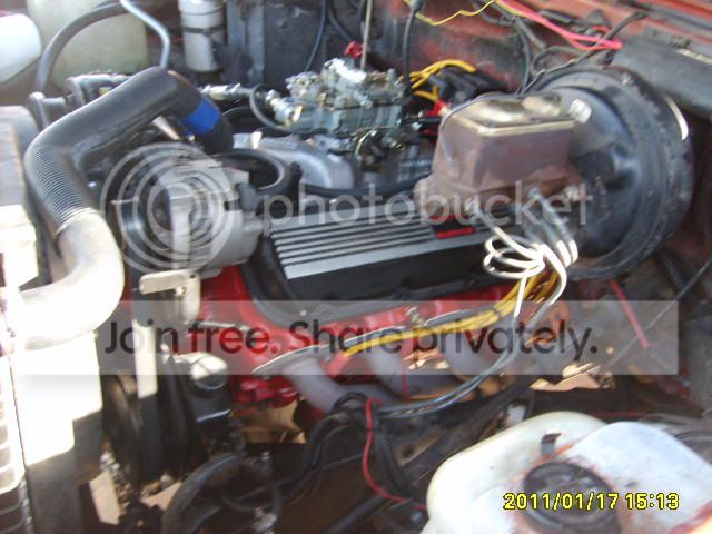

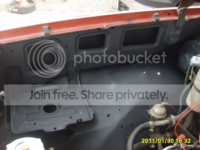

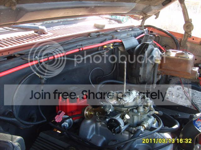

the engine compartment with stuff just hanging everywhere!

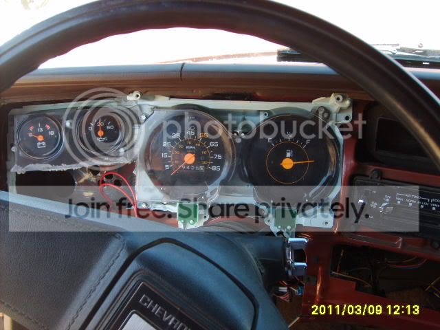

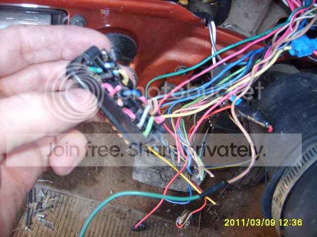

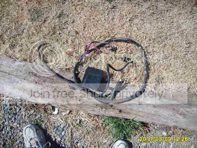

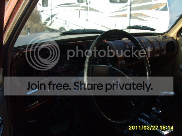

and what I did today, tore the dash out and the cruise control and made a point of no return decision and cut off the OEM connector for the instrument panel.
and the vacume line and wires for the cruise control

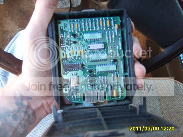

inside the black box of the cruise control brain

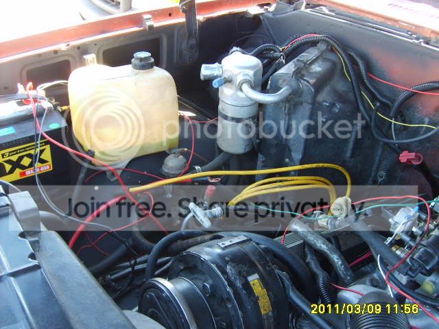

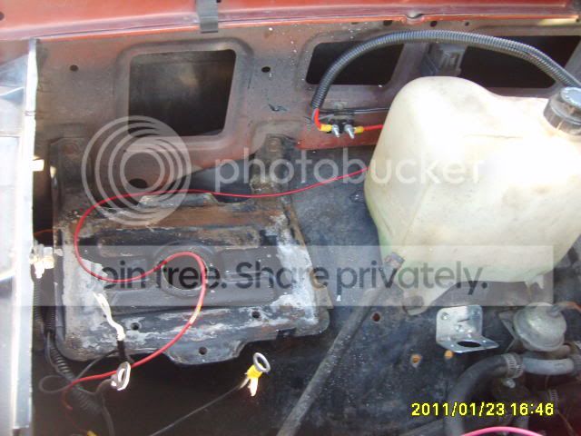

and got the auxilary battey cable mostly in place.

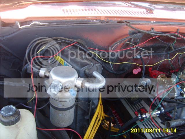

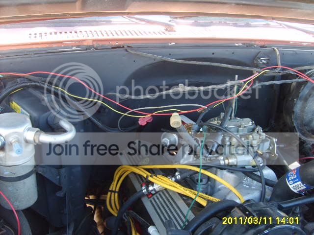

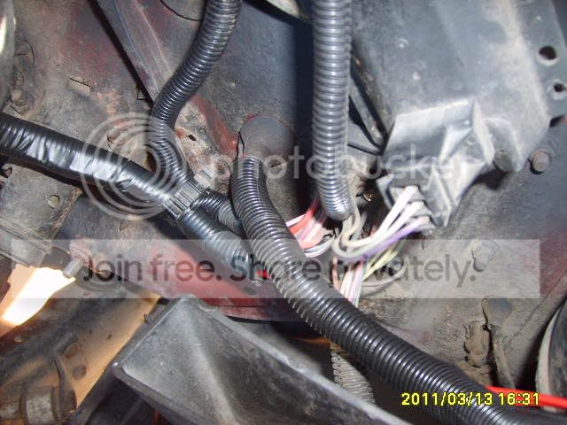

also got some 10AWG wire to so I can make a new charging system, the fuseable links are history and I am simplfying the harness too. Going with 30A circut breakers to regulate power and a few relays for accessories.

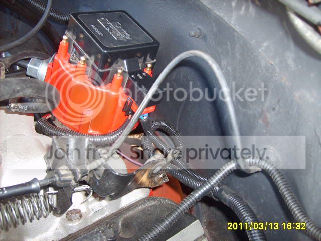

got the input power for the fuse block and the controls wires for the alternator and distributor and Tach all hooked up.
back side of the fuse panel all tidy now
view along the top just above the brake booster, you can see the junction block sorta.
dist and tach feeds
far side view, but as usual still got a long way to go. Might get the breaker and batter feed hooked up tomorrow.

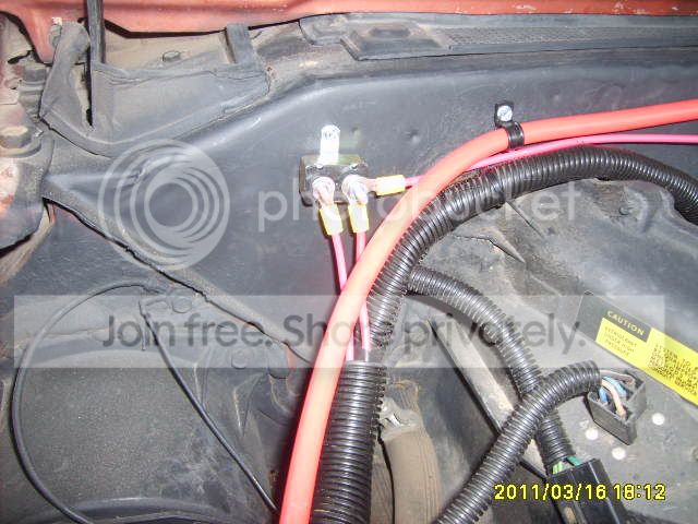

mounted the circut breaker and hooked up the battery to it and the junction block, also got the power wire run from the alternator to the battery. No pics of that stuff though cause is is all laying loose and ugly, I need to put the mechanical fuel pump on so I can ditch the electric pump wiring. But wouldnt ya know it the rod for the pump is in the other truck which my wife took to work so that put a damper on the progress! I would just ditch the wiring now but want to use the electric pump to prime the mechanical pump and fill all the lines before I take it all out.

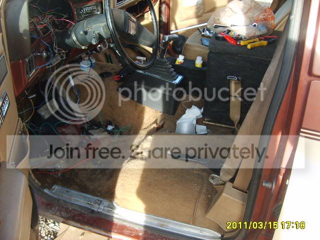

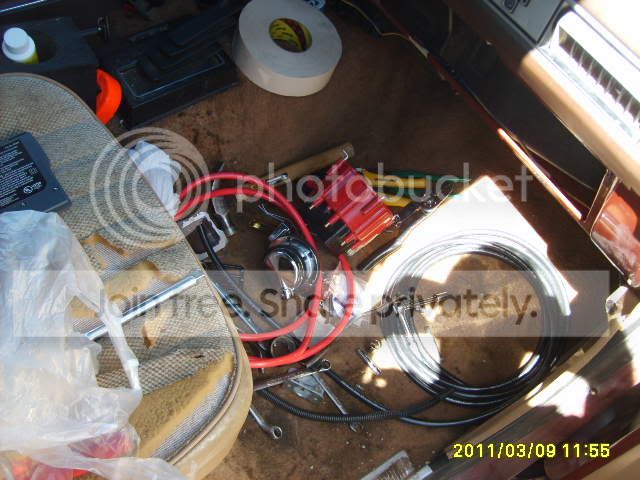

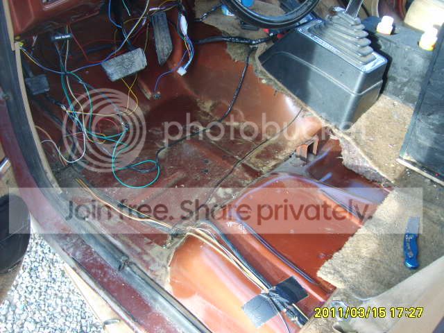

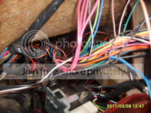

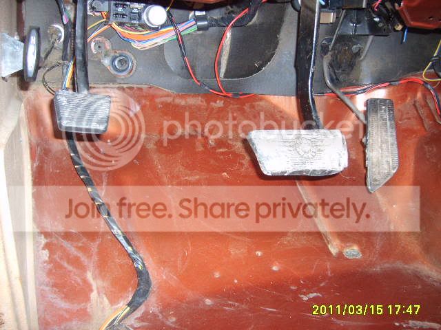

So had a hour or so of light left but what to do?? Go to the inside for a while!!
had to take the seat out
I know there are wires under there too!
and they are ugly too!
little better now
there we go much better now, all ready for the "quick roof" treatment!
still got all the rest to do up behind the dash but a lot better than this!

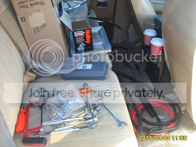

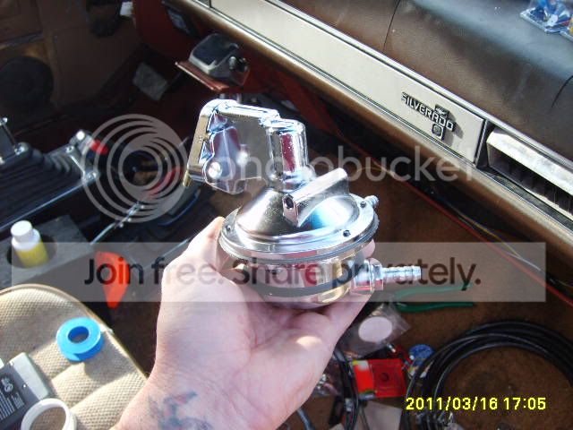

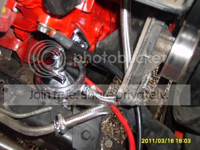

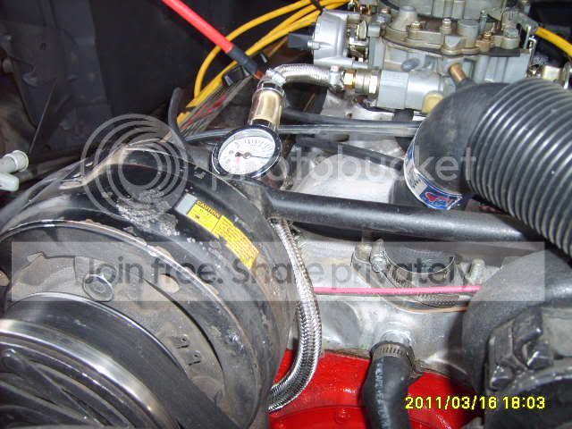

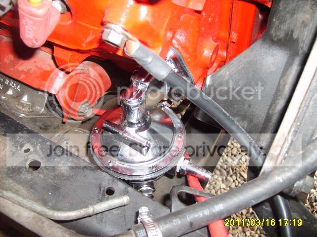

put the pump rod in the burb before I left for work so was able to get it mounted up today.
oh how shiney!
all bolted up
braided lines in place and primed up with gas, even kept the pressure gauge.
whle I was in there I went ahead and snapped a pic of the circut breaker.

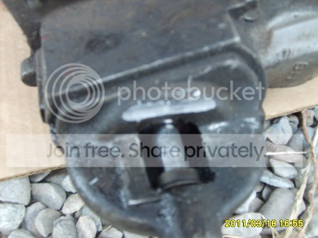

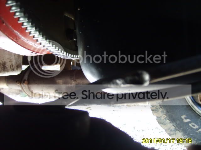

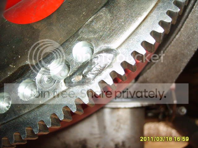

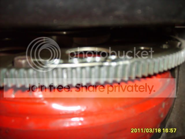

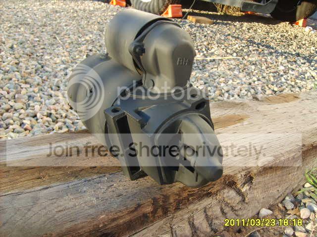

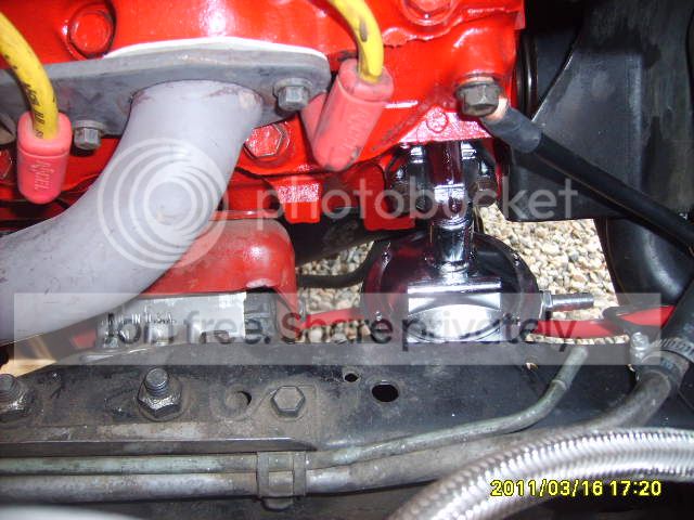

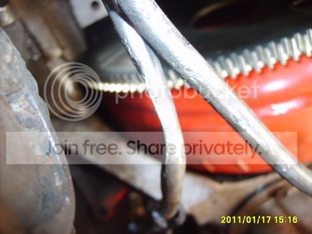

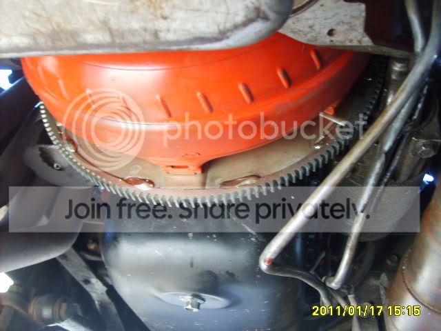

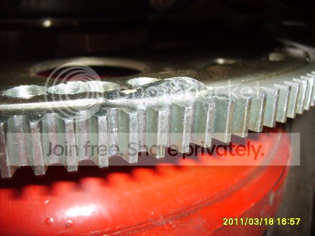

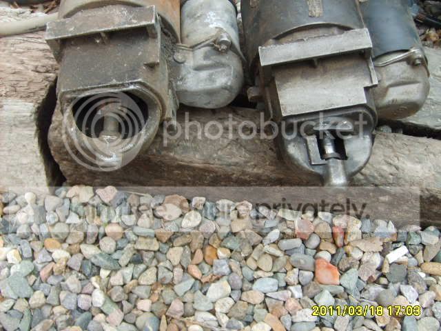

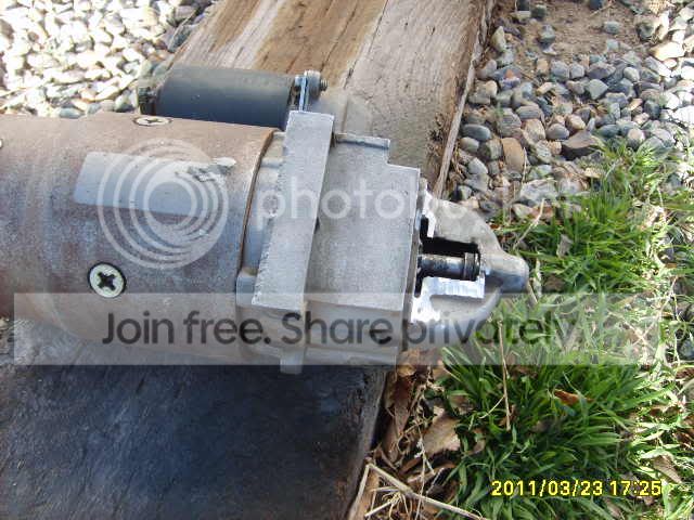

I found the source of the noise from a while back, remember it was coming from the flexplate? I was right it was from that, but it aint cracked and the bolts arent loose either, it was from a fat weld!
so how does that make noise you ask? It hits the starter!
that explains why it's only under load, the pressure on the torque converter forces the flexplate forward and the weld rubs the starter! The funny thing is the starter I had on there that crapped out on me is relieved to eliminate this, so all I got to do is machine the starter to somewhat match the other and problem solved.
why not just grind the weld down you say? because it is externaly balanced and if you remember it was all ballanced to 7500 RPM so would rather just leave it like it is.
old starter and current starter, these got swapped around when I put the 454 in and took the 350 out so not sure if there is a difference between small block and big block starters but there two are different.
so got the grinding done!
also did a little work on the driver side
and now that the starter is bolted up and the battery cable hooked up I got the final resting place for the battery and 2GA cables set in stone.
and yes I painted the starter before I put it in........
you know how I dooze it!!

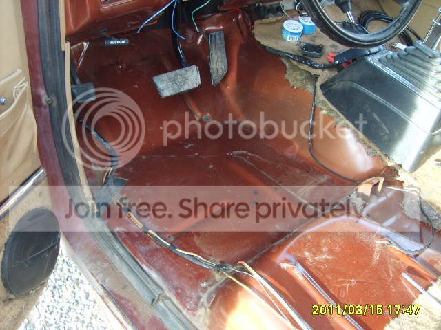

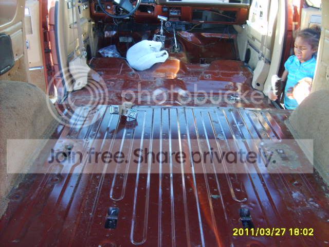

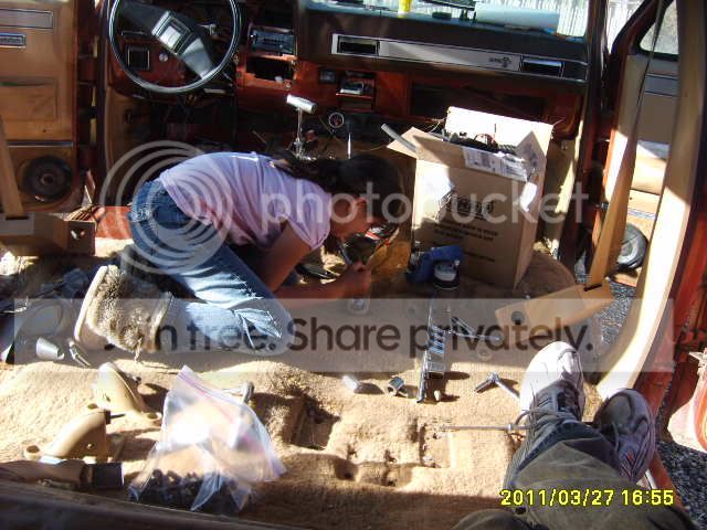

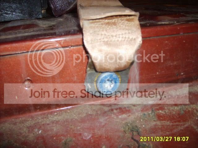

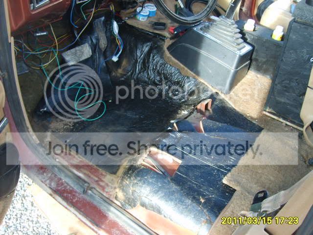

ok, got em all out, and I tell you the middle row had a crap load of bolt holding it all in.
Had help from my 10yr old daughter.
always one bolt that just wont come out, it even broke my T47 bit!! It will come out at a later date!
even took out the dash pad.
got it cleaned up real easy too.
I figured out the trick to getting all the tar and crap off the floor, I have heard all your tricks in the past of wire wheel and chemicals and putty knives. But I found the easiest way yet...........
a pack of kids that want popcicles!!!
I am a genius!!!
So will get on to some sanding and painting of the dash metal tomorrow.
