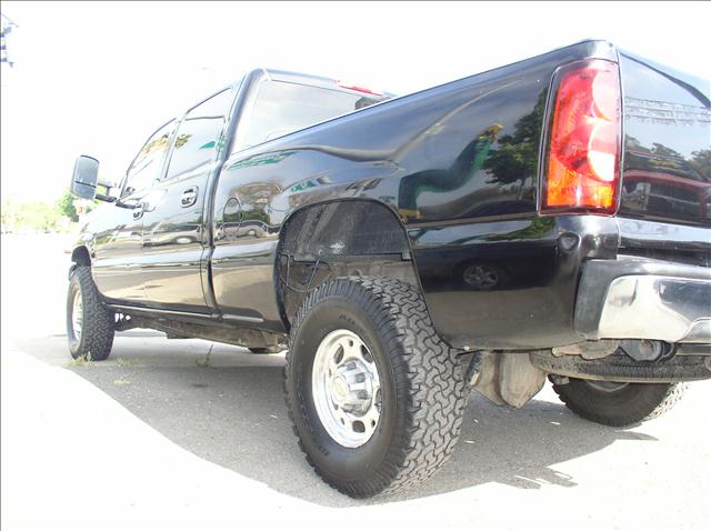

Not if i want 8 lug wheels. IF it were possible to just bolt 8 lug bearings onto the front, i would be stoked. But, from what i found in my research it appears to not be very simple. There is a way thats mostly simple looking, but no one has proved it out as working. The issue is that the 1500's used a 3 bolt bearing and the 2500's used a four bolt bearing. The closest i have seen anyone get is using a 95 dodge 2500 (w/d44) 8 lug, 3 bolt bearing, and chevy 8 lug rotors and studs. But i havent seen anyone actually put a caliper on that setup. But if it were a bolt on affair, and i could just swap in a 14blt FF, That would be pretty sweet! I think the tahoe would look sharp on a set of these wheels,
I dont care about the beef! I want the wheels! Really though, if i keep this thing long enough to actually do something about the rear end, i would just do the 6 lug 14bsf. I dont care enough about what wheels it has to go beyond that. Just expressing my discontent at the 8 lug conversion not being a simple swap.

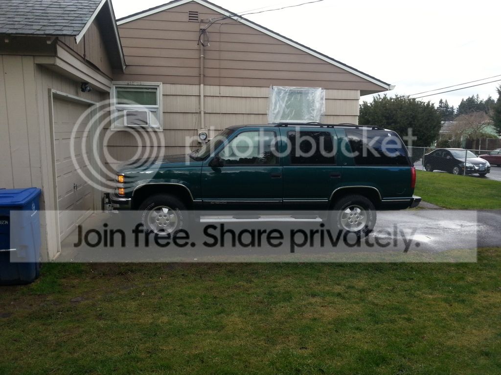

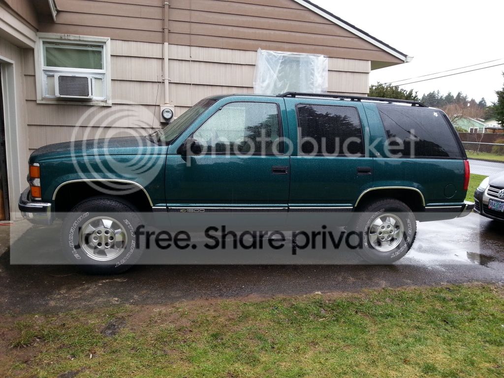

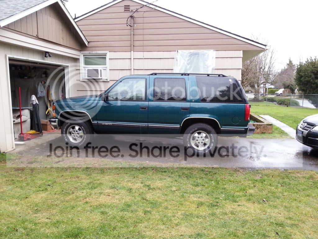

You will like it more after i pull the running boards and air dam off today! Its the perfect mix between blazer and suburban. Tho i do think i would like it more with a solid axle. Its tough to beat the ride and drive of the ifs, but its even tougher to beat the feeling of a solid axle.

Looks good... I hate running boards too!
On the 4doors do the back windows roll all the way down?

Good news i think. Turns out, those running boards sell for about $400 new. Mine are in very good shape so i have them on CL for $100. Should be able to get that for them i think.
