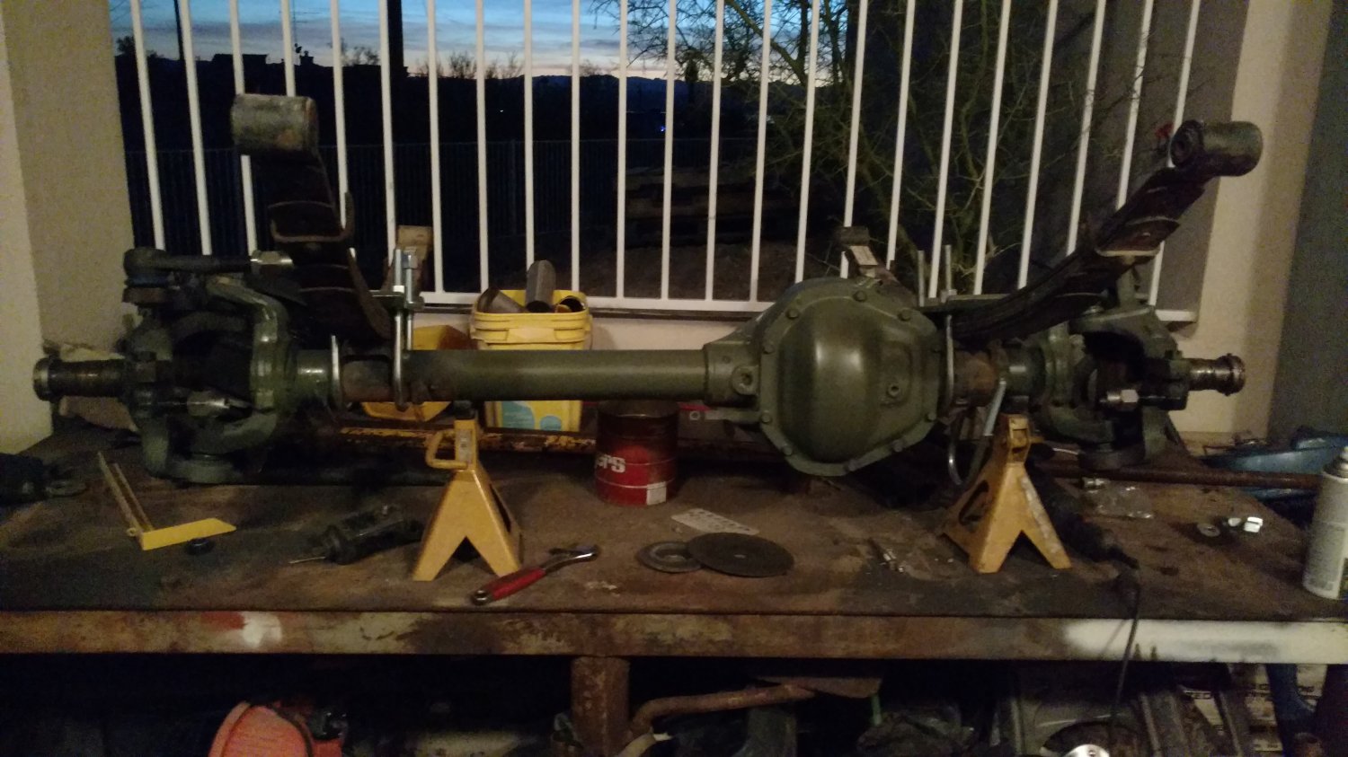

Found a HP 60 locally to start with. Housing, knuckles, calipers, spindles and rotors.
full

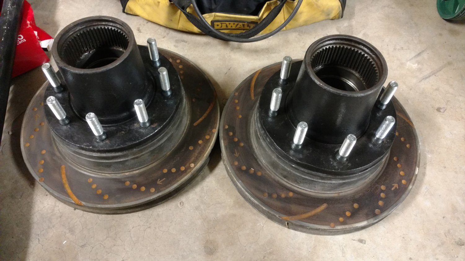

Cut tone rings into hub's to keep abs operational.

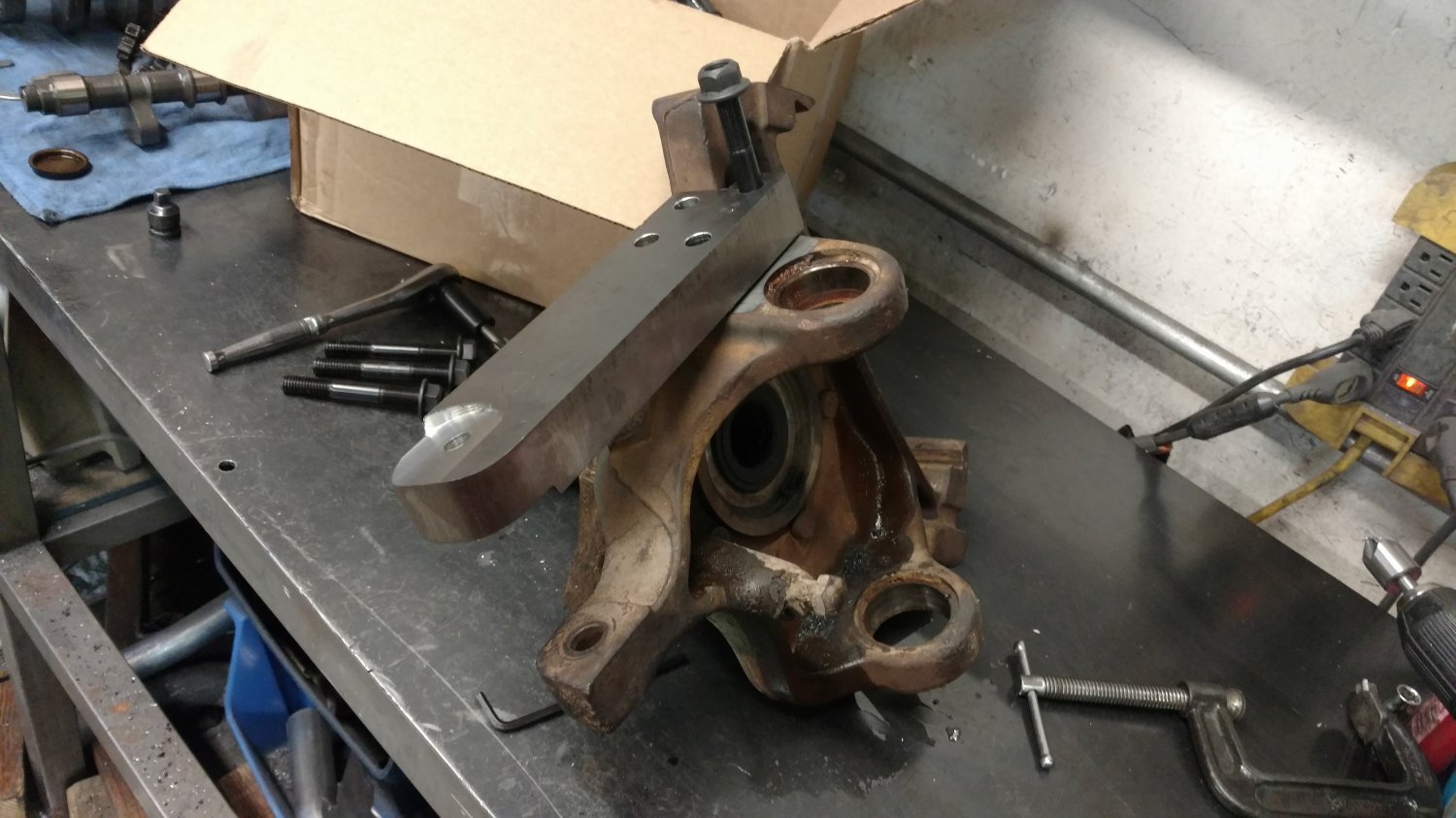

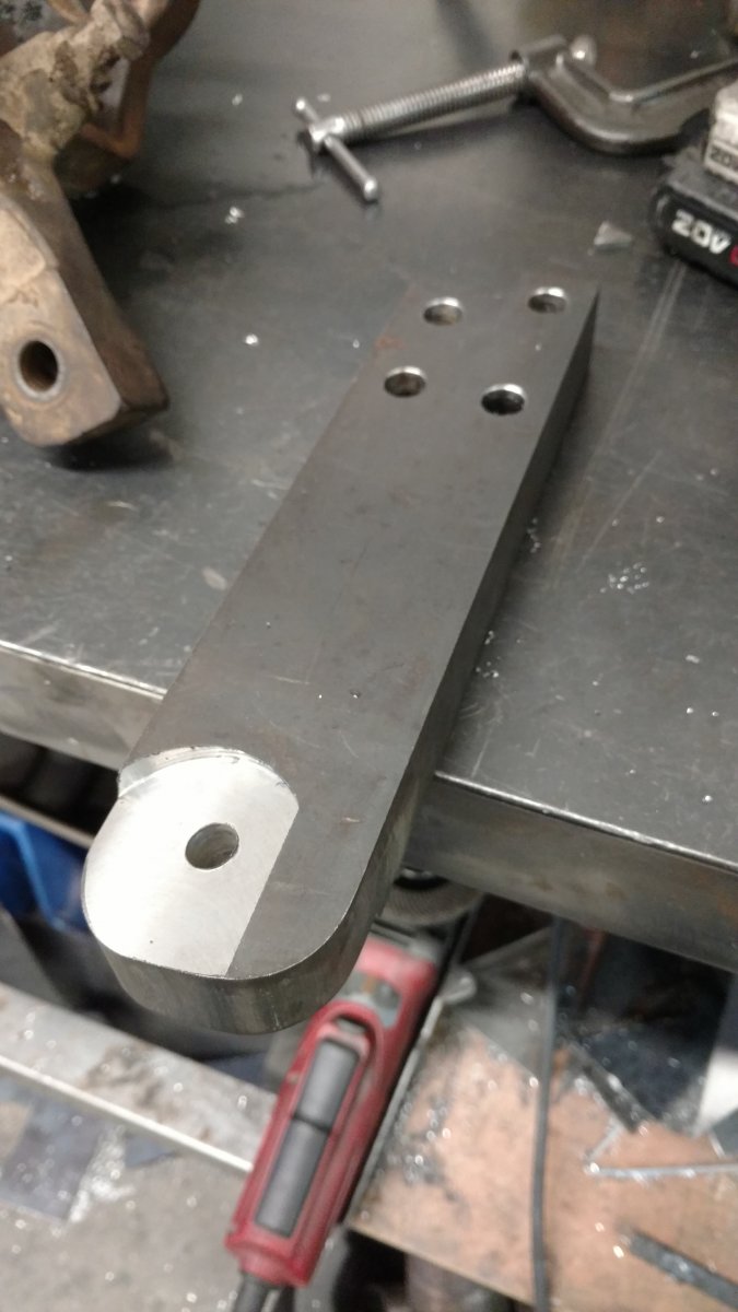

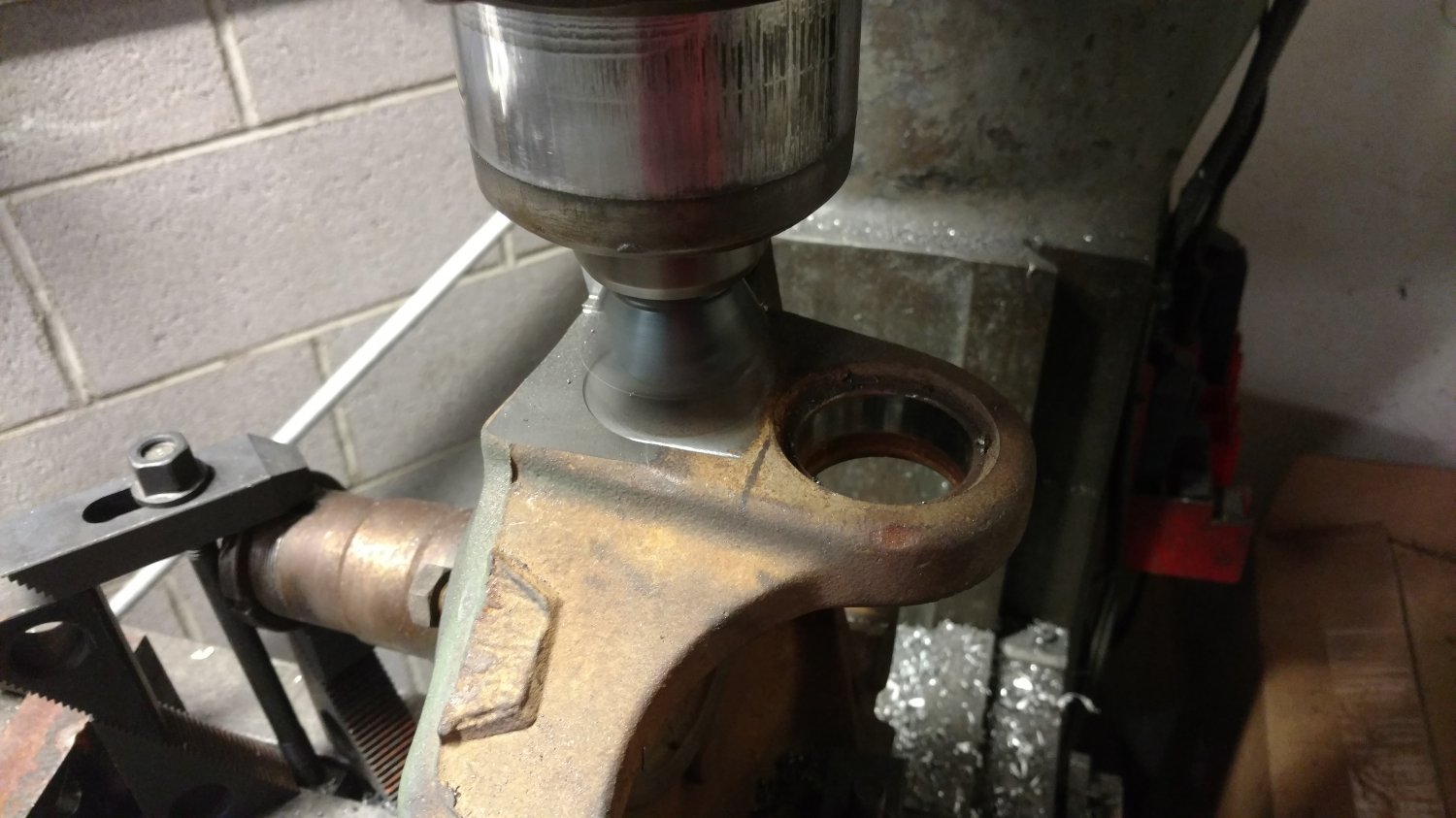

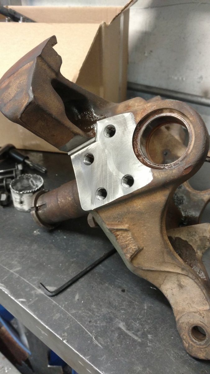

Had some time before work to mill the knuckle flat, drill and tap it and rough out the steering arm.

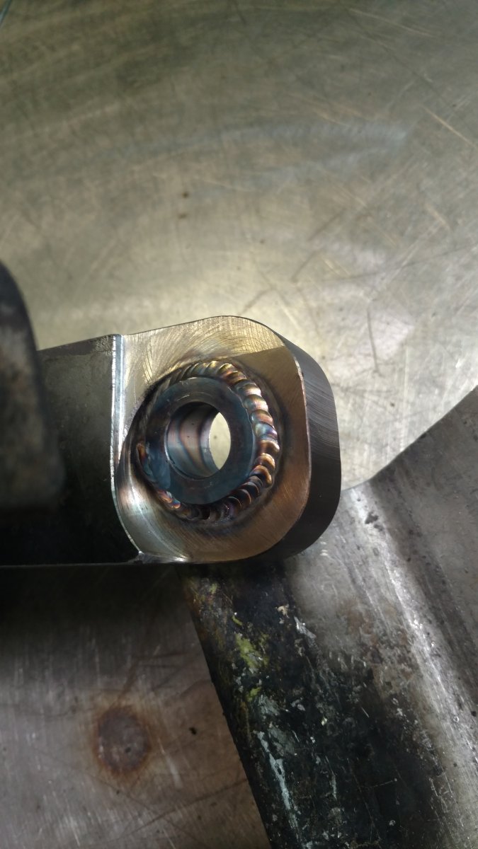

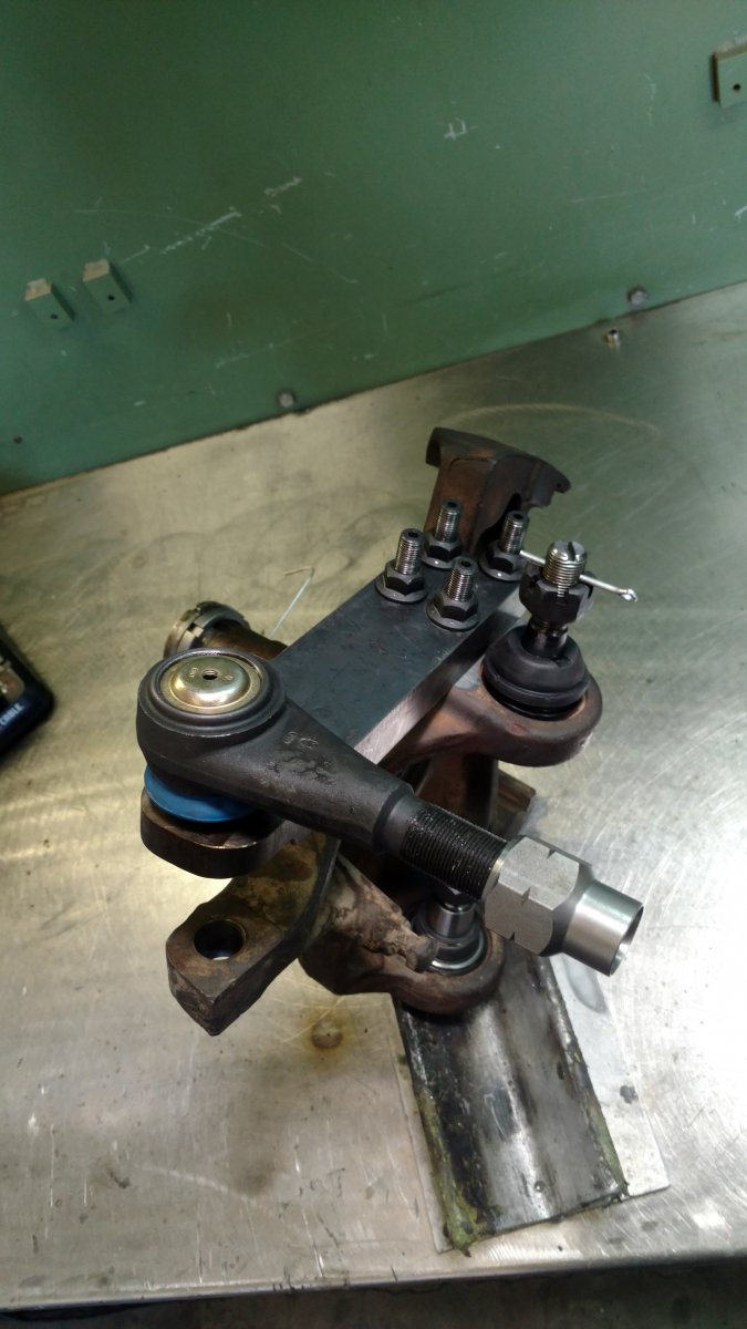

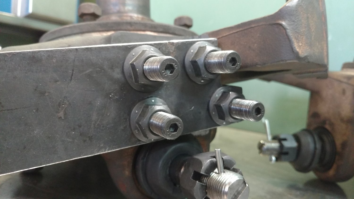

Got the steering arm finished up, and new ball joints are installed. Knuckles are done, just need some paint.

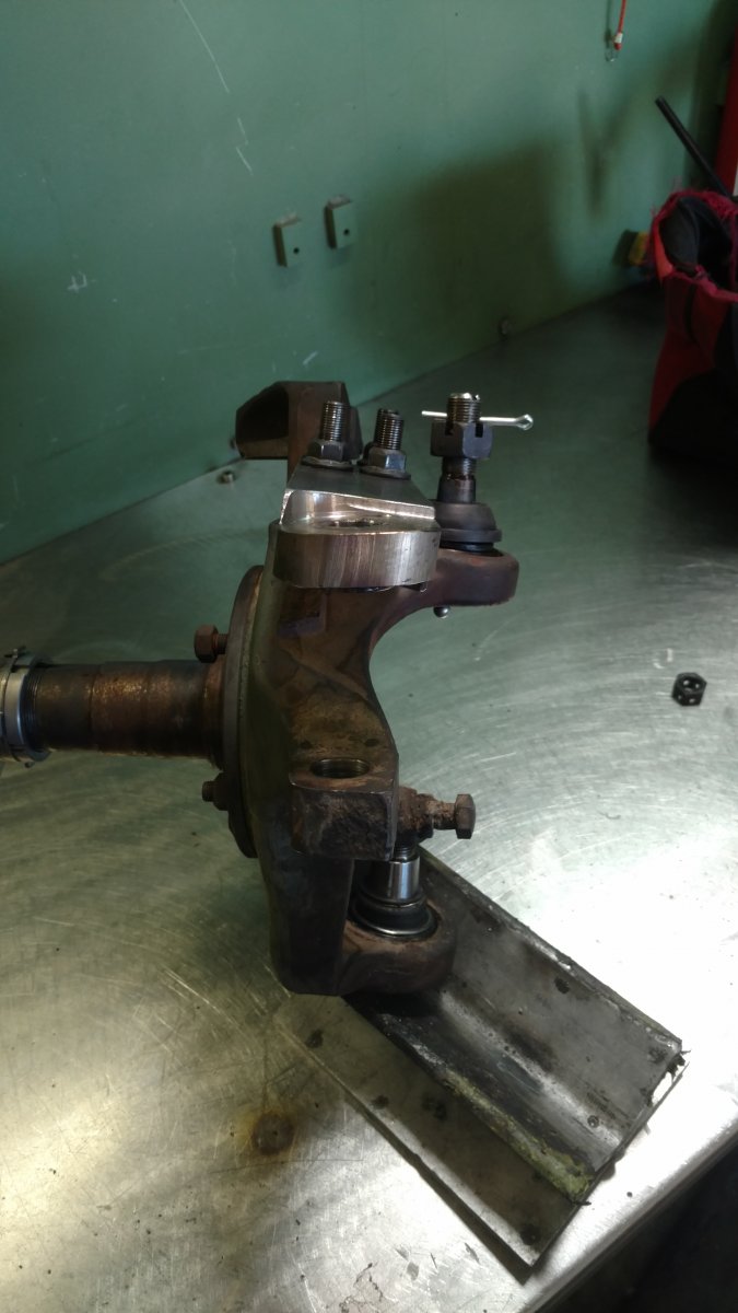

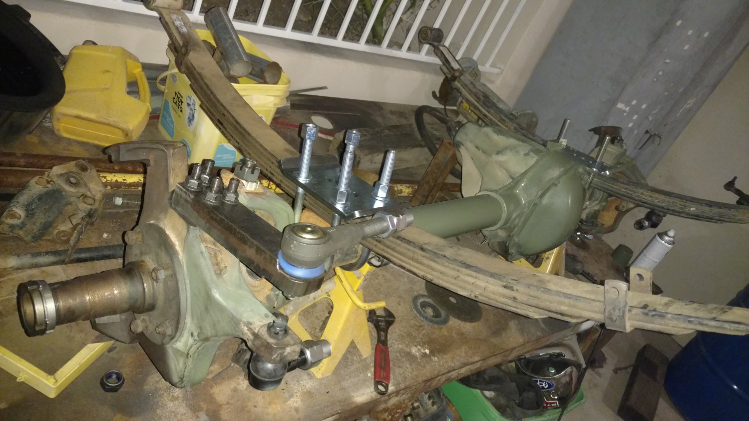

Mocked up knuckles and springs to check clearance for drag link and tie rod. Was hoping to move the tie rod to the top of the arms but not going to clear, so oh well. Also checked the color choice I've been thinking of, thinking it will look good.

Also got the hub's ready to go
