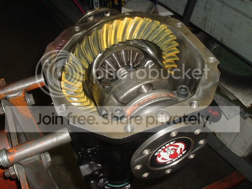

you could increase the size of the spider gears (if available from a larger piece) then blueprint, polish, and cryo the existing diff for a significant increase in strength...
The size of the differential is the actual problem. I know there's pics somewhere but think um well tiny. Big limitation of these cars but the motors can be built to pull way hard in the mid range. I bet my cars 60 to 80 time would hang with some that were way more powerful

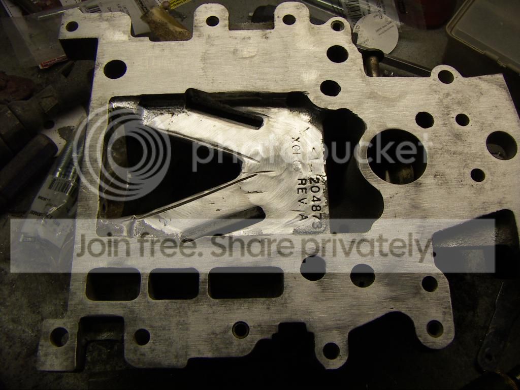

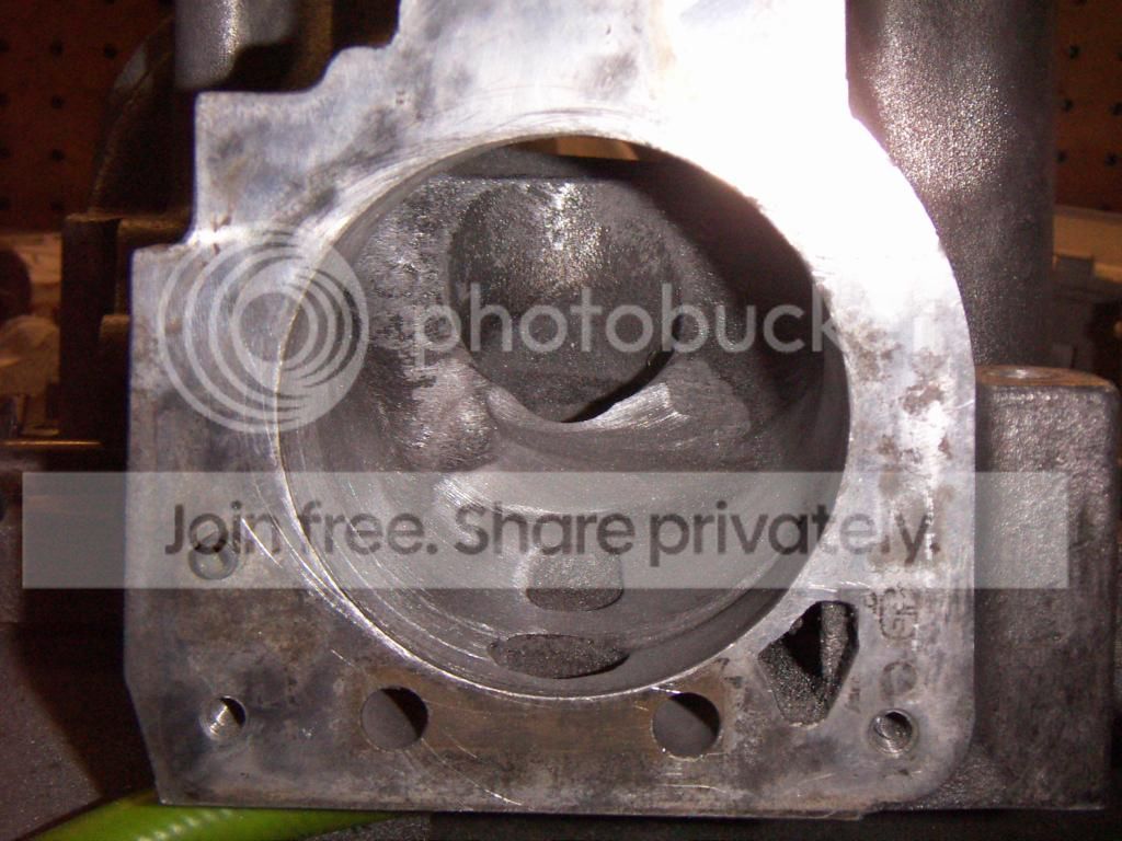

Got the supercharger ported. It turned out ugly, but should be functional. The inlet was enlarged from 67mm to 75mm, so I can run a larger throttle body on it. The outlet "arrowhead" was opened up into a "V" to emulate the Gen V blower design and sharp edges smoothed out. You can also see where I removed the little wall, helping expose more of the intercooler inlet - who knows how much that helps or not.

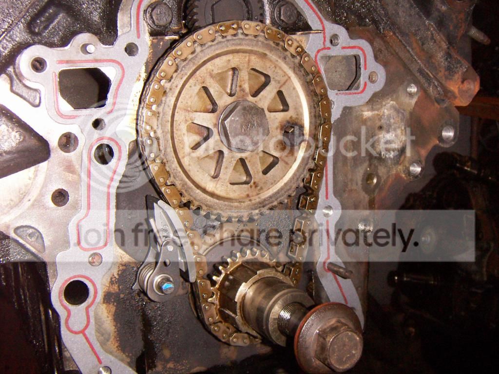

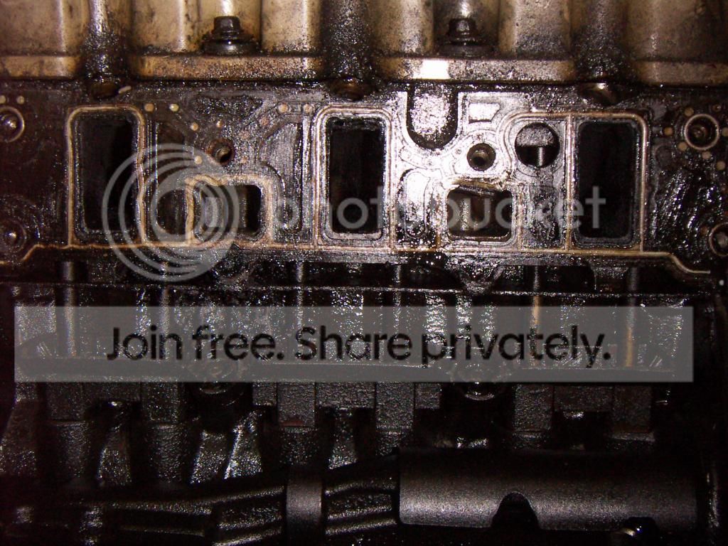

I expected the lower intake gasket to be bad on the donor motor, since they all are and there was some oil and coolant on the outside of the engine. I wasn't expecting all this sludge, though. I spent a long time cleaning it with ATF and brakecleen. This is a 140,000 mile engine.

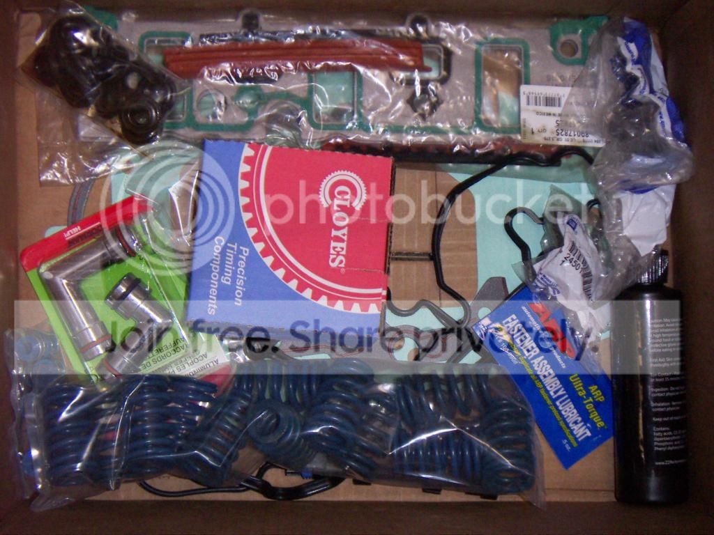

Kind of a weird one on the spring retainers. 11 springs went on fine, but the 12th has the wrong ID so the valve lock won't fit in it. I'll have to go down to ZZP to sort this out - plus they forgot to give me the rocker bolts that were supposed to come with the kit. So for the weekend:
-Got the top end cleaned up

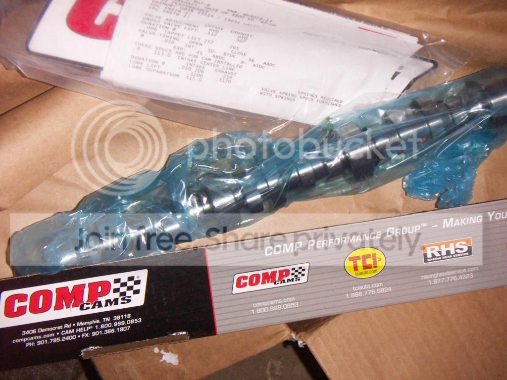

-Put the new Cam in
-Put in new valve seals
-new LS6 valve springs (90#) and retainers (except for one)
-Painted the valve covers and supercharger case.

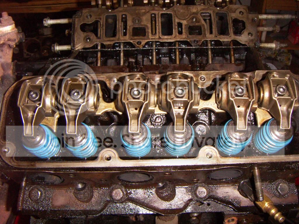

Help me understand hydraulic roller lifters here. I assembled the lifters, pushrods and rockers and then rotated the engine. Some valves would never close. I found many of the lifters couldn't be compressed, while a couple of them could. So I took all the lifters apart, cleaned them and depressed the little check valve in the bottom while re-assembling. Then I could easily push the pushrods down a little. After this I tested each cylinder with compressed air in the spark plug hole and all valves opened and sealed as expected.
So were the lifters just stuck from sitting around for a while? I thought maybe the oil would free them up, but if multiple valves were stuck open the engine wouldn't even start. Is this anything to worry about now?
Anyway, the valvetrain is done.
EDIT: OK, I did some reading about this - apparently it's normal for the spring in the lifter to raise it up once the rockers are removed, drawing surrounding engine oil in with it. So they end up at their top position and essentially hydrolocked. I'm not sure how you know the right amount of oil to have in them while you're assembling the engine, but it sounds like air is bad. But it seems like once you have oil pressure it should all take care of itself?
