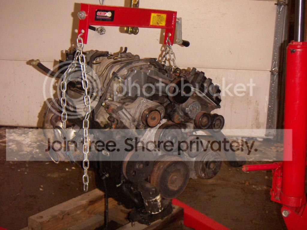

Look what I have:
It's from a 2001 Regal GS. 140k miles. Oil looks good, turns freely, still had some coolant in it, which looked good. Teardown will come later.

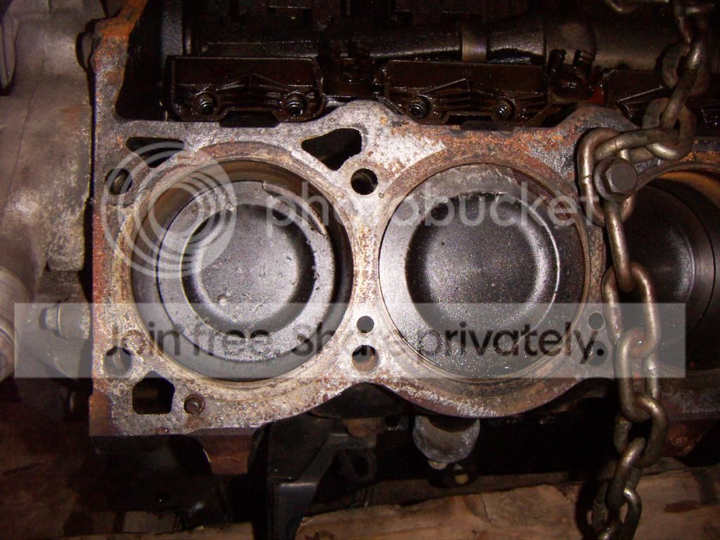

Here's the blown engine:

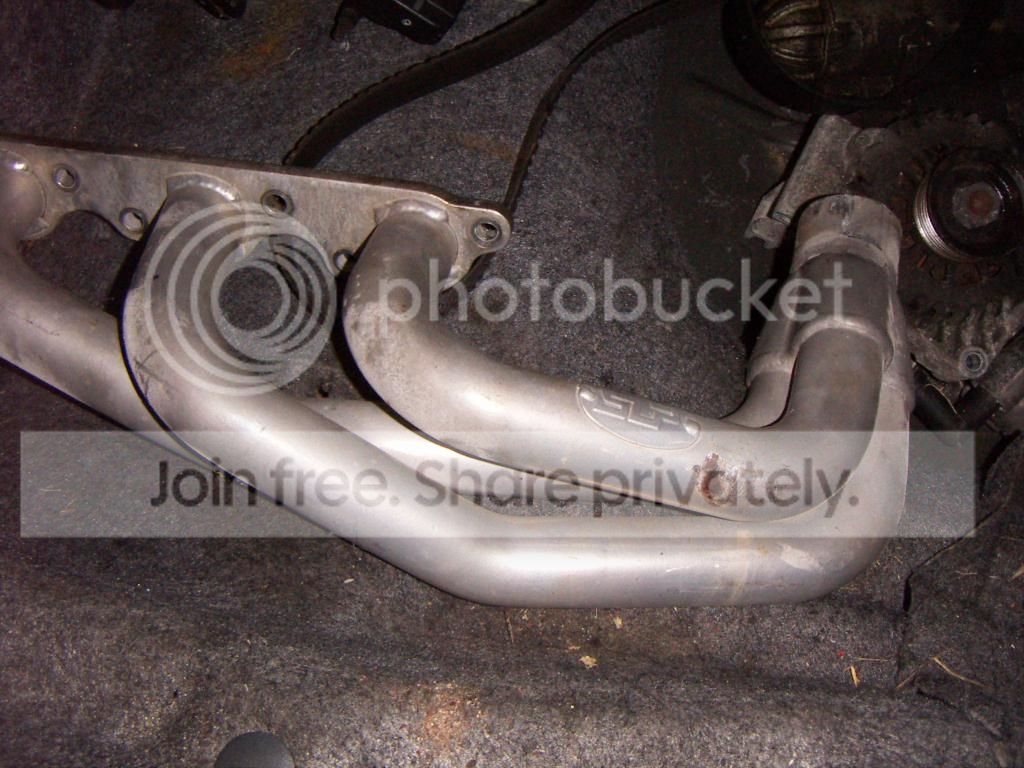

Car came with SLP coated SS headers. Will definately run these.

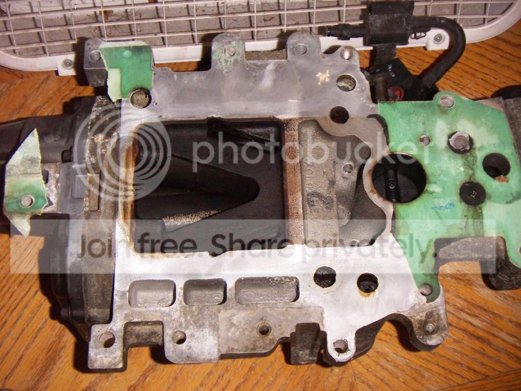

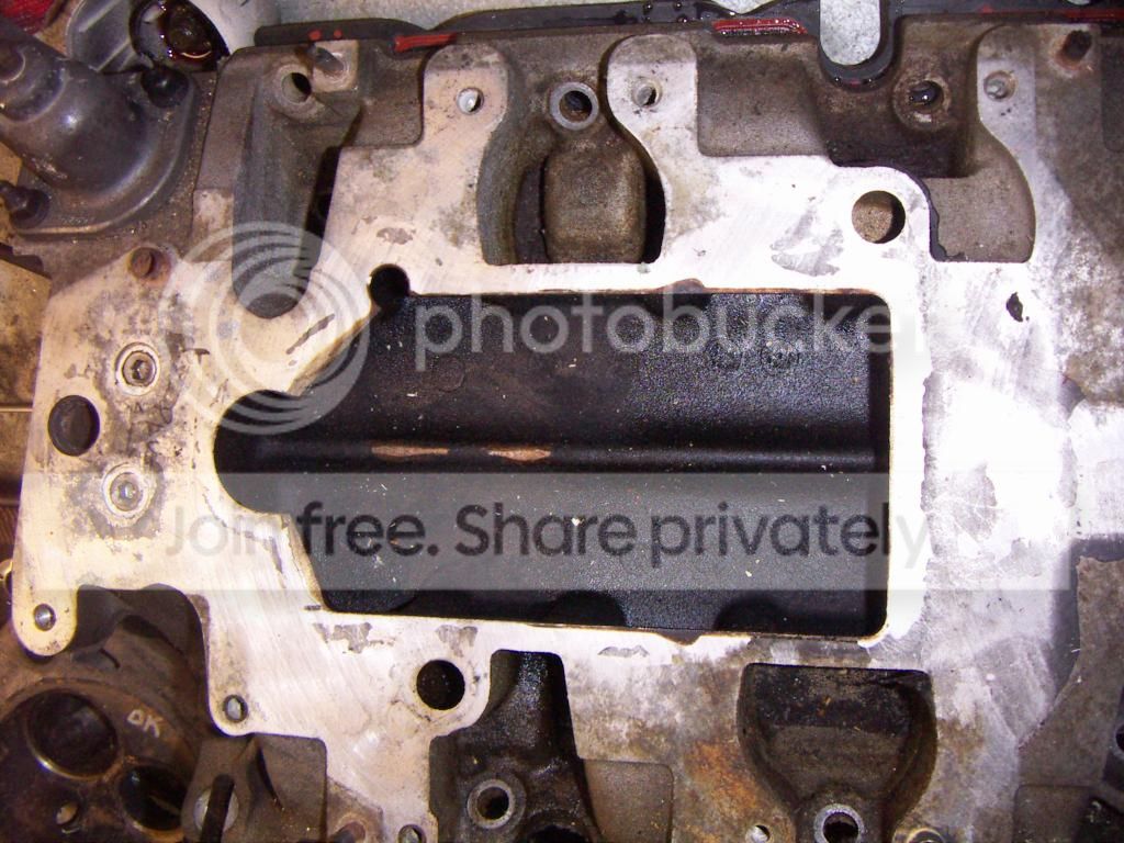

Lower intake manifold has been modified for the intercooler, but the blower outlet seems stock. I may do some work to the blower before installing it.
are you using the intercooler on the 01 style charger and intake? is that the gen v style? Im interested in incorporating that into my monte carlo swap.
Gen V is like 2004+. This is all the Gen III, which started in 96 or 97.

No plans to change compression. I would maybe have purchased an L36 instead. Really the ultimate plan would have been an L67 with the L36 intake manifold and a turbo. I'm planning to basically use the complete running engine I bought, but swapping on the intercooler and injectors from the blown engine.

-Supercharger is bone stock. No outlet work or inlet work. No machining was required to fit the pulley.

what is the intercooler from is what I am asking. I know some guys swap in the gen v stuff, but wondered what path you were doing. Simply taking notes.
The intercooler is aftermarket. GM never packaged 3800 with one. There is some minor difference in the intercoolers used for Gen III/V - something with the PCV, but the intercooler core is the same.
What is it? Air to water between the intake and S/C?
Yes. Then a water to air exchanger goes in front of the radiator. The system uses an electric water pump.
