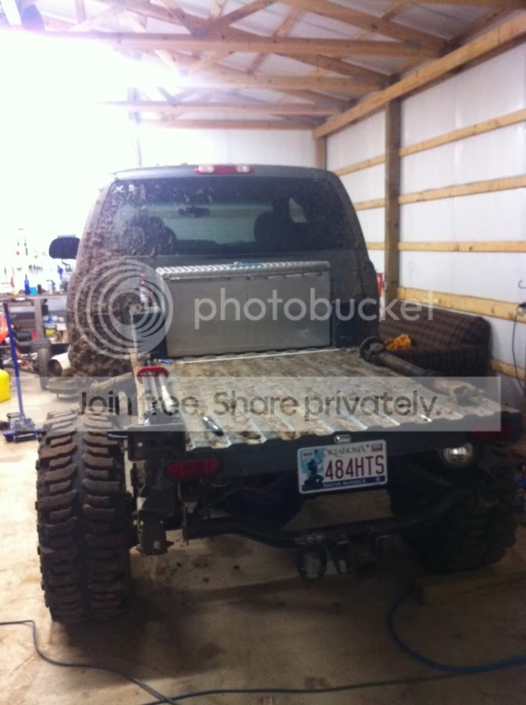

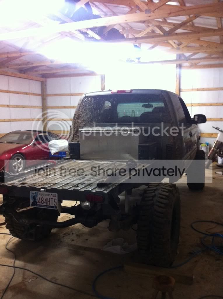

So not much tech, just mounted an old toolbox I picked up out of a trashcan at my old job and some ammo cans from the back of the K5 along with my high lift. Used some factory shock bolts tapped into and tack welded to the bed floor for the jack. I plan to mount a spare front shaft and a set of axle shafts on the right side of the bed in pvc pipes. I also left room for a spare in the center. I need to find a good ax and a small shovel to mount as well. Mounted a light from a quad as a reverse light, and wired my trailer LED tail lights into the trailer plug so I would have turn/brake together.
Anyway, pictures from my phone, as usual.
