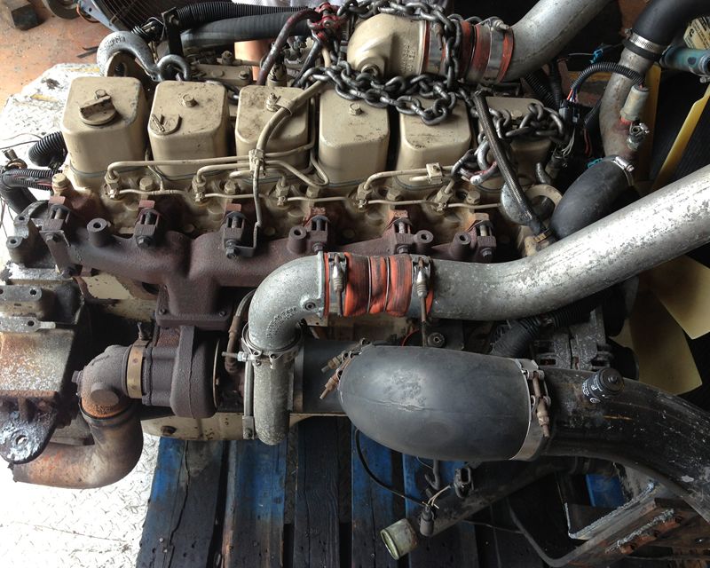

Let me save you some monies, and give you more room under the hood...
