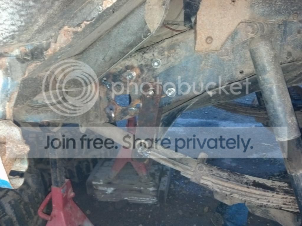

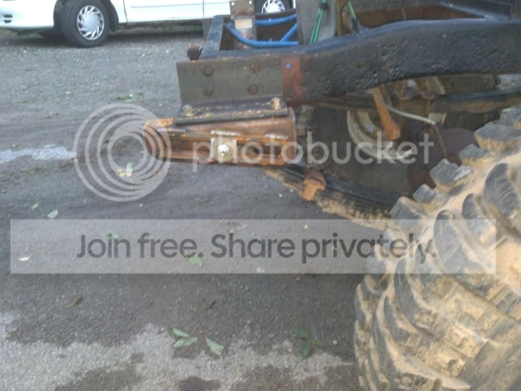

liquid iron sliders for the rear.
on the front i gave it the standard move the rear hanger forward.

Was finishing it up tonight, putting some degree shims in for shaft clearance. Had to take the shocks of for more clearance and realized the driver side was completely blown out and the pass. Side wasn't far behind.
Those sliders were $150
They are beefy though. I had to clearance the front so the spring doesn't bottom out..
