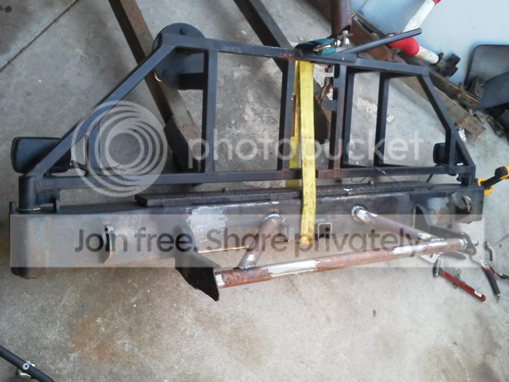

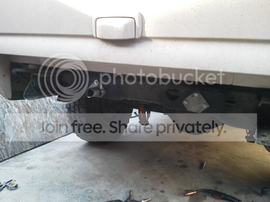

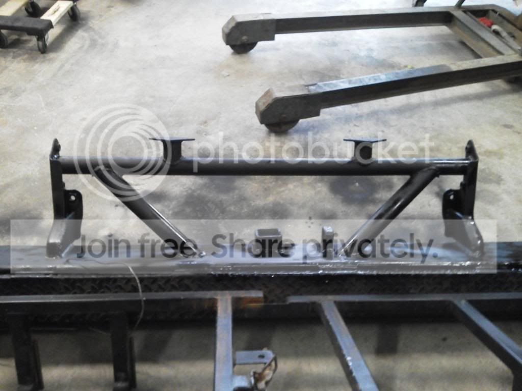

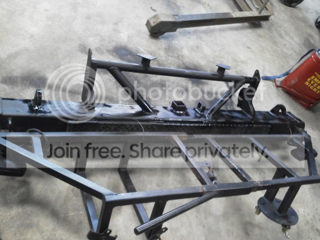

I spent the day finishing the rear bumper frame ties. I think it should be strong enough to pull a trailer or maybe even a tree. I welded heavy hex nuts on a 1/4 plate and put it on the back side of the center crossmember for extra strength.
