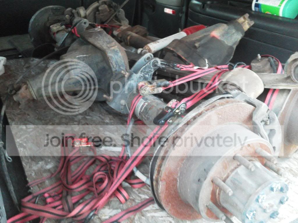

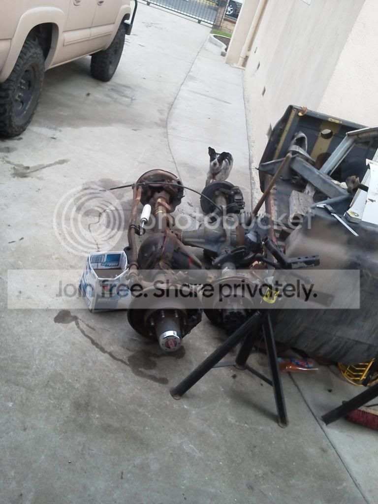

I did it! Found another axle set that I think I scored on!
D60 HP Kingpin & D70 with disc!!!!!!!
1200!!!!!!!!

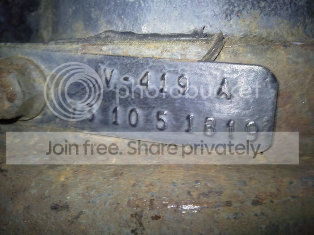

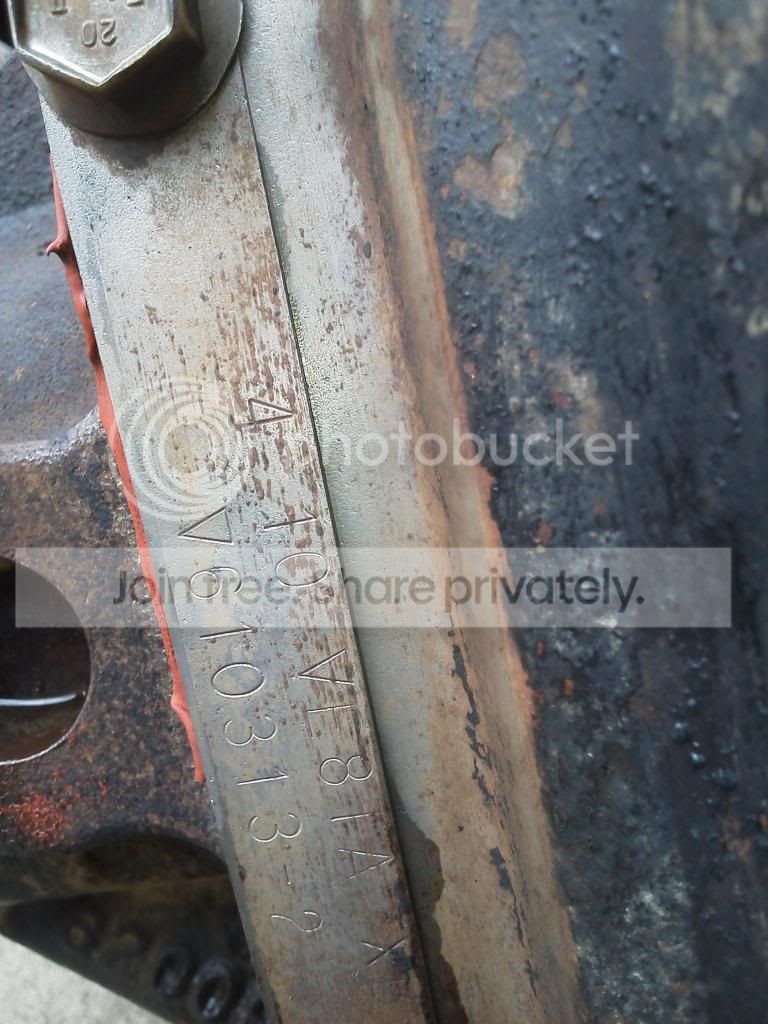

Anyone know what the id numbers could mean? I don't know what the donor vehicle was or the gear set. The frt id tag is unreadable and the rr seams odd to me
620093R - supposed to be out of an F2or350

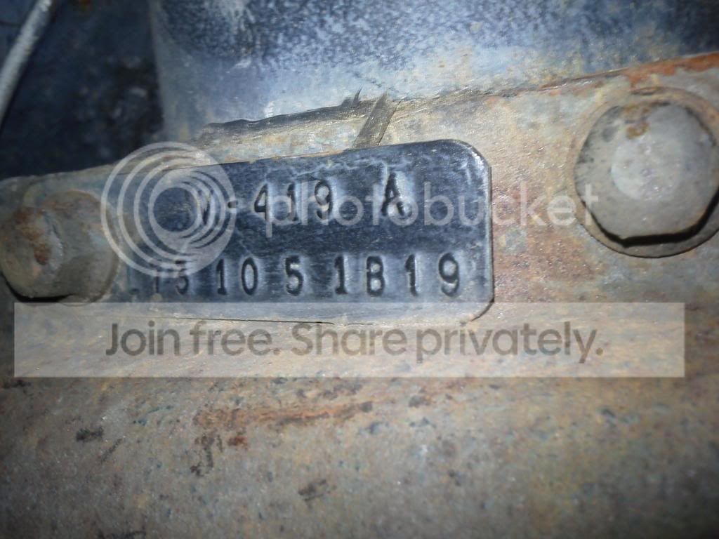

rr id tag

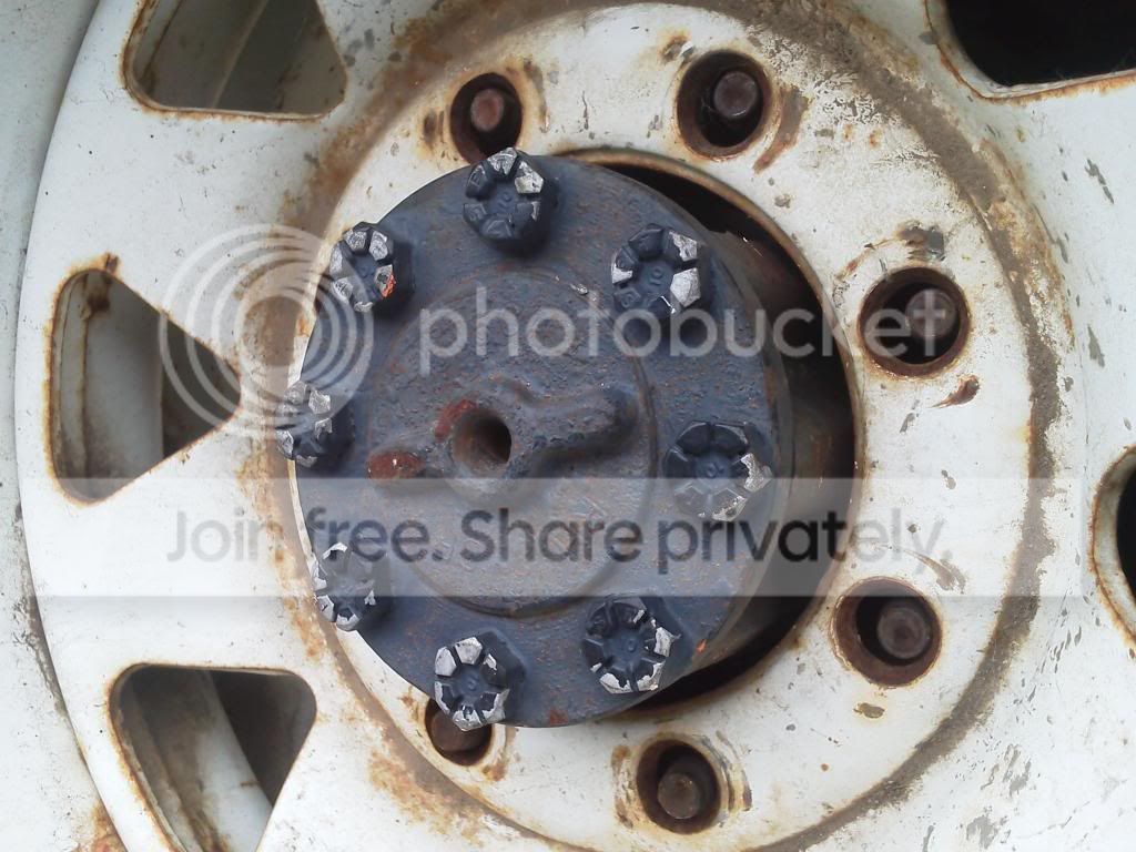

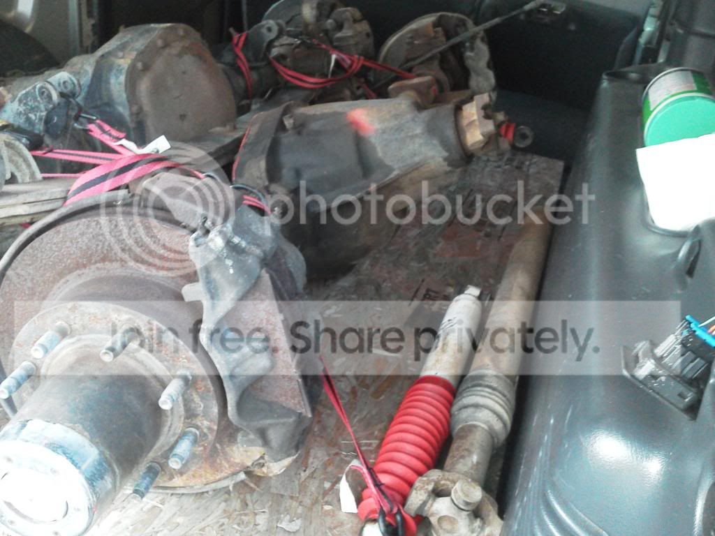

Front is just what the doctor ordered. Rear looks to me like a stearling 10.25. No? Better pic of the pumpkin area?
yep sterling rear. possible metric pattern 99-up stupid duty rear . check for 8x170 mm pattern lug studs .

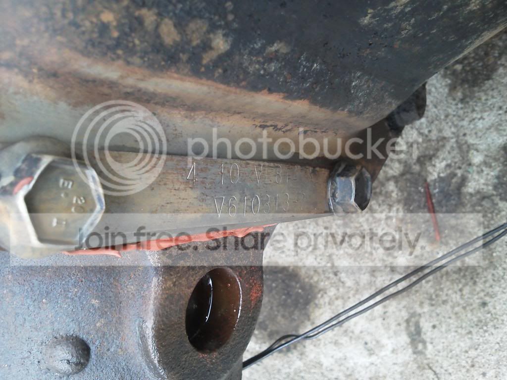

FRT ID tag
rr tag:

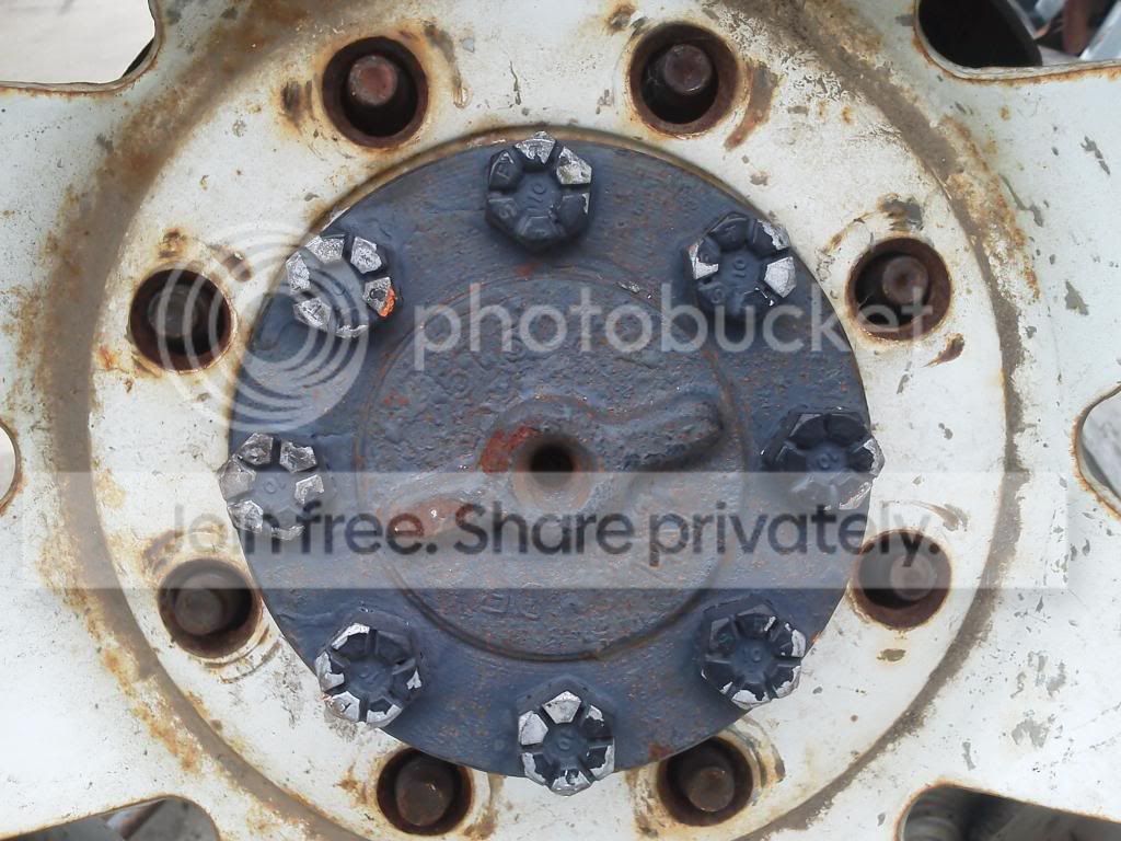

RR wheel fitment - measured from stud to stud - minimal difference but no go
Can't I just open the holes 0.020" - will that be unsafe?
oops - how would the wheel run true right. Damn it! I thought I scored the rear as well. I want a full floater with an ebake

front is 88.5-91.5 srw king pin 4.10 gear f350 axle aspr dana site on your bom #
rear might be able to swap hub n rotor over from van or older axle possibley . i know vans didnt get the metric as soon as the trucks did . but that would be reading / searching / test fitting.
You still didnt get a bad deal really. $1000-$1200 is about the going rate for that front axle.
