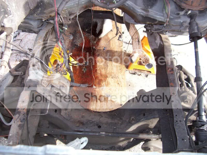

Basically all that has happened is I got the tranny out and the innder fenders and the stuff in the way
I'll gunk it and pressure wash the grease off, There is 0 rust on this truck besides the surface rust on the roof

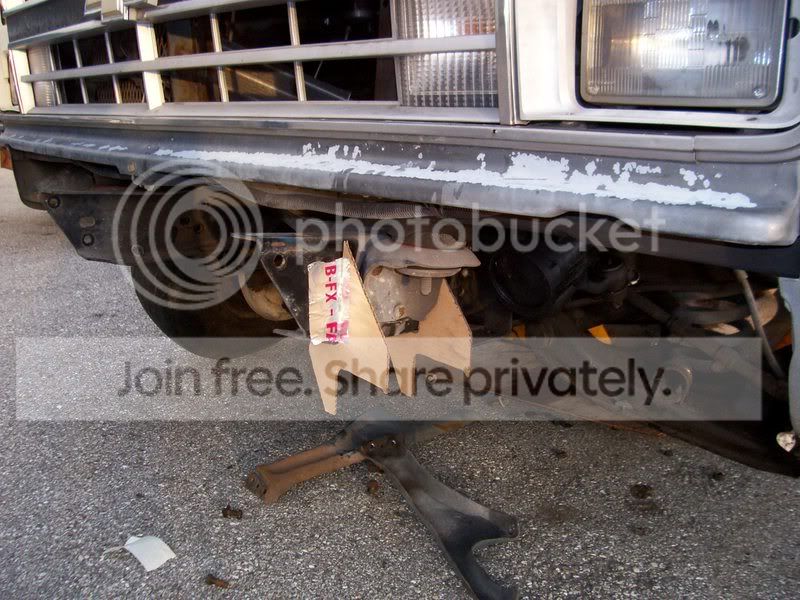

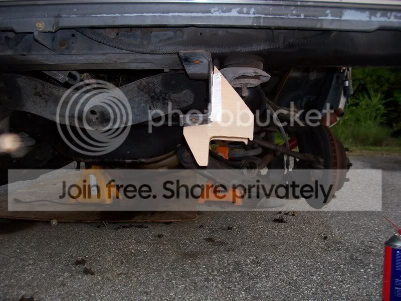

Oh I didn't post the mock up here

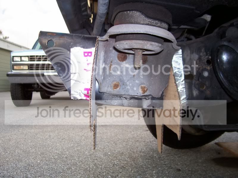

I'm going to trim the body mount so it fits a bit better

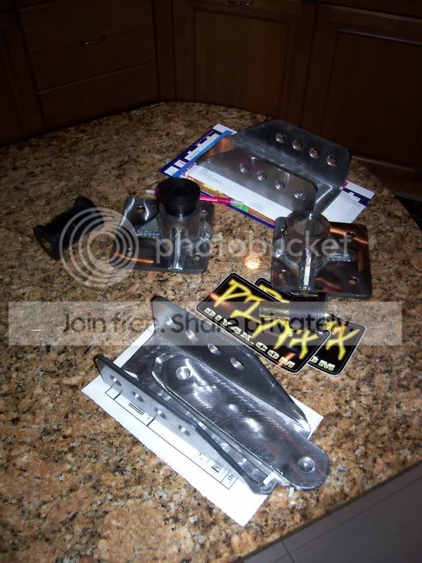

I got all my parts today
110 bucks worth, Actually 97 plus shipping
what are you going to do the for the front spring hangers?
I had custom brackets cut
You'll see when I put them on
