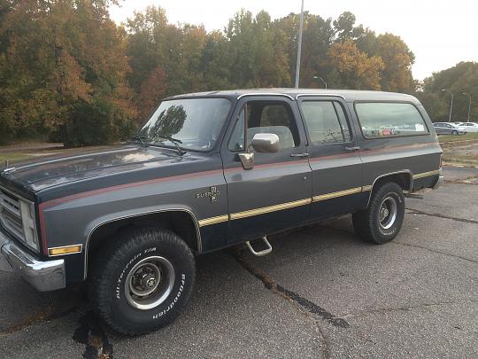

That's a nice, clean looking truck, if it were mine I'd not want to modify it too much if you can stand not to.

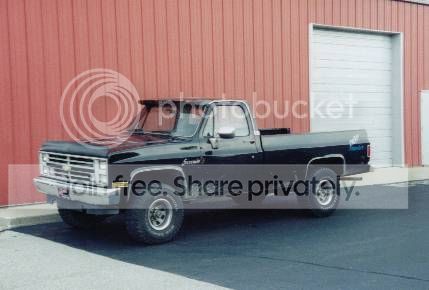

I have considered that option as well as 32x11.5s. I also agree, I'm trying not to change it too much. I actually just found a picture of exactly a 2" lift with my same wheels and 33s and I like the look of it... thinking this is what I should do and call it good.

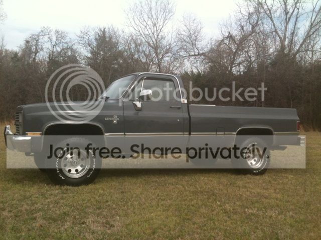

I really like my stock wagon wheels, but I just stumbled on this and I think it might be the sharpest looking combo ive seen so far. 2" lift with 32x11.5s and 15x10 wheels.
