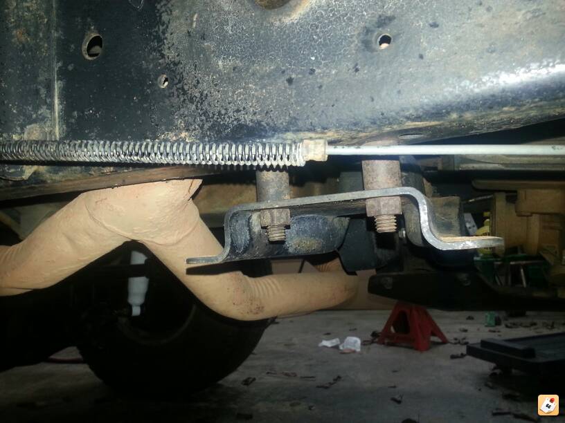

4'' Lift Excessive Pinion Angle?
I can tell just by the pic that the vibes are coming from the shaft/u-joint angles.
Cheapest way out is a slip yoke CV, this will retain an original slip yoke at the t-case with a double cardan joint (this is what I had done). None of your old driveshaft parts can be re-used cause GM originally used some special press in yokes that no outside shaft shop ever bothered to buy the tooling for. It's easy enough for them to just replace the whole unit at minimal additional cost. And your original slip yoke is not a CV type, so you'll need a new one of those anyways. I had a local shop build me a new shaft with a slip yoke CV for about $300. To save money for me they utilized a used CV they had on the shelf.

Thats good to hear, I spoke with tom woods driveline and they went on and on about needing a SYE in conjunction with a CV shaft. So you're running a slip CV shaft with no vibrations? If that's the case, I'm definitely going that route. Hopefully I can have my local shop build me one for around 300. Thanks for your input

I wonder if dropping the tranny cross member a little bit would help? :dunno:
I've seen it done before.
Its already got the factory 1" spacer in place, I'm afraid to drop it anymore because it could make the front shaft bind. I have already clearanced the front CV and hope that's the only mod ill have to do on the front. I think I'm just gonna sack up and spend the money on a CV shaft.
It does not come spaced from the factory, but the spacers are there. If yours are not in place, look inside the frame rail at the tcase crossmember. There should be a space there; just relocate it.
After you get a CV shaft, relocate those spacers back to the top of the frame rail. Between the frame and x-member (like shown) puts stress on the frame rail that it wasn't designed to hold. I've seen them crack or break the lower part of the frame rail right off. Prob not an issue for a mostly street driven and mild off road rig, but start getting twisted up or dragging that x-member over rocks and it will eventually fail.
And, yeah, TW will try and sell you on the SYE cause that's what they sell and that's their job. Don't get me wrong, it's an awesome set up, but for a street driven and mild off roader, you'll get by just fine with a slip yoke CV shaft.
Check with High Angle Driveline and Tattons (can be found on ebay) for pricing as well.
Those factory spacers are not for dropping the transfer case. They are to obtain greater bolt stretch and keep the bolts tight. If you did want the case lowered, you should use a piece of square stock as long as the crossmember is. With just two stress points you can bend or crack the frame - although a lot of people have gotten away with it for a while.
When getting the driveshaft built or modified, make sure all of the measurements are taken with the crossmember up where it belongs.
That makes sense, never thought that was their purpose. Once I get my shaft made ill swap them over. Thanks for the insight
