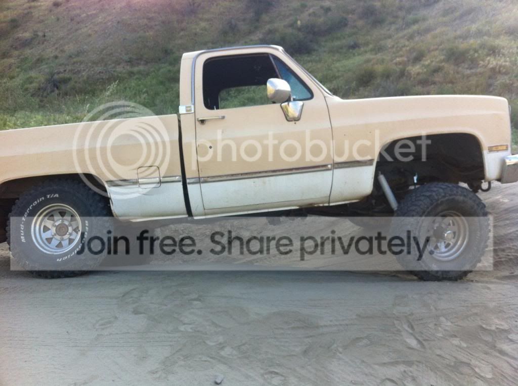

Well let me fill yall in on what im working with.. This is how my truck sits
Im not sure what leaf springs are on it, One guy (that i almost, and still may, buy a set of 4" lift springs from) told me he thinks they are stock.. doesn't seem like a stock ride height to me.

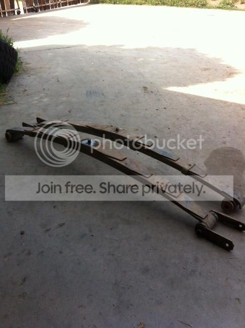

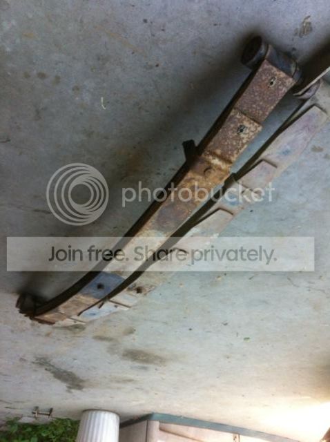

These are the springs off the truck:

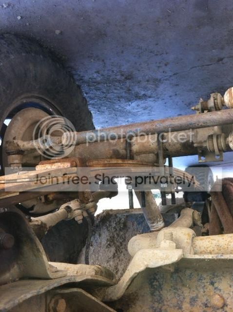

And here is on the truck:

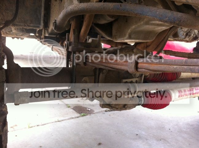

I personally think they are old Rancho Lift leafs, reason being is this wrap over second leaf:

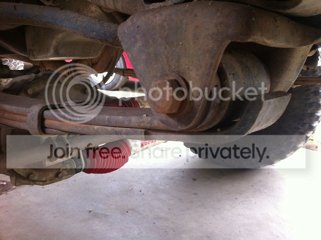

Leafs before and after:
How they sit now:

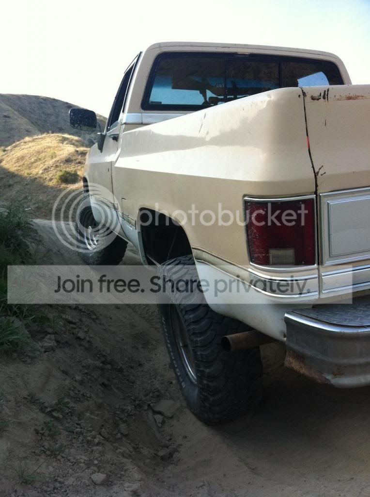

Some pics:
I didnt get a pic of the front springs at the time sorry...
Why not just lower your bump stops and keep the shocks you have. Looks like you've got more than enough flex
