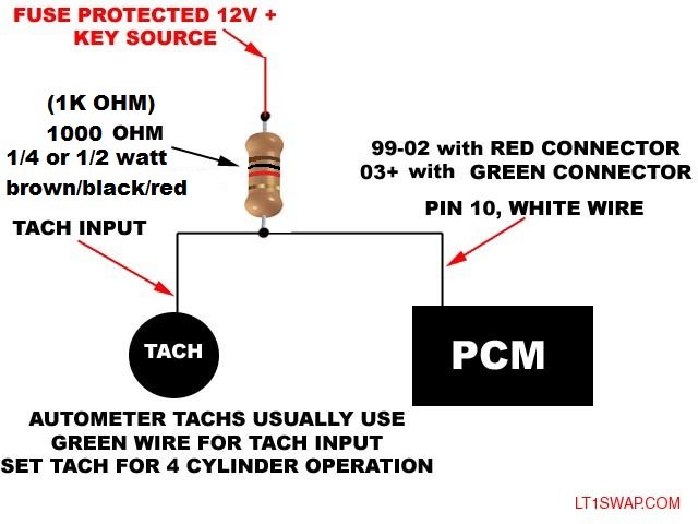

this is for supersize75k5 or anyone else trying to hook up a tach to the lsx engines...
First off, you need to set the tach to 4 cylinder mode. even though the lsx engines are v8s, the rpm out signal is a 4cyl signal. Some tachs have a switch to set it to 4cyl., others you usually have to cut both "loops" of wire on the tach to change it from 8cyl.to 4cyl.
If you are running a 98-00 PCM you can probably just hook up the tach signal wire from the pcm to the tach and it should work fine.
If you are running an 01 newer setup you probably have to do this little trick to get the tach to function properly.
