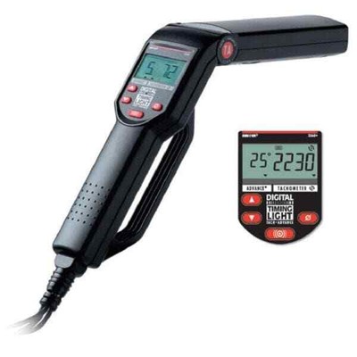

will be picking up this for future troubleshooting….
