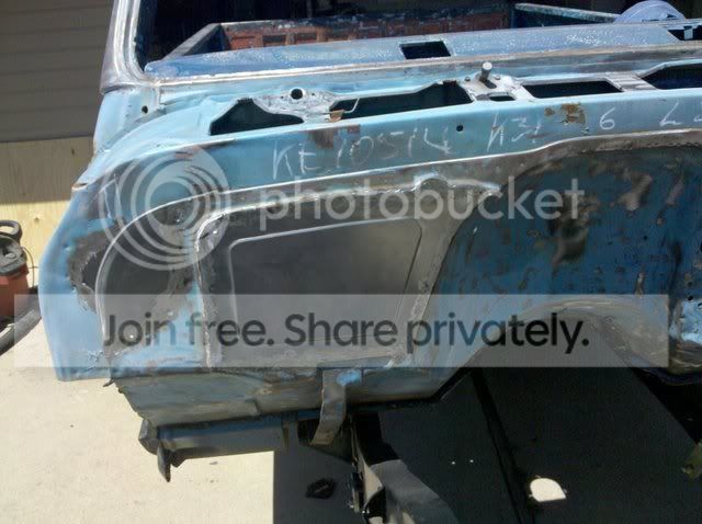

Did some work on the firewall, here is where I started:

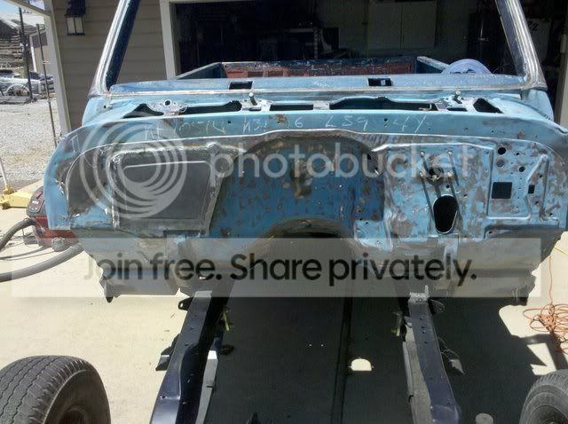

Next:
No heater? It's cold up there in nor cal, how you gona keep your feet warm?
On another note that ovalish hole just under the booster rod area, home made? It's not like that on mine.

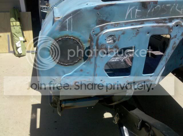

Still going to run a heater, just and aftermarket one. A Danhard is what I am leaning toward. That stock heater assembly took up way too much rooom under the hood.
Are you talking about the clutch rod hole that I filled?
I like that you kept all the original grease pencil writing on the firewall....nice touch!
Originally you had talked about putting a smallblock in this build, but recently there are BBC photos... is that where you're headed now? Any plans to modify the firewall now, or are you going to wait until the motor is back from the builder and then do some "test fitting"?? :thinking:
Don't be discouraged if it won't just drop right in....they don't. Fortunately, it's obvious that you have the metalworking skills to get the valvecover clearance you'll need.

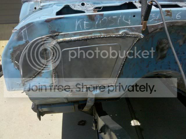

Yeah, I had to sell the 78 to pay for a house remodel...So I did not swap everything over as planned. Then I figured if I am going to build this thing for fun I might as well put a big block in it. It will not be my daily driver so 8 mpg is fine with me.
When I get the BB back I will start to see where I need to "adjust" the firewall to make it fit. When I get done I want it to look like it was made to be in there. No bashing...
