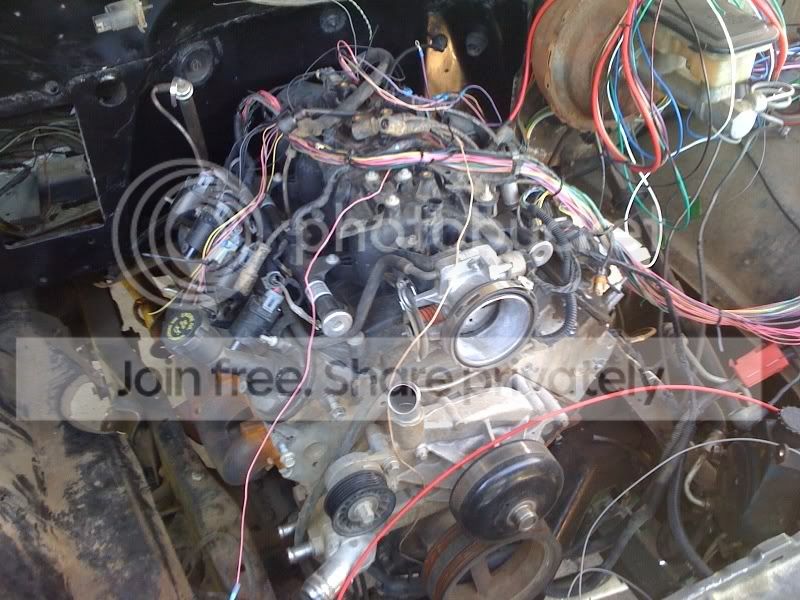

looks like the k5 wont have OD for a bit longer than expected... old motor should pay for it and hopefully with the right gears mpg wont be too bad.
