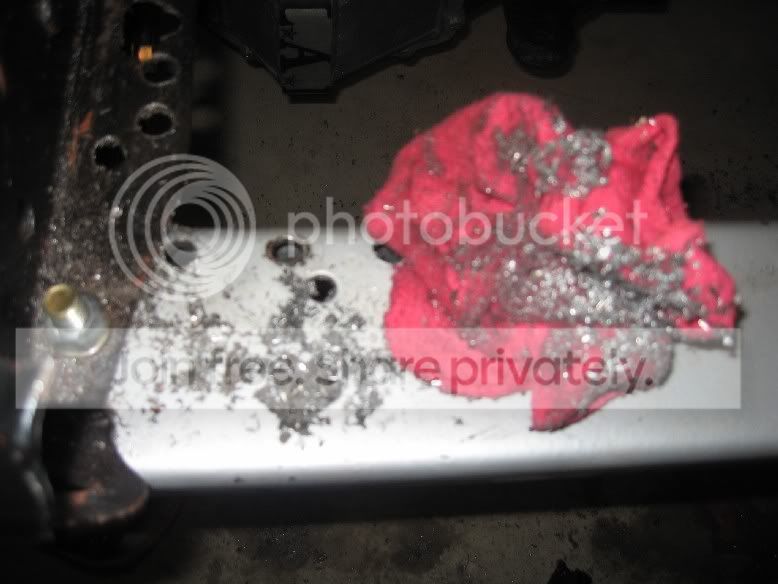

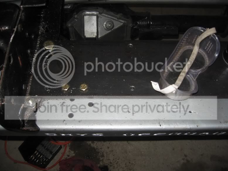

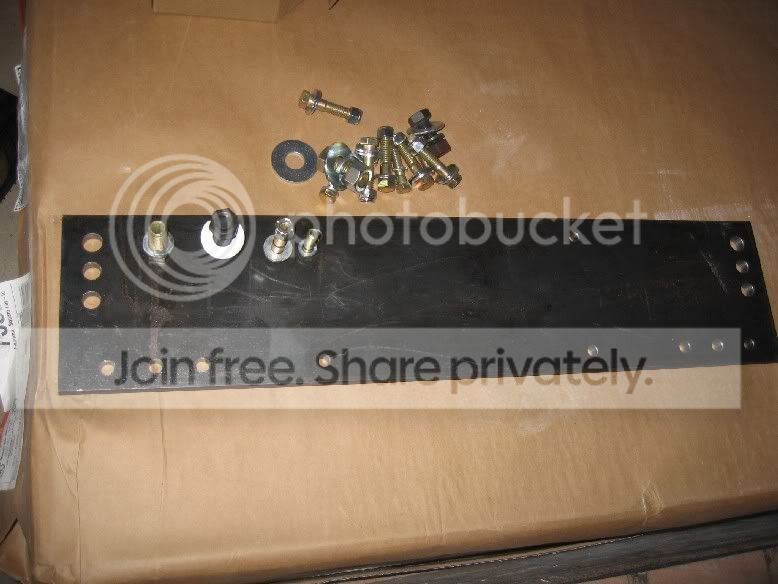

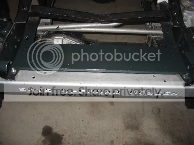

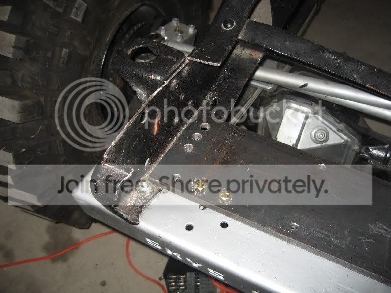

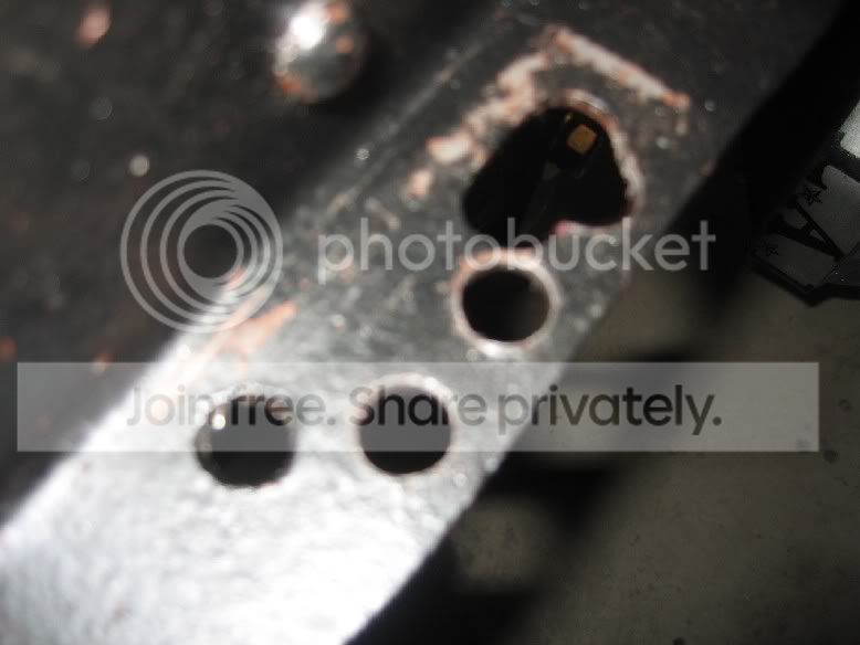

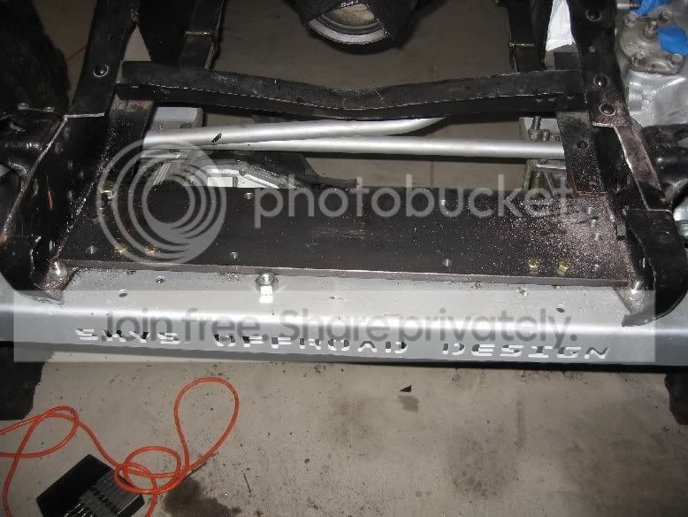

Well managed to mount the winch last week. Used 1/2" steel. It's tied to the frame with one 5/8" grade 8 bolt and two 9/16" grade 8 bolts on each side. Then there's six 7/16" grade 8 bolts bolting it to the front spring x-member. My battery ran out tho, before I could snap pics of the winch actually mounted. All in all, I had to drill 14 holes. :shaking: But the holes in the plate were drilled by a local machine shop...having to drill 1/2" steel with a hand drill :barf: Also got it over to my buddy's shop CBC Offroad so we can start the 'cage hopefully some time this week. I'll get some more pics tomorrow.

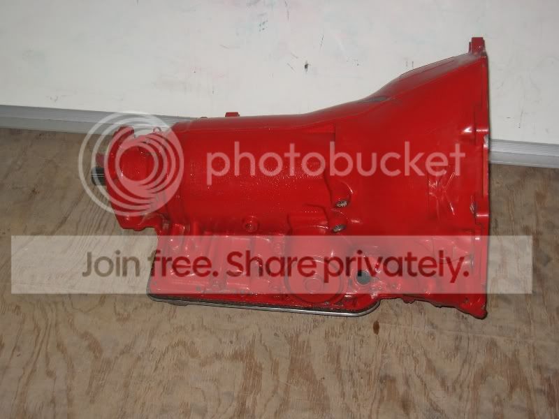

2 years later & finally got my tranny. Pretty much built to the hilt, we'll see how much of that is true once I run it. Full Reverse manual valve body, performance clutches, sprags, etc. The only thing I might change out is the TC to get a lower stall speed. Also got the last adaptor I need to connect it to the 203. DOM for the 'cage is in. I got my propane tank clamps and some snatch blocks. Hopefully we get my propane tanks this Friday and I order up my VFF 30 fuel lockoff this week as well. :D
