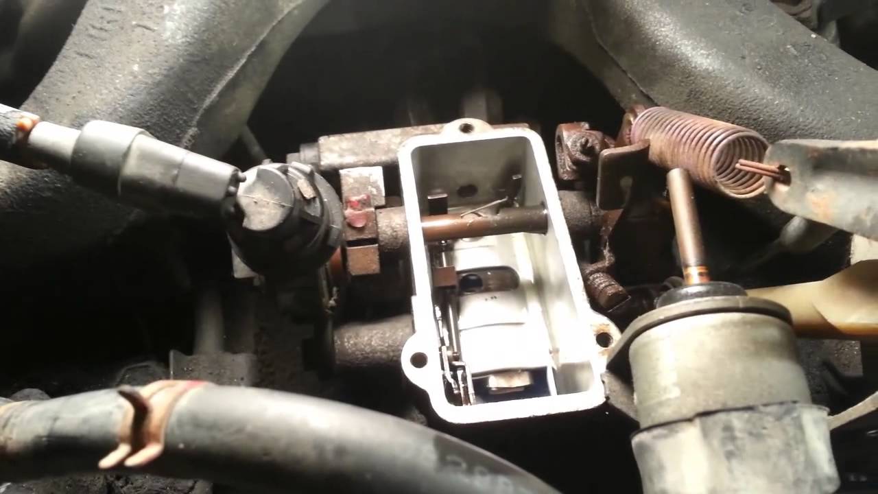

A 1/2-ton diesel with a factory TH400? Didn't know that was possible, the TH400 vacuum modulator occupies the same spot as the TPS that the C-code emissions engines got. :dunno:
You know, now that you mentioned it.....I took the owners word it was a 400 and 208. I never even looked. Guess I should do that huh....
Looking at this picture:
image-jpeg.227708
You don't have the vacuum modulator there on the left side of the IP. So I don't think you can have a 3-speed in that truck. Here's what a TH400 truck should have:
Not really. The other stuff was recent work. I don't think the rest of the truck has ever been touched. Pretty sure it has never been out of the truck. I'm fairly certain he was guessing and I never bothered to look.
