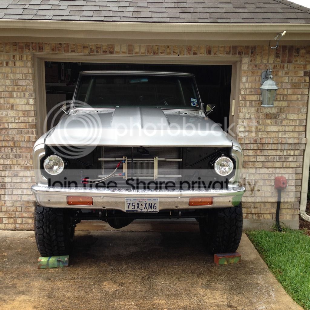

Before vacation started putting some of the clothes back on. Still need to do the inner fenders (they'll go absolutely last) and the grille. Hood shot sticking out from the garage.

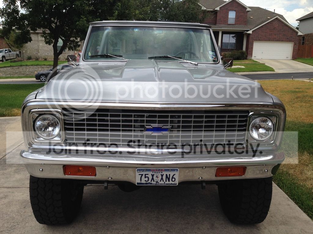

UPDATE 8/12/15 - Sweatin the small stuff. Slowly making progress.
Got the leak in the temp sender squared away. Unsuccessfully tried a few things and ended up using a thin bead of Permatex watertemp housing sealant. Left a few threads clean and still have good ground contact on the sender. Check that one off.

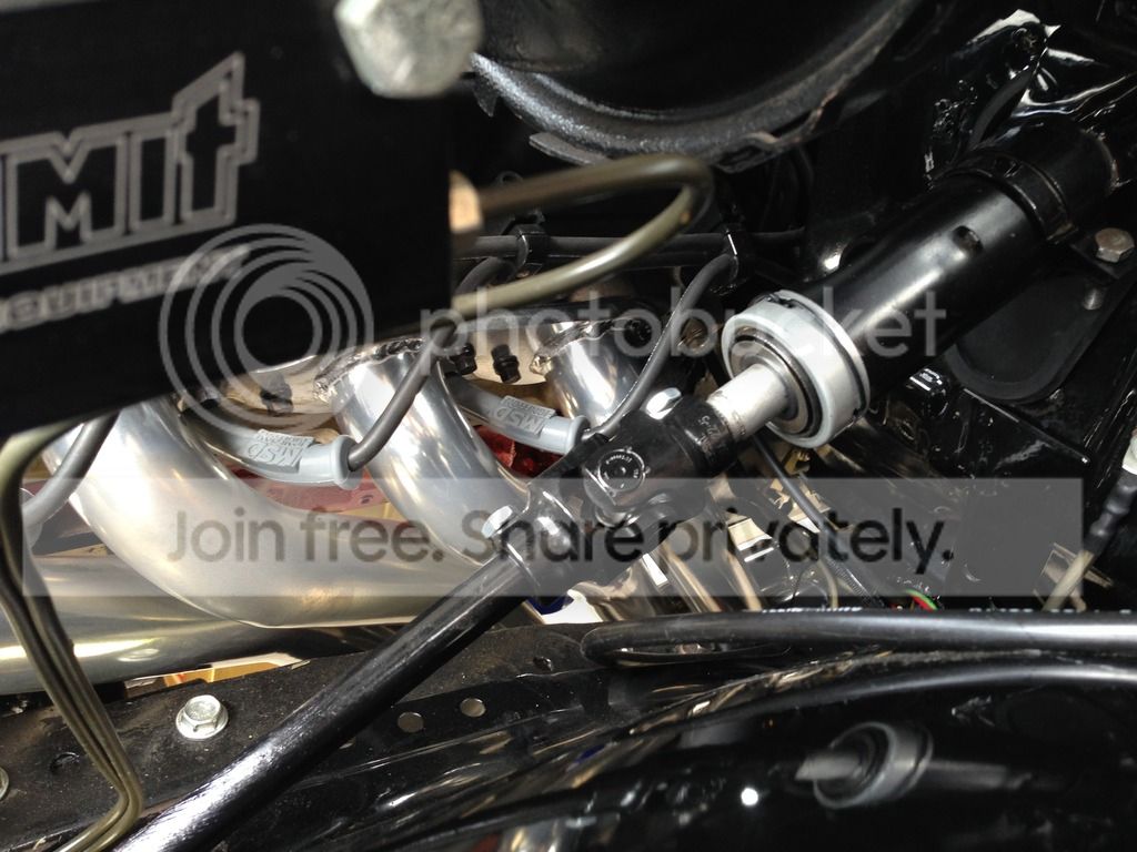

Got rid of the ugly a$$ factory upper steering joint and put in a Borgeson ujoint. Much better function and better looking to boot. For anybody searching later... 3/4" 36 spline and 3/4" DD.

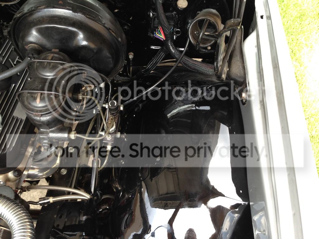

Put in both inner fenders. They still look good after sitting on the shelf all this time. Shiny.

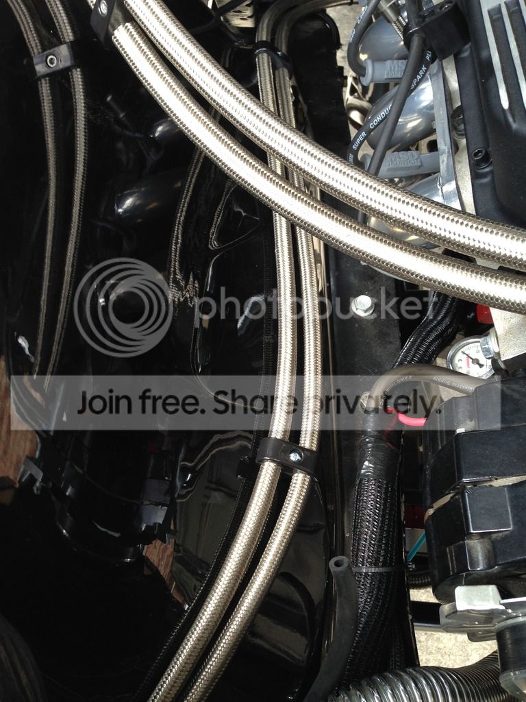

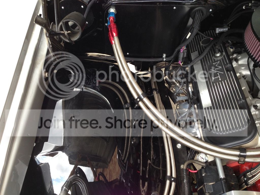

Mounted the transmission cooler lines to the fender. I used Made For You double tclamps with a small plastic spacer underneath to get the braided stainless up off the fender. I've used these clamps in a few places on the engine. I like em.

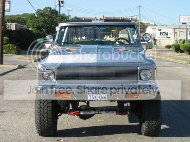

Lastly put the grille on and aligned the hood.
Kidding. I decided to ditch the billet and took it back old school.
Not much left on the list to get it inspected and registered.
Almost fooled me. The flames on the hood gave it away as not being right. Looks nicer than anything I've seen that isn't 2" off the ground.
Nice job, AJ!
All the little stuff starts to jump out when you have a truck that's so nicely detailed.
Electrical tape on the end of the wiring loom
Zip tie holding down the harness
Rubber hose not connected to anything
I don't know how anal retentive you are, but it looks like you've got a parking brake cable laying across the drivers side inner fender....which will eventually abrate and scratch the paint off underneath. It's the kind of little detail that is better to just deal with now, rather than waiting for the paint to be damaged.....removing that fender liner without scratching/damaging anything else is going to be a serious hassle.

Dang man. Wiring is done. I used electric tape at the ends of all the braided covers and where groupings of covered wires joined. :dunno:
The ebrake cable is an issue tho. The push pull cables I found don't have a tight bend radius. The way its currently routed is currently the best I can do while still running the factory pedal. Thinking about running a handle at some point...hidden inside the console. Small stuff.

I think Greg just meant to put some kind of rubber pad or clamp between the brake cable and the inner fender. The paint scratched off on mine and looks about the same.
Exactly! No need to reroute the cable, just find a way to keep it from bouncing around or rubbing across that beautiful paint!!! :eek1: :waytogo:

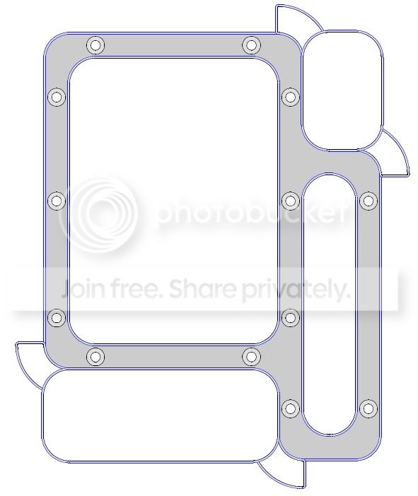

Spent the evening drawing this up in Front Panel Express. I'm sure there are easier ways, hence the extra shapes, but their app submits it for machining too. Will be cut from 3mm anodized natural aluminum
