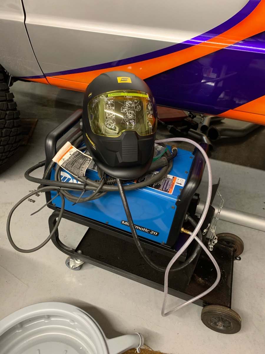

2/8/21 - Big upgrades planned to the Overbuilt Cruiser for this year. Back in parts accumulation mode. And finally adding a needed skill because I got tired of sourcing out my welding.
@ryoken - Like the helmet?

BIG time! Still more to acquire. Gonna be slow progress, as usual. The kids are keeping me entirely too busy.
sweet! tracking says mine will be here tomorrow....
jealous of the machine too... ;)
Thanks Paul. I can't wait to fire it up and hopefully keep the booger welds to a minimum.
