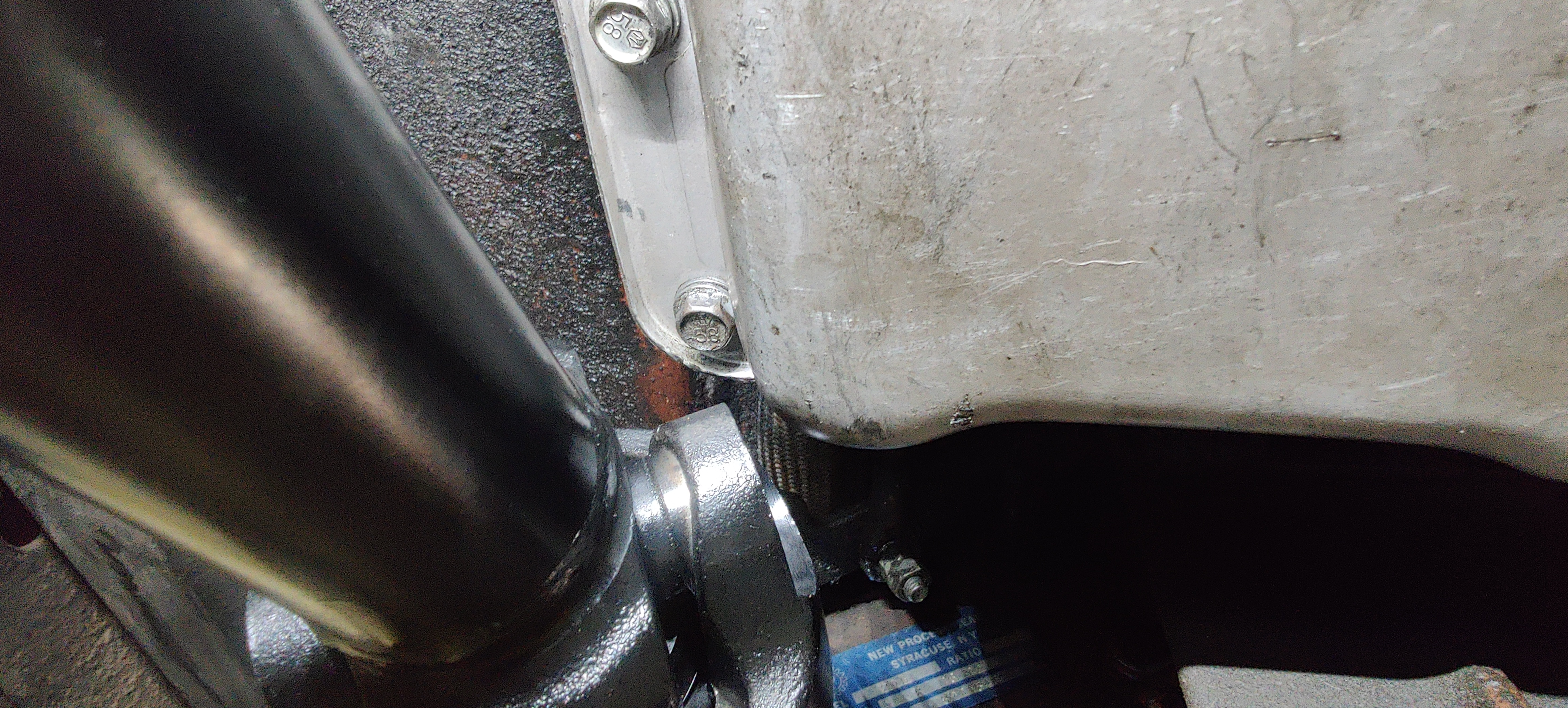

So this is my issue I believe. I have the 700r4 matted to a 400 sbc. I'm not sure exactly how he matted the transfer case to the 700r4. But the transfer case is pushed closer to the rear diff now. Obviously making the rear drive shaft shorter and front drive shalft longer. My truck is not lifted but has 33inch MT just for reference.
I need a new drive shaft because they welded the old one together at the slip. Only reason I can see they did that was so it wouldn't slip out? Anyways. The biggest two issues I have right now besides maybe some internal rear end damage? Would be
1. The linkage for the transfer case. It's an aluminum case so I'm assuming it's the np203. When I can post pictures I will. I think I'm going to fab up a twin stick setup. I want to keep it in the factory location. I found offroad designs twin stick instalation guide and looks easy enough to make.
2. The biggest issue is the front driveshaft won't clear the cross member for the transfer case. Looks like I might need a custom driveshaft? Or is there a better crossmember design out there that'll help with clearance issues?
Oh and she's an electronic 700r4. So how have people been getting her into OD? I think some people on this forum have been using a switch?
This is also my first square body so I'm trying to learn stuff as quick as I can. So if I gets something wrong bare with me lol
The t cases start from the factory with a tag on them. Originally that truck was a NP203 (probably since it was an automatic)
The NP203 is an all iron t case
Originally, a NP241 would have been married to that 700r4 (maybe a NP208, but those two are almost interchangeable) this is probably what you have
That will give you some numbers to look up in google photo until you find a tag or can post pictures
The factory automatic in 1977 would have been a 3 speed automatic. If the shifter is the column shifter, it’s likely you are pulling the transmission into 3rd, thus locking it out of 4th - OD
1- the ORD shifter is great. It’s not free, but works awesome. The 208/241 shifter will be a cable driven unit, also available is a JB conversions unit
2- finding a crossmember from a newer application that had the 700/241 application may be the ticket, or build your own…
3- the switch you are think of is probably for the torque converter lockup. It will lock/unlock depending on speed or throttle. You can also run it as a toggle, but I would recommend a vacuum operated switch
Lastly…
Does the aluminum t case have a place for a cable, or is it an electric connection the the output (for the speedo)?
Once you figure some of these issues, you can approach the driveshaft resolution. There may be a junkyard nearby that you can source and original driveshaft instead of popping for a new one

If you have a 208 or 241 T-case, you won't be able to use a twin stick shifter. There's only one lever on the case. The factory shifter for both of those bolts to the floor and uses a rod to connect to the lever on the case.
Both of those cases use a slip yoke that slides on the output shaft of the T-case, so the drive shaft is solid.
A 700R4 will go into OD when the valve body and governor commands it. It doesn't require an electrical signal.
The electrical plug on the left side is only for the torque convertor lock-up. You do want to make sure that it is locking the convertor when in OD, otherwise it builds too much heat and I have been told that it won't cool properly because of the oil flow internally.
It may not need the electric signal depending on if someone did a hydraulic conversion in the valve body. Does yours have any wires going into the plug?
