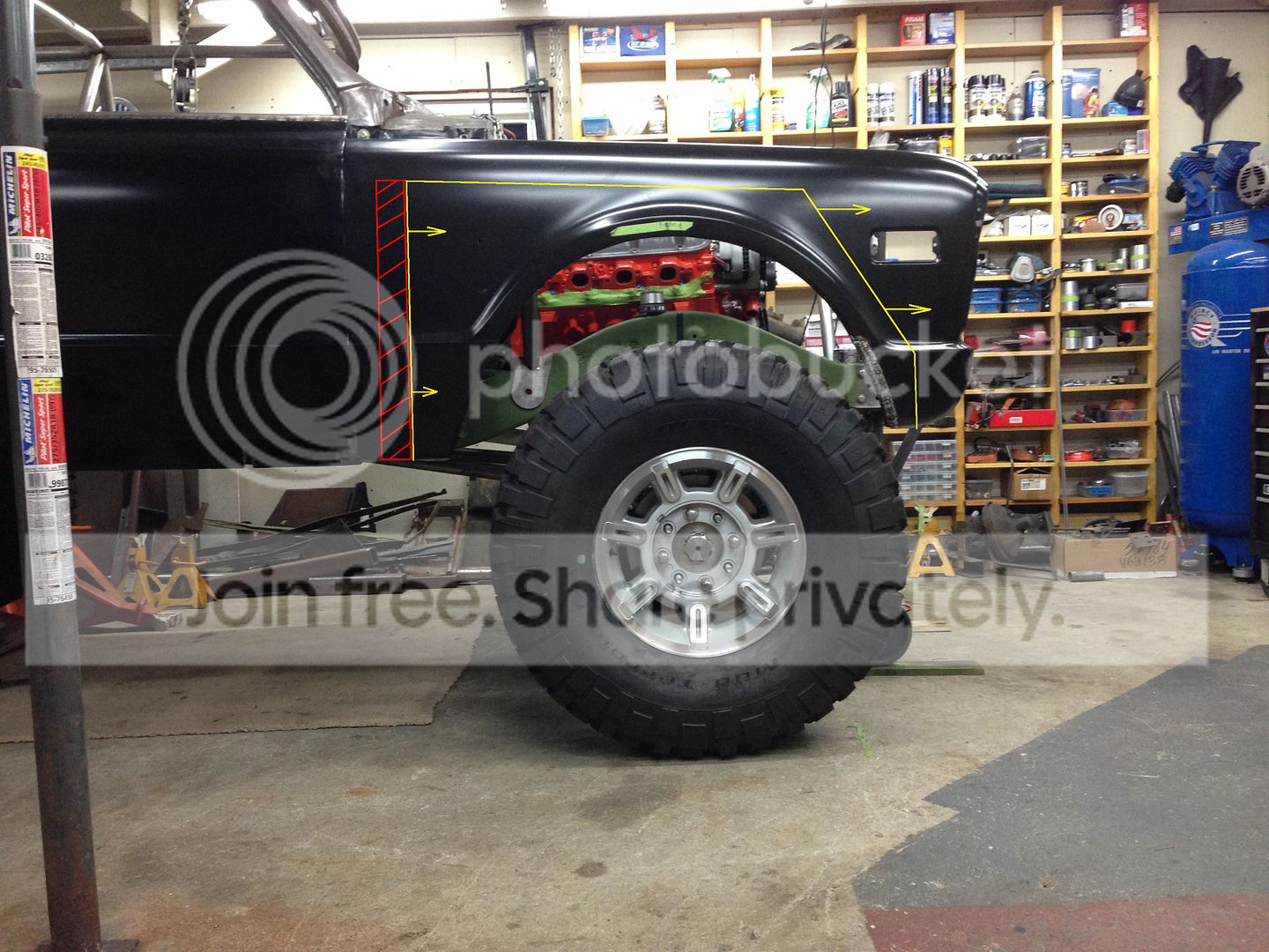

Astute viewers will notice that there is still a 2" gap between the fender and door in this final shot. That means I have to now either:
1. Cut and slide the entire fender opening forward 2" on the fender (maintain current 106" wheelbase)
2. Cut and slide the entire fender 1" and move the axle back 1" (to 105" wheelbase overall)
3. Don't cut the axle at all, and move the axle back 2" (to the original factory 104" value)
Still ruminating on that one... :thinking:
-G
When you say cut and slide...you mean cut out the entire wheel opening from the fender, moving the opening pretty much where it will be close to the side marker (Maybe 1" away) and filling in the back portion with another piece of sheet stock?
Just want to visualize it.

Add 2"to the back of the fender would be the easiest.

Something like this:
The yellow is the "cut" line. You want to get everything that is included in the fender arch so that it moves as one large piece, otherwise you will change the proportions of the wheel arch.
The red line is the resulting gap once the arch is pushed forward. That will need to be filled in with scraps from another fender or flat steel that has been shaped to fit.... whatever is easier!
The only "unknown" is how much of a stretch will be aesthetically pleasing. I'm afraid that 2" might end up putting too much material in the area where the "K5 Blazer" emblem goes and it might be a visual distraction. I think that adding only 1" might not even be noticable, but then I'd have to pull the wheelbase down to 105" to keep the tire centered the way I want.
Ultimately, once I cut and move that section it will be easy to tack it in a few spots (at 2" shifted) and take a look at it. If I don't like it....just cut the tacks and slide it back an inch and try again. :waytogo: It's only metal...

yup, Greg's got the right idea..... the light area is the only tricky part...

I think that 2" would be pretty extreme. But, it's a ton of work for just 1".

I've been down this road before, so I know it's possible... the only question is how hard to push that arch around.

Why not cut off the new arch you just built and graft it 1" or 2" forward on a new fender? That way you don't need to graft in a 2" strip at the back? I guess it's a little more $ that way though.
