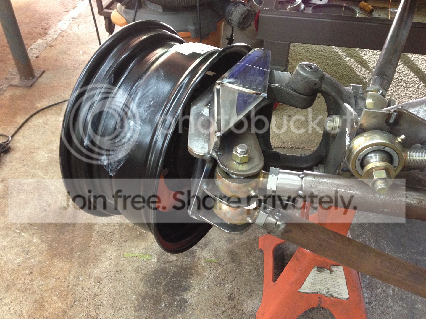

Didn't get a whole lot of time to spend on the truck, but was still able to knock out a few new pieces. Here's a shot of the drivers side steering arm tacked together...
Ignore the extra heim in this assembly. I decided to build the arm as a mirror-image of the passenger side, and obviously there isn't a draglink on this side. The idea is to just swap in a thick slug of DOM to replace that upper heim so that I can run a long bolt down through the entire thing and torque it down. This will allow me to weld the boomerang shape on this side as well and it will carry the loading correctly. Keeping that "placeholder" in the steering arm will give me an option to connect my hydro-assist ram to that spot if I want to. It's not my preferred location but we'll have to see how the packaging works out later on..... it's nice to have options.

DS steering arm. Starting to figure out this welding thing. :)

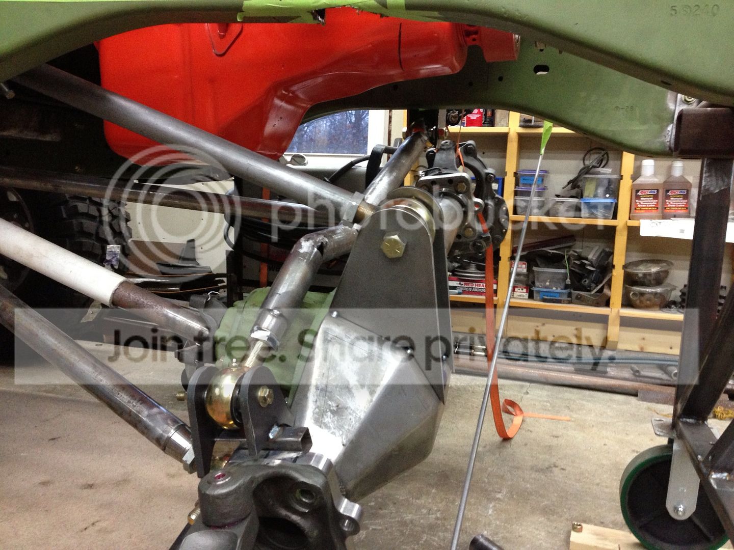

I spent a couple of hours last night VERY carefully aligning the front axle to the truck frame and making sure that it was back on it's tires for correct ride height. Since the next steps are building bracketry for the PHB it was important to insure that everything was in it's EXACT correct location before I start using up the empty spaces that remain... After dropping plumb lines and checking and double-checking everything was perfect, there was still a little time left to make one critical modification.
Here's a shot of the original axle-side "upper 3-link" bar and the way it attaches to the pumpkin...
BEFORE:
Now that the steering and PHB are being stuffed into that area, it doesn't really work anymore..... the main problem is that the PHB is aligned vertically above the draglink, so as the suspension cycles up on the passenger side (especially while steering left or right) things are going to collide. The axle-side PHB mount is also going to need to become a true double-shear mount, unlike how it looks in the current mock-up work, so additional clearance will be needed for that also. Here's how it was resolved....
AFTER:
By gently removing about 1" from the bracket and smoothly transitioning it with a curve back up to the upper-heim area, the bracket still looks nice but now allows the PHB to go back towards the axle by about 1-1/4" to 1-1/2" more. This will allow the heim to clear the draglink under all suspension cycling motions (hopefully!) and will have the side benefit of allowing all the PHB bracing to occur much closer to the pumpkin/axle housing itself. This should make it a lot easier to build, and to keep it strong... not like some long, crazy arm hanging way out in space!
Here's another shot, more from a side-profile to show the new clearance. Obviously in this shot the PHB hasn't actually been moved yet... but you can see that it's got a substantial amount of room to move backwards now.

you cycled it right??
cycle.
Looks like it will clear everything. So much fun getting 5 gallons worth of parts to fit in a one gallon space :D:D
Me thinks your gonna be tickled with the front suspension and steering though. Time spent here is worth its weight in gold
I did notice something, might just be the angle, is the jam nut gonna rub the bracket?
You gonna brace the upper bracket side to side?

Eric,
Well..... I cycled it as far as I could until things hit each other. :whistle:
That's sort of the brute-force method that's been in play with this front suspension so far...... build stuff where it seems to fit, then cycle it, turn it, and notice where it collides. Re-evaluate and re-engineer. You were the one who told me to stop building every bracket so damn nice at the early stages of mock-up and that was sage advice. I would have thrown away a lot of "pretty" brackets by now. :) Once I get the PHB mount moved back 1.5" I will throw some heavy tacks on my "adjustable" PHB sleeves and cycle it again to see where else I messed up. The next likely interference from what I can tell will be the draglink vs. tie rod on the passenger side under heavy PS bump travel.... it seems like the tie rod won't really "fall in behind" the draglink quite as perfectly as I'd hoped, so it might require me to move the idler bracket slightly forward on the frame to create more angularity between the two (so they aren't overlapping as much on the PS steering arm). Kind of tough to explain, but I have a feeling you know what I'm taking about.
Which jam nut are you referring to? The upper link?
-G
I thought by now you probably had a pretty good handle on all this stuff sounds like you do
Yah the upper link jam nut. I am guessing the bracket is wide enough but you might consider taking a nip out of the bracket when it is in its final stages.
Nothing says I got lazy at the end like a buggered up jam nut :whistle::haha::haha:

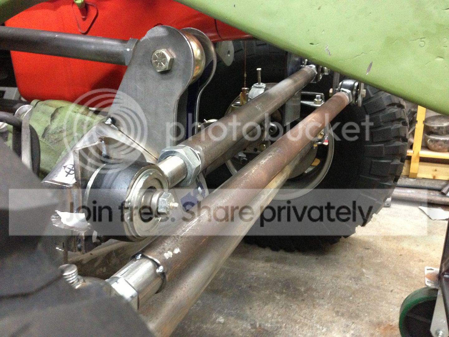

Here is a shot of the drivers side... (left to right) Idler arm, tie rod, and PHB bracket (PHB moved back 1.5" from yesterday)

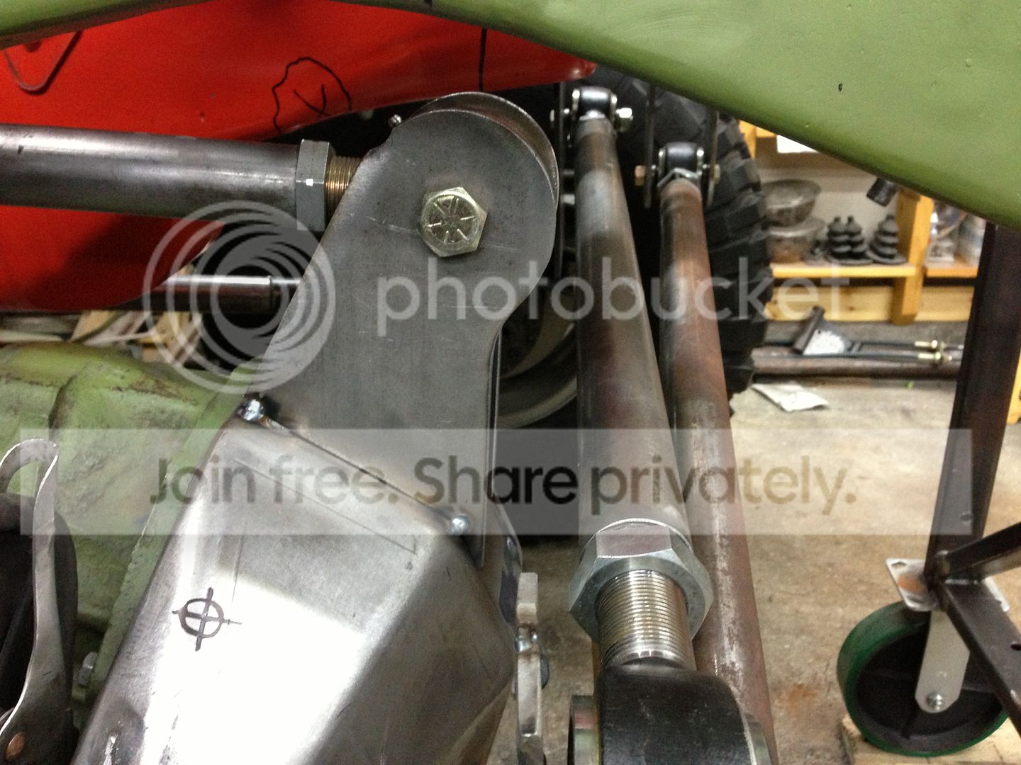

....and here's the PHB bracket moved back 1.5" on the passenger side. You can see how much closer it is now to the upper link mount bracketry:
Here's a close up of the clearance (or lack thereof) to the upper link bracket....don't worry, there is a slight gap in there and the tube I'm using for mock-up is 1.75" diameter....the final version of this tube will only be 1.5" so there will be a tad more clearance than this photo show....
Nice.
