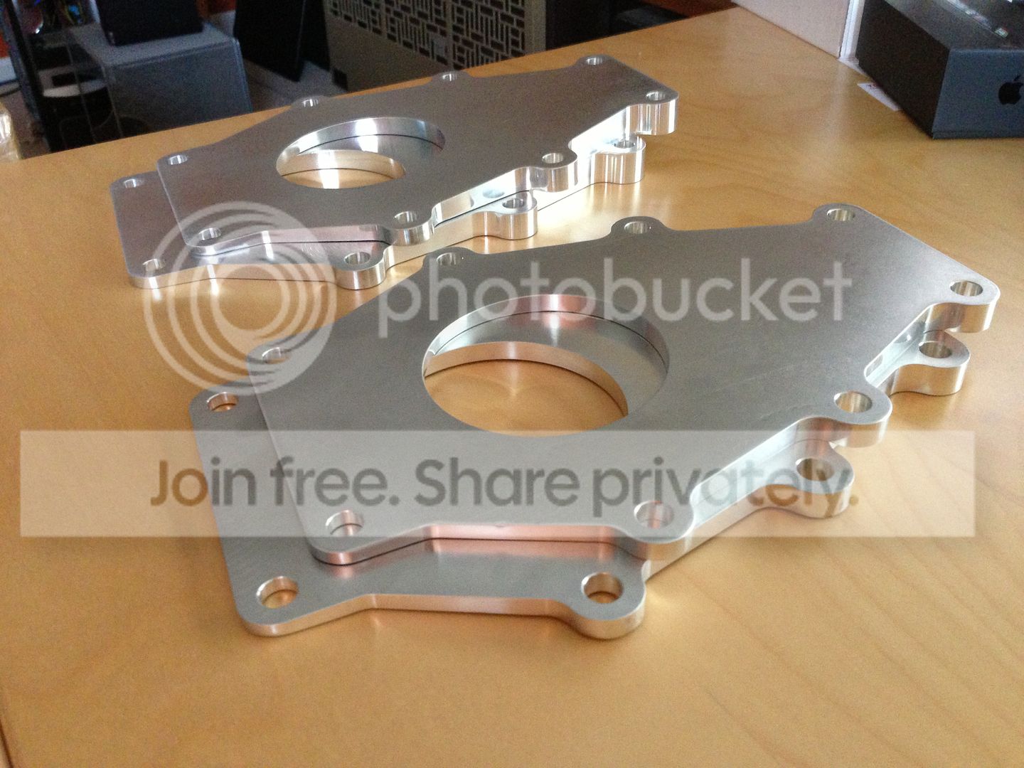

2013.06.25 - UPDATE: FRONT CAMBER PLATES HAVE ARRIVED!!!
BAM! Cool new parts have arrived for the front axle...
I had two sets made... the thinner set is 1.75* to allow me to set up the axle for 0.0* overall camber. The second (thicker) set will allow me to set up the front end for -1.0* of camber (negative camber)....
One step closer..... :)
-G
Which ever set you don't use, needs to be placed on the wall in the living room. Those are more like sculptures than parts.
My usual "West Coast Connection" hooked me up..... :waytogo:
Thank heavens for USPS flat rate boxes!
-G
-G
:sign11::sign11::sign11:
Way cool
Jeebus you're a perfectionist:haha::haha::haha:
Looks awesome Greg. I agree with everyone, the ones that don't make the cut are definitely art!:pimp:
If you have done by Blazer Bash this year, just send a few pictures on poster board. You would win the "most innovative vehicle", without even showing up.
