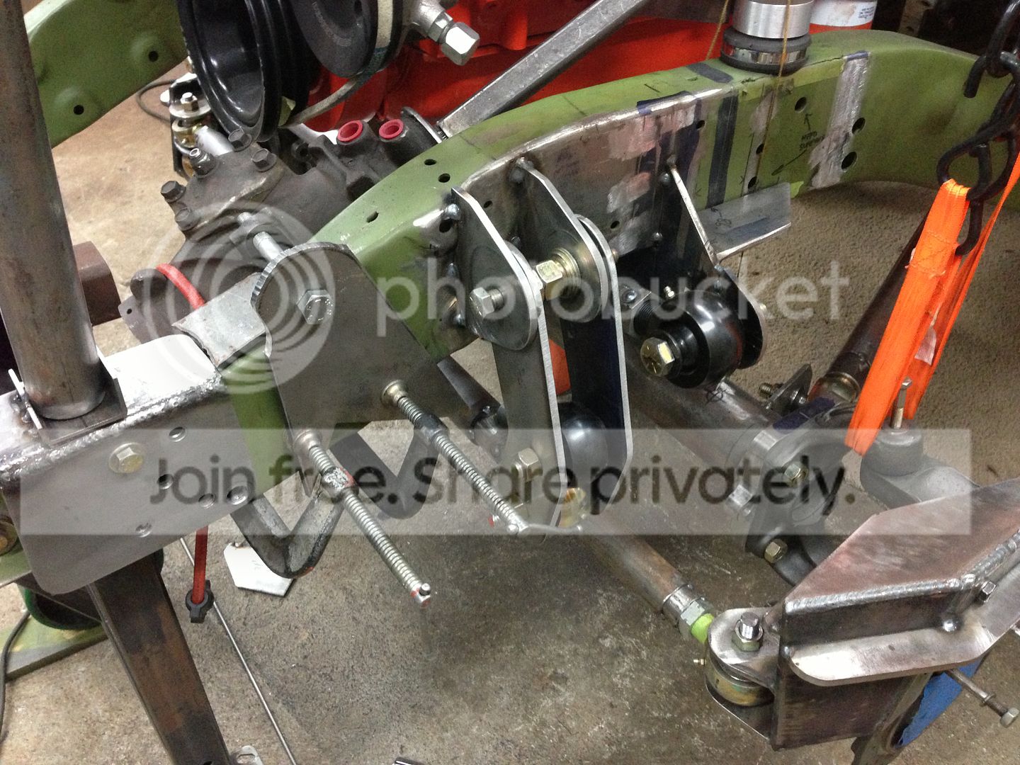

Here's the update from last night.... Burned the midnight oil again!
Pulled the motor to gain access to the inner framerail so that the notch could be added to the frame (for upper link mount bolt clearance). Basically that area is already 1/4" thick all the way through, so by cutting a square piece of 3-1/2" x .250" wall tube (lengthwise) and finessing it in there, everything stayed nice and strong.
After dressing the welds and smoothing everything out, it got a fresh coat of Ryoken green, and the motor was reinstalled....
Just before the motor went back in, I made a few other small tweaks in areas where clearance was tight... The hope was to get everything perfect so that the axle could be brought up to the 29" value on both sides...... It ALMOST got there. The final numbers were 29" PS & 28-3/4" DS. The pumpkin still hits the oilpan, but that is the only remaining interference at this point. A tiny amount of additional dimpling on the pan should get the job done.
With that complete, it will be time to fully cycle the suspension again (same process as before) to see if the new PHB mounts screwed up anything else.... If that all checks out, it will be time to cycle the PS and see how well that new frame notch does its job! :D

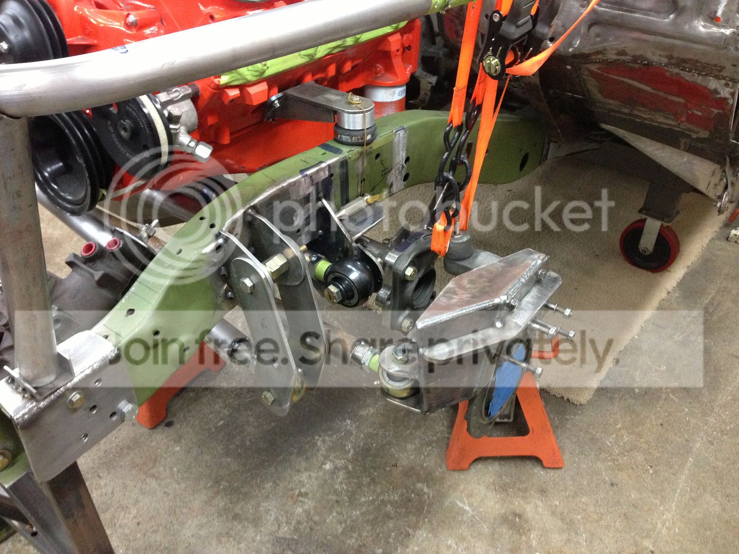

2013.07.21 - UPDATE! - PERFECT EQUALITY...
There wasn't a whole lot of time in the shop, but there were enough hours to tweak the PHB and draglink lengths to make them identical. Previously the PHB was 37" and the draglink was at 43". It was going to be tough to just slap that extra 6" on one end of a bracket, so the idea was to try to finesse a couple of inches into each bracket and hopefully pull 2" out of the draglink without affecting the operation of the idler itself.
First step. Lengthening the axle side PHB bracket. Due to the kind of length that was being added, the heim wouldn't clear the steering arm anymore. So the mount had to be raised a tad so that the steering arm could pass directly underneath under hard turns.

Added 2" to the PHB and remounted it to see how the steering arm clears under hard left turns... (this location NEVER would have worked with a straight PHB, the 7* bend makes a huge difference)
A slightly different angle, but it really shows just how FAR out on the axletube this mount has gone. It's just about aligned with the upper kingpin pivot location!
So far so good.... Time to move to the frame-side mount and add 2" there also.

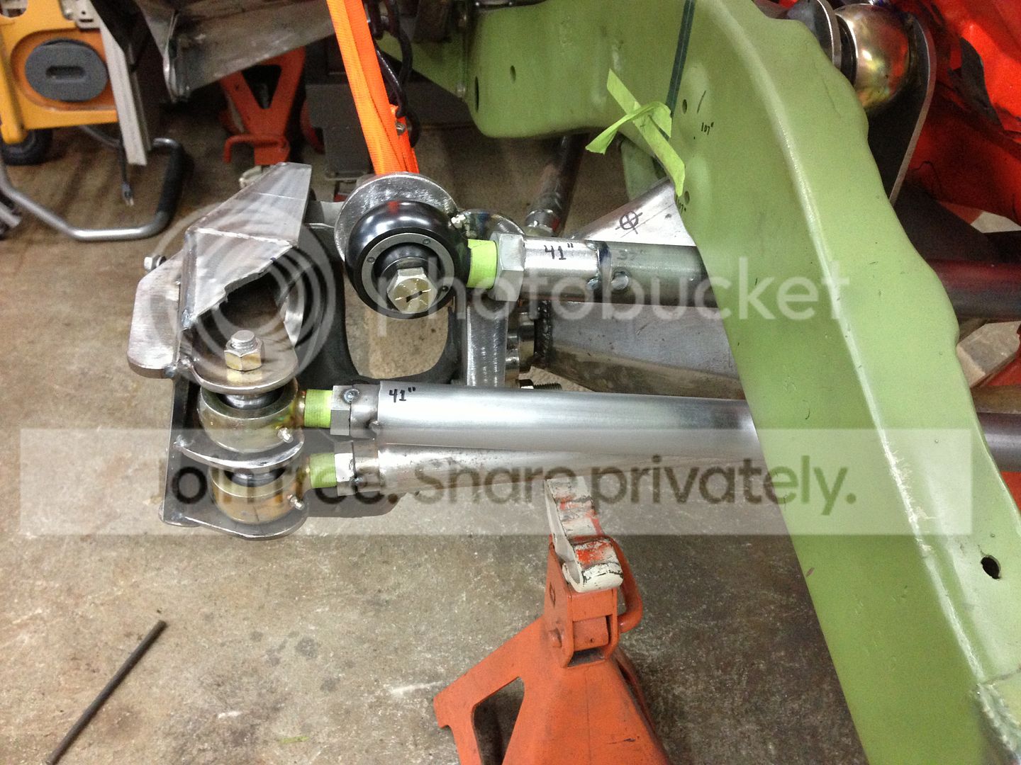

Had to make a small mod to the DS steering arm to allow full uptravel now that the heim was sticking so much further out than before.... But after adding another 2" to the PHB (now at 41" vs. 37") the end results were good.
...and a little different view at full-lock (hard right) to show how tightly all the DS components are packing into that space...
Another photo, a little further back at full bump.......
The last step was to remove and cut down the draglink by 2".... It was clear if this was going to limit the amount of steering or not (before the idler hit the frame) but luck was on my side and it worked out perfectly! :waytogo:
So... The PHB and draglink are now both officially at 41" so bumpsteer should be almost completely undetectable. Suspension-wise there are a few remaining interferences, but the next step is to set the axle at ride height and recheck that it is still plumb and square to the frame after these last mods. There's no point in fighting for clearance if the axle isn't truly in the correct spot yet.
.....things are getting closer and closer! :D

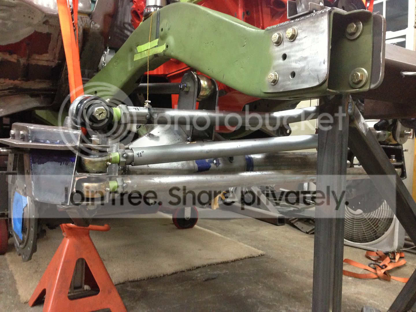

LAST NIGHT'S PROGRESS....
Got the suspension down to exactly 23" on each side again (actual ride height of the lower link mount bolts) and double-checked all the measurements now that the PHB is at 41" instead of 37". Things had drifted slightly since the big "Day of Cycling" occurred, so it took about an hour to get the axle moved back (~1/4"), and slightly toward the driver's side (~1/8"). At that point, the front suspension looked like this:
FINAL FRONT SUSPENSION RIDE HEIGHT AND PHB ANGLE!!!
Took a measurement off the PHB (actually, it's not possible to lay a digital angle finder on it anymore since it's bent....needed to use a straightedge across the heims!) and the overall angle of the PHB came in at 4.8* which is pretty nice and shallow. Obviously, this establishes the angle for the draglink, and since the steering arm side of the draglink is also "permanent" now, and adjustments will be accomplished by raising (or lowering) the idler mount bracket on the frame.... as an FYI, the current angle of the draglink in this photo is 3.5* so the idler will need to go up slightly to match the new 4.8* target value.

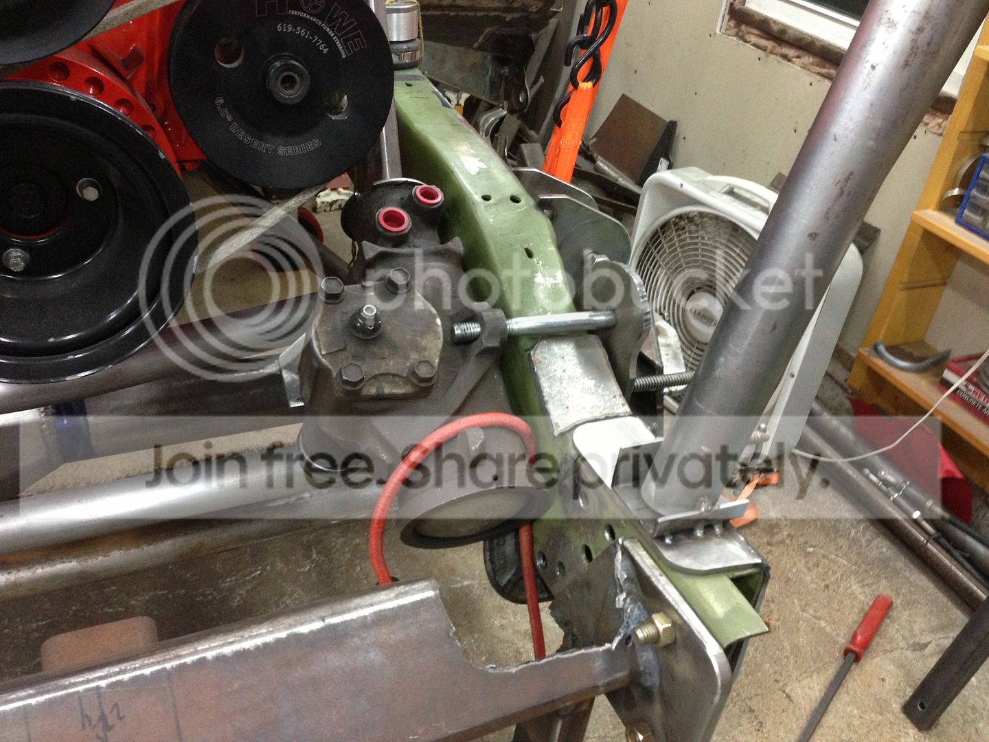

The next order of business was to see what could be done about relocating the steering box from it's initial "slap it on there" location to a more practical spot further back toward the firewall. As Eric mentioned earlier, if you crowd the steering box too close to the radiator support, most likely there are going to be interference issues. To understand just how far it could be moved it was time to get the pitman arm cut and sized for this application....

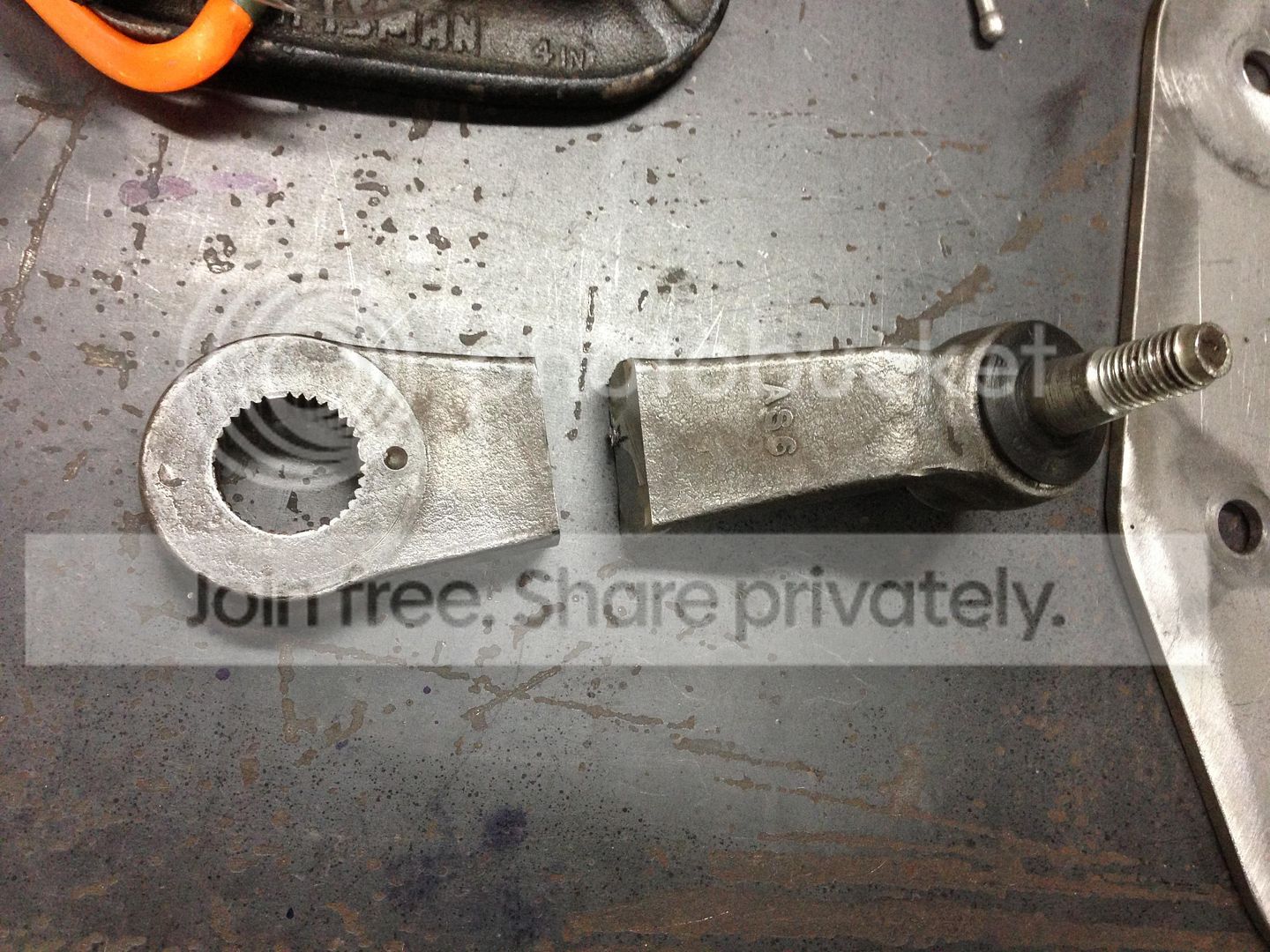

The approach with this idler steering setup is to keep things as simple as possible. There are only two dimensions that are used to transfer motion around from the steering box to the wheels.
5.5" <- This is the dimension of the original pitman arm that was on this box, so it seemed like a good value to use again. (Except this time it would be made completely FLAT, with no drop in the arm) This is also the dimension (5.5") of the upper mounting hole on the idler arm. There is no ratio-change as the motion of the pitman arm moves the idler.
8.0" <- This is the dimension of the new steering arms that were built for the 404 knuckles. This was a quasi-scientific value based on what others have done for hi-steer D60 type steering setups, so it seemed like a good "not to short & not too long" value. This is also the dimension of the LOWER mounting hole of the idler arm... so again, there are no additional ratio changes going on except for the one transition necessary to convert the 5.5" pitman arm to the 8" steering arm motion.
Here is a shot of the modified idler arm with the two new dimensions (5.5" & 8.0" hole spacings) still at the 3.5* overall slope... there is quite a bit of room for this to move up vertically, and there is even some room to go back (toward the firewall) if that improves the steering box positioning and/or anglularity of the small steering "stub" that will connect the pitman arm to the idler arm.
Last shot is of the steering box in a better location (though still not final). This is about 5" further back from where it has been for the last several weeks.

Steering boxes are some of the clumsiest objects to work with, I swear! :doah:
The large diameter at the bottom of the box keeps it from laying flat against the frame, so the 3 mounting tabs NEVER actually touch the frame when you need them to....basically just about the time it's aligned half-way decent, it slips out-of-position before you can get a clamp on it and half the time ends up on your toes or the floor!!! :eek1:
Tonight I am definitely building a spacer to go between the box and the frame to make it easier to manage. Also, that one long bolt that I use to "hang" the box across the top of the framerail is becoming a problem too....the box could certainly be mounted lower on the framerail but that bolt keeps forcing me to hold it up too high.
Anyone with "tricks of the trade" on steering box positioning is certainly welcome to chime in here. I don't need any more black toenails!....
-G
Unfortunately there is no trick I know of with a sag box for mock up. If you've ever looked at my build thread all I did to give the clearance on the body was put mounting sleeves through the frame and stand the box off the frame about 3/4 of an inch.
The only solution is to use a toyota truck or landcruiser style box. They mount flush right on the side of the frame rail. But I think you're well beyond that now.

Greg I used plumbers tape a lot with steering boxes, have also made large clamps out of some old shackles and some all thread.
One time I actually tack welded the box to some 2x2 square tube then tack welded that to my floor jack.
I know what you mean about steering boxes super clumsy.
