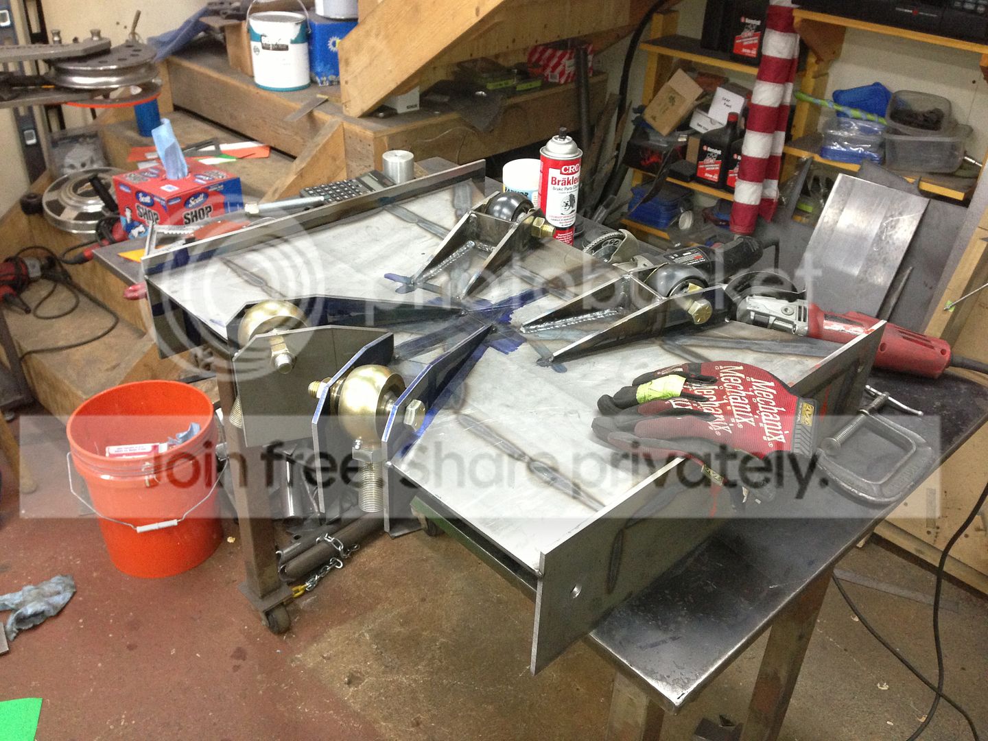

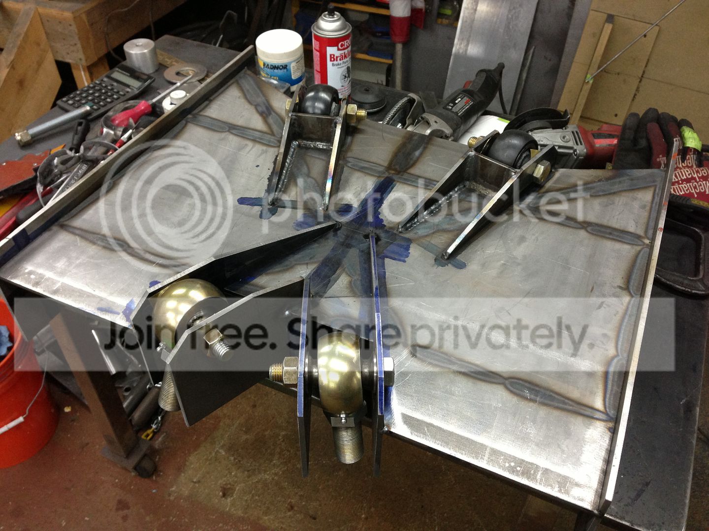

UPDATE:
I didn't spend much time last night taking photos.....so you only get two this time. Last night the exchange rate was 3.5 Hours = 4 Rear Link Brackets. Not a bad trade IMHO.... :D
The process (and shape) of these brackets is VERY similar to the front link mount brackets since they are both establishing a heim position at 26" off the floor. The only real difference is that the rear mounts converge more sharply, so instead of two discrete mounts showing on the bottom of the monolith, this rear setup will end up looking like one large consolidated triangle once the final mini-skidplate is welded across the top of the mounts.
-G
You gonna put plate on top of the link brackets?

Yes there will be some additional plating across the front and rear link mounts.
I will drill drain holes before its installed, that will be no easy feat. I broke my expensive 1-1/4" annular cutter over the weekend trying to "freehand" cut a couple of holes with my 1/2" hand drill... The large diameter holes really need to be fixtured somehow. (a magnetic base drill would be good right about now). Ultimately I will probably move my drillpress out into the middle of the shop, then roll my workbench under it so I can drill holes in the monolith that way....
The truck will ultimately have a very large set of skid plates covering most of the underneath (transmission area, rocker panel/ rock slider areas, etc) so its not going to be easy for large amounts of debris to get up and into the crossmember..... But I was already wondering about how I'd ever know if something was leaking. Having a transfer case run completely dry would be an expensive day.....
