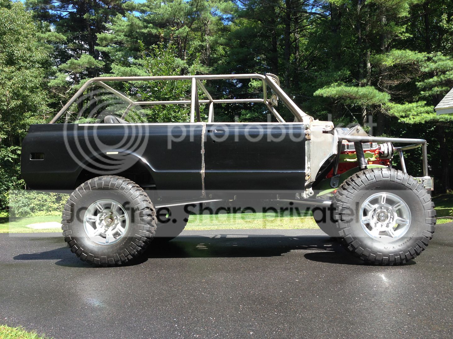

Danger is getting big!! I still remember talking about baby jail in this thread and that doesn't seem that long ago. Looking at the last series of pics, you should be justifiably proud. You've got the trifecta of coolness going on. I see your landscape stuff, of course the Blazer hitting a huge milestone, and a great kid posing on top of your big block. :waytogo:
You couldn't ask for more and keep a straight face I'll bet.
Happy upcoming birthday BTW...:waytogo:

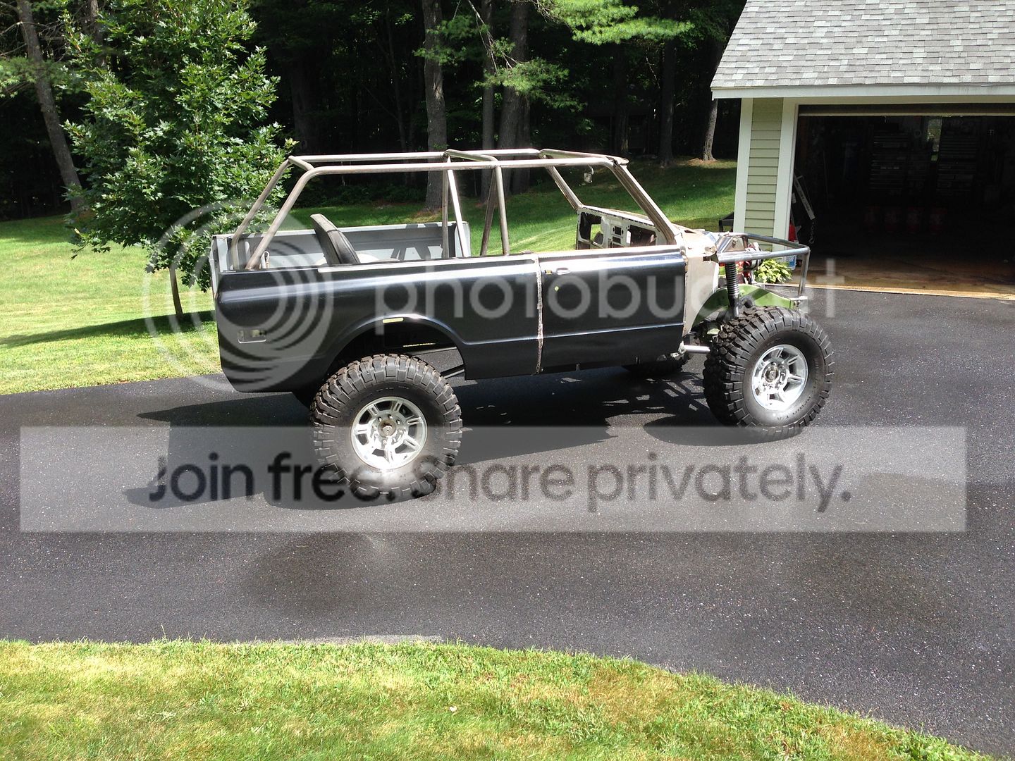

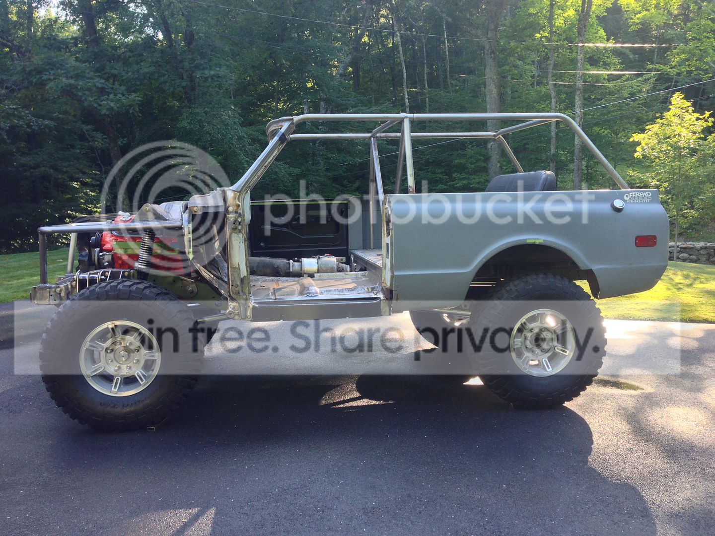

I've been working SO hard for the last 10 years, that it's been insane at times..... The house needed a LOT of work and every time I turned around some major thing was going wrong (septic system, roof leaks, well pump, etc). The Blazer project always went on the back burner as the other demands of the home, marriage and family took center stage.
....and yes baby jail. Almost 18 months of pure sleep-deprivation and NO spare time to think about anything besides diapers, feedings and trying to keep the household running.... Starting a family in your 40's is a tough assignment. :D
Only over the course of maybe the last 6 months, have the planets finally aligned enough where the loose ends of a million household projects are now being checked off the list, Charlie is old enough now to start hanging out and having fun conversations with. And yes, I've been logging enough hours on the K5 that I finally had the payoff experience of rolling it outside into the sunshine and spending an afternoon just enjoying that feeling, drinking a few cold ones and snapping a couple hundred photos.... :waytogo:
Believe me, this weekend I absolutely had that experience of just looking around at the house, yard the truck on the driveway, and Charlie doing his goofy pose on that old-school BBC and feeling pretty proud and blessed for so many things that are good in my life these days.
-G
Awesome pictures, awesome kid, awesome big block, and awesome clearance! Diggin this update.

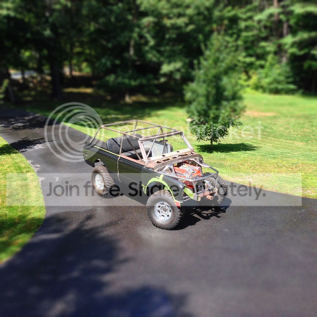

This one was manipulated using some kind of Apple tool call "Tilt Shift"... to mess with the perspective. A buddy of mine sent it back to me once he'd messed with it..... kind of makes it look its in some kind of miniature model.....
-G
Tilt shift is a reference to old cameras with billows. You could tilt the lens on the end of the billows to have a strong blurring effect on those areas that are intended to be out of focus. This happens because the distance between various areas on the lens and the surface onto which you're projecting the image is different. Essentially, it messes with the focal length of the lens. Kind of. It makes your subject more powerful, and as you noted, typically has a miniaturizing effect on the subject. It's really strange to look at photos of huge urban areas in tilt shift images because they look like Lego creations, or claymation or something. [/artlesson]

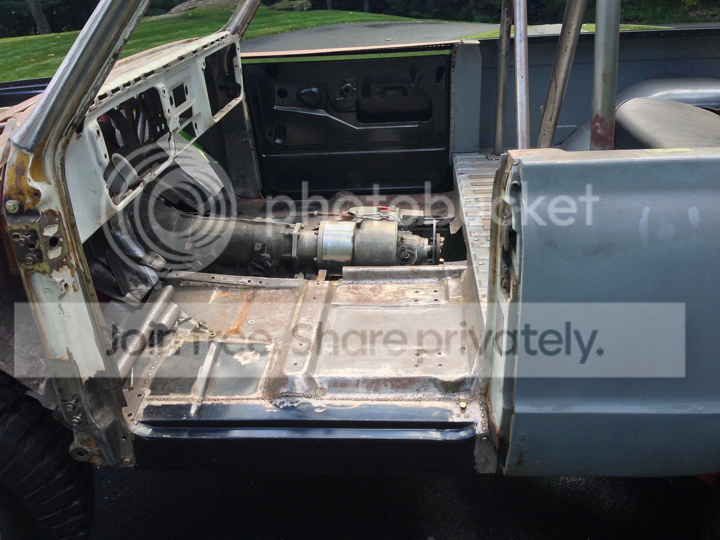

I may have missed it... did you cut the top of the door off to match the bedsides?
