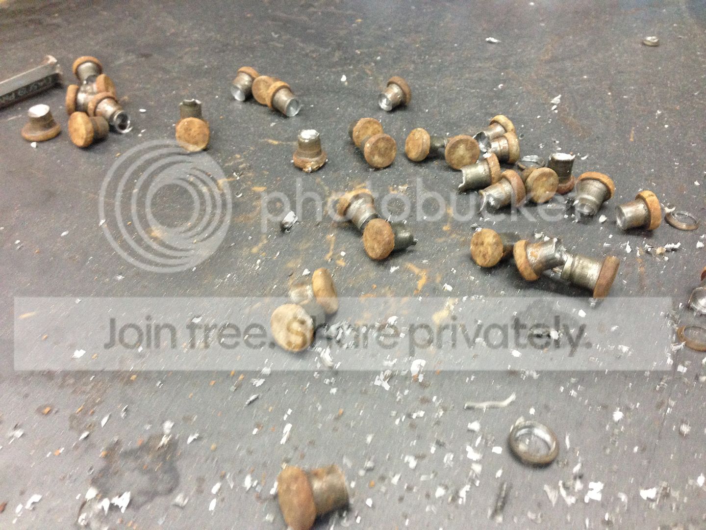

The factory wheel center is not welded, it is held in place by 12 rivets per wheel (3 per flange)... so the first order of business was to drill and punch out a LOT of rivets.

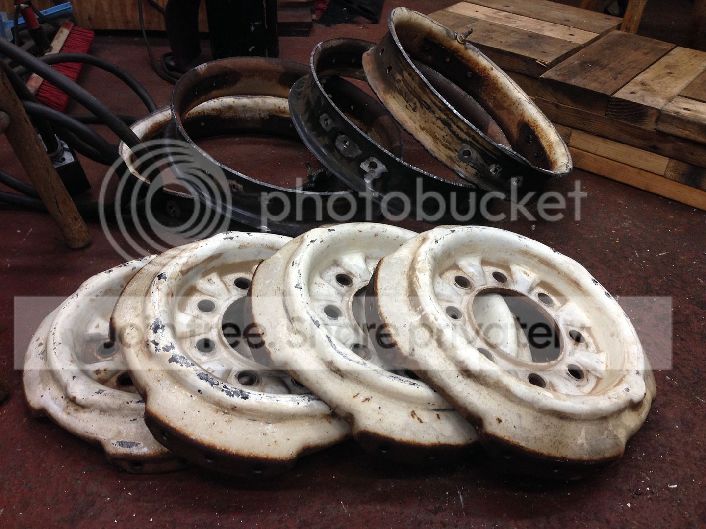

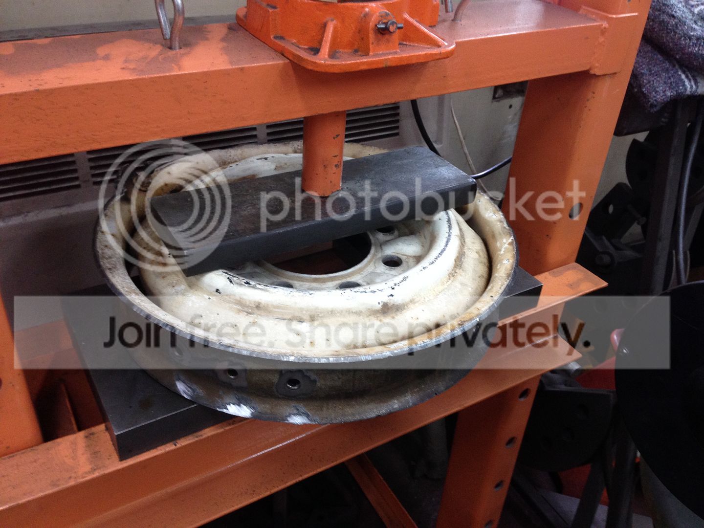

....then press out the center from the outer hoop.
After a couple hours of joyless effort (on my birthday no less!) I had this:
Time to begin! :waytogo:

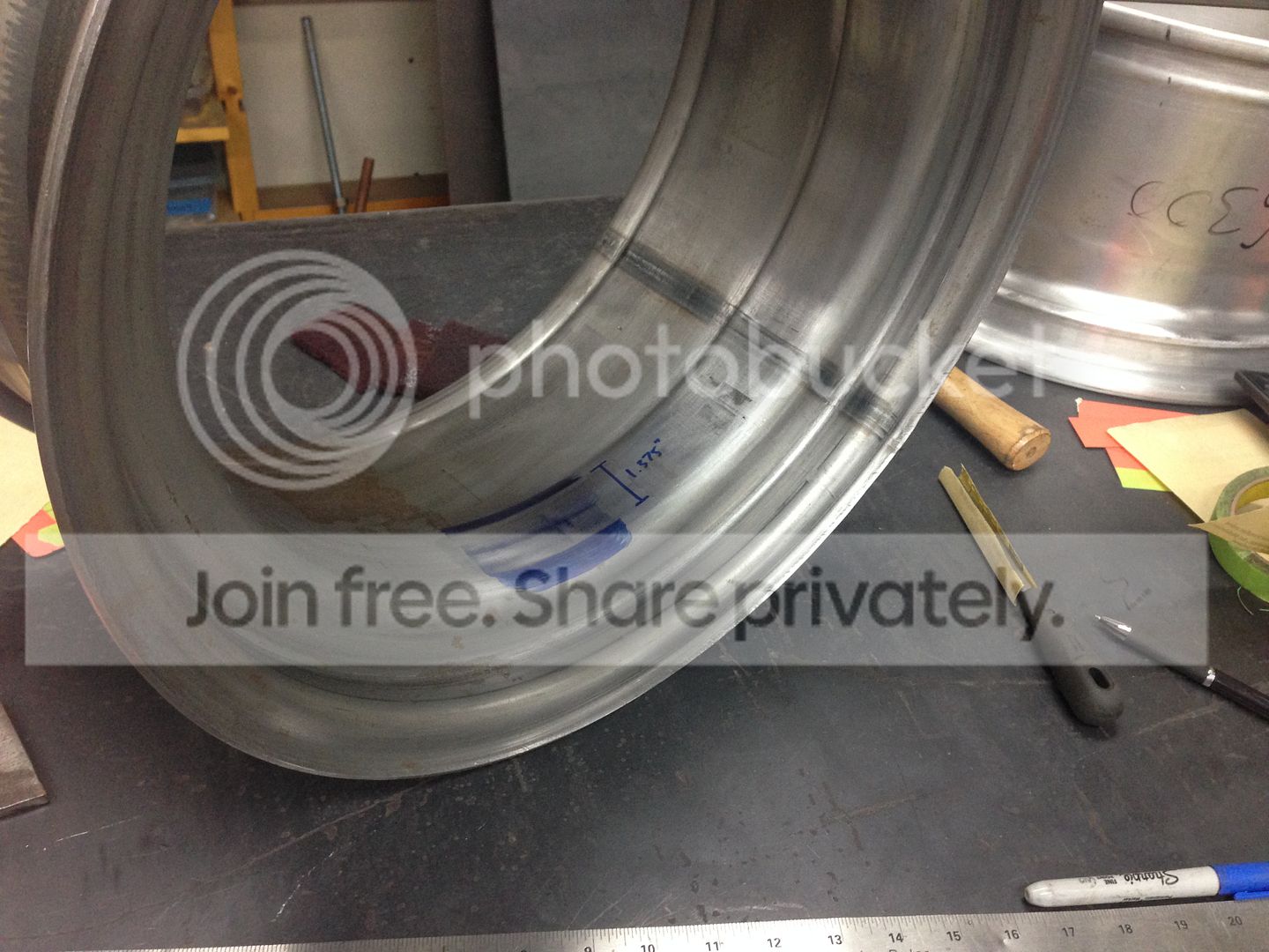

This is what they call a "drop valley" 17" wheel hoop. The internal I.D. is 14.228"... which is about .080" too large for the centers. However, for the time being I picked up some thin .040" steel shim stock and was able to make up the difference to keep the mock-up process moving forward.
The actual "drop" area isn't all that wide, and since it's got a pretty large radius on both sides, the useable FLAT area where you'd want to land the mounting flanges from the wheel center is only 1.375" inches across.
A bit of Dykem and the not-so-scientific method of gently sanding across the area with a flat file revealed where the flat area ended, and where the curved (and unusable) areas began.

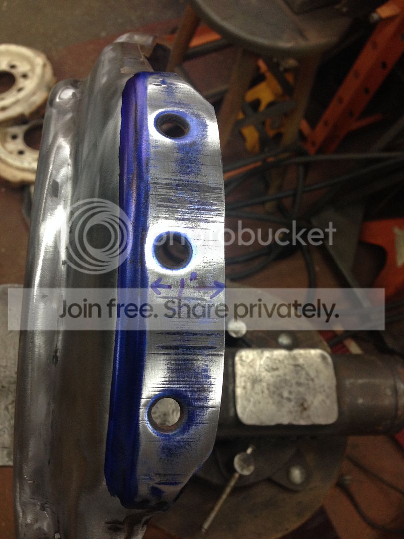

I did a similar test for the wheel center flange to see how much material I have to work with.....
As you can see, even though the flange is pretty wide the useable FLAT area is only 1" wide....

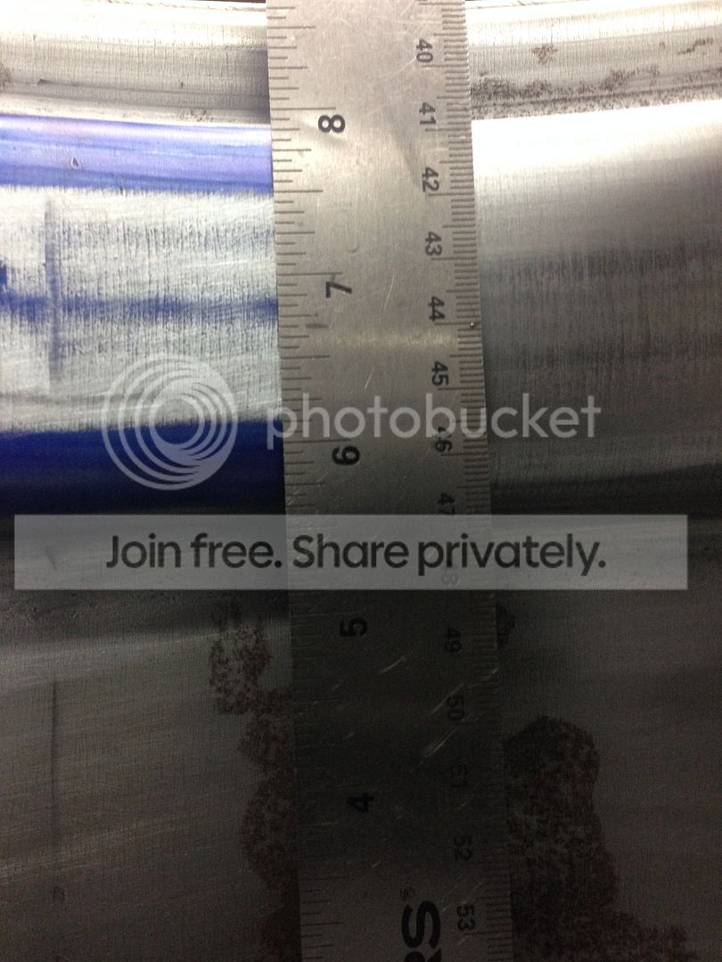

Laying the hoop down on the workbench (back side down) and measuring up from the tabletop, shows that the flat area starts at 6-1/8" and runs to 7-1/2"....
This is basically my workable area to install the wheel center flange... so realistically, that's only about 3/8" of real adjustment for backspacing if I want to keep both flat areas in 100% contact with each other.
