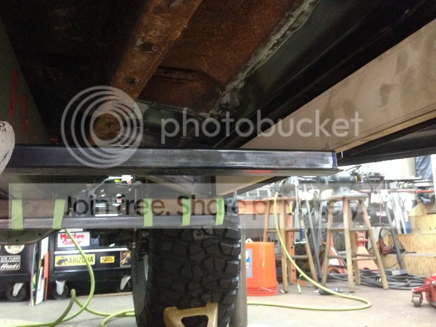

When we last left this discussion, I was working to get a solid cross-sill assembly figured out for the B-pillar area.... so on Sunday morning, that's where I picked up my work again.

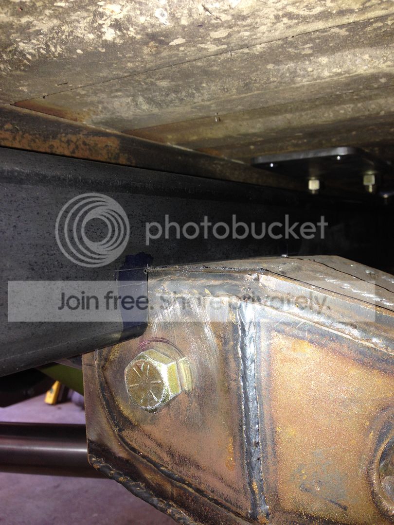

The cross sill is based on a 3" x 2" x .188" (3/16") wall tube. It fits in the space above the factory framerails really well... even without a body lift. However, the problem I ran into was that by the time I got the entire plate/mounting system into position the way I wanted it, there just wasn't enough room for it to sit flat on top of the framerail (unmodified).
Fortunately, the solution was simple and will ultimately end up being stronger... I cut a 1-1/4" notch to clear the (mini-monolith) brackets that hold my rear upper link mounts and dropped the entire assembly down a bit....

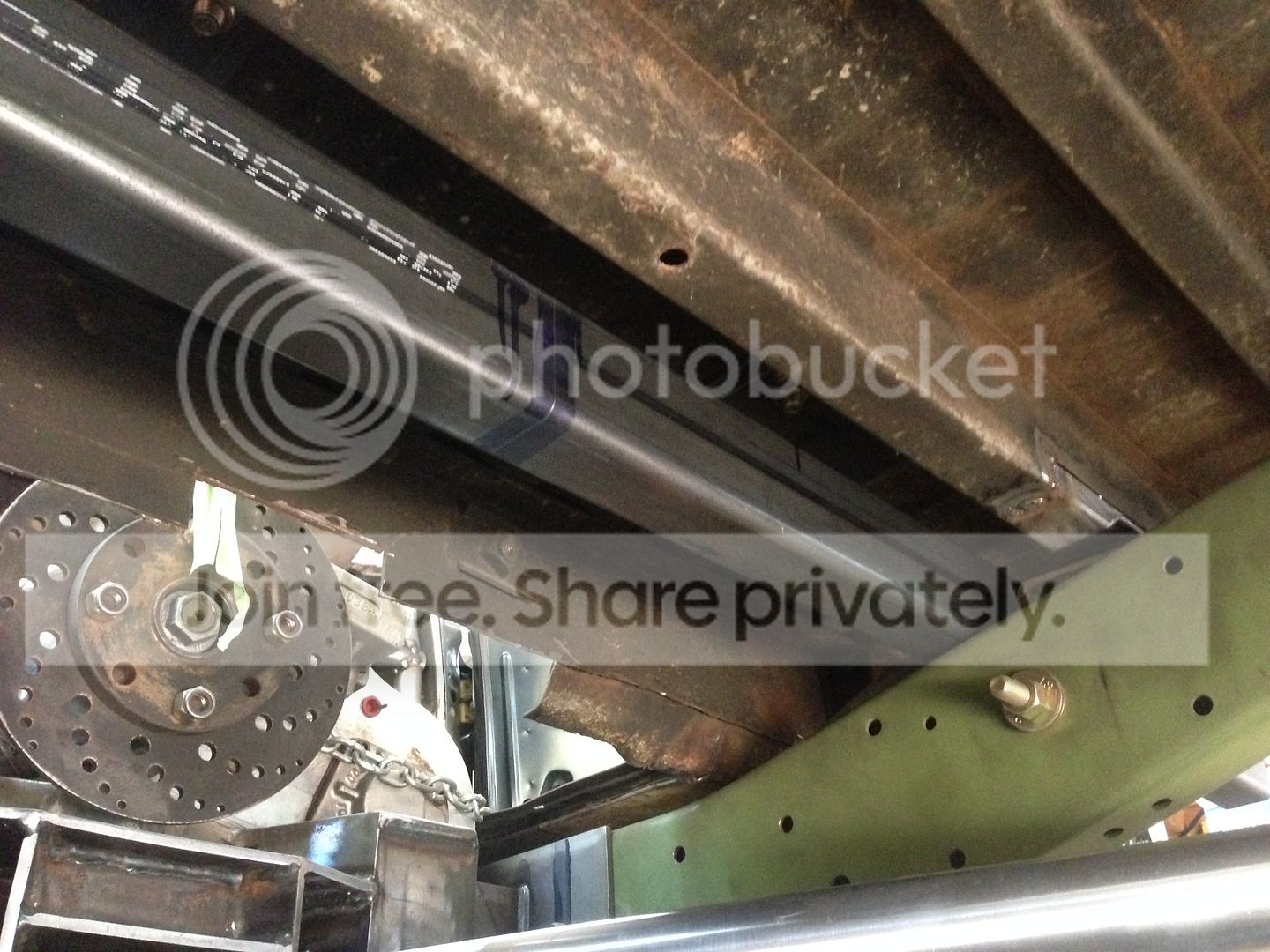

Here's the best shot I can provide of the full tube showing it's position relative to the factory cross sills in that area.

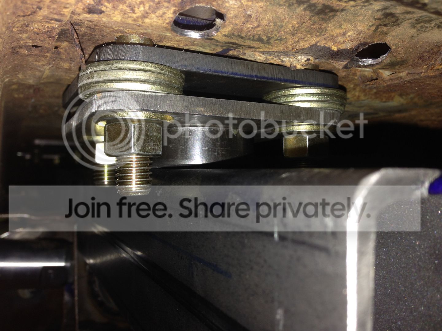

The plates themselves are a bit tricky. The key is that since I will be hard-mounting not only the 10 factory body mounts, but also ALL of these extra cage points... I need the same ability to shim and gap the bodylines at each position, in the same way the factory expected the body mounts themselves to be shimmed. This meant that I had build-in some adjustment space in my bracketry..... and ~3/8" seemed like a generous amount to do that (depicted as a stack of flat washers in the pic below)
Once I had that space reserved, between the underside cage plate and the cross sill landing plate, there was about a 5/8" gap that needed to be filled in with a small section of tube. Since my old 2" x .500" wall DOM link arms weren't going to be doing anything except sitting in the corner, I cut off a short piece and wedged it in there. No worries about strength on THAT part!! :D
I repeated this same process on the driver's side, though it was a much bigger hassle with the bedside still in place.

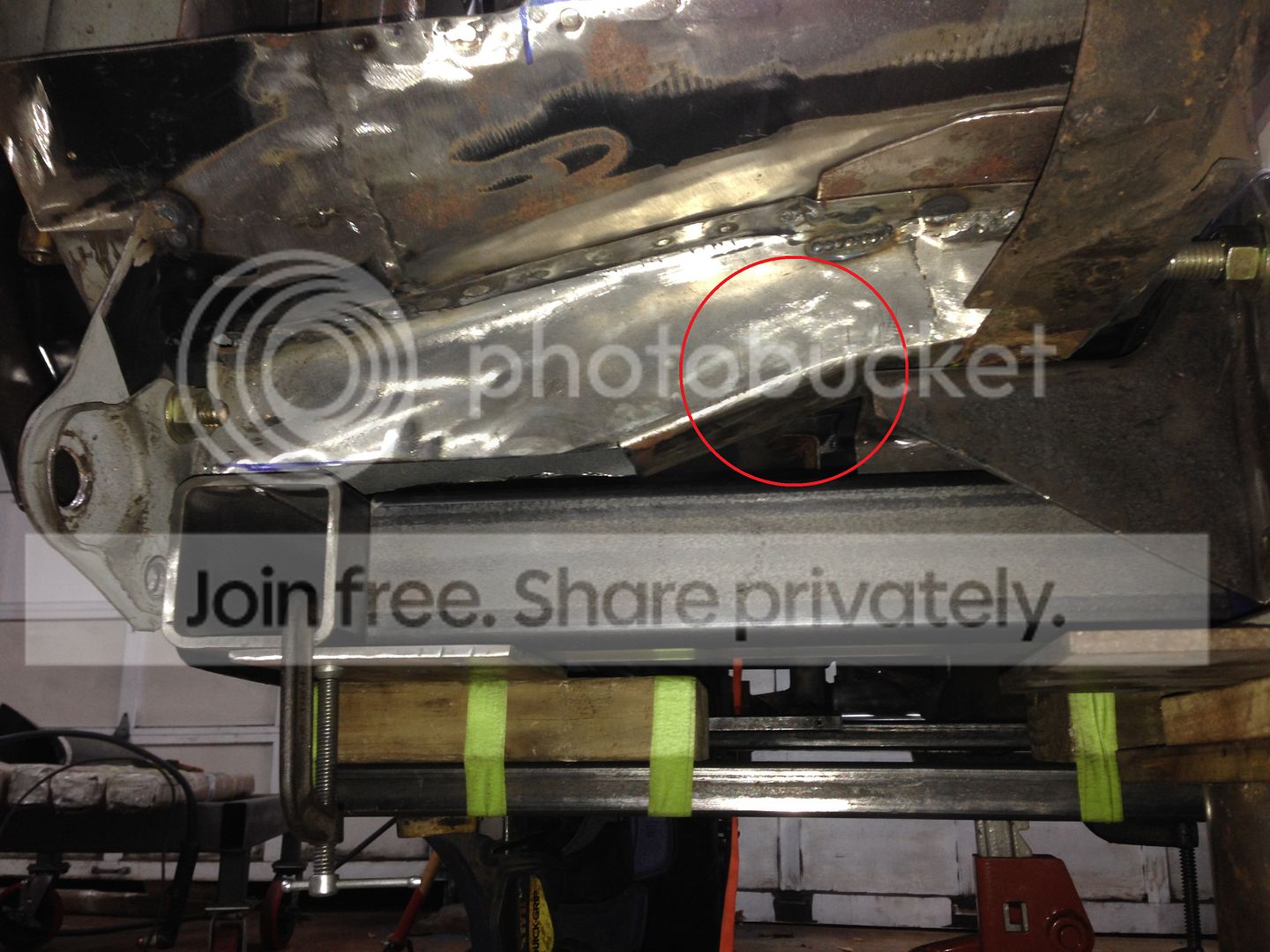

The rockslider is intended to get it's support from the framerail itself (like 99% of rocksliders do) but I also wanted to add support in a vertical axis by tying in slider into the A-pillar and B-Pillar mounts using down-bars. This will help tremendously to resist the torsional bending of the framerails when the rockslider is balanced on a rock, and the rockslider tube actually helps to tie the cage together longitudinally, so everything gets stronger in the process.
As it worked out, my flat bellypan framerails can be extended all the way out to the outside edge of the rocker panel, and are in an almost perfect alignment. In this shot you can see that I've clamped some long straight scraps of rectangular tubing to act as a temporary support for the rockslider, and to establish that "level" from the framerails themselves.

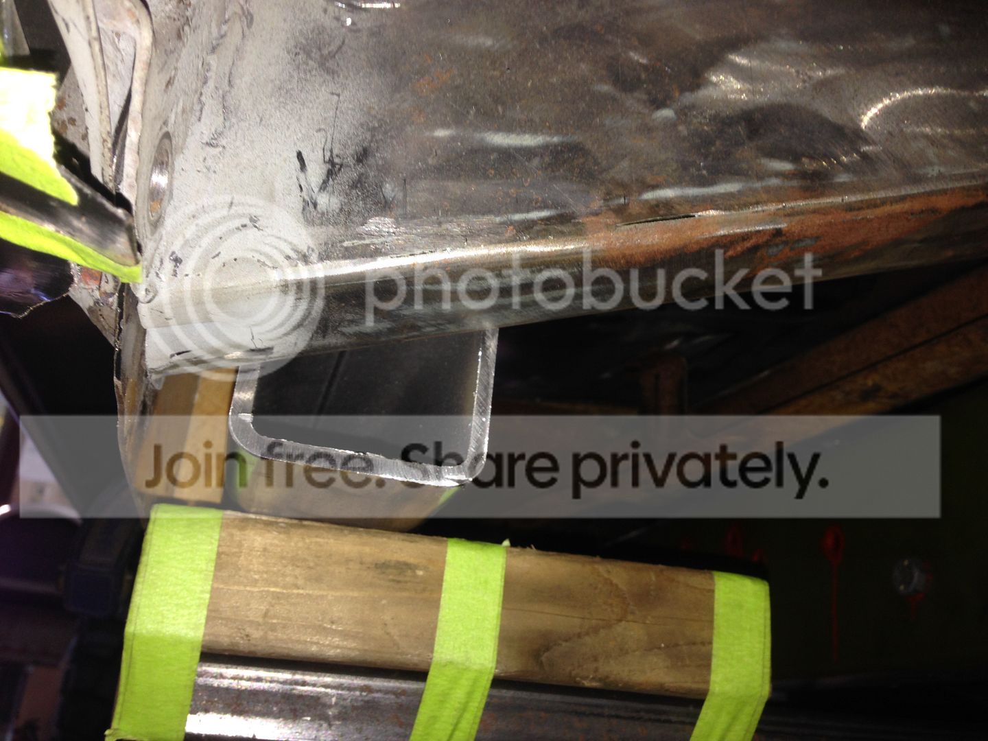

The inner rocker is a thin vertical piece of metal directly under the door area. I used a scrap of 3/4" thick lumber to act as a spacer so that I'd have a bit of clearance between the rockslider structure and the body. Remember that the body still needs to be removeable / installable, so I don't want to make all my clearances super-tight, or it will be a nightmare to drop the body back down onto this structure later on when it's all painted.

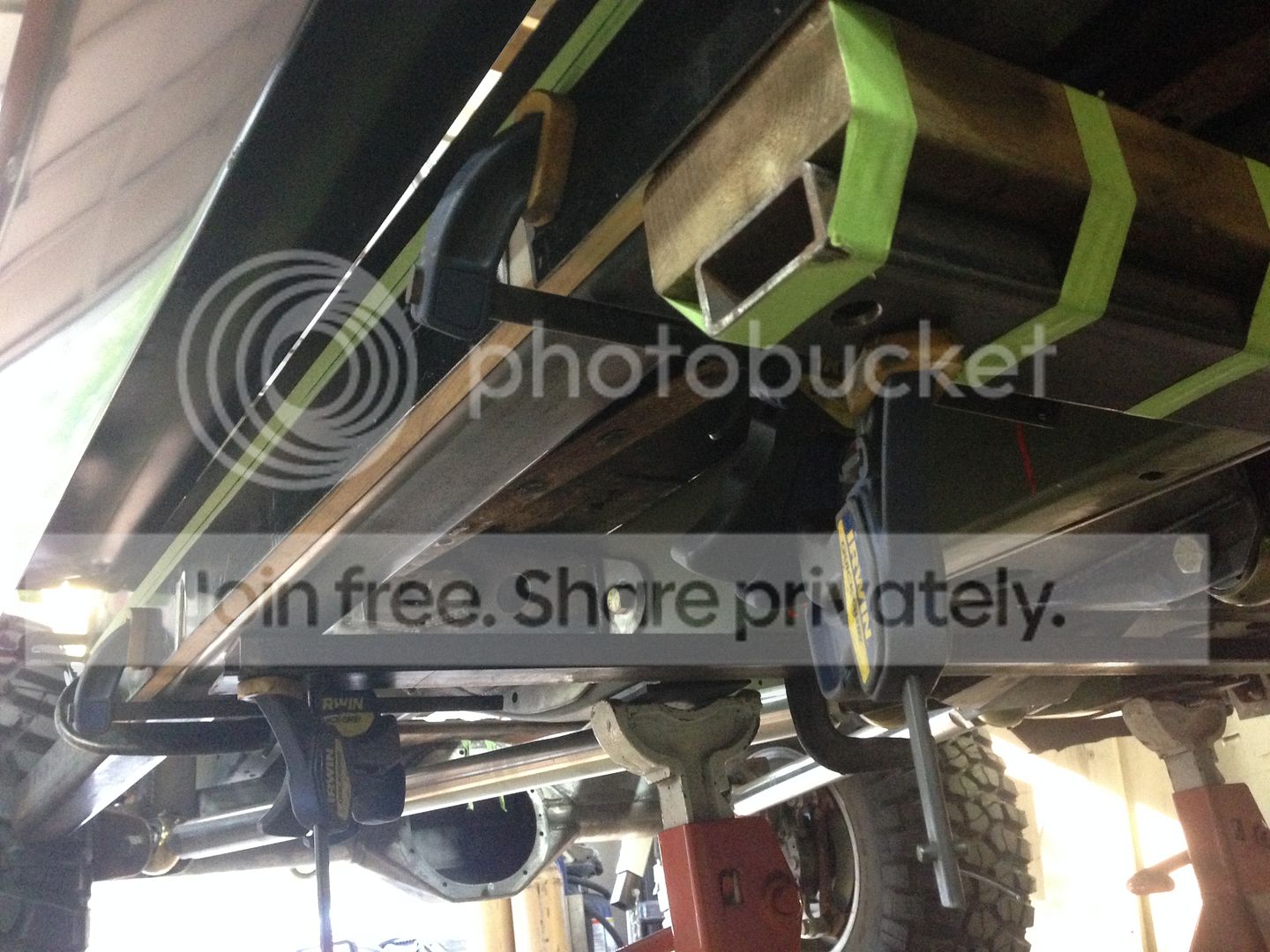

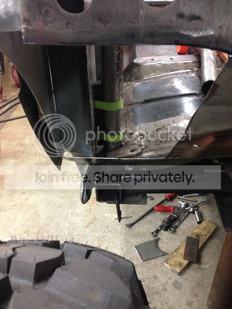

Here's the shot with the 2-1/2" x 2-1/2" x .188" wall square tube in position...
As expected, when I put that tube into position, it hit the front cab support!
Since I need to pick up the loads from the A-pillar roll bar, the rockslider needs to get directly below that cab support. Several years ago when first started this project, these rusty cab supports were lovingly replaced and restored..... and I thought for sure that work I'd done would last forever. :haha: Last night, I said "screw it" and chopped right into them with my abrasive wheel......
At the front cab support area of the rockslider, I also needed to get the loading back into the framerail itself, and a logical place to do it was under the factory body mount bracket since it's already lined-up with the cab support that I'd just hacked apart. Digging through my pile of old "takeoff" frame brackets (I had TWO frames, so I've got extras of everything!) and found the bracket I needed.

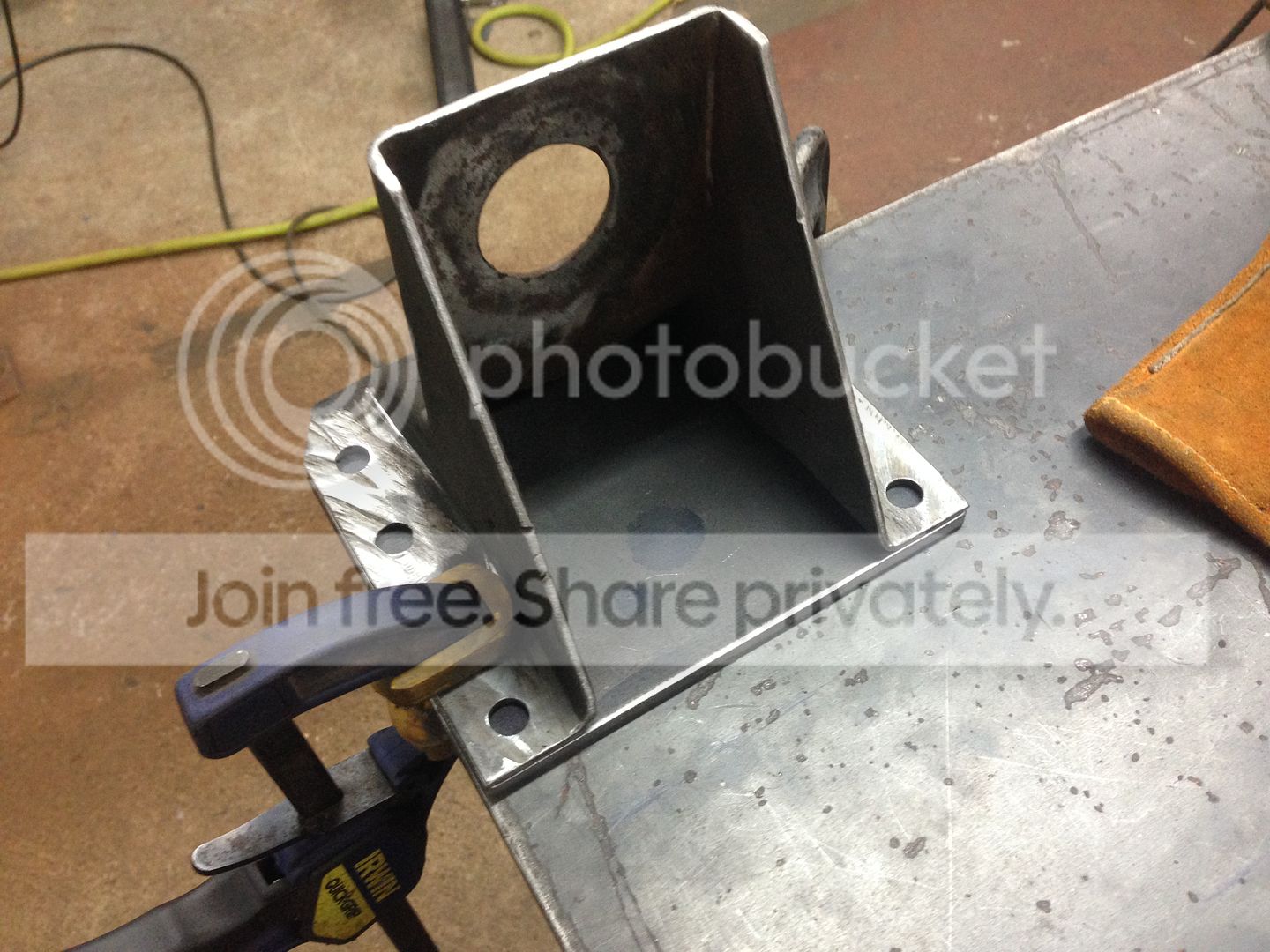

The concept was to build a stronger 1/4" thick plate that would be sandwiched directly behind the body mount bracket..... this would allow my to use all the same mounting holes that I already had, and give me a solid place to weld the 12" section of square tubing that comes in from the outer rockslider area.

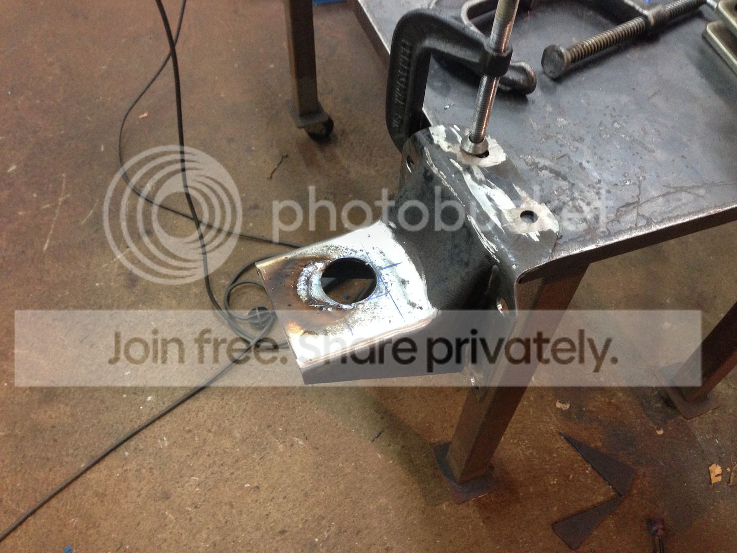

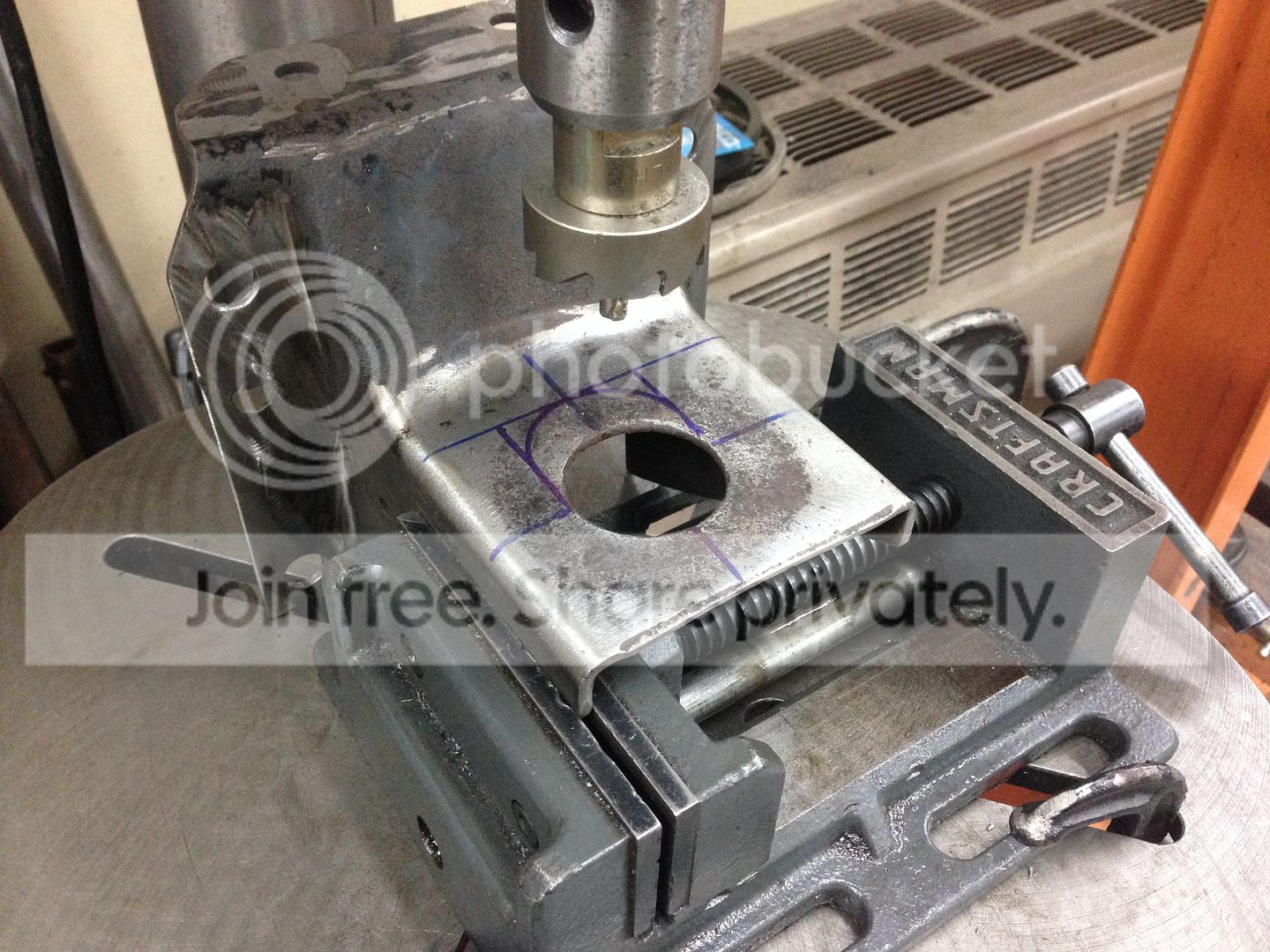

Along the way, I realized that the factory holes in those cab support brackets are FAR from accurate, and since I was spacing the bracket away from the frame an additional 1/4" anyway, the center hole was going to have to move a little bit....
It worked out pretty slick... I clamped it down securely and used my annular cutter to remove a small crescent shape of steel, then immediately recycled it by welding it back to the bracket on the opposite side to create a new hole about 1/2" further inboard than it was....
Sweet.
It was a bit of a hassle to get the old bracket out, and the new "custom" bracket into place but I eventually prevailed....
The payoff for all of this work is seen in the following photo:
You can see (through my conveniently located tire clearance hole in the firewall :D ) that the A-Pillar is directly above this forward rockslider mount, and that the mount also now ties-in cleanly to the frame area...and tucks in right under the factory cab support mount. Obviously, I'll have to drill out an access hole for the cab support bolt before I make this all permanent... but this shows the basic idea about how the rocksliders are going to get their support not only from the side (frame) but from above (roll cage). This whole assembly is going to end up really tight and rigid once all these items are locked together.

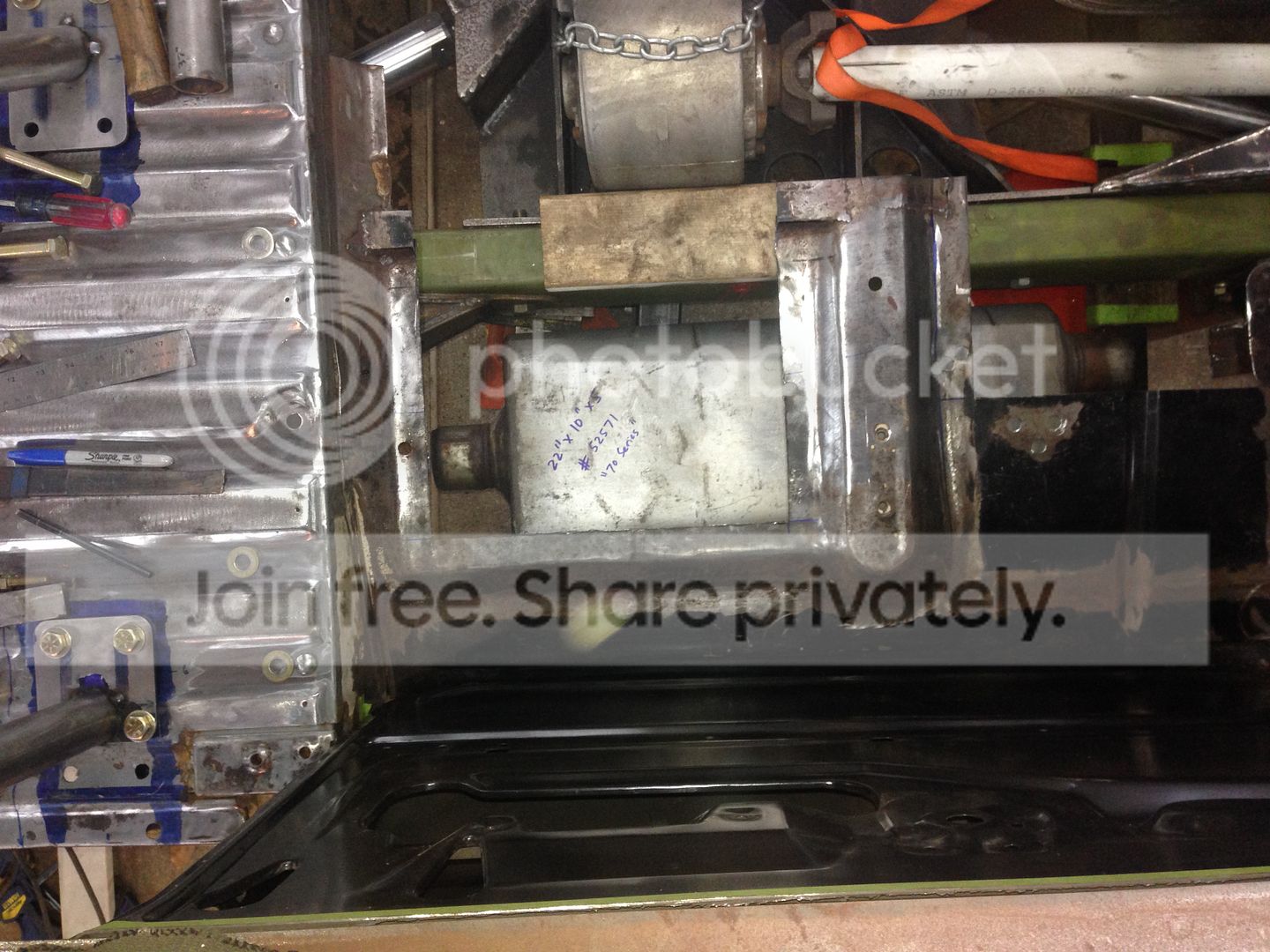

Last night, I spent some more time looking at the real-estate created by closing off the rockslider / frame area and since I have already decided to run the exhaust collectors into that area, it seemed like a good idea to try to fit the mufflers in there too.

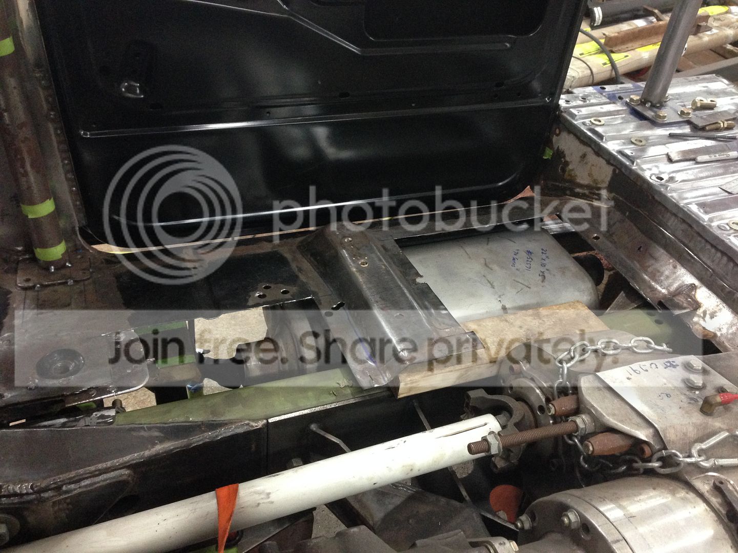

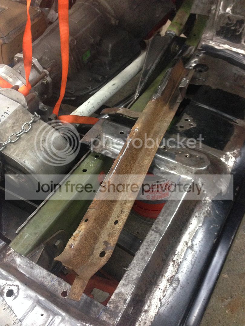

The only catch was that there is a factory floor brace in the way. It runs front-to-back across the middle of the floor on each side and is SUPPOSED to strengthen the floor. It's performance is dubious at best, and I'm sure I can come up with something stronger (certainly something with more speed holes!) and since it was in my way..... it was removed.
When my truck used to run, I had installed a set of 70-Series Flowmasters on it. They are pretty huge (22" x 10" x 5") so they seemed like a great option to test the available space. If THESE things fit, almost ANYTHING will fit!!! :haha:
......and they DO! :waytogo:

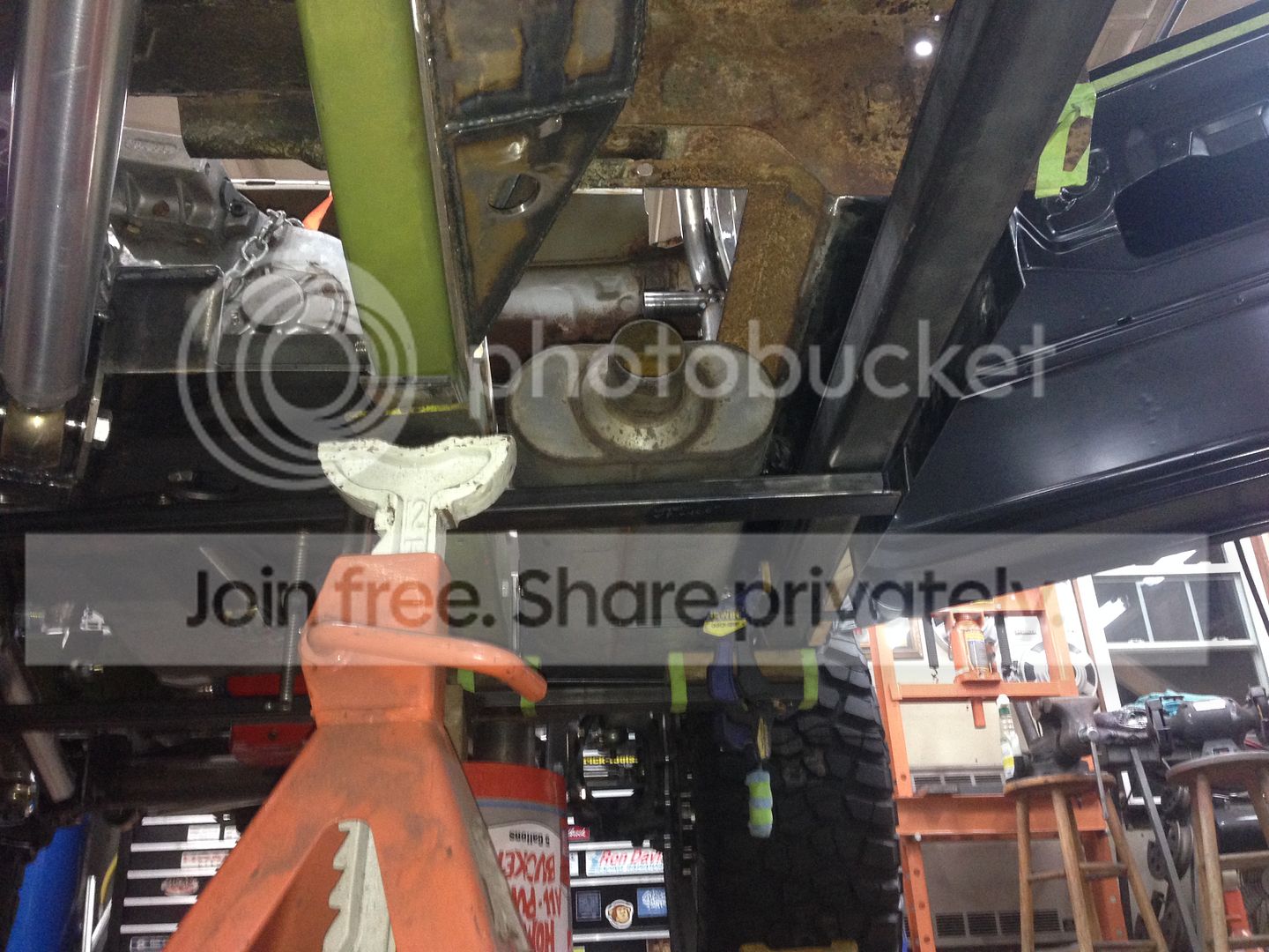

So.... now I've got a huge space, with a huge muffler in it, that will be completely protected from underneath by an enormous skidplate. And it's located directly underneath the passenger seat. This is what they call "a single part doing more than one function".....it quiets down the engine noise AND it acts like a terrific seat warmer too. This is luxury that is usually reserved only for the finest luxury cars.... but now I'm bringing it back to 1972 baby!!
(The serious solution is going to involve spending a LOT of money on Jet-Hot coatings, and ThermoTec insulating products) :D
Ultimately, I want this truck to be quiet most of the time... so hanging massive mufflers is actually part of the plan. What is ALSO part of the plan is adding a set of electric cutouts so that I can "blend in" some extra noise on those occasions where I want to have some fun..... by my current thinking, I should be able to install a set of QTPs (or whatever) just after the header collector passes through the cab support area and into the rockslider cavity..... the exhaust can then be diverted to either go through the quiet muffler, or out the dump pipes. If there is enough room, I would love to run the dump pipes parallel to the muffler and then merge them back into the same common exhaust section just before it exits the side of the truck. That way the truck looks normal with only two exhaust ports total, but with the variable cutouts, I can "tune" the amount of noise I want just by cracking open the butterfly valve more and more.
I think there's room to do it. Here's a shot of the muffler pushed back as far as I can (without trimming more metal). It looks like I might have around 12" of open space in front of the muffler to play around with.... :thinking:
