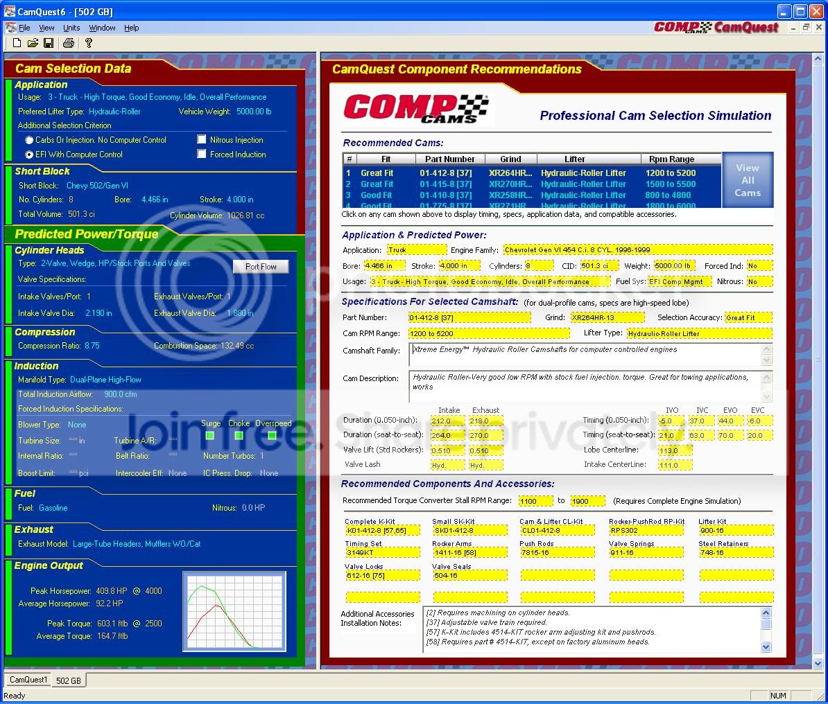

It is set up to be EFI friendly, using a cam with modest LSA specs. The objective was to maximize low RPM torque, so I think it will be in the 400HP range with over 600LB/FT of torque... Torque peak is at something like 2500rpm too......
And it's never burned a single drop of fuel....better economy than a Prius. :D
EDIT:
I found a CompCams simulation printout from back in 2007.... not sure if this is the final set of numbers or not?? :dunno:
Scott may have saved something newer on his side, but this is all I have here.

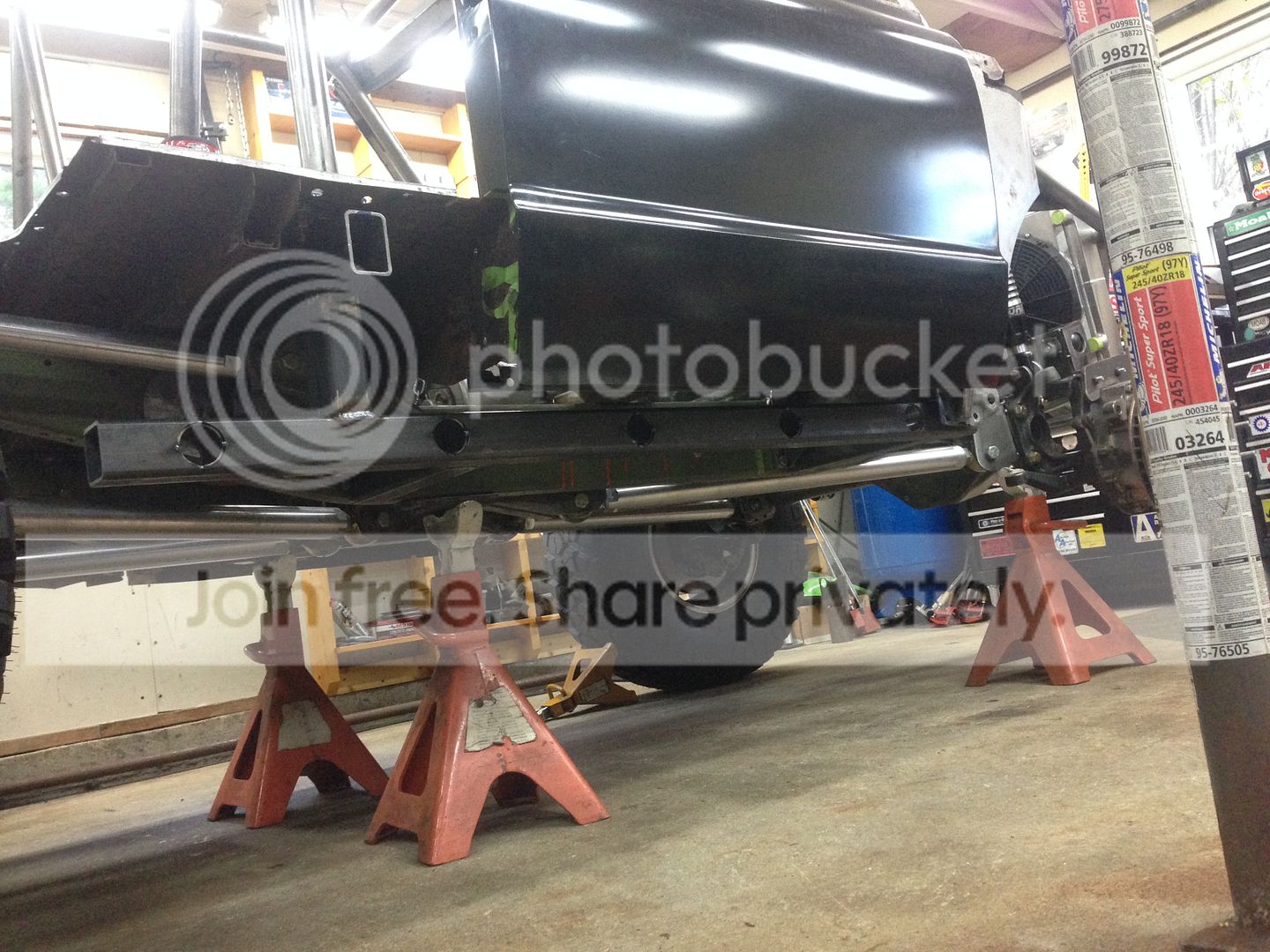

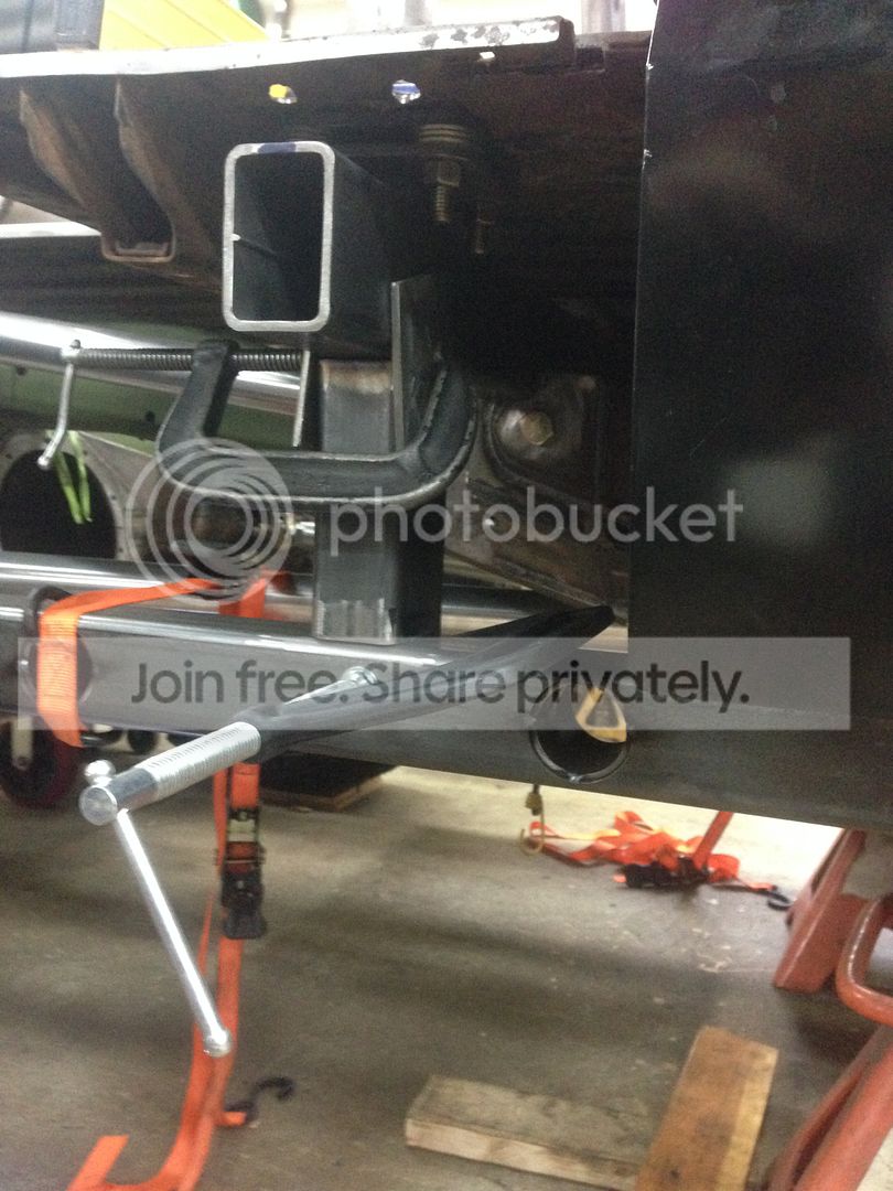

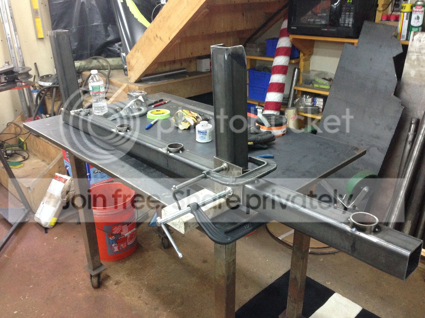

As is usually the case with "new" ideas in the build. It takes just about forever to get things mocked into place. The rockslider structure was no exception... there are so many simultaneous dimensions to check, that just getting the part under the truck and secured on jackstands with shims and c-clamps is a real time waster. Eventually though, I got what I needed and was able to burn-in the two outrigger tubes that connect the rockslider to the outer frame rail area.
The front support gets welded underneath the factory cab support hanger (centered directly under that large bolt), and the rear hanger will end up welded to those massive upper link mount brackets that I'd built many years ago. The nice thing about the way this is going together now is that instead of having a TON of small parts all bolting to the boxed framerails... I am actually creating a second "perimeter style" frame structure that will include both rocksliders, the new 2"x3" cross sill, the upper link mount brackets and the front cab supports. Fewer individual parts should translate to an even stiffer frame structure, and less worry about bolts working loose over time.
When I break this project all the way down for final painting, etc. The parts should still be a manageable size to lift and work with... and that's important too.

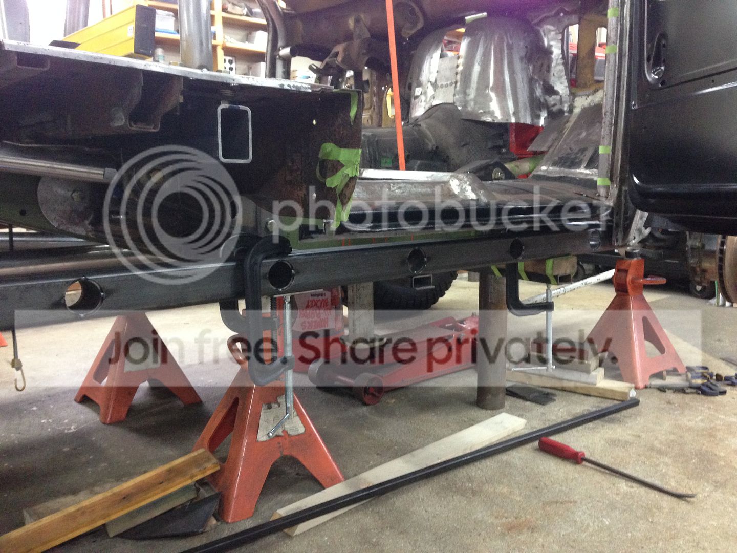

With the supports fully welded to the slider, I started fitting them up to the frame and cross sill area. Lots of clamping and squaring-up was required. It's hard to get a good visual reference when the tubing has such a pronounced radius at the corners... so I find myself using small pieces of plate steel to make sure I'm landing the parts against each other perfectly.
Here is the shot that shows the rockslider in final position.....MUCH further inboard than the last time I posted a photo of it (when I believe Eric had a small panic attack about the aesthetics :D ). As I mentioned before, the target was to get it about 3/4" behind the vertical inner rocker sheetmetal so that there would be ample room to position the body back down on top of all this stuff and not scratch up the fresh paint, etc.
You might also notice that the "inner rocker" that I just spoke about is actually mostly cut off now. The challenge with leaving that sheetmetal in place is that I need to get access to the 5 index holes to install my rocksliders. I could drill a series of 2" holes to let the tubes pass through the rocker, but there is also going to be a large flange that connects all those tubes together and allows me to run bolts from the outer rock slider assembly into the inner rocker support area to clamp them together strongly.
Here is another image... sorry it's not very well lit or focused.
Ultimately what will happen is that I will take the piece that was cut off and bend it a couple of times (lengthwise) so that when it is rewelded the panel will come down to the top of the rockslider (within maybe 1/4" then travel horizontally toward the center of the truck for a few inches, then bend again to that it is aiming down toward the ground again.
This will allow any debris in the area to rinse away, and will prevent me from having a large gaping hole visible when the rocksliders are installed and the door is open. Being able to preserve the factory weatherstripping across the bottom of the door is going to be tricky when the factory outer rocker is removed... so I'm trying to keep as much metal intact in that area as possible to attach to.

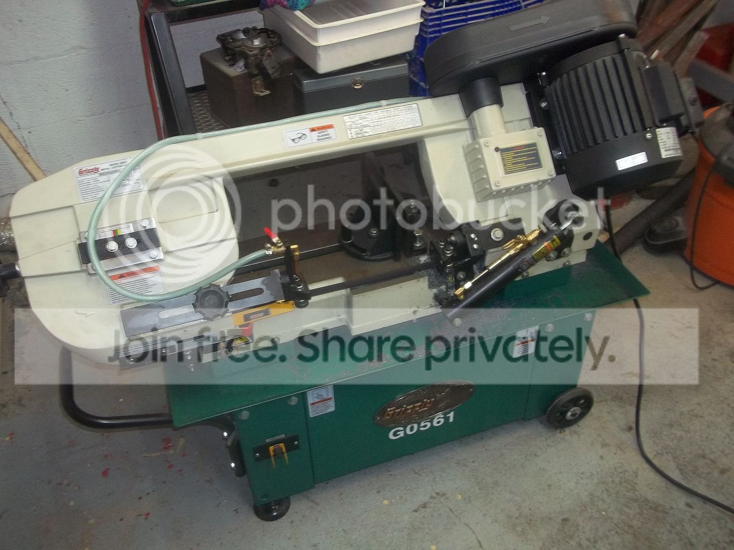

*coughbandsawcough*
poifect cuts.... :pimp:
Perhaps you haven't seen the size of my workshop? :haha:
Space is absolutely max'ed out, and I'm going to need to find space "somewhere" for that new rolling TIG machine.
A stainless hose clamp....now THAT'S something I can find room for! :waytogo:
