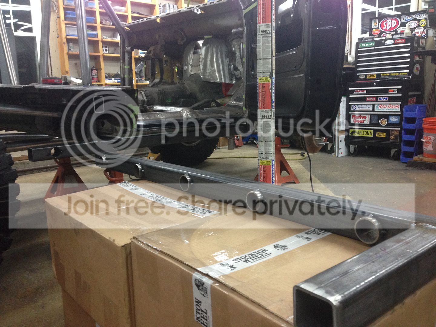

In the meantime, there is ALWAYS something that can be done to move the project forward. So I spent last night building a mirror-image rockslider assembly for the drivers side of the truck.
Basically it's the multi-hole main section, plus two frame stubs... then a small drop-bracket that locks it into the B-pillar area. Once those were all welded up I started the tedious process of getting the heavy SOB up under the truck and into position....

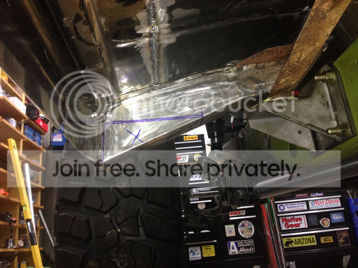

As before, the A-pillar cab support was in the way, so I marked it and did the unthinkable for the second time.... :D
I also marked and cut the inner rocker (vertical panel) to remove the excess. It makes it a lot easier to negotiate the slider into position for ratchet straps, clamps, shims and cuss words with that sheetmetal removed.
By the end of last night, I had it up into position correctly. I used a LOOOONG section of 2"x3" tubing across the underside of the truck (laterally) and clamped it under the passenger side rockslider tube....then ran it tight against the two framerails. Since everything is in perfect horizontal alignment, this gave me a "shelf" to rest the drivers side slider assembly on, and help to insure that it was perfectly level and true with the other side of the truck.
A few heavy tack welds will lock it all into place, and I'll be free to play around with the new tubing this weekend..... That will be perfect timing, since I am now pretty excited to build the visible part of the rockslider and get that mounted under the door area.

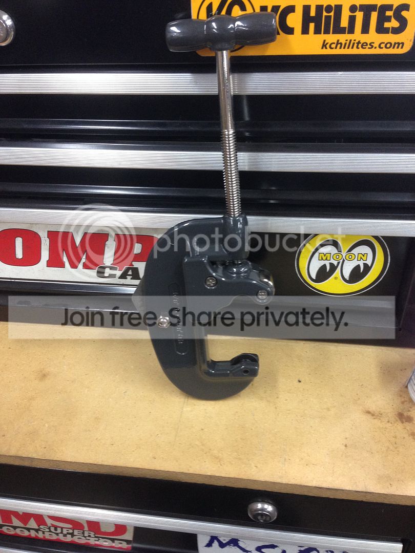

The first is an idea that I thought would work out better than it did.... It's a large diameter pipe cutter (up to 2.5" diameter). Whenever I want to cut a nice, square end on a piece of tubing it's always a struggle to either wrap it with tape or just some other time-wasting process. So I bought this from Amazon.
It worked great for exactly ONE tube. It scored the line I needed and I was able to then follow that score line with my cutoff wheel and get a good result. Unfortunately, I think the cutting wheel isn't designed for harder metals (like steel) and now it "walks" all over the place instead of cutting straight...... if I ever need a barber-pole mark on my tubing, this will end up being really useful. :whistle: I'm not sure if there is such a thing as a hardened cutting wheel replacement, but if I can find one this tool would be an awesome time saver.-G
I have a similar pipe cutter I use for exhaust pipe and it works fantastic. Quick, easy, straight cuts with no cutting mess. Never had a problem with it but it is a high quality piece, no idea what it cost, inherited it from dad. And of course I have never tried to cut anything as thick as you are trying.
