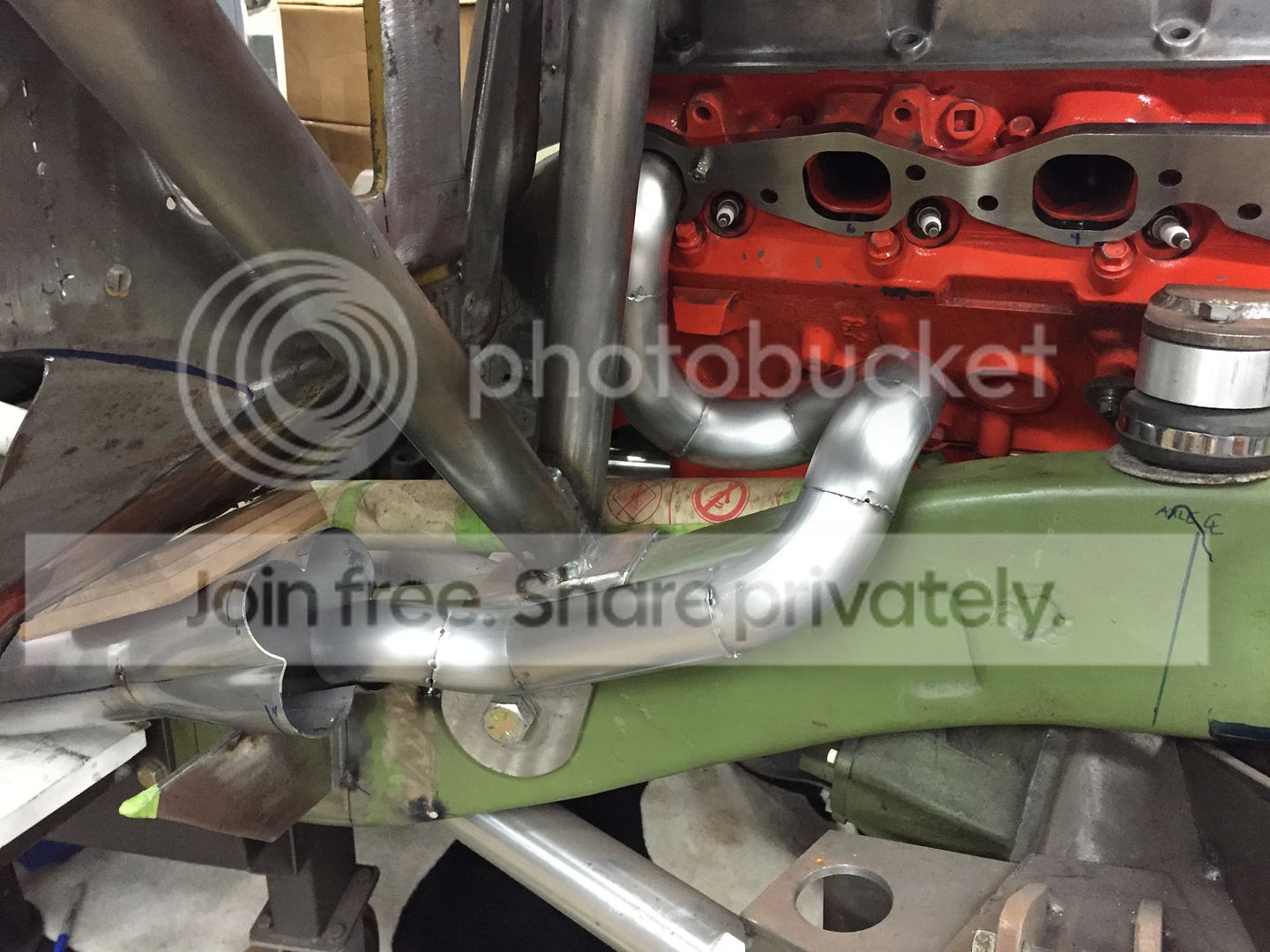

All the sections in that one tube...that's craziness. Making progress.
12 sections per primary tube.....8 primary tubes.
Someone's going to have PLENTY of TIG practice before this whole story is finished. :waytogo:
-G

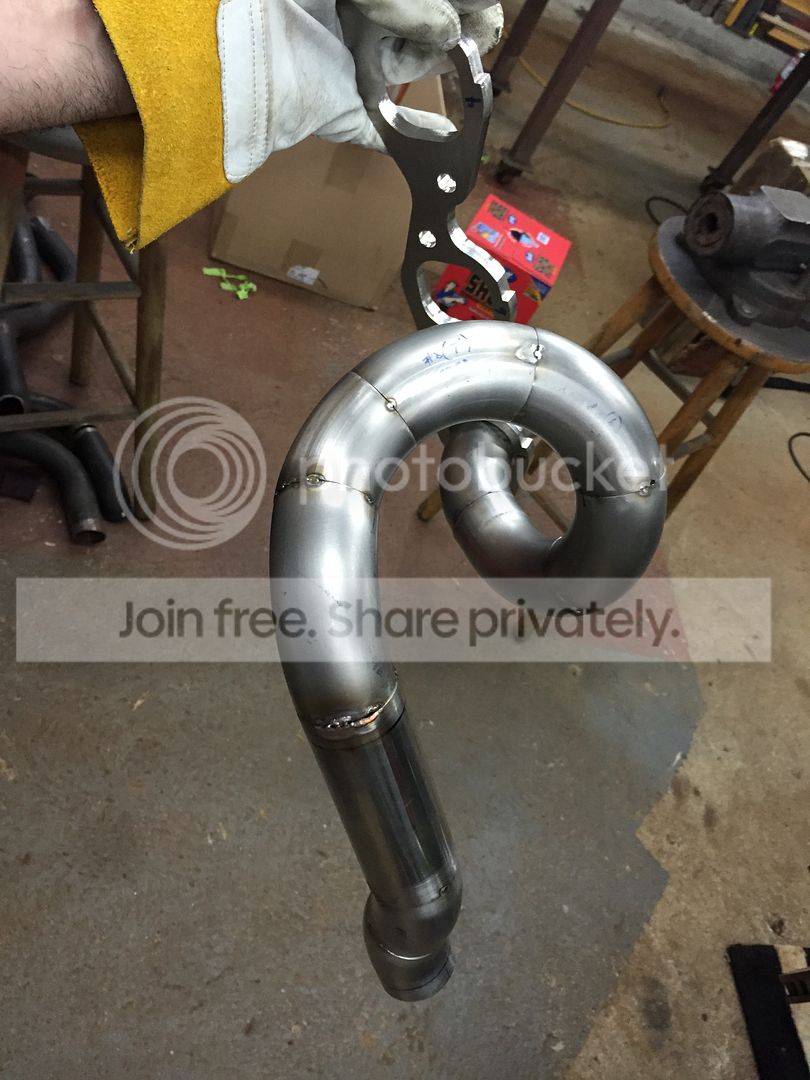

2015.08.13 - UPDATE! - 12 SEGMENTS DOWN, 84 TO GO...!!!!
Cylinder # 8 is complete!!! Check that one off my list!! :saweet:

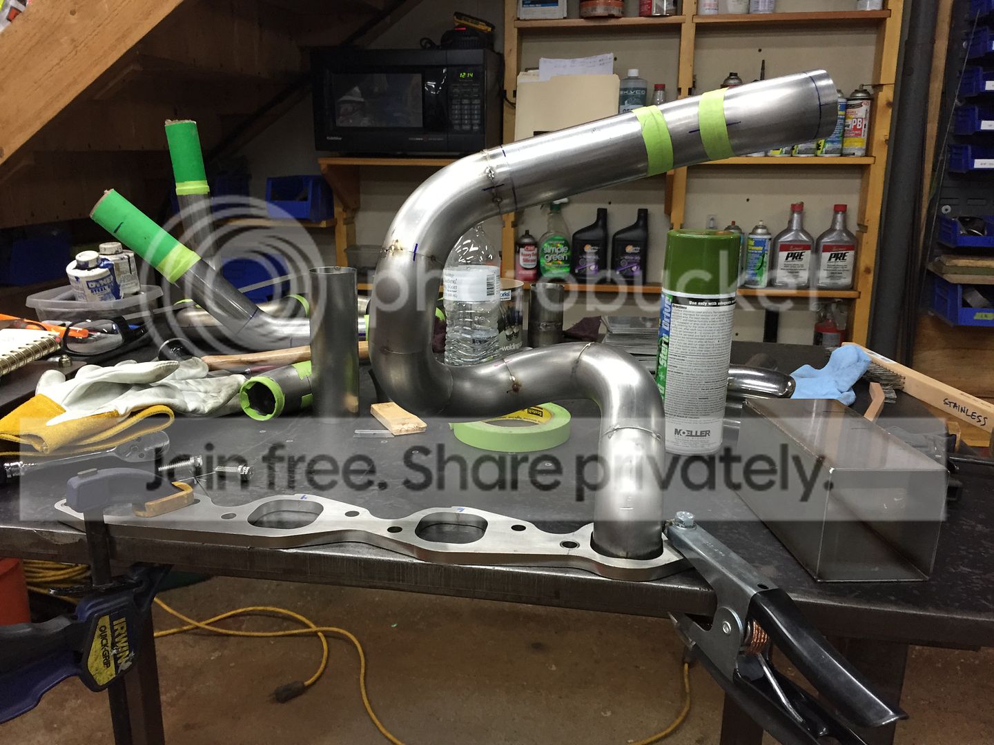

12 segments, all fit up and tacked into place and it lands nicely in the collector just the way it needs to. With only 7 more cylinders remaining, this process should be done in no time. :haha:

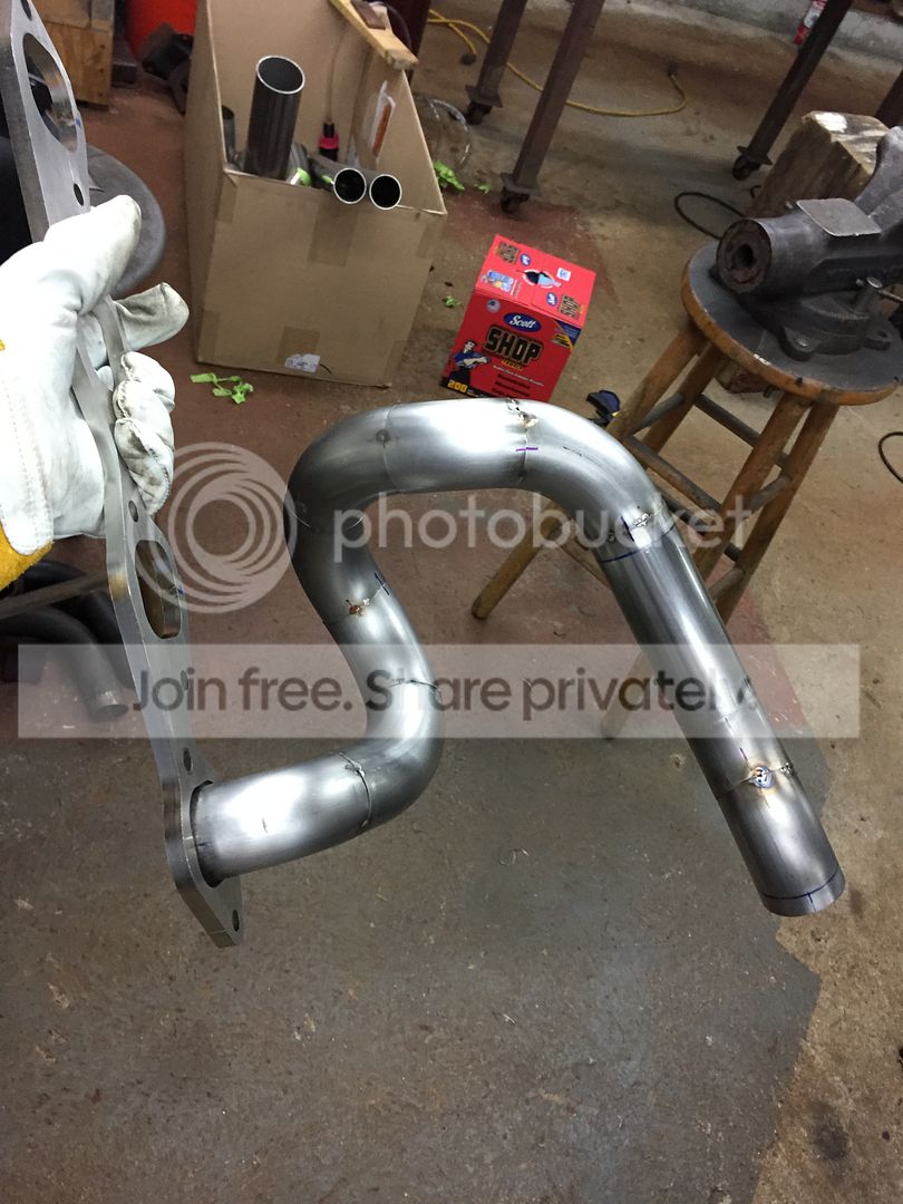

On the bench doing the last few segments:
That's some crazy-ass bending going on.... :D
The final shot at around 1AM..... it was a late night. :eek1:
One thing that continues to frustrate me is the inconsistency of being able to do a quick tack-weld with the TIG. If I am laying the part on the bench with the seam facing upward, I can almost always get a nice small tack weld across the seam. If I try to do anything in a vertical position, it seems like all I get is a blow-through on the tubing. :doah: The seams are all nice and tight (no gaps). I'm trying to keep the torch really close to the tube, and I've tried aiming the torch straight down into the seam, and also coming in at around 45* from the side. I have tried going maybe 1/2 pedal (max is 45A) to see if I can ease into the puddle and avoid holes... but at this point I just can't figure out a good method to tack things together in anything other than a perfectly FLAT benchtop configuration.
This is not going to work forever.... eventually I will NEED to tack something that's already installed on the truck, so if anyone has tips or tricks please let me know!!! :bow:

I don't have any advice, except to biuild a really large and strong bench that can hold 5000lbs. :) Those stainless headers videos were pretty neat to watch. I wonder if you can build some kind of fixture that fits on your bench like they did?
Is the plan to take each cylinder tube off and fully weld it up and then weld them all to the flange and collector at the end? I could see it being really hard to access all the joints once all four tubes are tacked in.
Yeah, that's what I need..... a complete vehicle rotisserie!! :D
I will have to go back and watch the videos again to see how they normally do it, but I'm pretty sure that each primary tube is removed and is fully welded....then they are welded to the head flange, and the last step is welding the collector end together with the "star point" to seal up the center gap between the four tubes. The last step is the perimeter weld the collector to the primaries. :thinking:
-G
When I tack something I always find its best to blast it with the heat all at once. Sometimes you need to dab some filler, even for a tack. Somethings not right if you're blowing through.
Going from an angle can be a good way to push something that has more material into a puddle on something that has less, or even something with a slight gap.
Also you're probably going to want to grab a toxic cup for doing the collector. Its expensive but only use it when you need it for stuff like that. It lets you have like a 2in stickout to sneak in tight places.
What sort of distance do you keep from the tungsten to the workpiece? I think I might also be getting TOO aggressive and trying to lay it in there like 1/16" above the tubing. It's possible that the arc isn't even the right length/shape to initiate the melting...??? :dunno:
All I know is that I stuck the tungsten about 10 times last night, so I know that I'm definitely working a LOT closer to the puddle than the first time I posted my TIG photos!!! :haha:
-G
Nice ram horn on that exhaust. :) you look to be making decent Progress. That's tough to learn a completely new process of welding. You look to be doing much better than most would though.
my tungsten is typically very close to the work piece. You have to realize, the bends of the u bends are much thinner than the straights, theyre also inconsistent from the bending process. So, what you might be thinking is your own fault may in reality due to the material being thinner.
i start my tacks cold and dab some filler and burn the filler in.
my first or 2nd post here i talked about the sequence of building the headers and you have it right. tack everything, leave the tacks on the header flange easy to get to so then can be removed later. once your happy with the complete header mark how the tubes are clocked on the flange, remove each tube and weld them completely. reassemble header tack it together, test fit. install the collector and mark its orientation, i then tack all my tubes together remove the collector and fit the center cone or plate. weld it and as much of the tubes as you can, install the collector again tack it and finish weld. you can finish weld the header flange before or after the collector, just dont do it before the 4 primaries have been welded.
i have a 3/8 thick piece of 2x4 tubing i drilled and tapped for the header flanges i bolt it down to that and then weld it. Ive never had a problem
