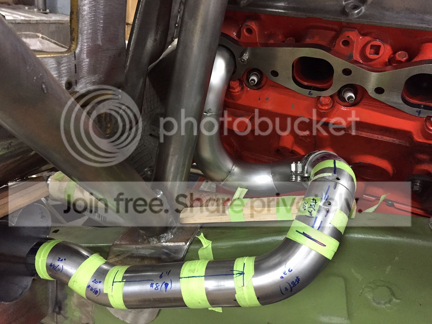

Quick update for slow progress... :)
#8 cylinder... First 4 segments are now tack-welded in 304 Stainless! Moving my way toward the collector swapping in one new SS segment at a time, aligning it, marking it and then tacking it in place. So far so good... :)
-G
Those are funny looking green welds!
Keep up the great work
Indeed! :D
The markings on those tubes tell the tale of how complex the exhaust design is. There are 12 segments (and rotations) fir the number 8 exhaust port alone.... That is a lot of potential adjustment, but also a lot of opportunity for misalignment too!!! :doah:
-G
