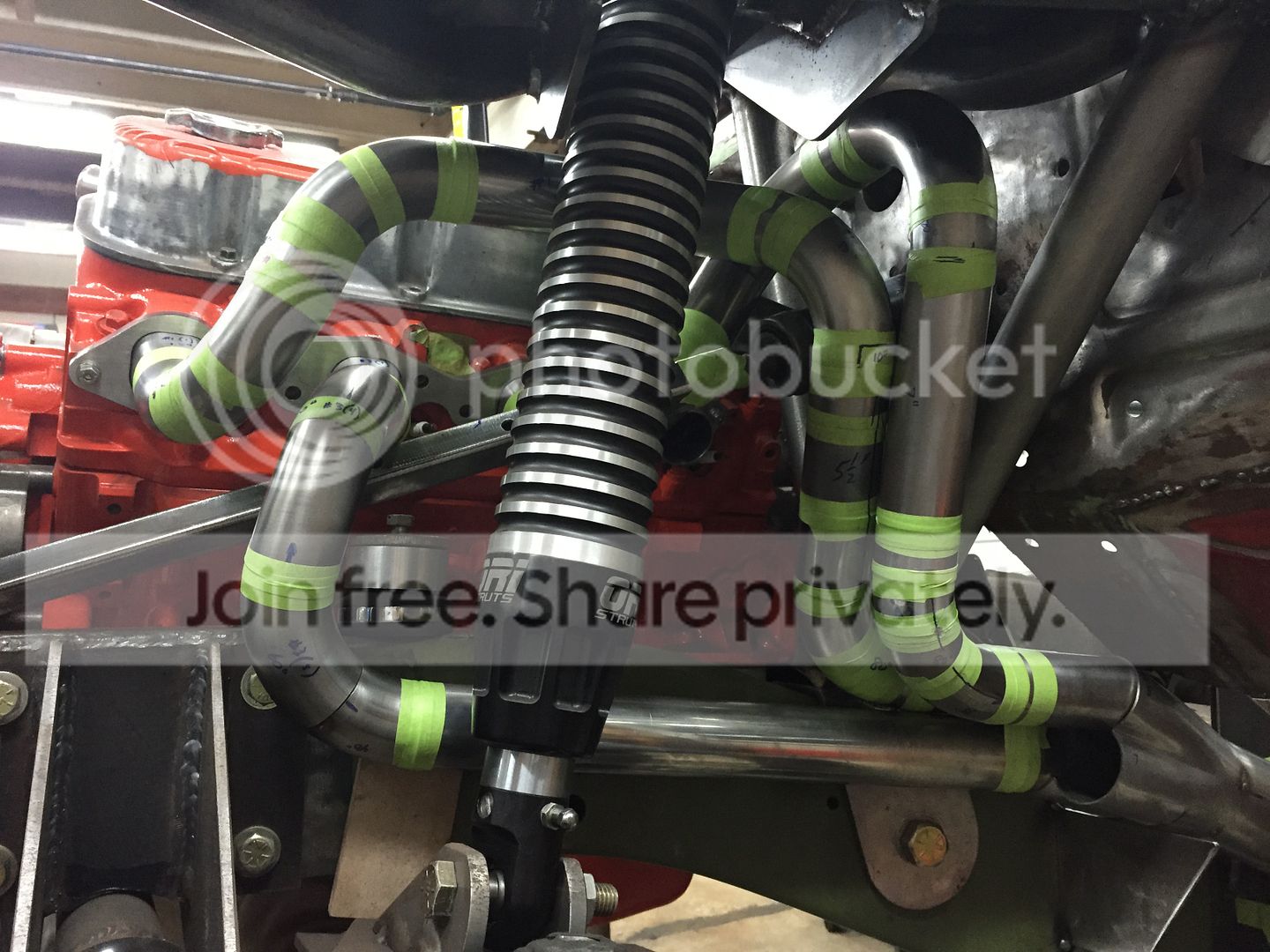

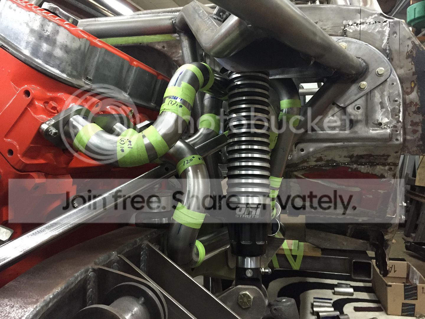

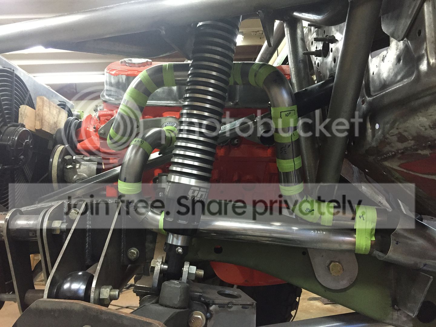

More photos of the Driver's Side effort so far......
Cylinder #1 ended up being a mirror image duplicate of the passenger side (Cyl #2).... But after that, I had to make some changes to fit the steering shaft.
As you can see in this one (Cyl #1, 3 & 5) the routing had to get a bit more creative to clear the steering... and I had HOPED that there would be a way to do each exhaust port above the steering shaft so that the header could be removed without disassembling the steering shaft.... but it looks like #7 will end up on the underside of the shaft which will basically trap it there.
Here's a shot from the front showing the tiny amount of room I've got to work with to make everything fit... :yikes:

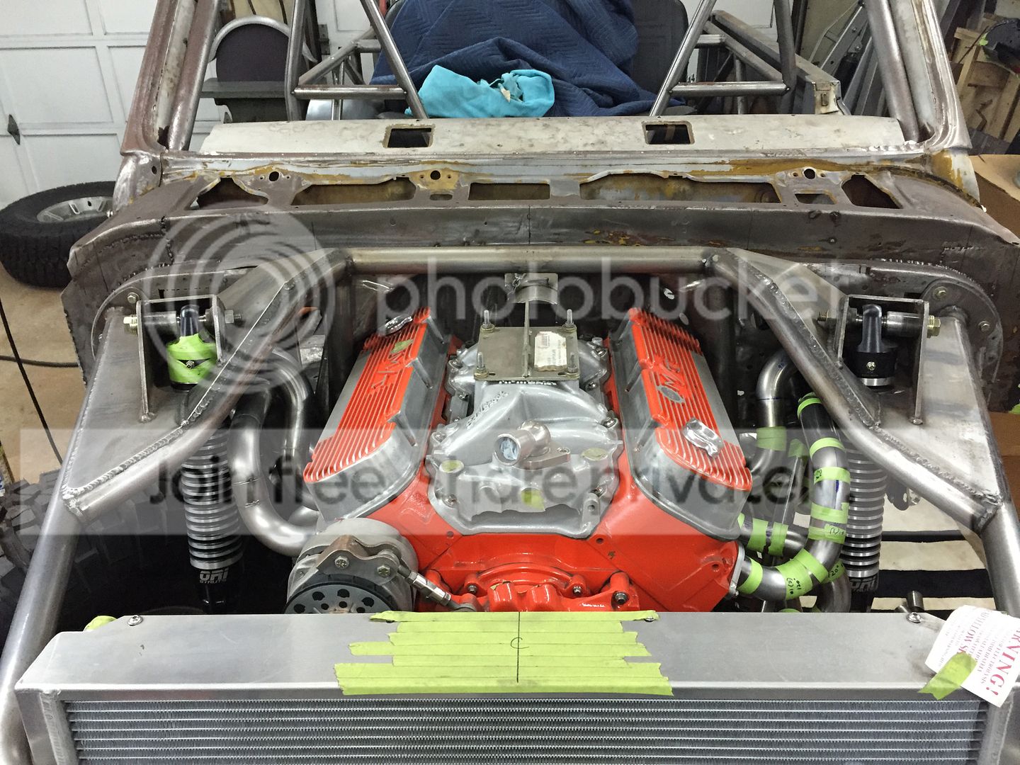

And a parting shot of the engine compartment from a little further back to show both headers in a single photo...

How well are the ORI's gonna cope with header heat? Looks like #1 and #2 both brush past the strut body pretty closely.
Well... The headers get JetHot coated at the end of the build, so we will just have to see if that does the trick.... If not, I will have to come up with some kind of thermal wrap, or a small metal heat shield of some kind... :dunno:
